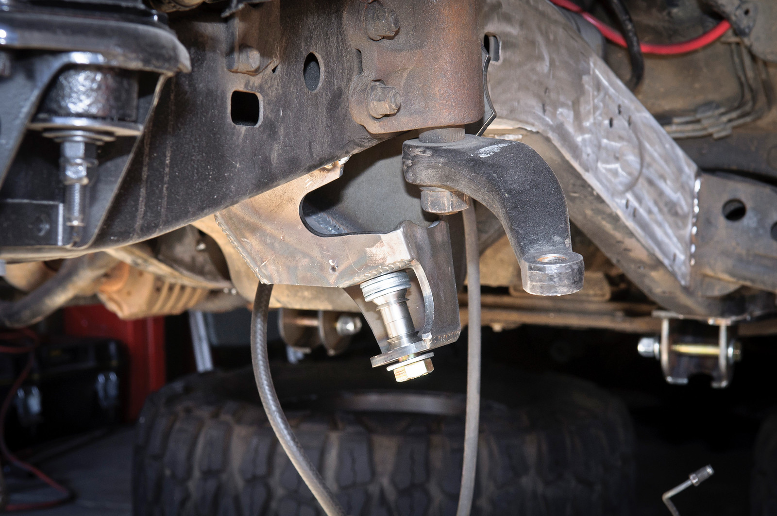

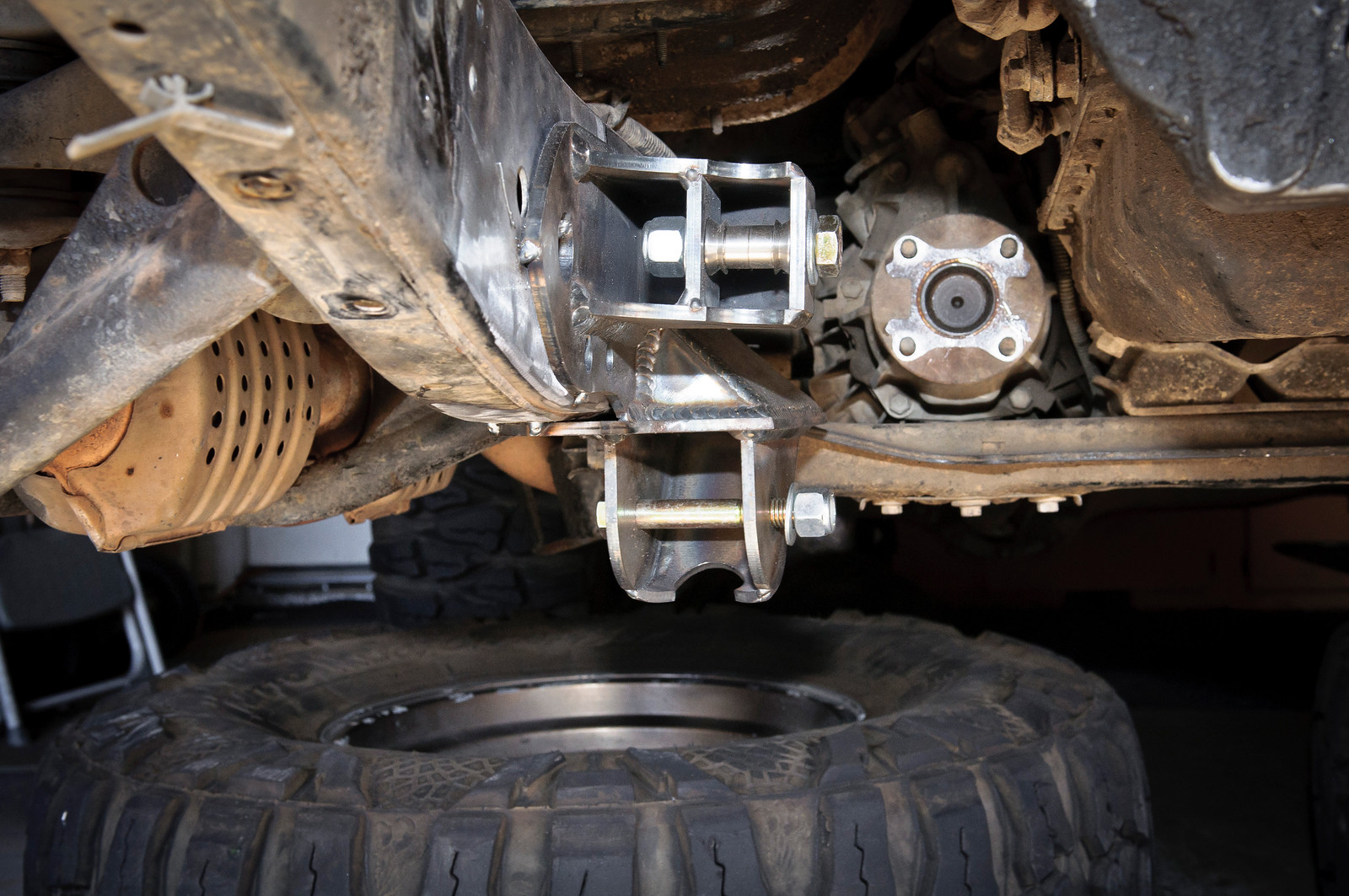

All brackets cut off. Started tacking up a few of the new ones. Waiting on some hardware to install the knuckles, and also waiting on the shock towers and lower coilover mounts. Cutting off the OEM shock towers and panhard bracket was a pain. Radius arm brackets up on the frame came out real easy.
Driver's side frame all cleaned up. But I cut my rear brake line with the grinder by accident. It was getting dark and I didn't have good light set up. FAK. It's the really long line that goes all the way to the back too. Think I'll cut a section out, re-flare and add coupler in its place.

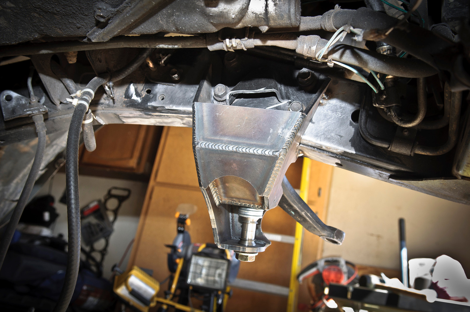

Panhard bracket really only goes in one place so I started to tack that in. Not much room to get this one wrong so no need to wait for the axle.
You could tell Brian put a lot of thought into this intricate bracket.

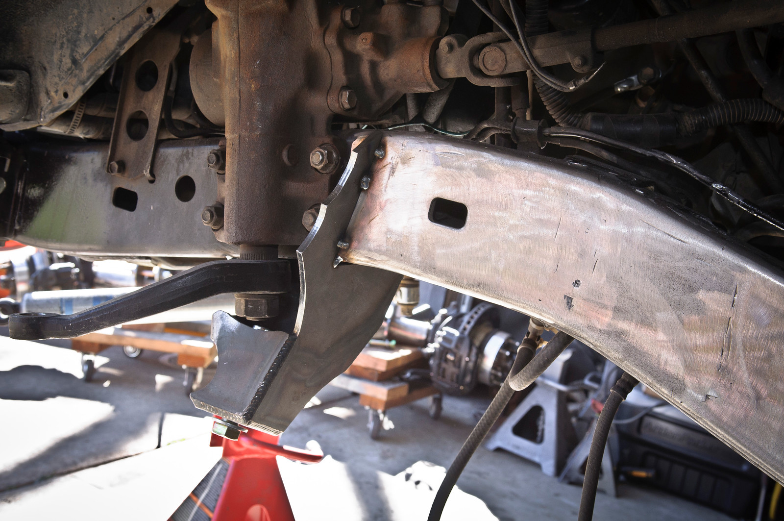

You could see the part of the OEM bracket I left in place. No way in hell I was going to try and remove that in between the steering box bolts.

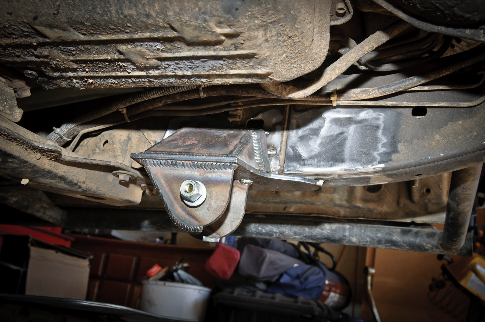

Driver's side control arm bracket

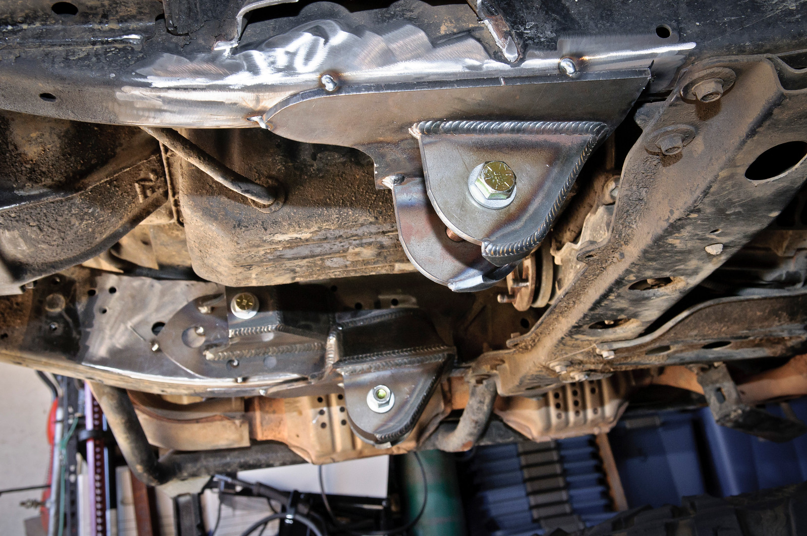

Passenger side bracket that has the 3rd link mount built in. This thing is a BEAST!
