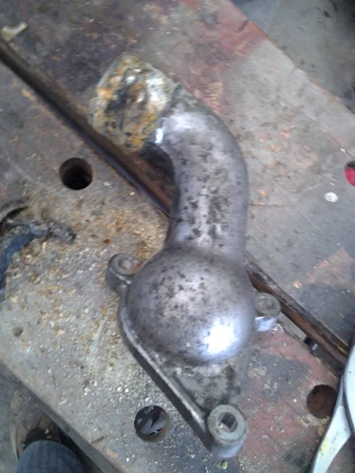

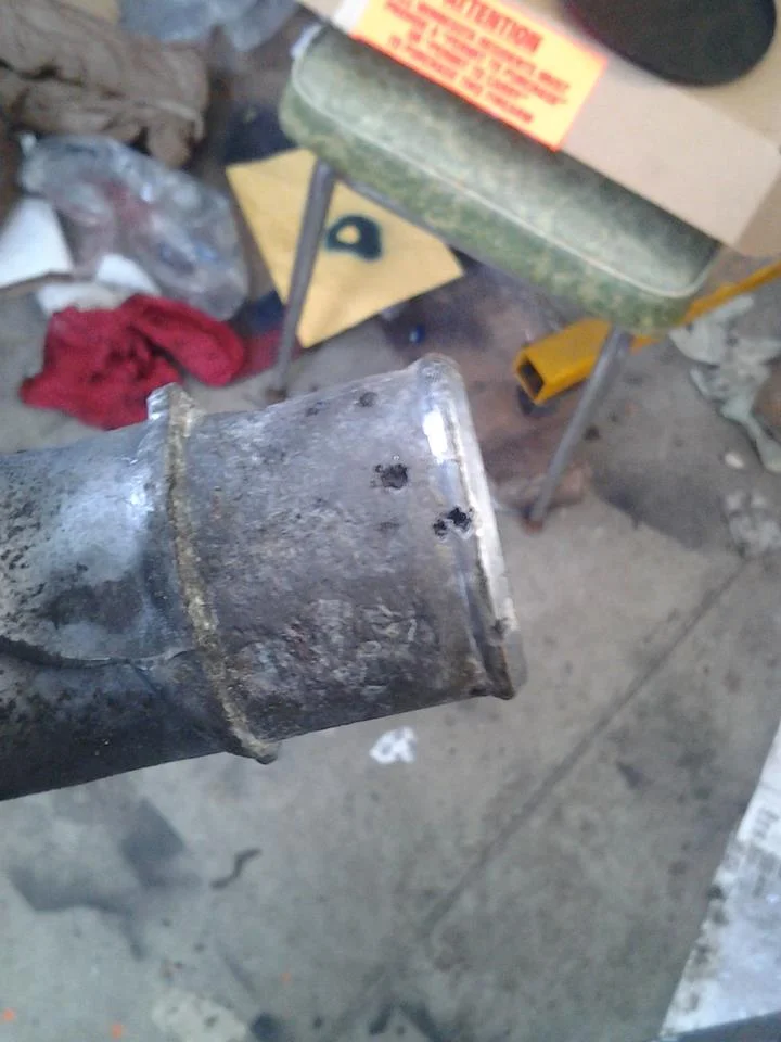

Finally dug into that radiator problem
Thermostat housing wasn't as bad as I thought. I'll make it flush with JB Weld though, just because.

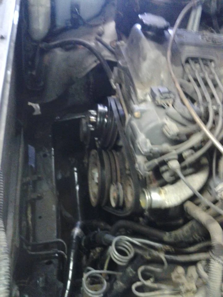

This was a lot harder than it needed to be. I'm replacing the blind bolts that you unfasten through the front with through bolts and a large washer. Not being able to put a wrench on the back side of this made it a PITA. Sometimes I want to slap engineers for trying to be too clever by half.
