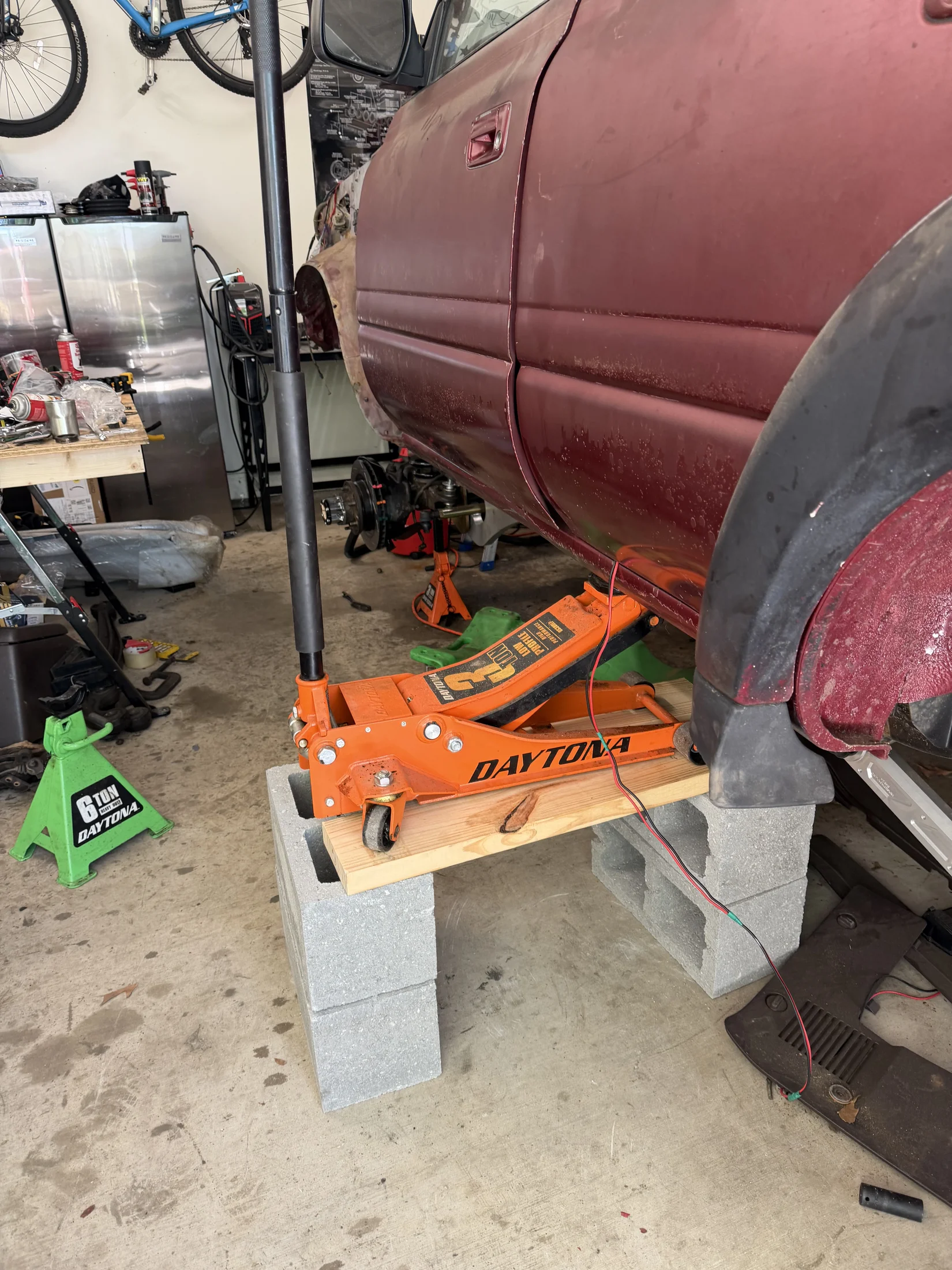

Also ordered all external bulbs (except headlights) in LEDs and cleaned up / put rust reformer on the base of my bottle jack.

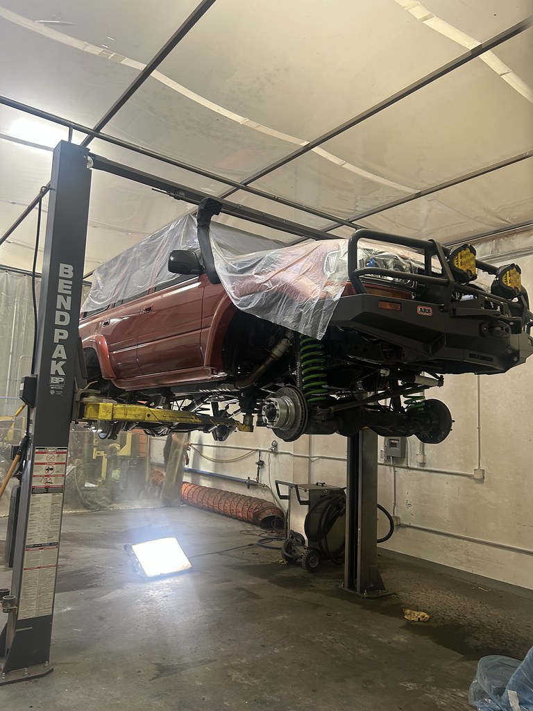

Also picked up drivelines from the shop new OEM joints and balance job along with all new hardware. They even gave her a fresh paint job. Ujoints suck and at $100 a piece for labor its well worth the money.
Getting ready for ice blasting the undercarriage, Raptor-line the wheel wells, repaint frame and cross-members, and have 30-year industrial undercoating applied. Should look close to brand new when done to match the new paint job!
I’m really contemplating doing this also. What’s a rough price point? I would imagine $2500-3k.
Yeah, closer to $4K as added the frame painting and wheel wells otherwise $3K without that. Just saw it after the first pass of ice blast and already looks like new so pretty excited to see it finished. Just in time to hand it back to Johnny and crew @Cruisers and Co for the intercooler upgrade as well as new 4.88 gears!
