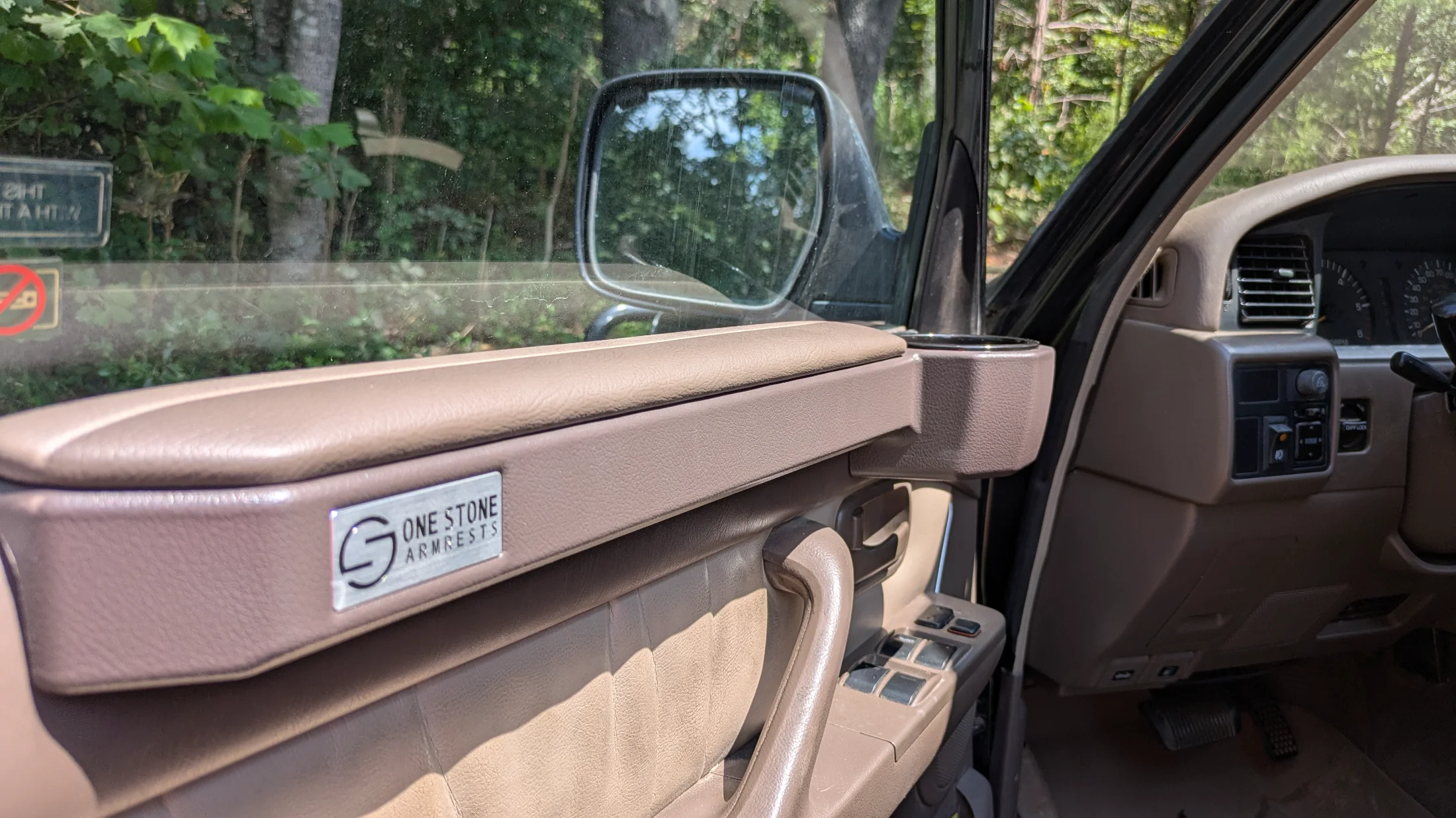

How are they attached? Is it something that could easily come on and off?
Yes. They pop right off. There is a metal plate that hooks into the window channel. They won't really go anywhere even if you slam the door or bump them.
they are sold for the 70 series, so you have to drill new holes in the plate.

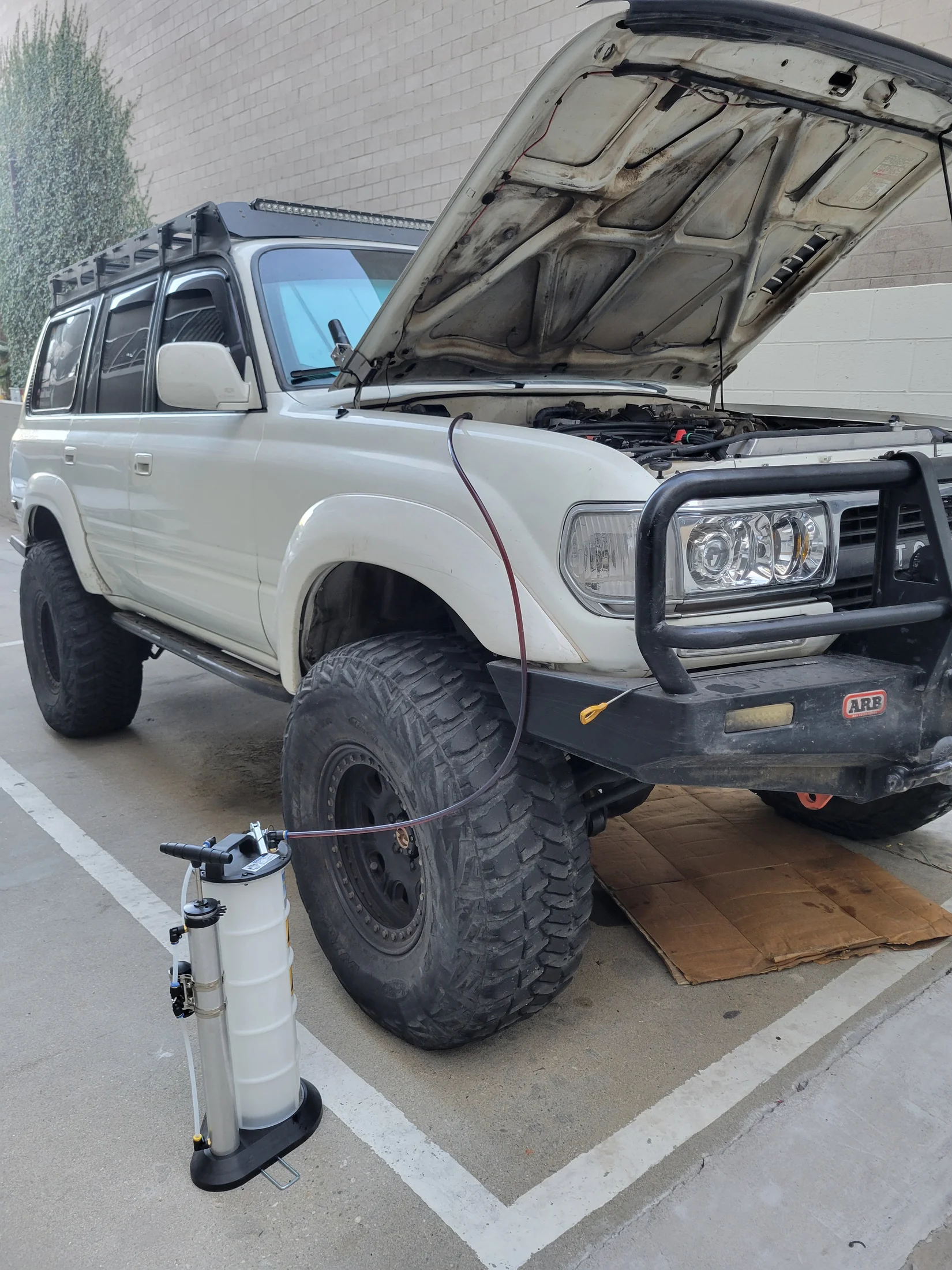

Oil change before the weekend trip. #nomess.
How do you like extracting (assuming thats what I see here) vs draining?
Extracting is a breeze, just make sure you have constant vacuum applied and just sit and watch the process. I happened to overfill my oil so extracting makes it convenient without having to open the drain plug and make a mess. This applies to drain and fill for transmission. diff. TC, etc.

I need this tool right now
Just go to any marine supply store...a mandatory tool for my boat that has the inboard/outboard configuration....without one of these, it would be a motor pull situation just to change the oil!
That's odd to me to see an extractor in use on a automotive engine.
Boat engines are designed for extractors by having the dipstick tube reach to the bottom of the oil pan (because there is no room to use a drain plug and pan to catch oil in the bilge) so the extractor screws on the top of the dipstick tube and pulls the oil from the bottom of the pan up the tube.
I didn't think automotive dip stick tubes go down all the way to the pan...???
Do you feed a small hose down the tube?

Yeah, my boat has a 90 elbow connector at the original drain plug location and a hose that comes up to attach my extractor tube to. I’d expect that the OP feeds the skinny tube down the dipstick tube to the bottom of the pan (hopefully!).

For my cruiser, I take out the drain plug and let the oil dump in an appropriate pan. I can see the appeal to using one of these on the cruiser down the dipstick tube, but I personally love to see every last drop drip out of the pan on my oil changes.
This engine drains so cleanly, I don't see the point of extracting the oil. 🤷‍♂️
People don't like being under it
The Audi and VW folk swear by extractors. But I hate using it. Just put the car in the lift and away I go.
Oil change before the weekend trip. #nomess.View attachment 3979724
So how do you avoid the mess when you’re changing the filters? IMHO this method would leave more old oil, and it’s impurities in the engine as opposed to them being drained out when you’re using the drain method. The drain method may be more inconvenient, but it’s how it’s been done effectively for many years.
Like I previously mentioned, you have to get under the rig to change the filters, so I don’t see any advantage in using an extractor, unless it’s the only way you can get the oil out, like on some differentials that don’t have a drain plug. And I was taught to let the oil drain out for as long as possible to get more of the impure oil out of the engine.
