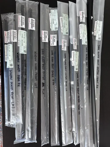

Installing new belt moldings and inner glass weatherstrips on the doors and windows all around. Was lucky to find these in black to match my ride.
