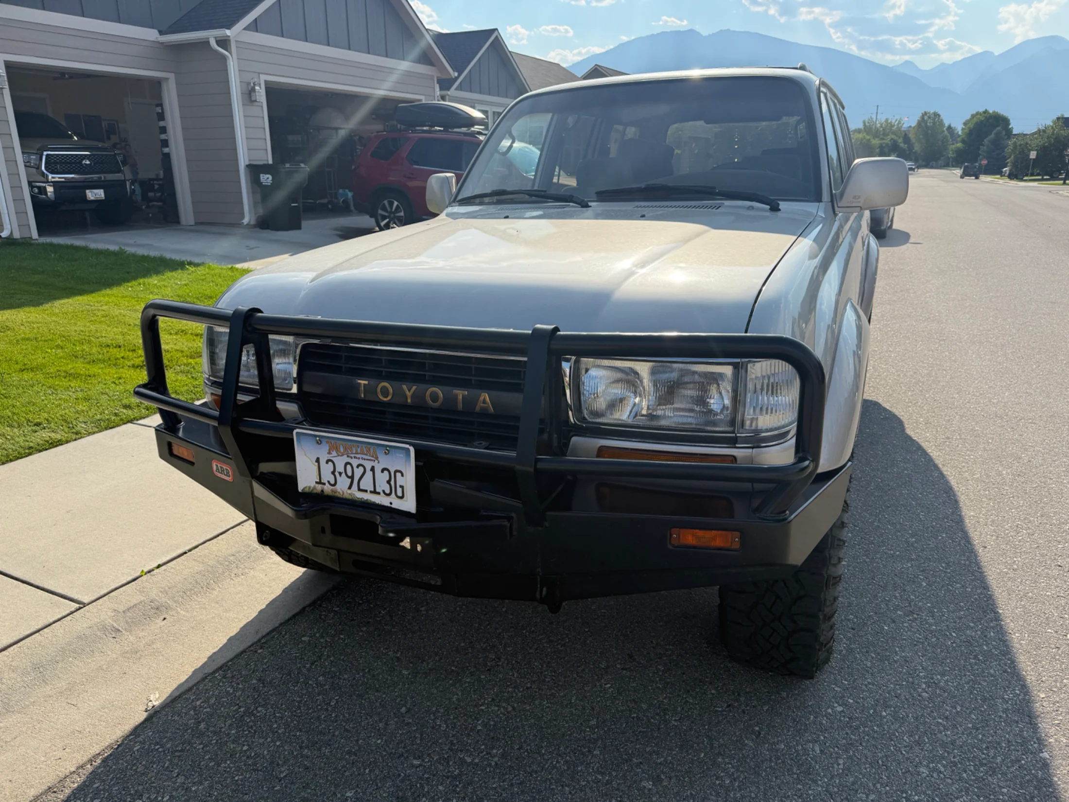

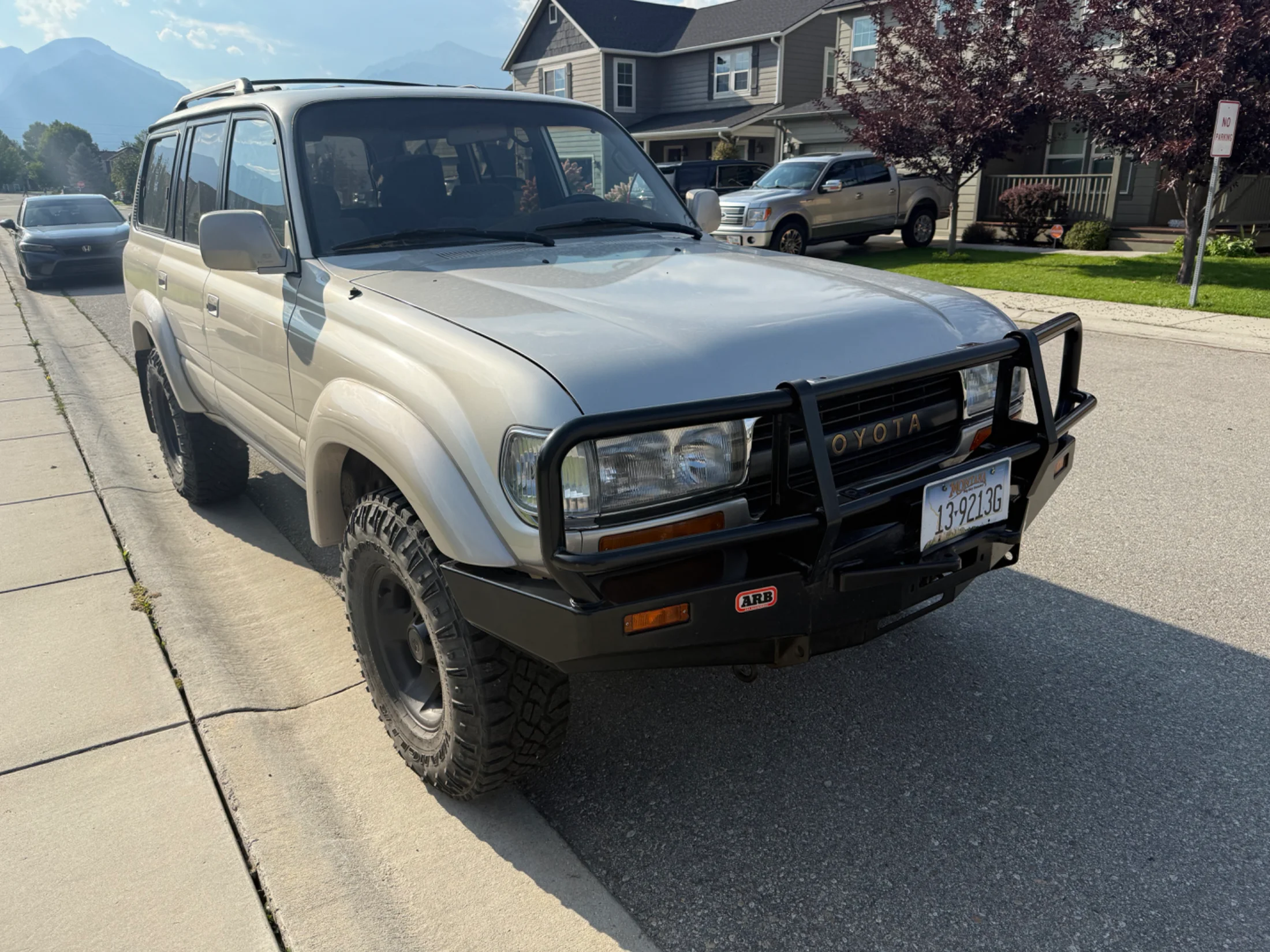

Installed a ARB front bumper!
Which model is this for? They don't list 80 series on their site . Bigots.
It's for the 70 series in oak. You have to drill new holes to make it fit and the magnets don't do anything but it still stays in place just fine. You could use double sided tape I suppose but I don't think I will.

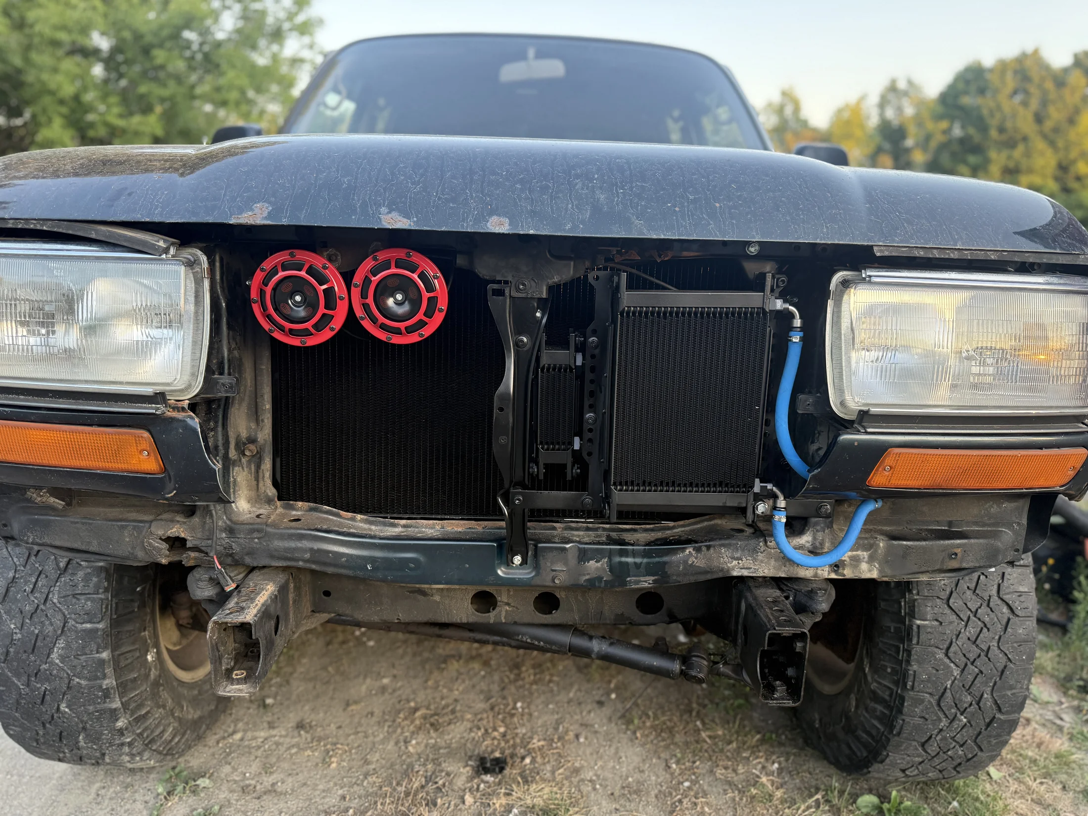

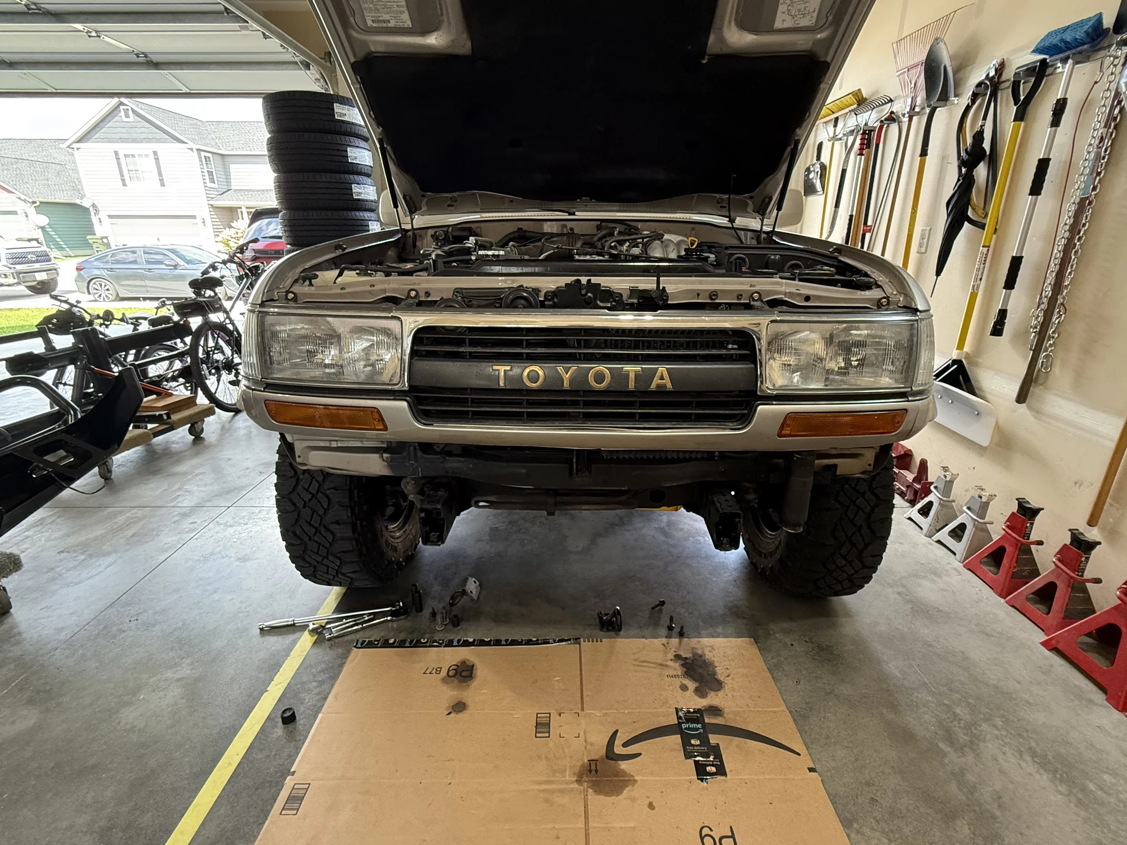

Got my 1994 running after replacing almost every coolant hose, radiator, fan, blue clutch, water pump, t stat, air injection delete, coolant flush (3x to remove green coolant) new power steering cooler, new trans cooler (both custom Setrab units) rebuilt steering box, 555 rod ends, all new oil lines for trans and ps.
DIDN'T set steering box backlash right so it's time to cry alone then take it back out. But hey! No leaks anywhere after replacing all of that
I have a few throttle cable brackets from the 95+ laying around if you need one. It supports the cable where the pair valve used to support it.

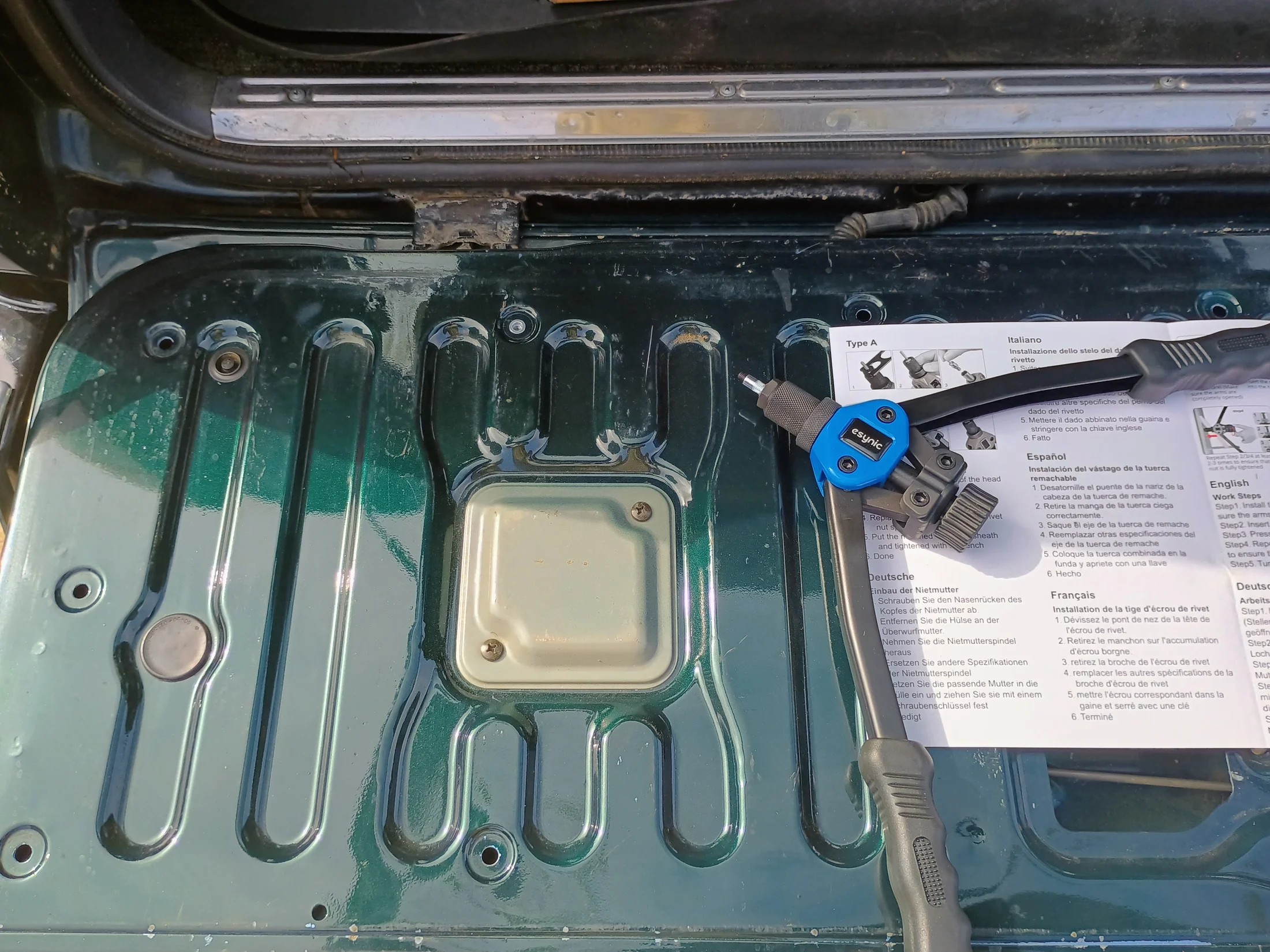

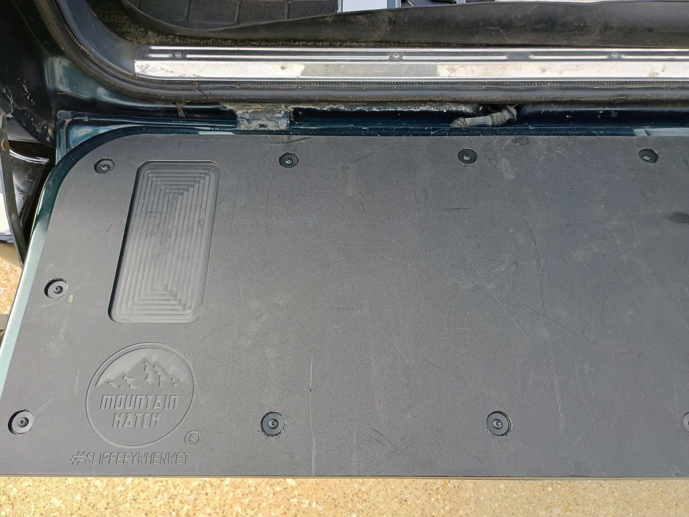

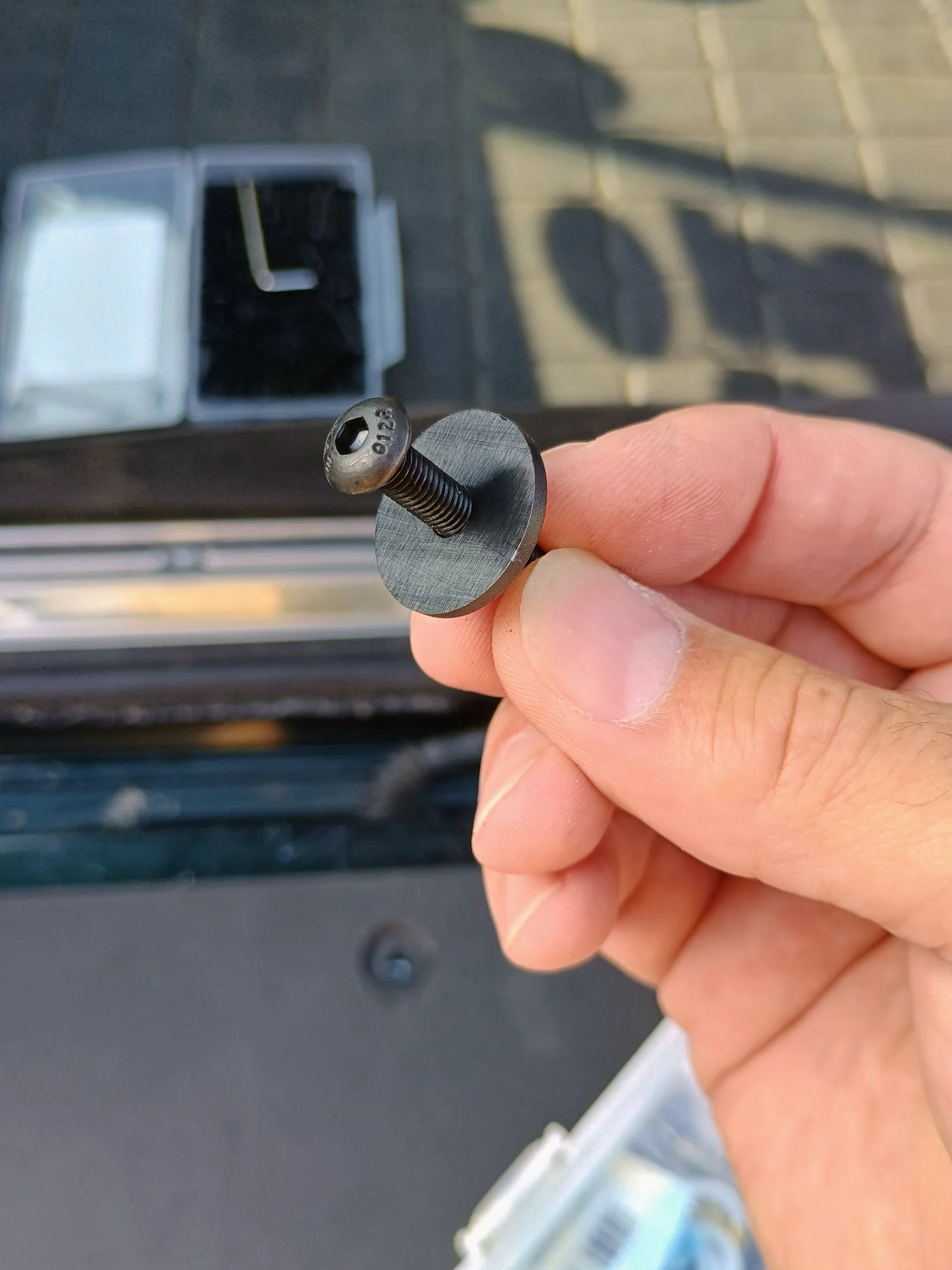

Finally found a good solution for attaching Mountain Hatch tailgate cover more securely.
The vinyl "Christmas Tree" push rivets that come with the cover loosen up over time, especially with fluctuations in temperature. Replacing them is cheap enough, but it's a short-term fix. Wrapping the threads with Teflon tape secures them a little better, but again only for a short while. Slamming the tailgate closed a few times and sure enough, the cover is loose again.
I tried these zip ties that have a sort of toggle bolt end on them, and conceptually it would have worked but they just weren't strong enough and kept breaking.

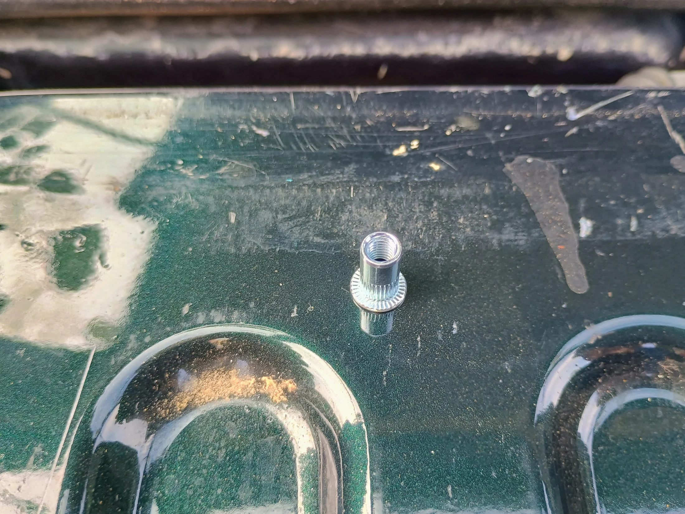

Finally I decided to go with rivet nuts and actually bolt the tailgate cover to the tailgate.
I used M5 rivet nuts and 30 mm M5 bolts with vinyl washers to prevent the bolts from cutting into the tailgate cover itself. It is super secure, and easily tightened should it loosen. Down the road I may replace the bolts with something with a wider head, but for now this is a great solution and minimally invasive.
Never worked with rivet nuts or used a rivet nut tool before, but it's super easy. And now I'm going to be looking for ways to use these things lol.

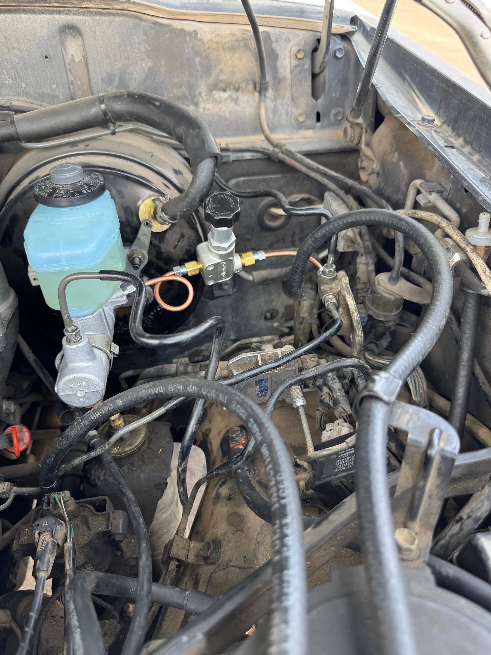

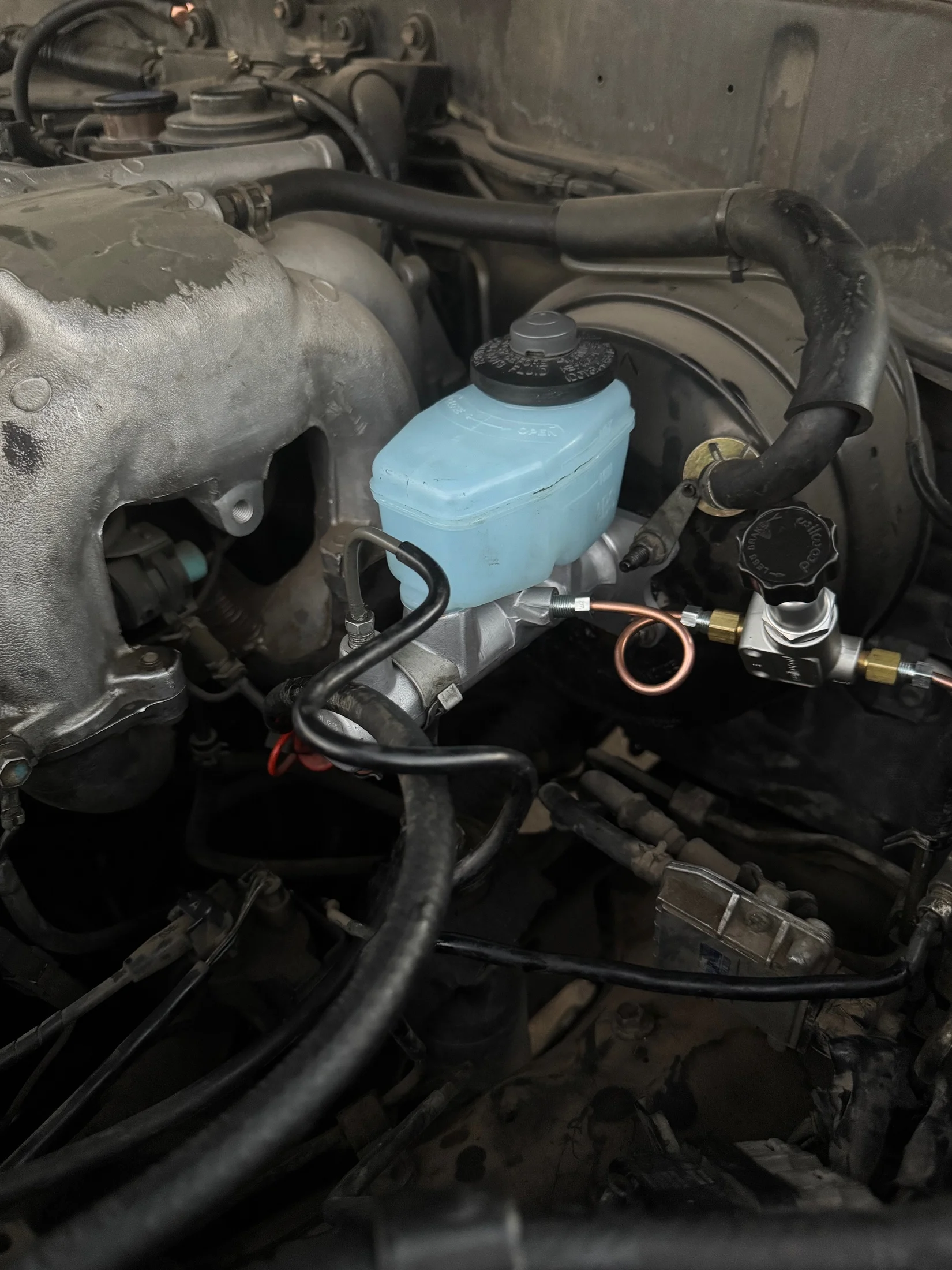

Just finished up replacing my master cylinder and adding the Wilwood proportioning valve. Gravity bleed the master cylinder and vacuum bleed the brake lines. After bleeding the brakes I drove it around and the pedal was soft. So after adjusting the Wilwood down aka adding more braking power the pedal got harder. So I tightened it down fully and backed it off a full turn. The pedal was rock hard, I will continue to adjust the Wilwood as needed. My plumbing is not as clean as @jcardona1

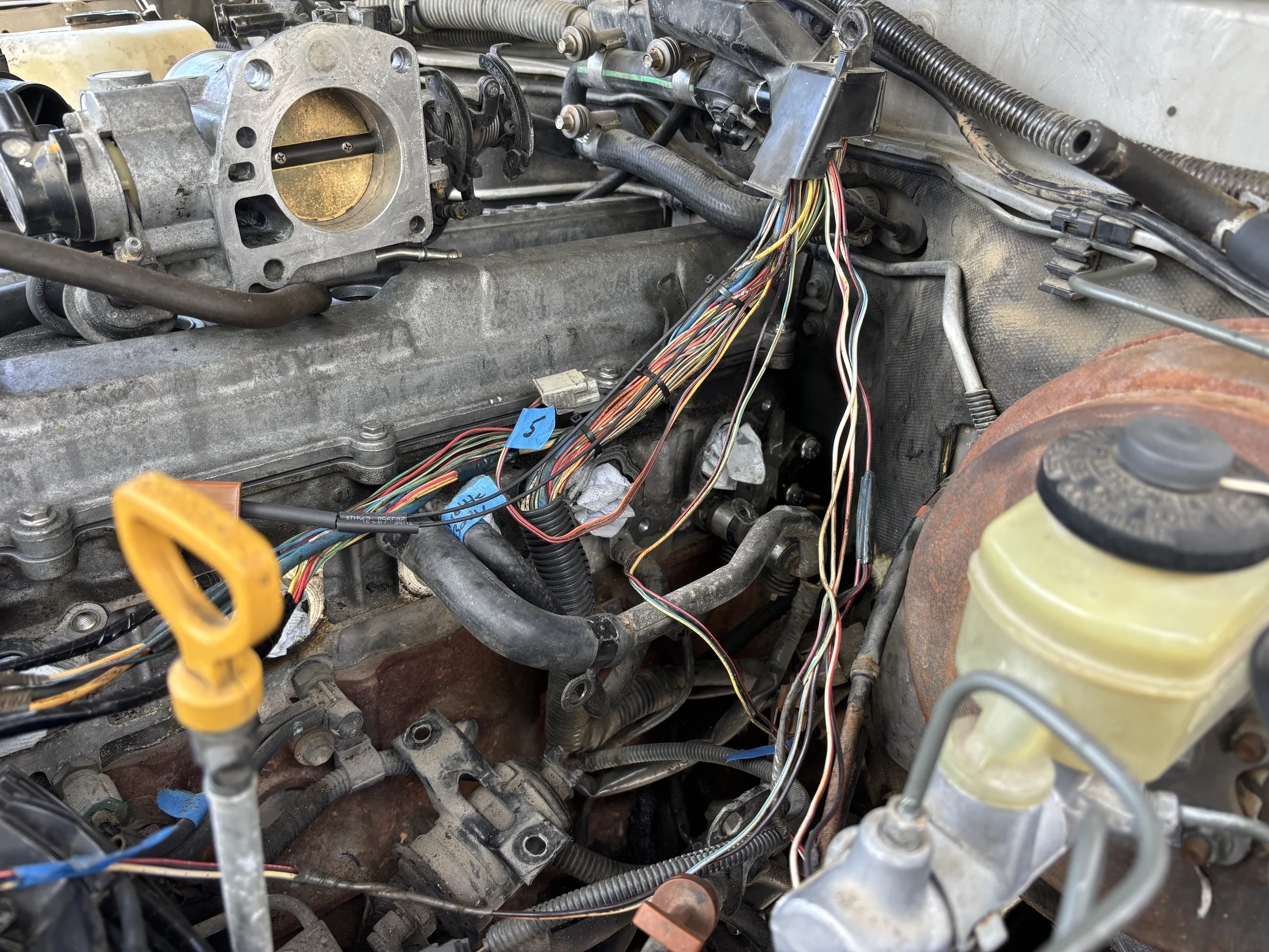

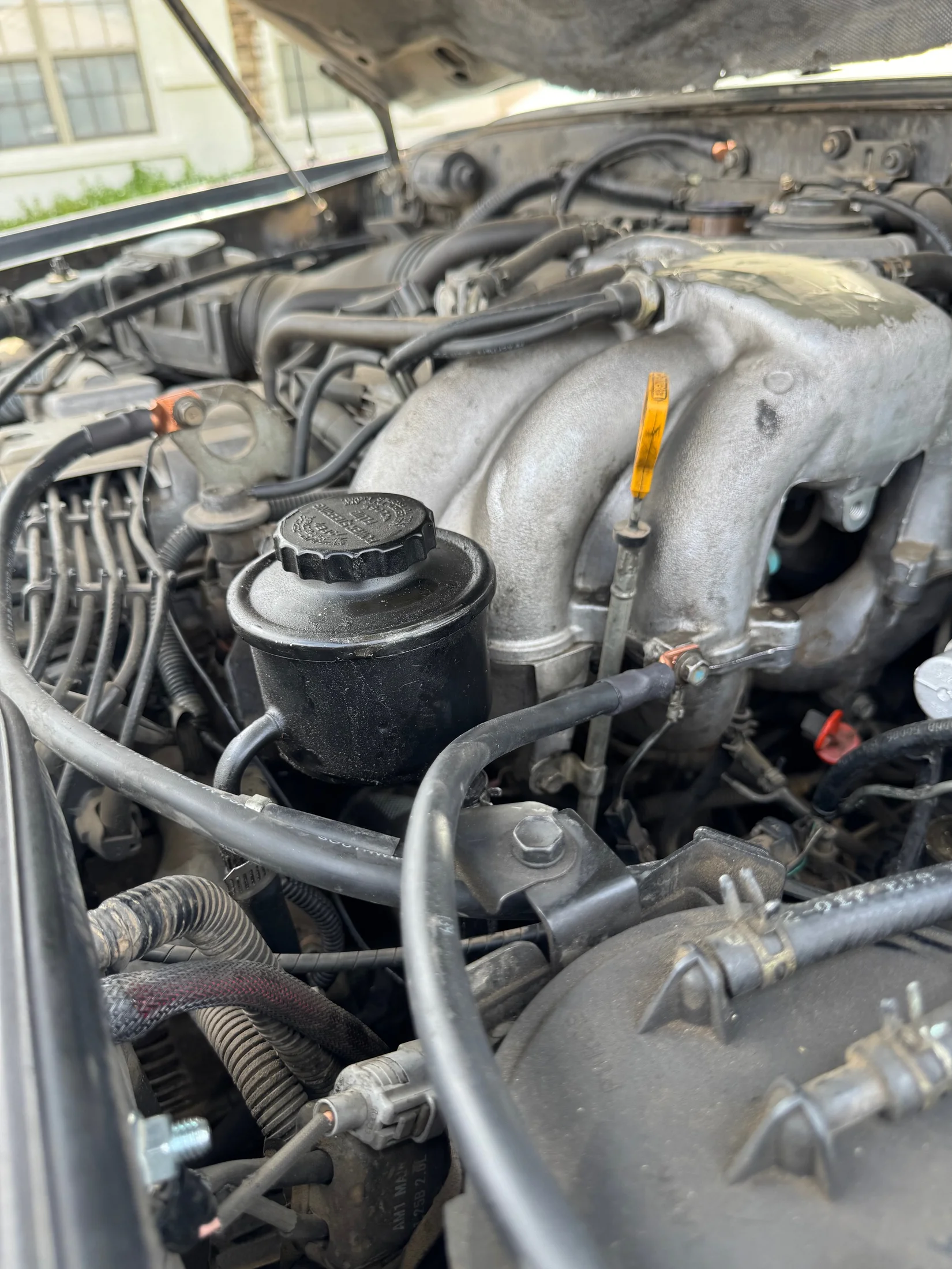

I am honestly embarrased by the birds nest my engine bay has become after moving around brake lines and adding a few new grounds.

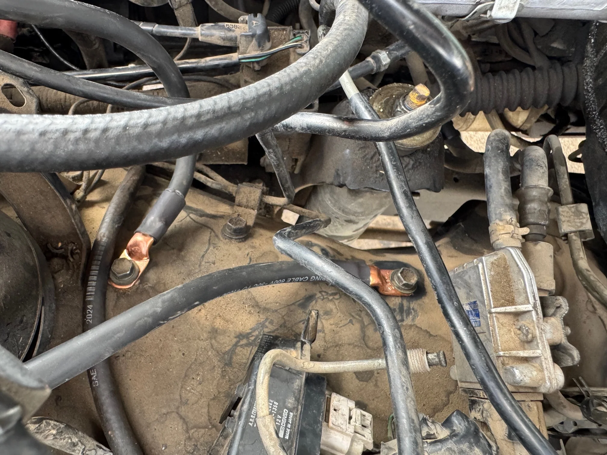

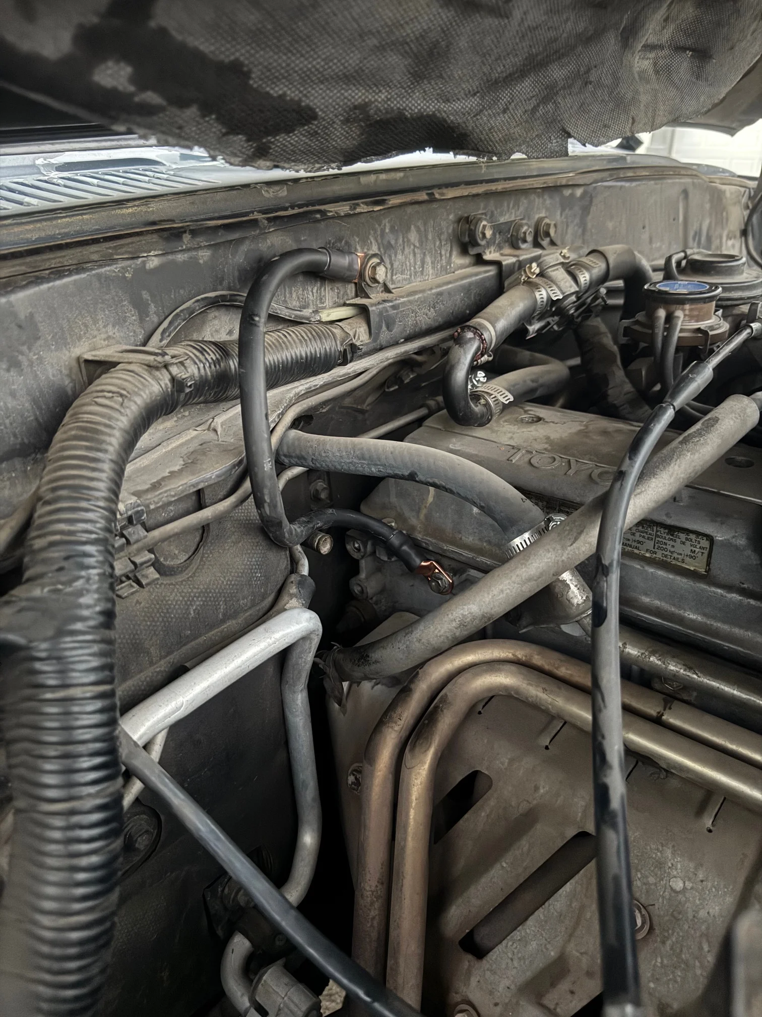

The next few pictures are of my upgraded grounds. I replaced the head to body ground with a 1 gauge wire.
Then I augmented the factory grounds from the lifting point and from the intake to inner fender.
