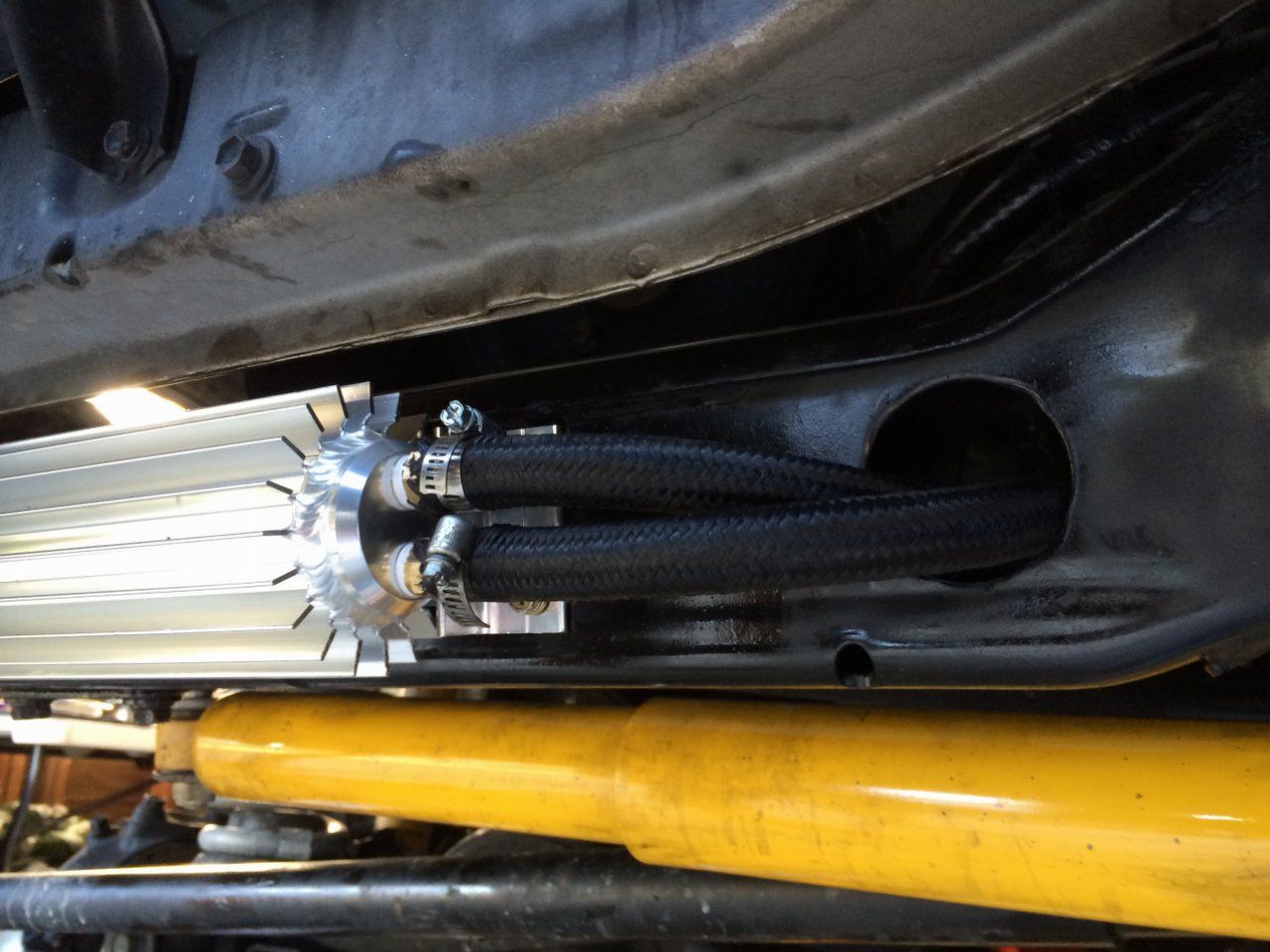

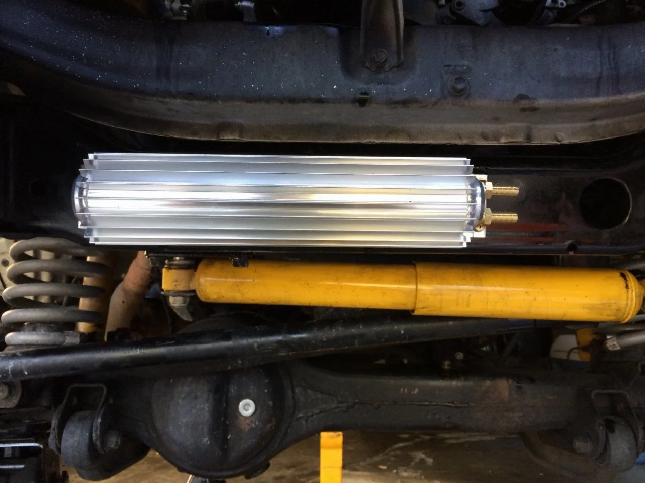

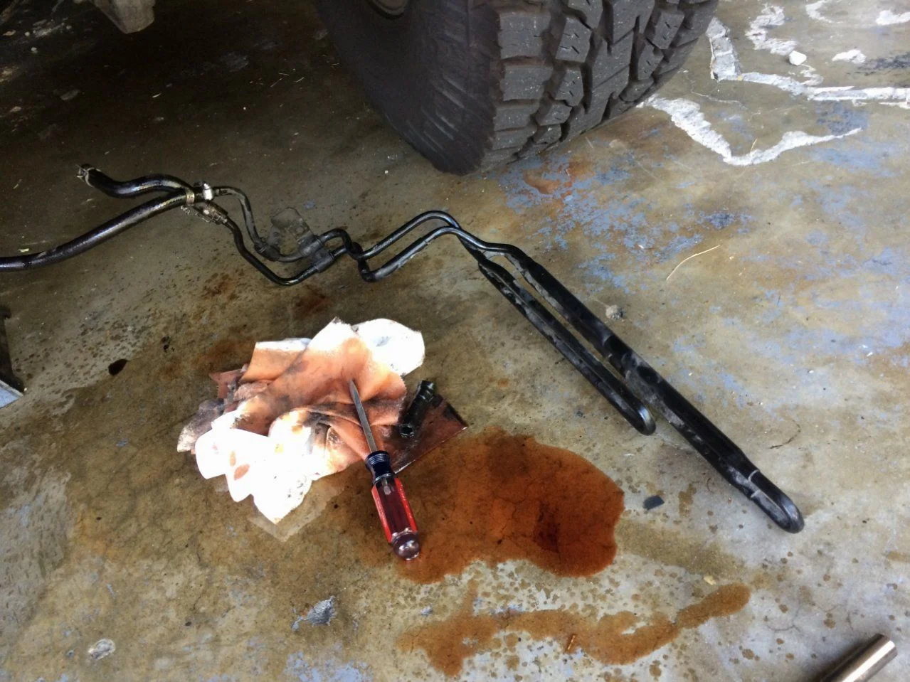

View attachment 904283 View attachment 904286 View attachment 904287 View attachment 904288 Oh and since I had everything open I replaced the paperclip with a Delare cooler. The hoses were hard as a rock and just crumbled. Glad I changed these out with good high pressure hydraulic hose, even though it's only low pressure.
I see you mounted that cooler where the high pressure hard line was, what did you do with the high pressure line? Did you just run a hose all the way from the steering box to steering pump?
Despite being a hardline, it is low pressure and uses constant tension clamps at the steering box and at the reservoir.
