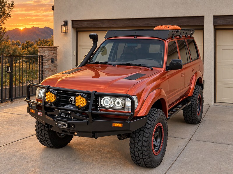

Didn’t expect to get hard at lunch but here I am erect and ashamedThat burnt orange is amazing!

Awkward boners are a thing…Didn’t expect to get hard at lunch but here I am erect and ashamed![]()

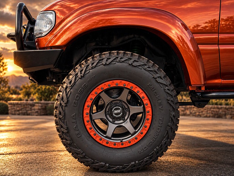

Yeah, don't have it down yet. I asked to enhance my NM dusk setting and got this and thought "wow, better than the real thing"...lol.Cool AI !!!!!![]()
