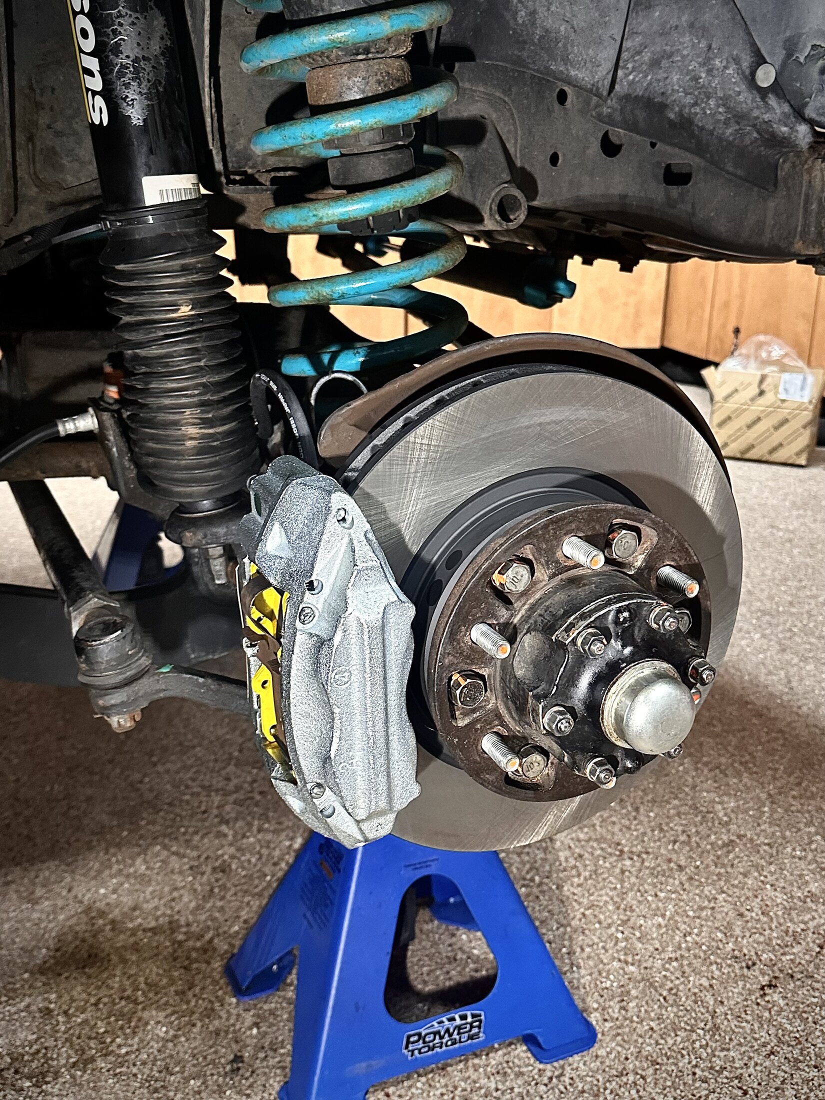

Completed a full brake pm. And new races/bearings/seals.
Everything new from booster back except hard lines.
Found a few interesting things;
-new mc failed out off the box
-Aftermarket ss lines that just spun in their bracket.
- inner rotors worn more than outer
-no shims in front pads
-rear bearings had zero grease. Just gear oil
-front bearings had grease but it was black
-most notable improvement in braking came after replacing booster to intake hose.

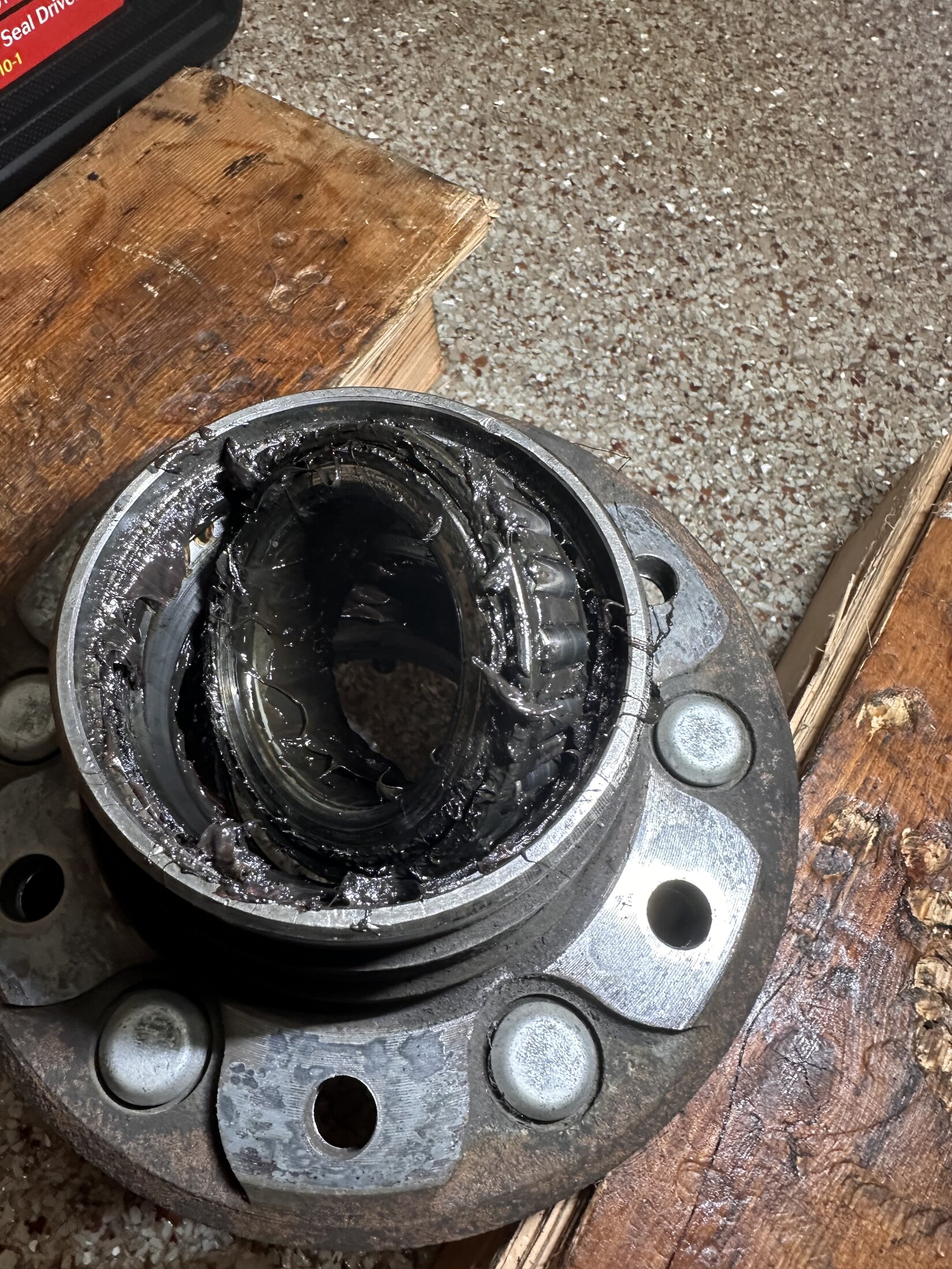

-most notable improvement in braking came after replacing booster to intake hose. View attachment 3919057View attachment 3919058View attachment 3919061View attachment 3919062View attachment 3919063
Second Picture, the spindle looks like the bearing spun on it. looks like it should have been replaced ?

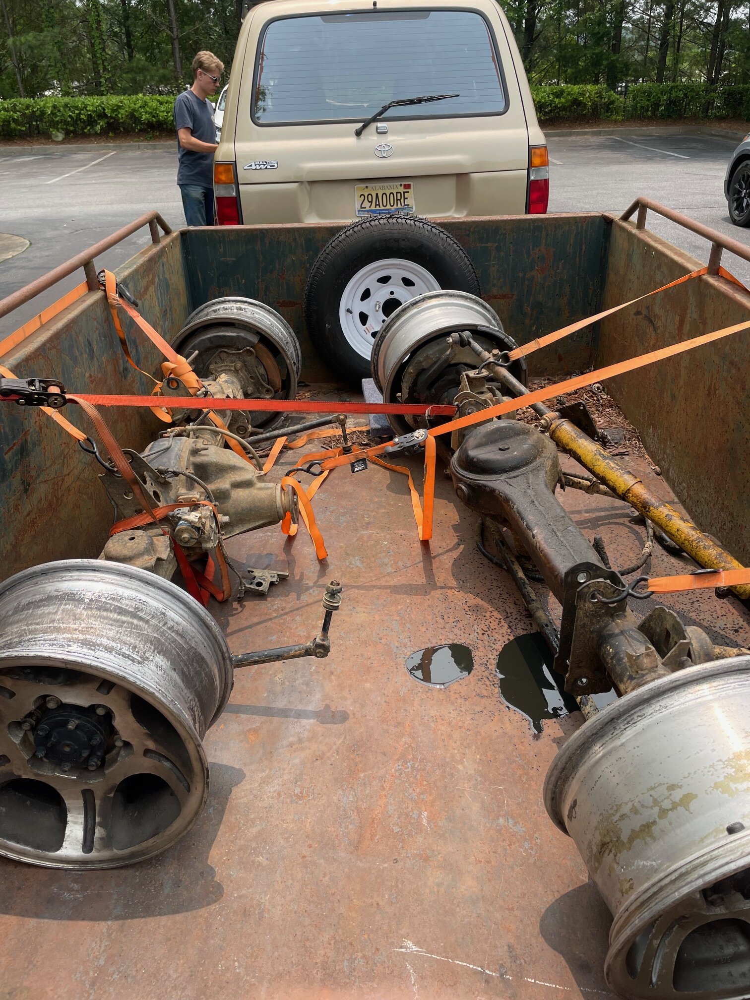

Quick story about a salvage yard selling an axle, this place Grahams Auto - https://www.grahamsauto.com/ which is only ca. an hour from where I live. The 80 I'm currently working on is unlocked and I would be satisfied with only a rear locker. Graham's had one listed on Car-part.com for $1000. I call and talk to the owner. His first question is, "What's wrong with your axle?" Nothing, I just want an extra. I ask what the total would be. His reply $1000 + 650 as a core charge. No thanks. Next time I check Car-part his price has gone up to $1650 on this axle. Just checked again and it's now up to $2850. Guess he's in no hurry to sell it. :lol:
