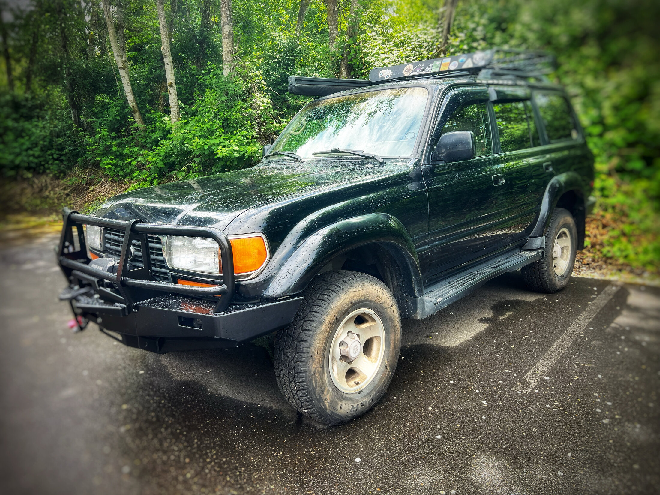

Updated the front bumper to an ARB and added the Apex Badlands 12k lb winch (synthetic rope).
The winch was a PITA to get mounted properly…I was happy to have people who knew what they were doing and help.

All these ARBs. My ARB wasn’t up to the task so I have it removed and making it better. ARB 2.0 in the pipeline.
She’s growing up so fast!
I bought that same winch as a placeholder until I could afford a nice Warn…. I’ve used it a few times now and like it so much that I may just leave it.

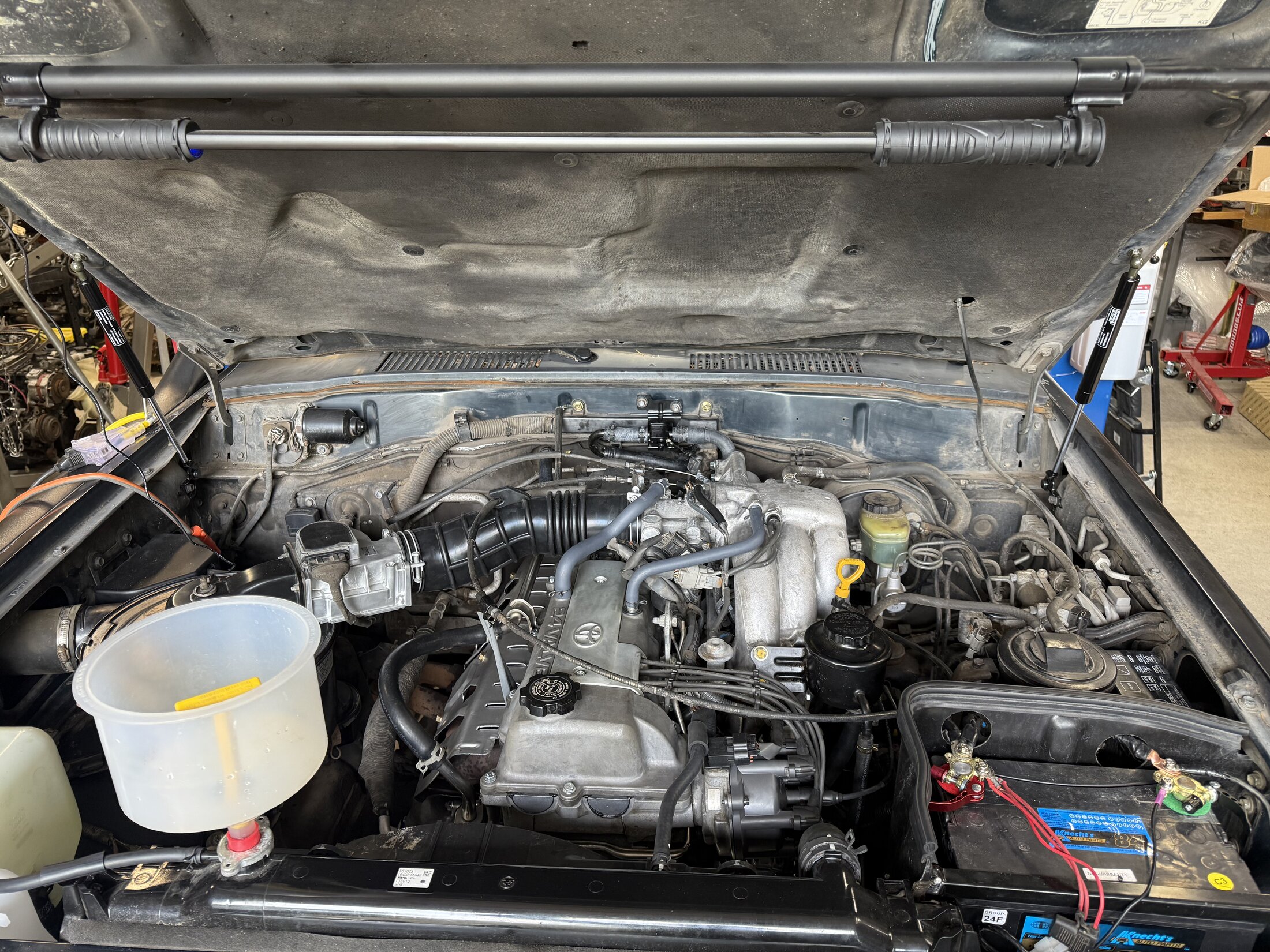

Replaced all four transmission (A442F) solenoids with help from @6th Gear 's excellent video here:
She now shifts flawlessly and I gained some power back as well.
For background, truck started intermittently not wanting to downshift to low at idle several months ago. As time went by it stopped shifting automatically at all, but would shift great manually and no other issues I could observe. No codes, OD light worked, ECT worked, no codes. Everything I read here and elsewhere suggested solenoids, but I started the TS process by changing the fluid and checking/cleaning all external contacts. No love.
Thanks to a suggestion here on MUD, I ordered the Isuzu part numbers (same OEM Aisin solenoids but cheaper than Mr. T parts). Paid $177 all in for all four shipped. Also got Aisin OEM grade FIPG from Amazon.
The day after I ordered the solenoids, the truck finally threw a transmission code (code 62, pointing to #1 shift solenoid).
The job was not "complicated," but it was messy, time consuming, and challenging, mostly due to the accessibility of three of the 20 10mm bolts that hold the pan on. Took about 6 hours with at least an hour of that fighting with those three bolts, both on and off. And some down time waiting for the fluid to completely drain (beer break).

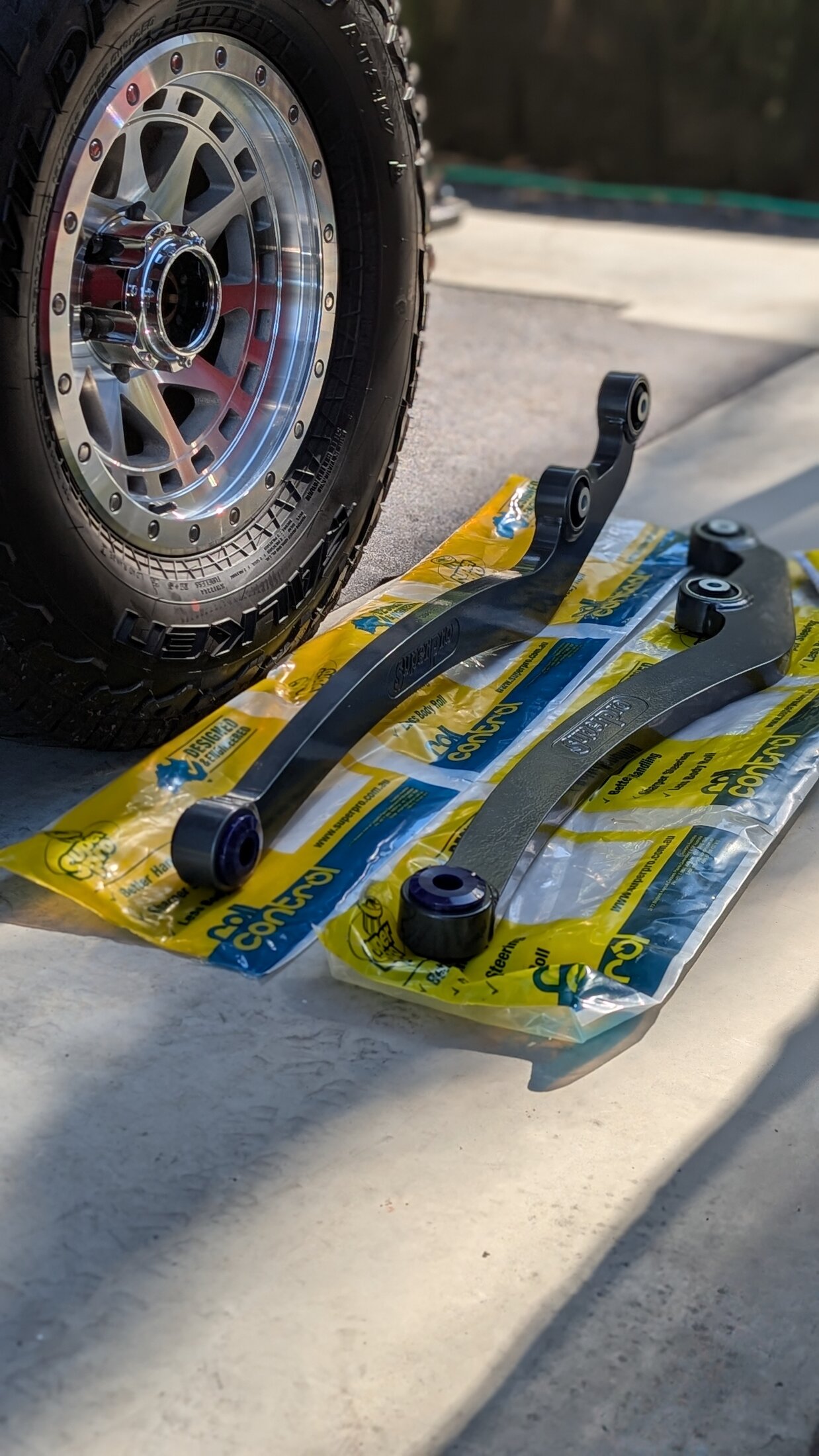

Installed new radius arms to my HZJ80 and removed the caster plates as it had excessive caster and causing diff spring perch to upper spring seat misalignments that affects spring rates due to springs being bent constantly.
also was looking to give the diff a slight push due to 315s on a 50mm lift.
ended up using these Super Pro arms. Updated Version of their (previous designee) that i was eyeing off for a while but once i could get my hands on there new ones Part Number (TRC1216) i haven't see many people using them from what i can find from Facebook pages eg . thought id give them a try was going to go the Blackhawk ones but there on back order and getting these for around 450$ off retail price i couldn't go past the deal . plus this will suit my needs with a 50mm lift . "These arms will do 50mm to 75mm or 2-3" (note there is a set of arms that suite 4" and bigger lifts) .
4° of caster @ 50mm
2.5° of caster @ 75mm
(Potentially could run the 4" arms at lower lifts eg 3" 75mm to gain more caster)
They have a polyurethane bush at the chassis end with two options for offset tube or concentric inner tube and genuine style rubber bushes on the diff side with the caster built into the arm . 80/105/70s
i ended up getting some photos of the before of how bad my spring alignment was and a few photos of the stock arms overlaying the new super Pro arms.
the arms where identical length from chassis bush to first bush on the arm but you can offset the arm up to 12mm by using the offset bush tube . that was just the amount i was looking for with my size lift Tyre combination.
Thought I would post on here for people that didn't know about them or where interested in these arms.

Nice radius arms but they are pricey compared to Delta or Trail Tailor radius arms. And both offers longer lenth over stock to allow for bigger tires. Did you considered Delta/TT?
I couldn't add anymore photos but this is how the caster plates made it sit with only 50mm lift definitely not really that practical it definitely works but would go the caster correction rubber bushes in the stock arms like we did with my misses 2002 GXL HZJ105 on 50mm liftView attachment 3914932View attachment 3914933View attachment 3914935View attachment 3914937
I did look into Delta arms but unfortunately from me to ship them here to Australia would have cost me a fair bit in shipping also being able to purchase the superpro ones via my trade account from my local automotive parts store and have the lifetime warranty on there bushings and I have run superpro bushings in my personal cars before and customers cars with awesome feedback and quality I thought they would be the right option for me and seeing 35" are pretty much illegal in Australia and my state I don't think I will be going any bigger in tyres or lift size so the small 12mm push is all I needed . Cheers brad

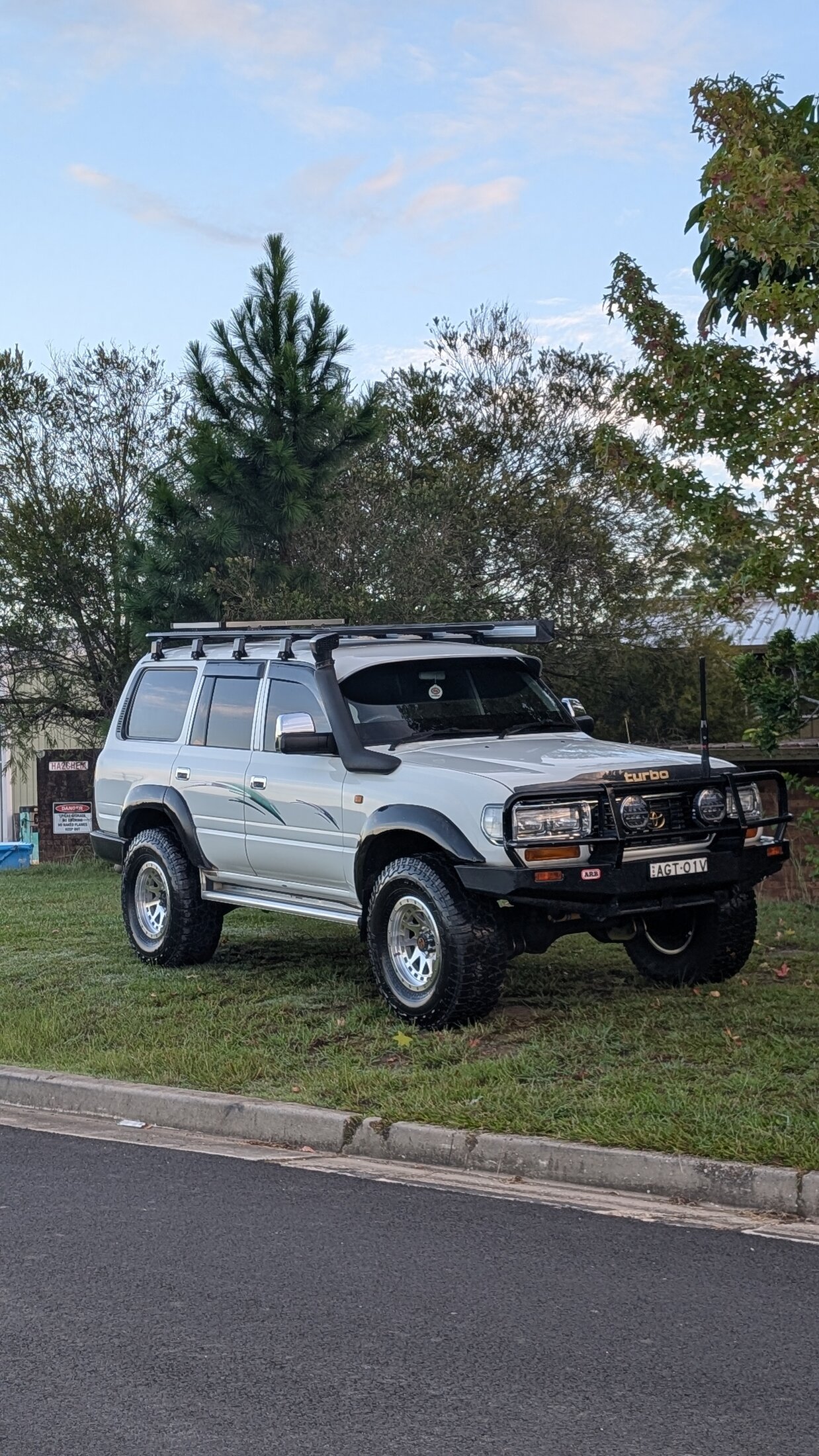

I really like the looks with that visor. It almost has an airplane cockpit look for some reason. Anyways, a sharp looking 80!
Just curious.....how does it drive high speed ? does the windshield visor acts like a parachute? I know there is an opening for the wind to pass through but is that enough at 70+ mph? (113kmp)?
Thanks I didn't actually install it , the old guy I brought it off installed it and I believe it's made for the 80 series , some people over here in Australia 🦘 use the visor off a 79 series UTE (Truck) and apparently trim the mounting bracket and they fit also but they really bow alot higher in the center from memory , it's very common in Australia to have a visor on almost everything 😂 a lot of your Ford falcon and holden commodores mainly the Utes the young fellas put them on , but yes pretty common over her on the 80 series to fix a visor.
Also there is a Australian company that hand make visors that are like the truck Kenworth style or like a peter built style drop visor he is called (triple SSS sunvisors) he is on Facebook.
