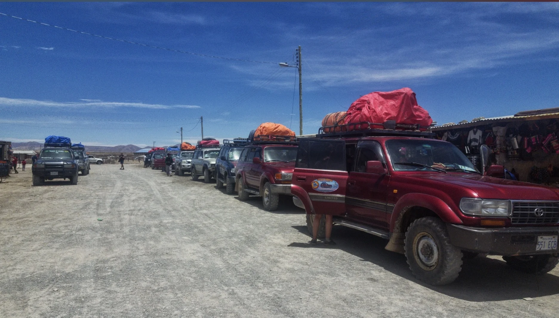

Ok, not me. But am planning a trip down south. Want to hit Uyuni in my cruiser and drive the flats. Has anyone here done that in their cruiser? Someone said all cruisers go to Colchani, Bolivia.

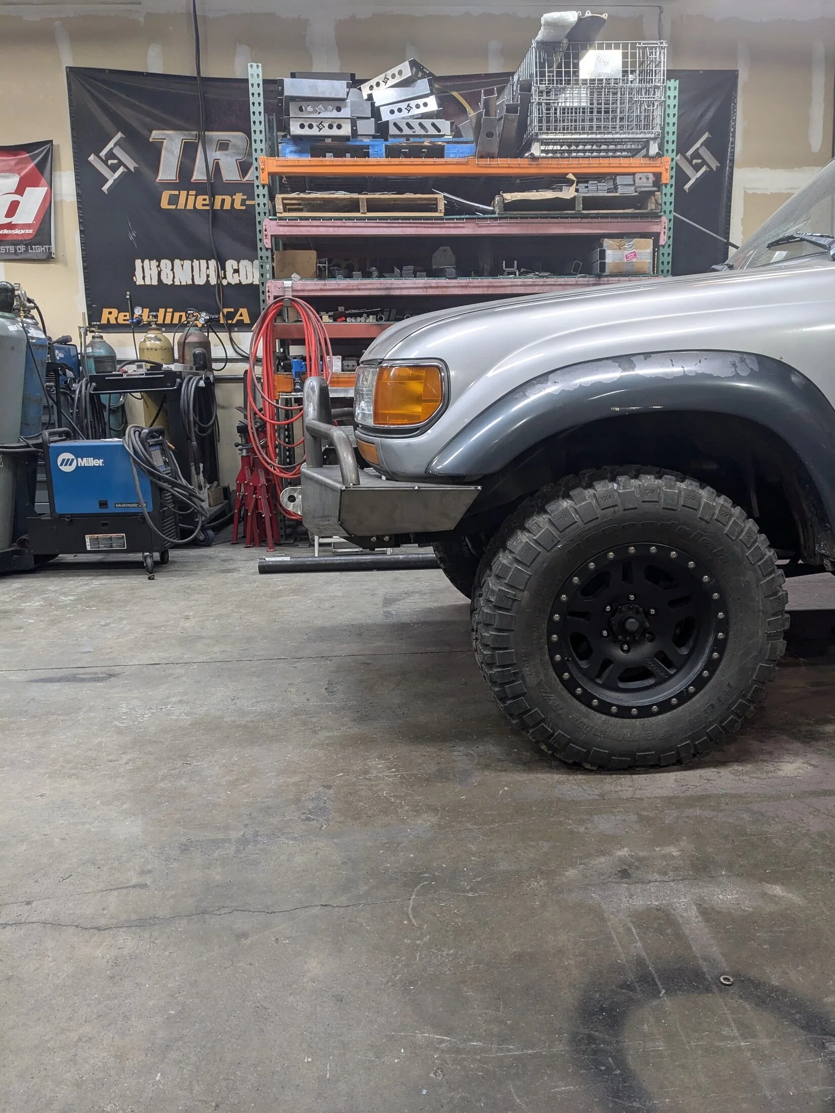

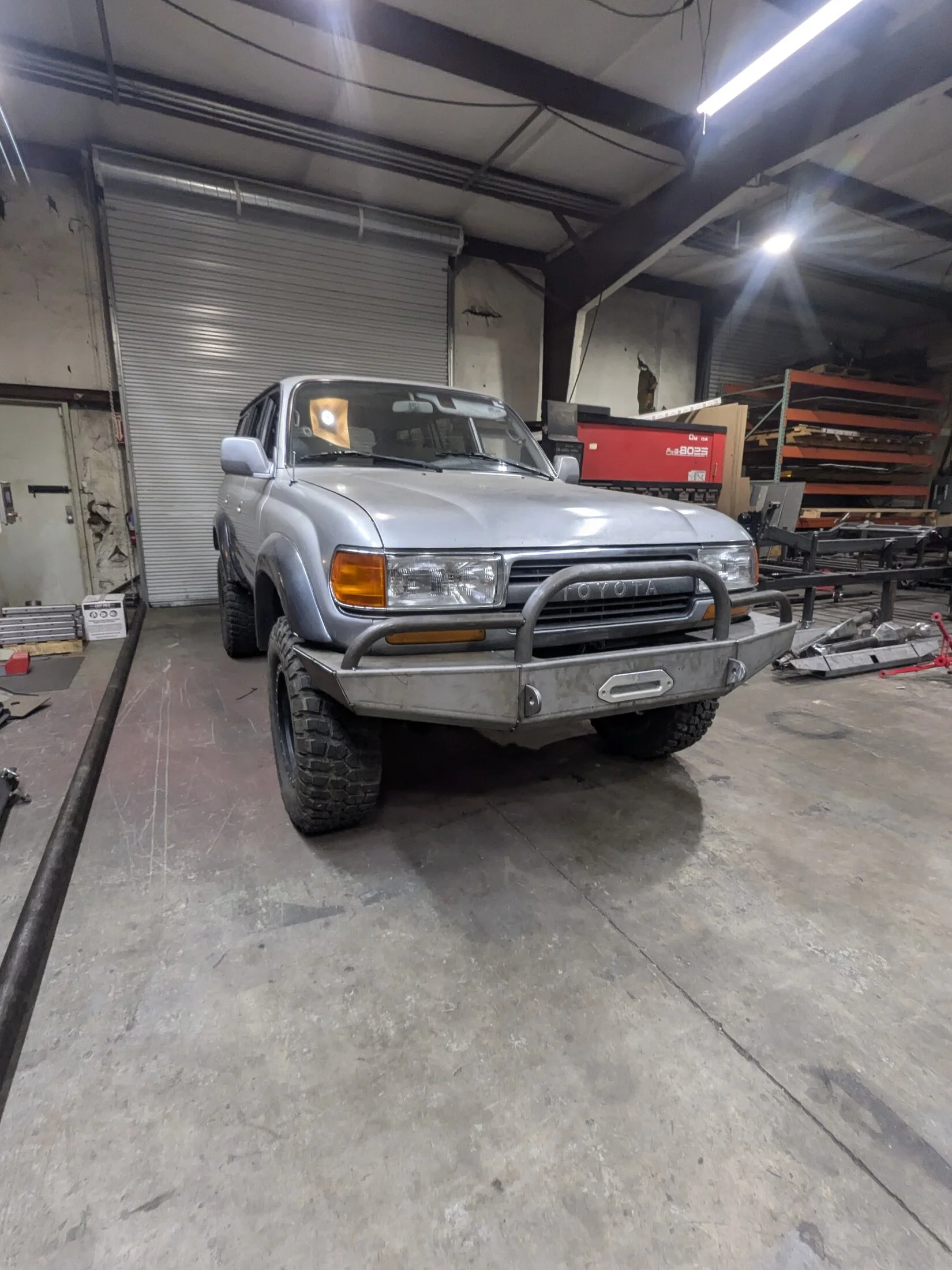

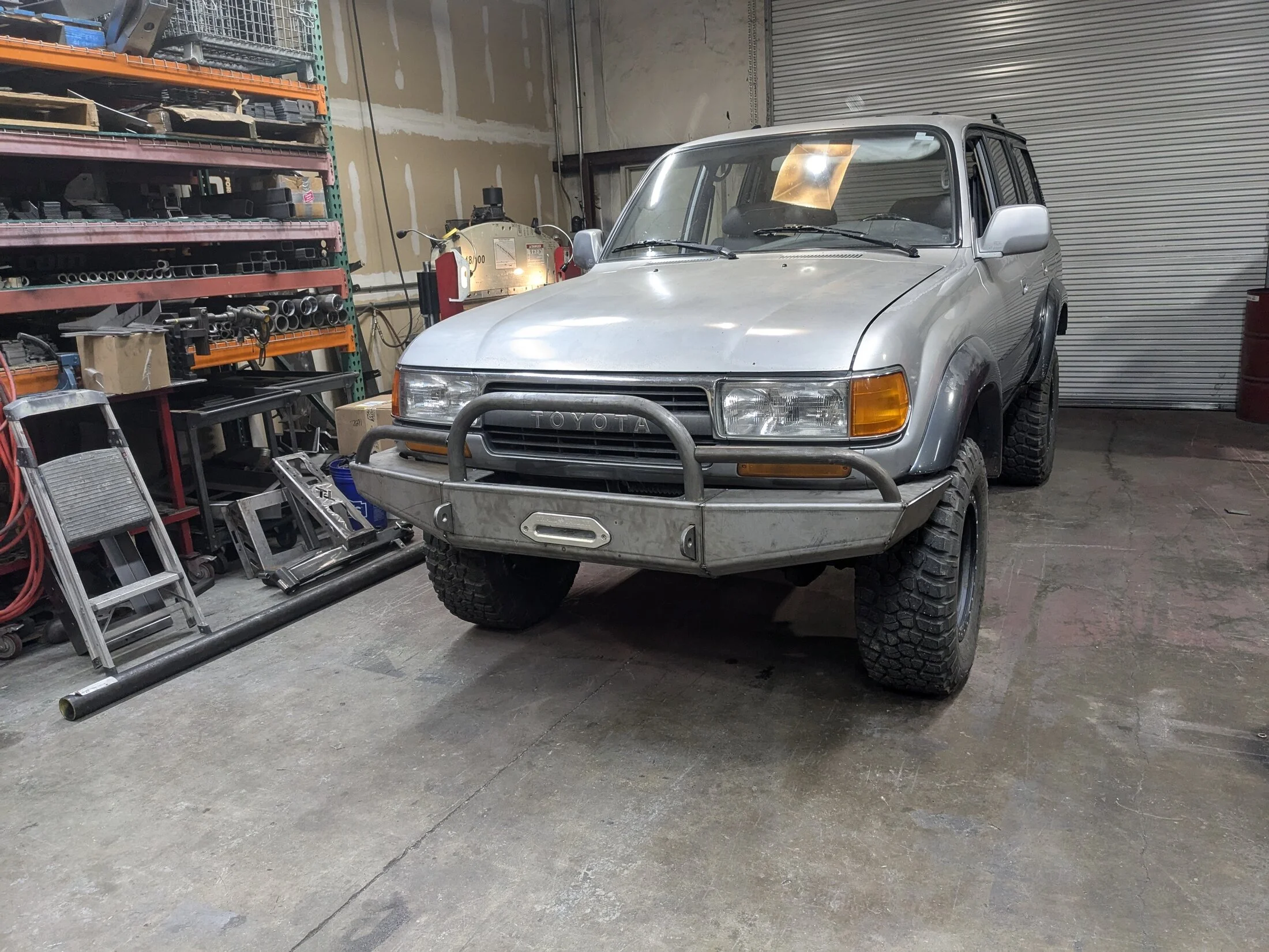

Any frame mods/cutting needed for install of the front bumper or is it just plug and play?
FRONT is plug and play. Remove the stock bumper and brackets and install mine.
REAR keeps the rear crossmember but have to notch the lower portion to accept the 2" hitch receiver. Other than that, its plug and play from there out.

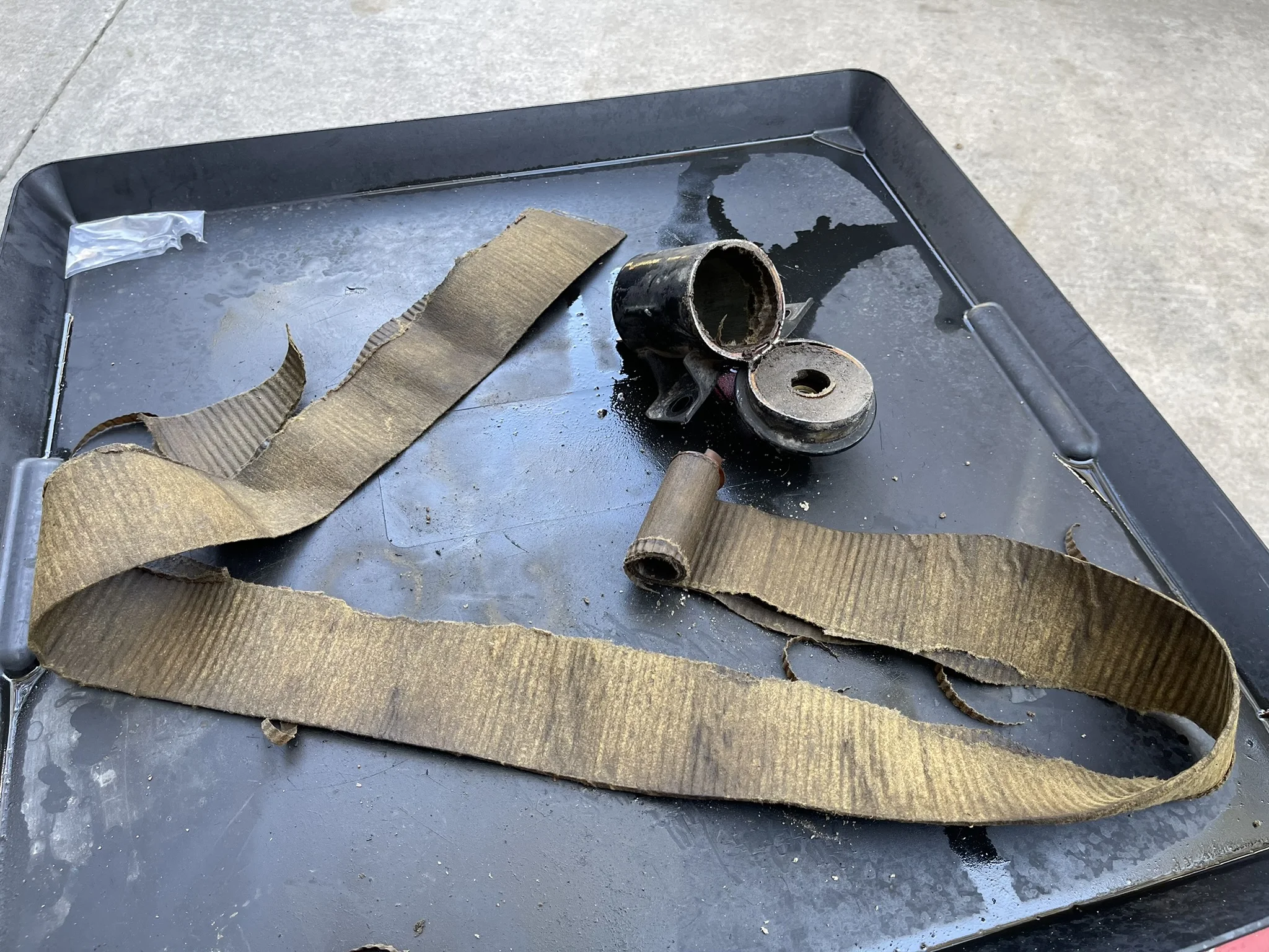

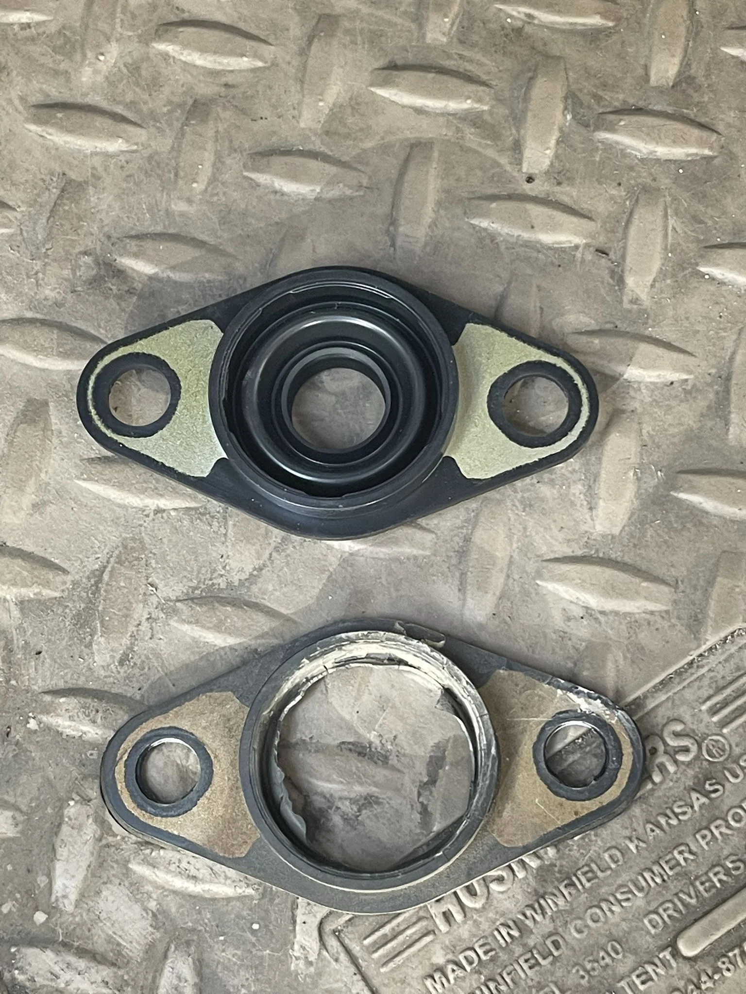

Probably the original steering shaft seal and fuel filter. I replaced my shift indicator with a nicer used one when I bought the truck, but found out they still make the 93-95s(?).

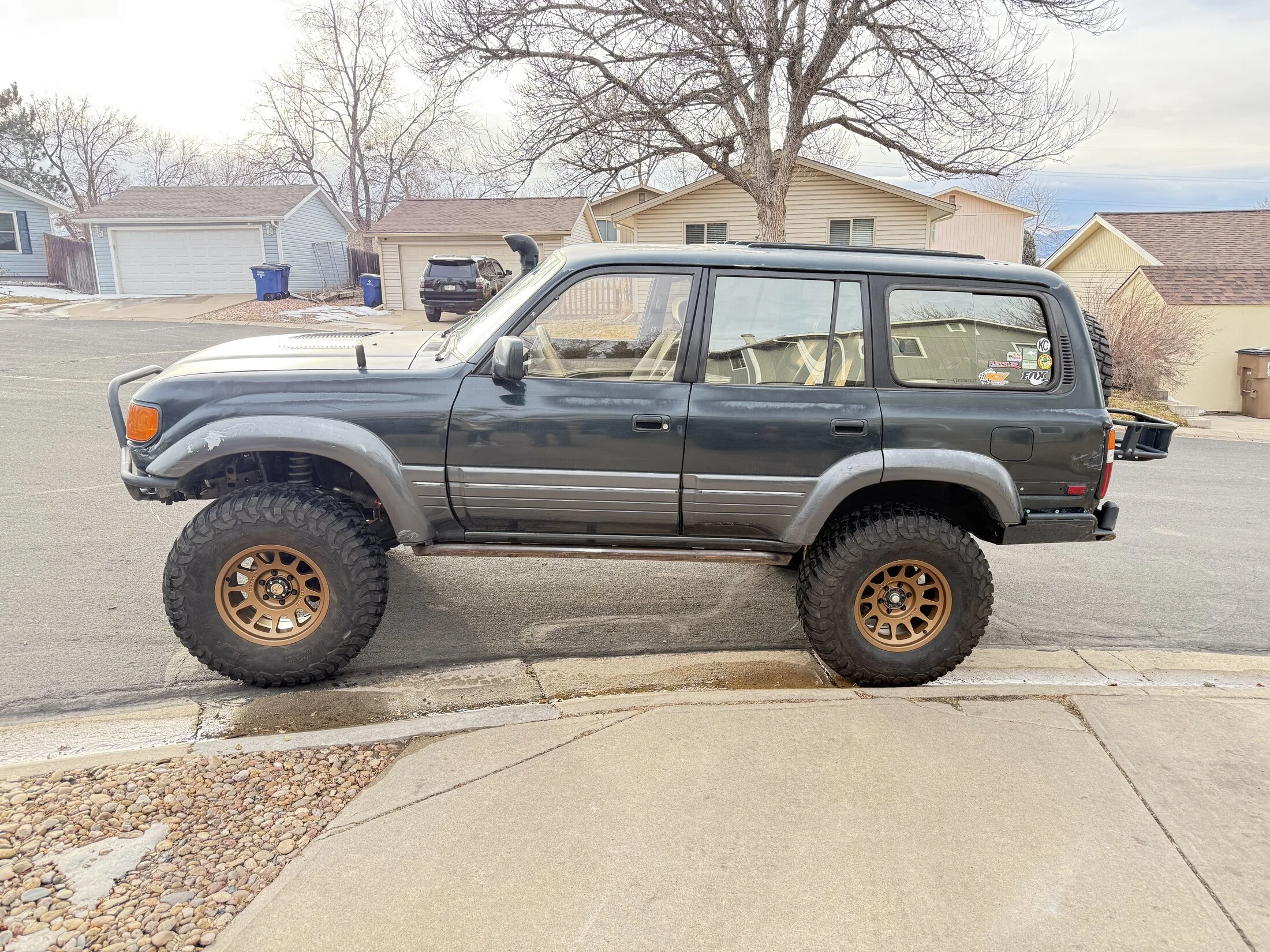

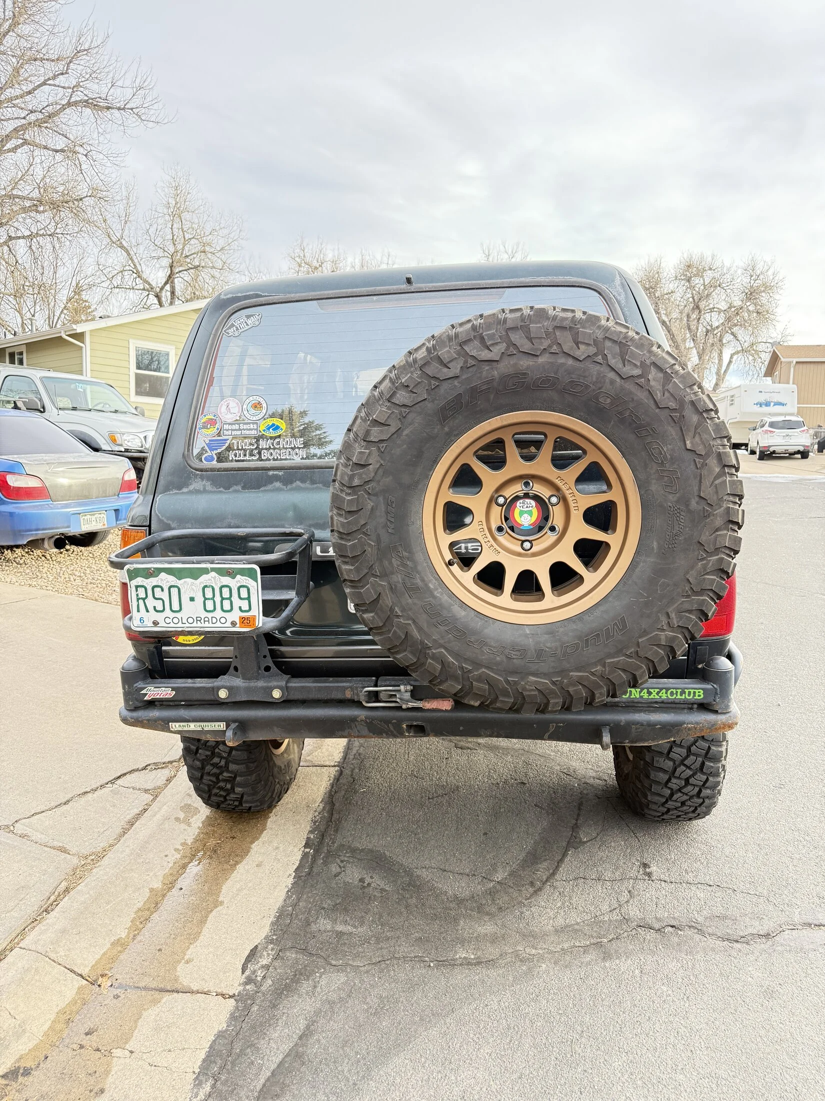

New wheels. After 7 years of beadlocks I decided I don’t really need them since I don’t air down past 10 very often. Went with the Method 703 bead grips. Had a buddy machine the lip that holds the center caps.

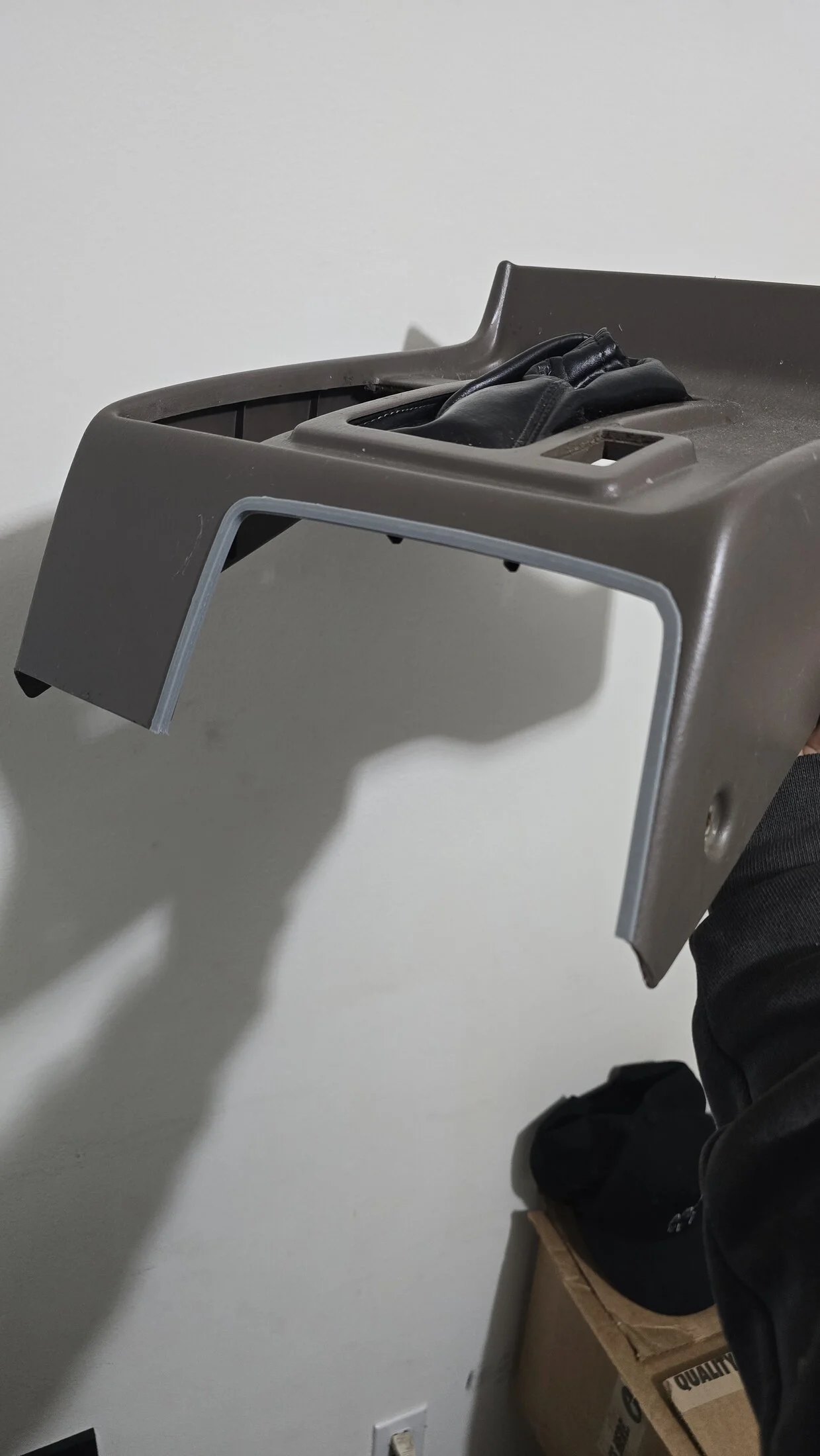

Now available on the site if you need that extra touch.
These are a pain to clean the supports from, but worth it.

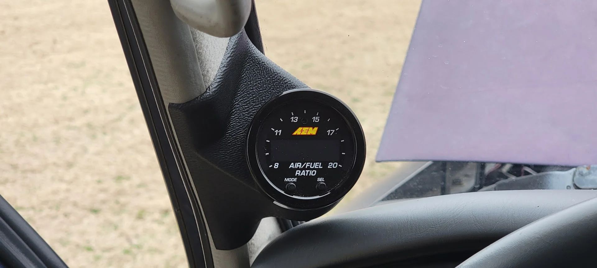

I finally mounted my AEM AFR gauge. It has been wired for months but riding around the center console. This location wasn't my first choice but it's the best visually. I'm hoping the red digits aren't too bright on the long dark country roads.

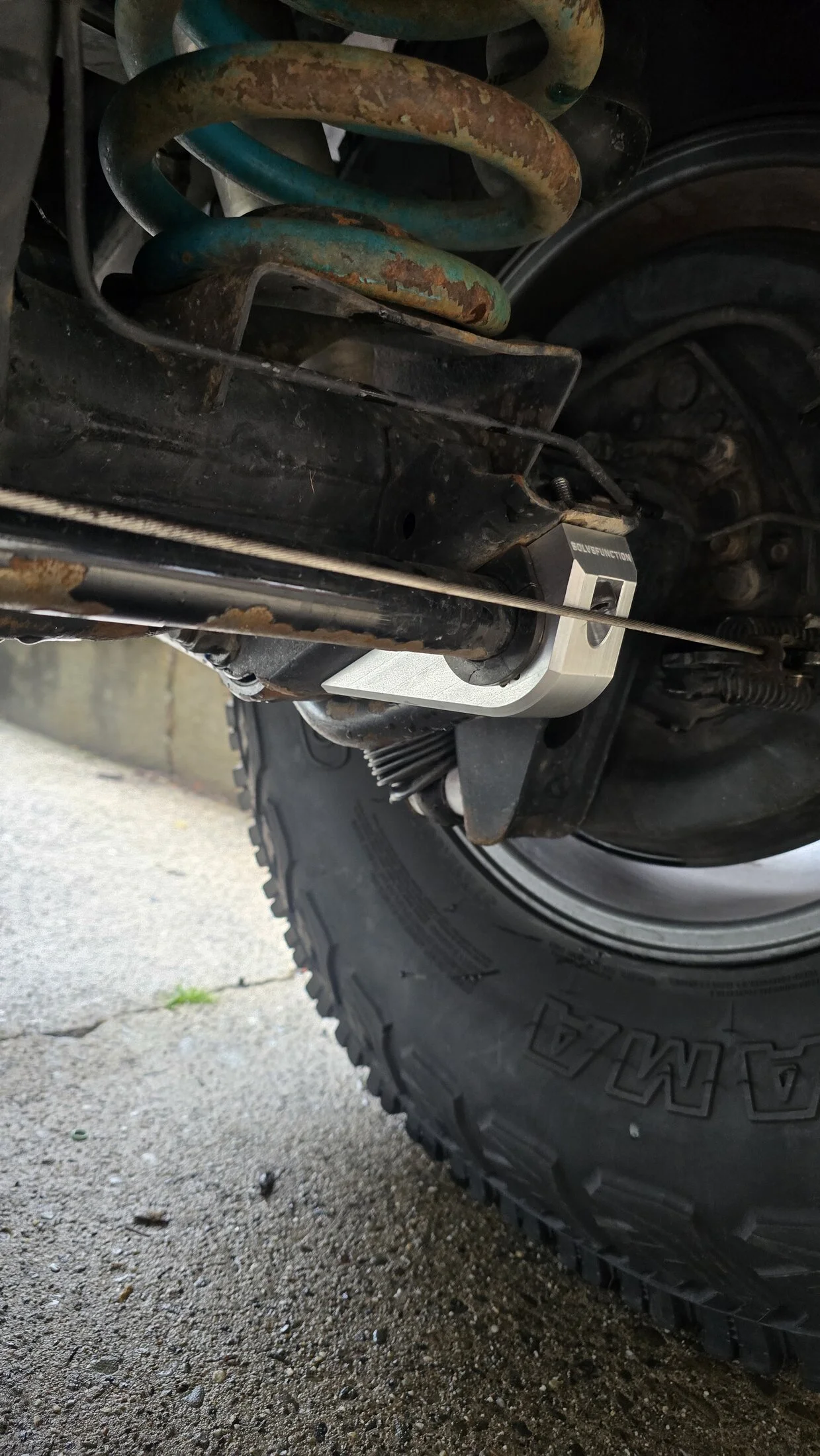

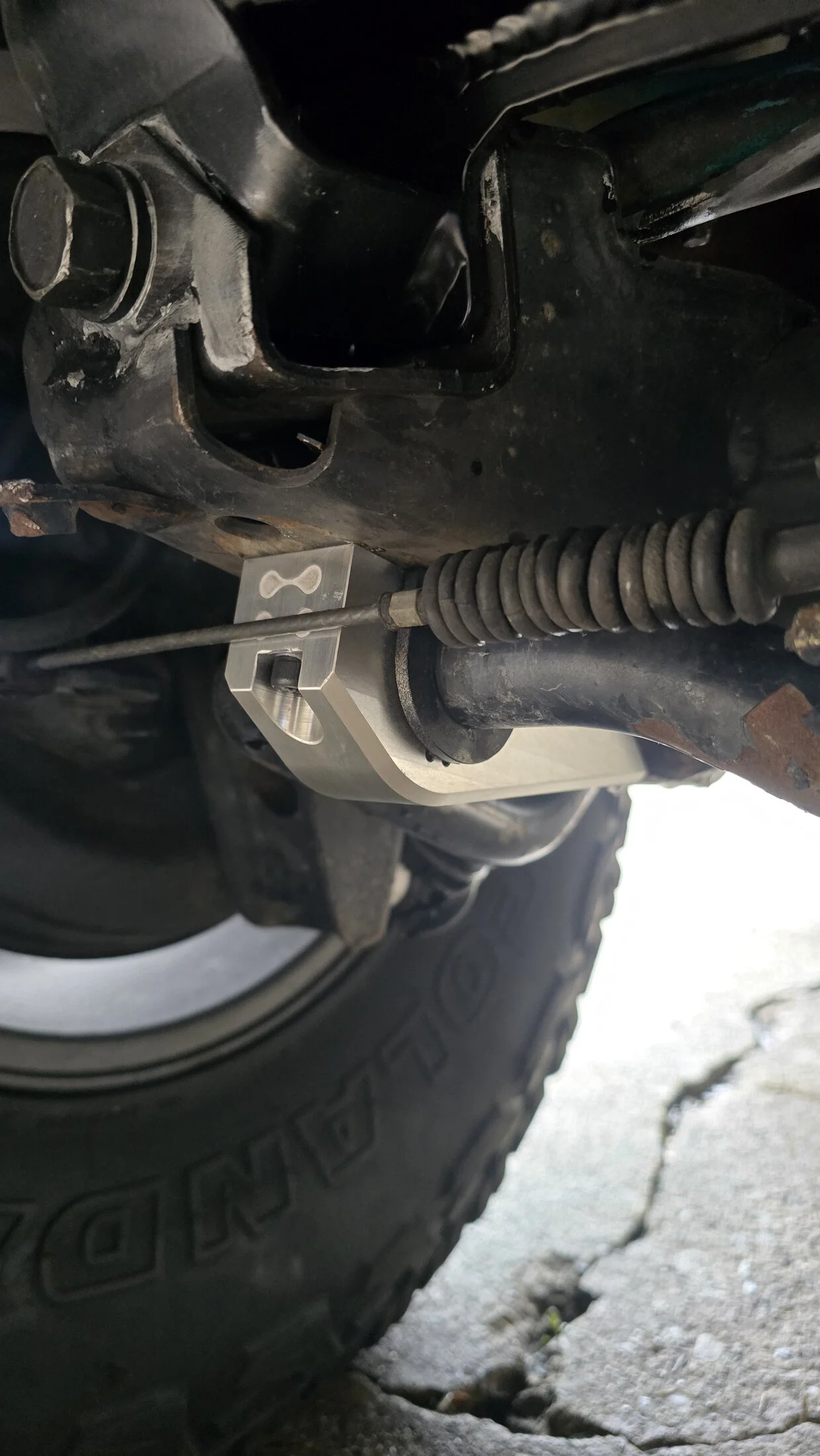

Do you make these for aftermarket Whiteline front or rear sway bars?
That's exactly what these are for the upgraded 30mm bars.
If you have the oem anti sway bars @Delta VS has some coming soon
