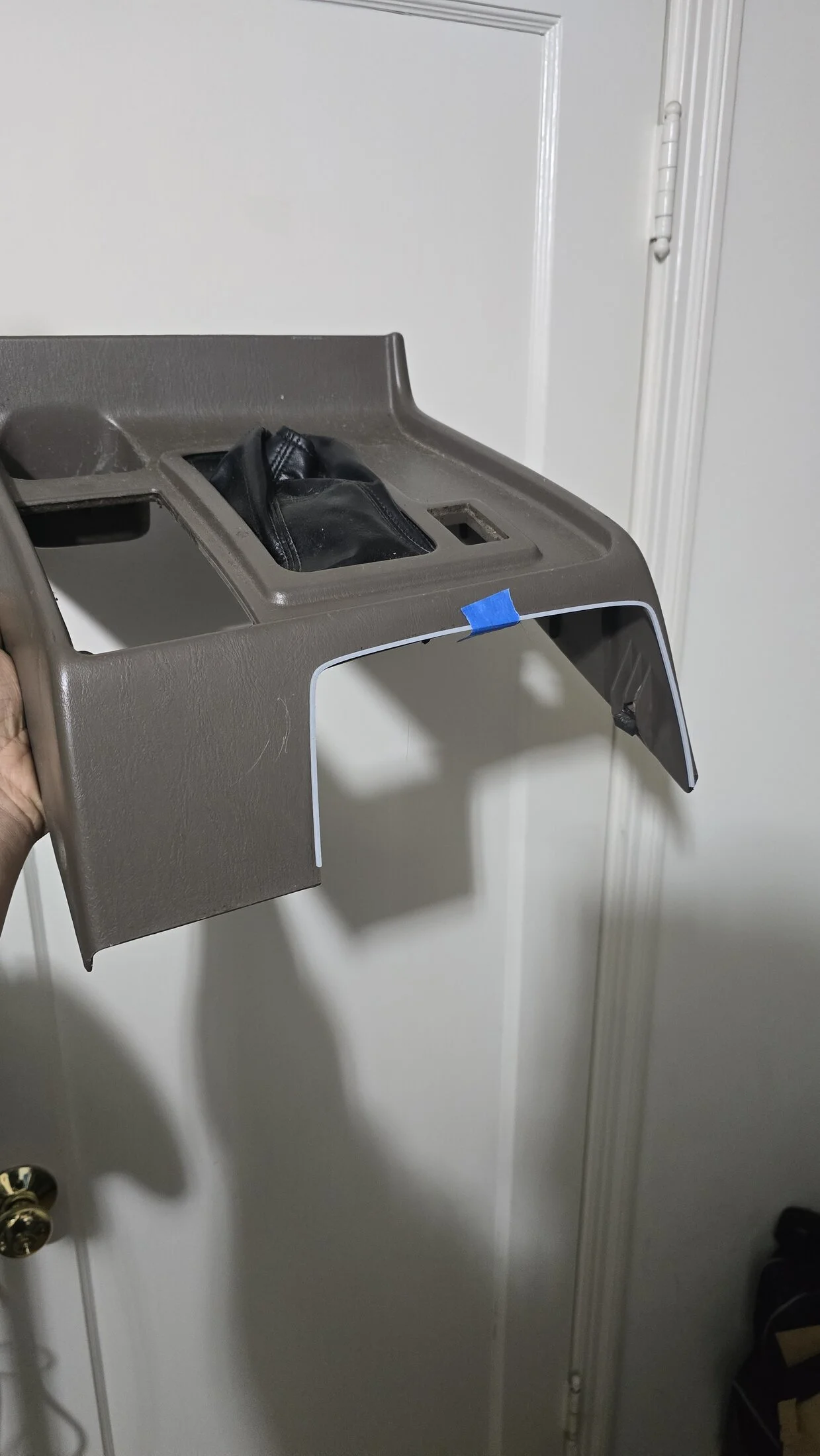

If only there was a person with a center console, calipers and a 3d Printer..
Will make these from flexible material

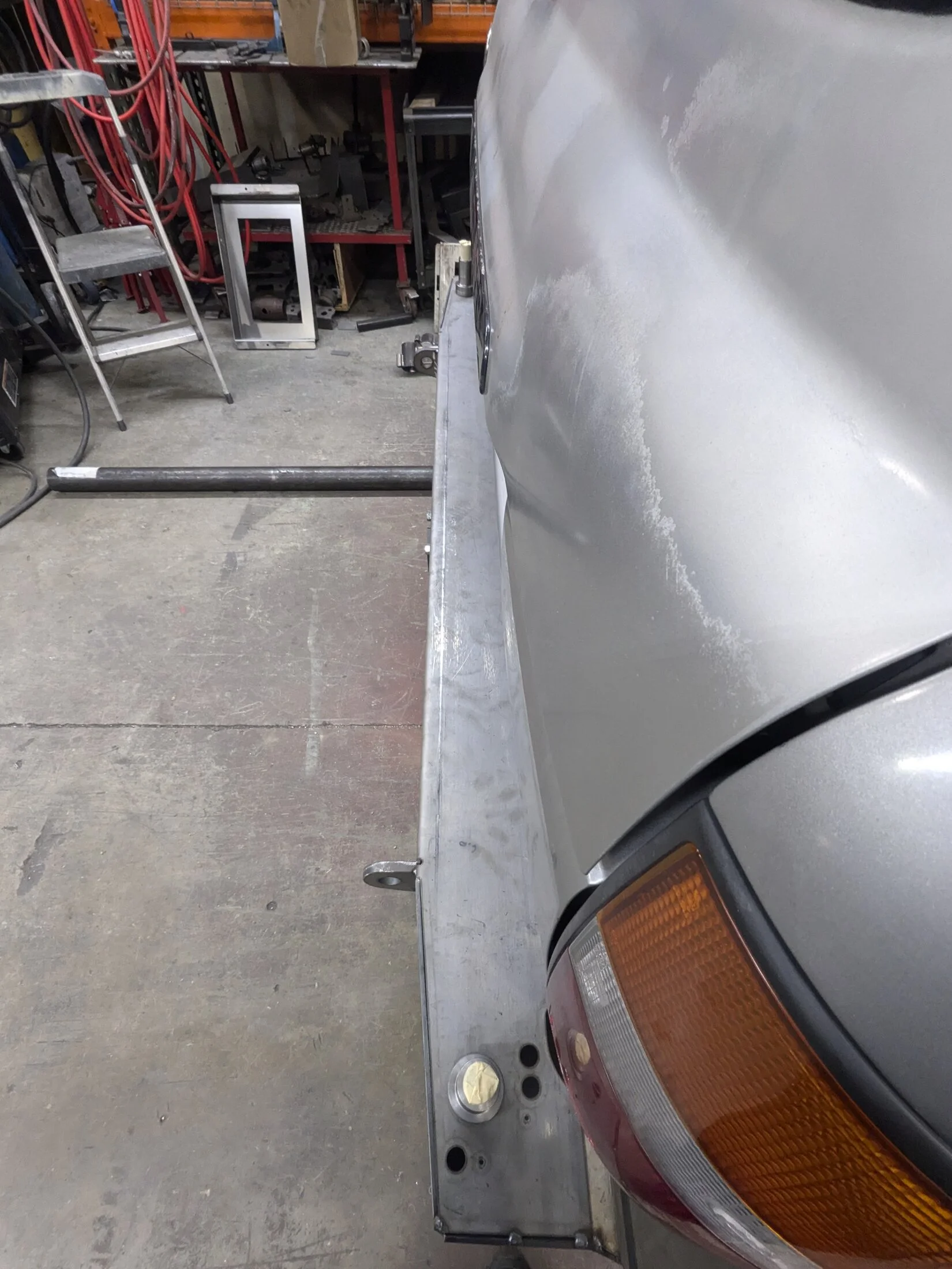

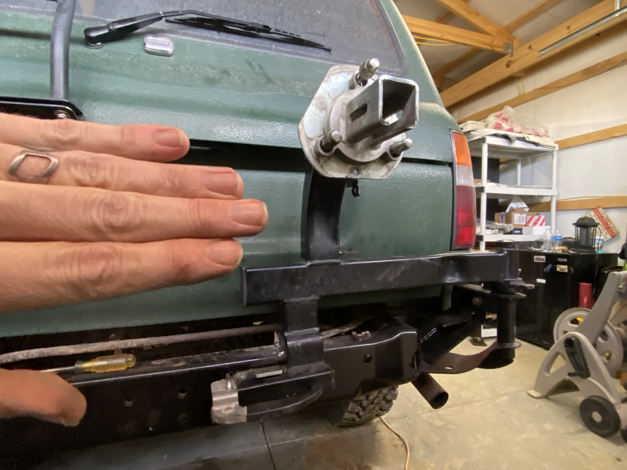

Picked up a Kaymar tire carrier/swing out. It was designed to be run with the oem bumper (which is long gone).
Used some scrap that I had in the shop to make a spacer, drilled holes through the rear crossmember and mounted the carrier up. Turned out just fine…
