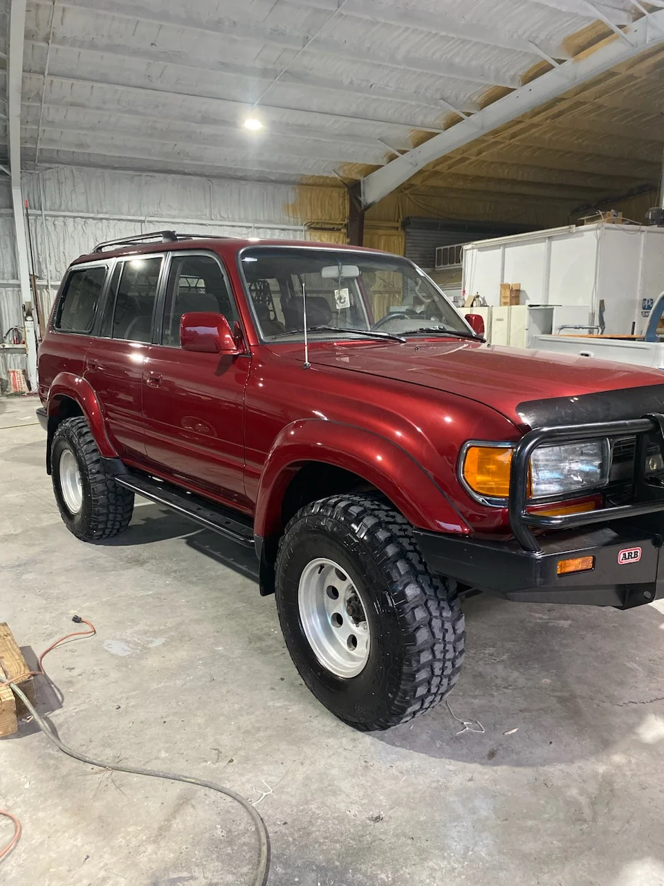

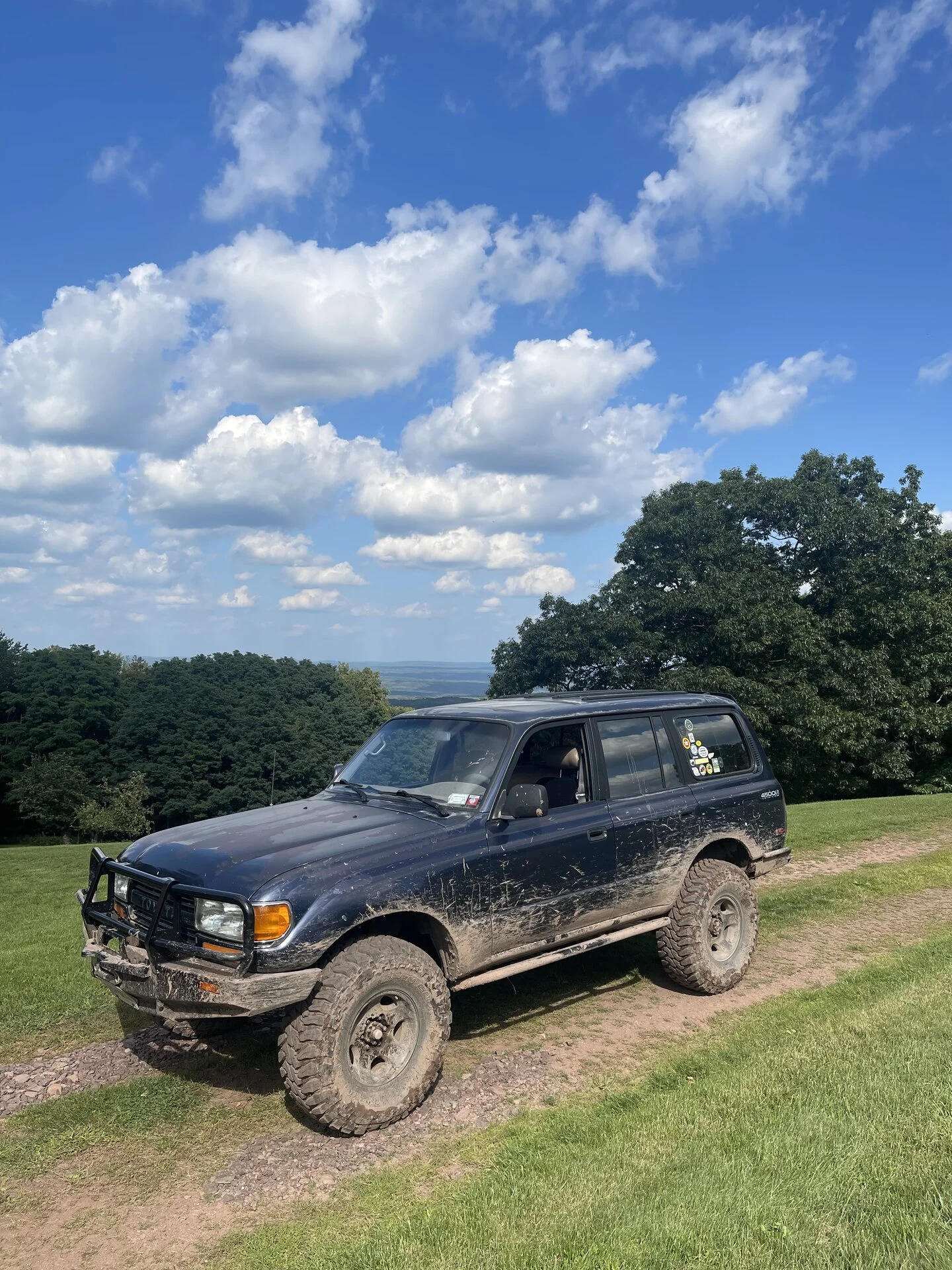

Do you happen to know the tire size on that GX? I need some ideas haha
37's will happen eventually....for now and the foreseeable future I'm running 285 / 75/ r17 Toyo MT's - they are great size w/ the 4.88 gears, does 75 on the highway no problem, I don't go much faster than that...no sway bars :smokin:
Awesome. Truck looks great.

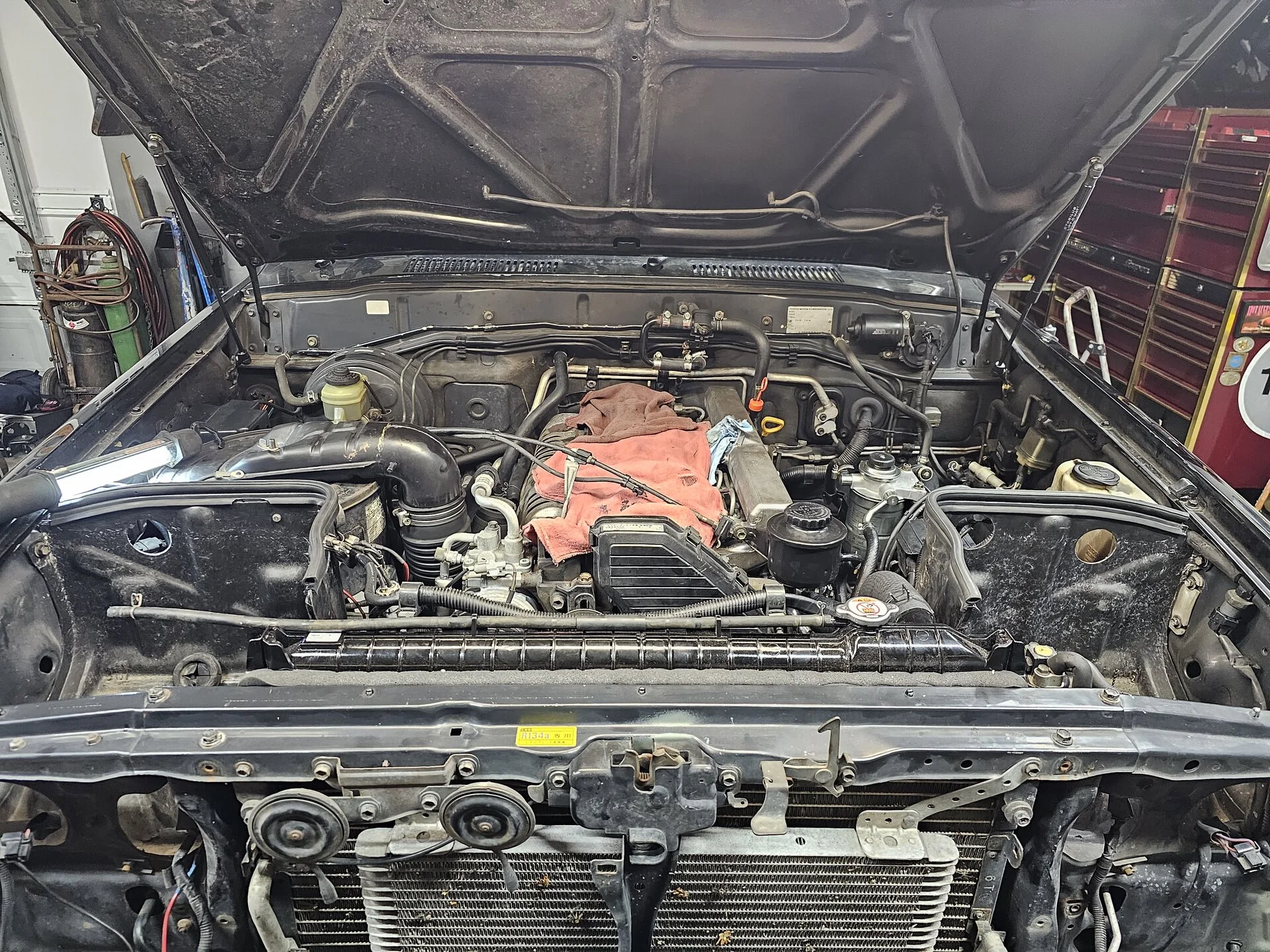

Radiator and timing cover back in. Battery boxes back in. Still waiting on shims.

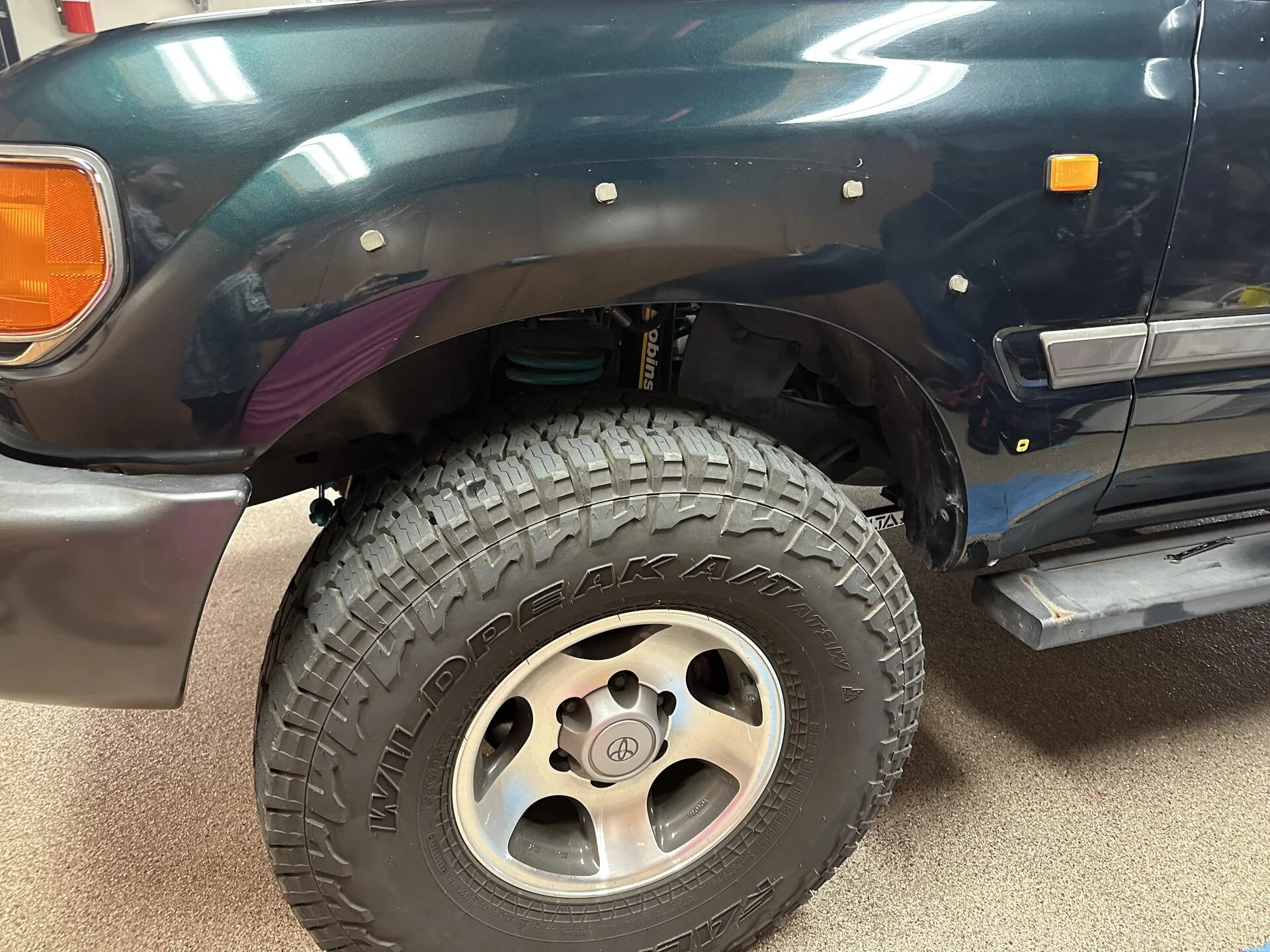

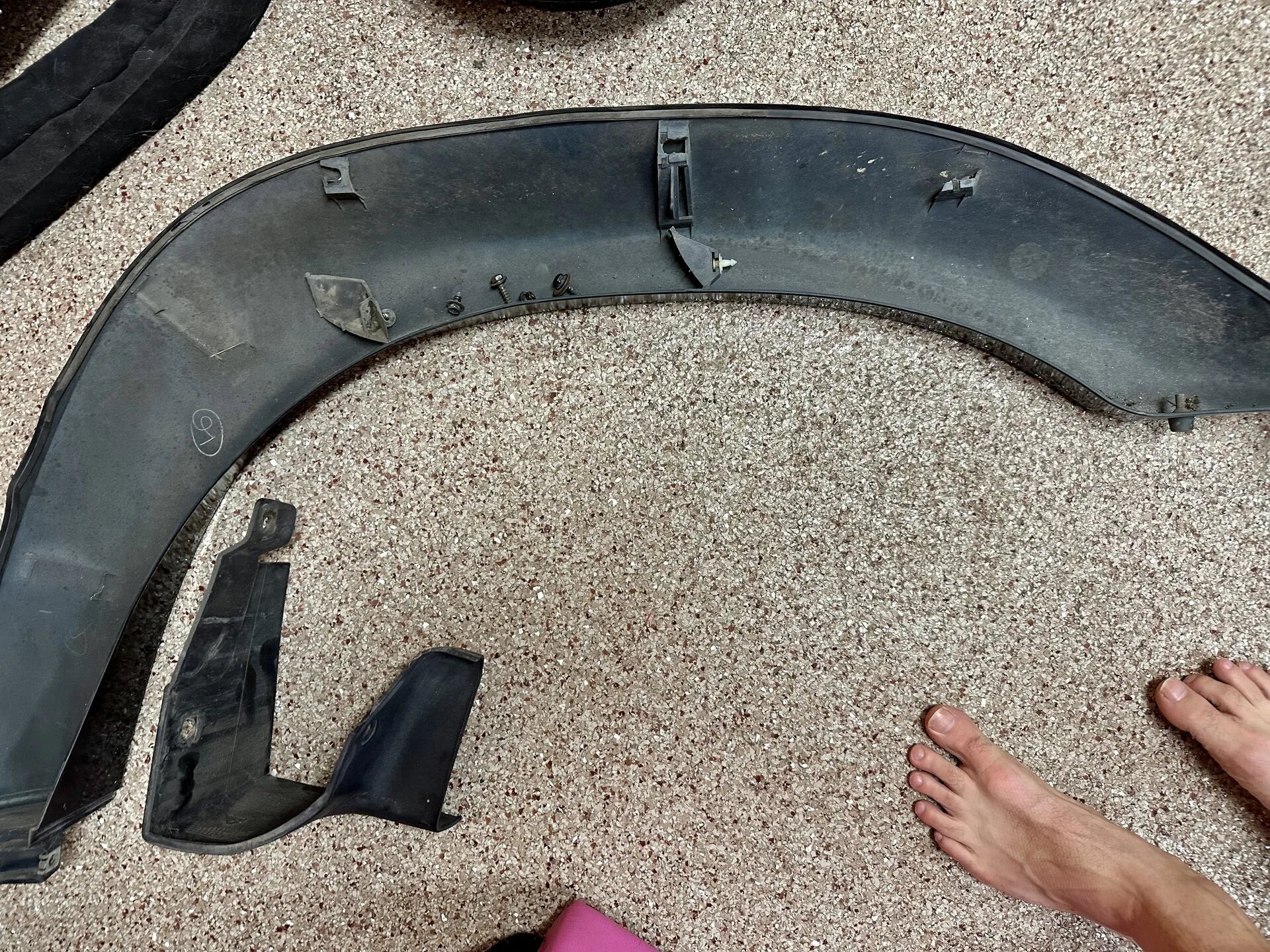

Finally got around to lowering my BIOR step slider 1/4” and the flare was loose, due to 3 of the clips on backside are broken.
Is this a JDM 80? I ask because you front fenders attach differently than my 1994. I literally just removed them and replaced the rubber trim. I have 3 bolts on top that you must unscrew the nuts holding them on from the engine bay, reaching inside the fender. I only have one plastic clip like that yellow one you have in a slightly higher position.
