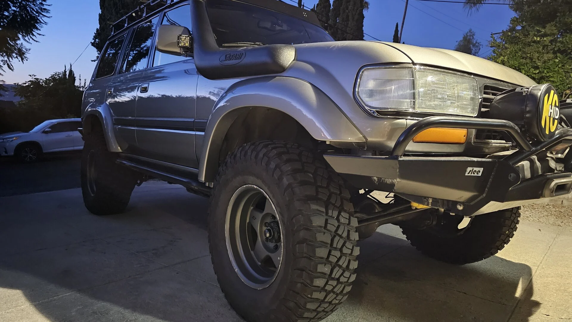

Now that’s she’s running (less the A/C)……
Finally replaced the seat bottom cushions. OMG what a difference! I sit like an inch higher, foam is nice and firm, and it was a huge pain in the ass. Hog ring pliers helped a lot, but it's tough work. Got the manual seat bottom foam from Land Cruiser Heaven. My truck is LHD but the seats are manual seats out of a RHD so I had to trim a bit of foam from the RH seat to make space for the front tilt control.

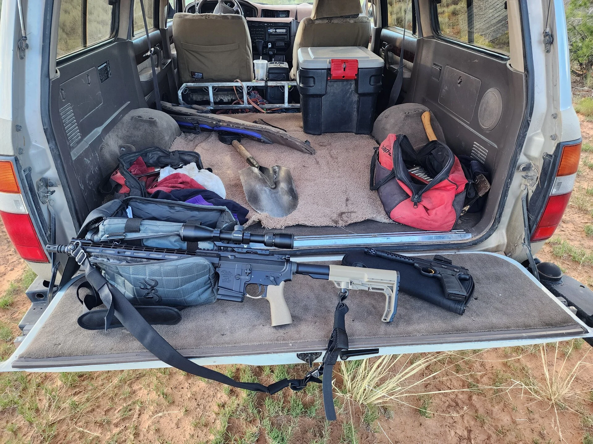

Loaded it up with crap and drove east across the state to move and start a new job. Than I took it out for an evening ride to explore my new backyard and do a little shooting.

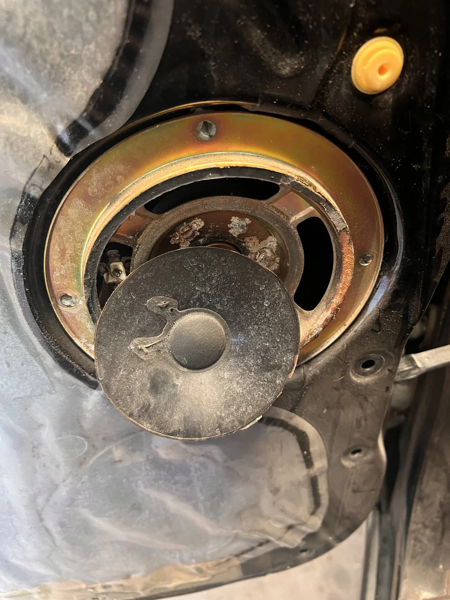

no pics but been getting water in the factory jack area. traced it up high, to what i think is the seal to the vents behind the window slider trim piece.
managed to get that trim piece off without breaking any clips. the trick i found here is to push out from the body both the bottom stud and the top clip, then slide the whole piece upwards. i was able to release the top clip with the help of a small socket on an extension (6mm maybe? enough to compress the clip). the hardest part was probably slipping the trim pieces back under the slider window gasket
since i chose to do this without buying new parts, i used 3M butyl rope i had on hand for my gaskets. made a mess of my hands and under my finger nails making thin strips to re-create the vent gasket, clip gaskets, and re-adhere the trim edges. now waiting for the next big rain storm
