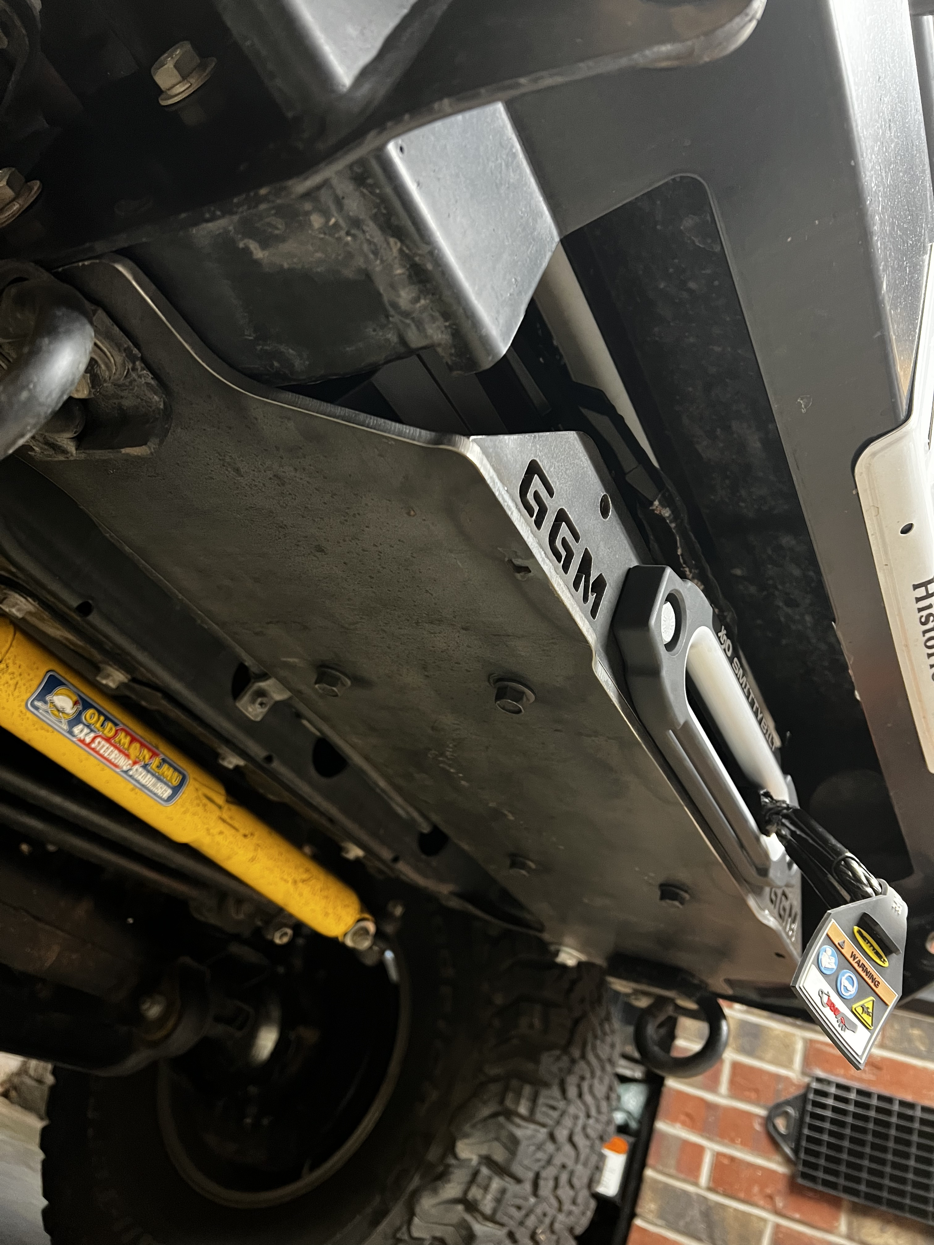

I wanted to add a winch to the front of mine but not thrilled with replacing a perfectly good ARB non winch bumper to do so. Thanks to @GGM for the mount plate so I could tuck this up in there! All in for the plate, Smittybilt X2O Gen3 12k winch, and some accessories is about $1100.00, which is cheaper than just the bumper replacement alone. Clearance is the same as it was with the unmodified ARB, so all good there!
Big hole to fill...just needed to cut out the "window" on the bottom of the ARB...
And still have easy access to the clutch...would have been nice to clock forward, but wouldn't fit without further mods since this winch only does 90 degree options. I'll go ahead and mount the control box on top of the bumper for easiest access...I don't want to have to open the hood to use the winch if needed.
I have some extended cables coming for the power leads to the head and just need to paint the plate, wire up, and all good!
