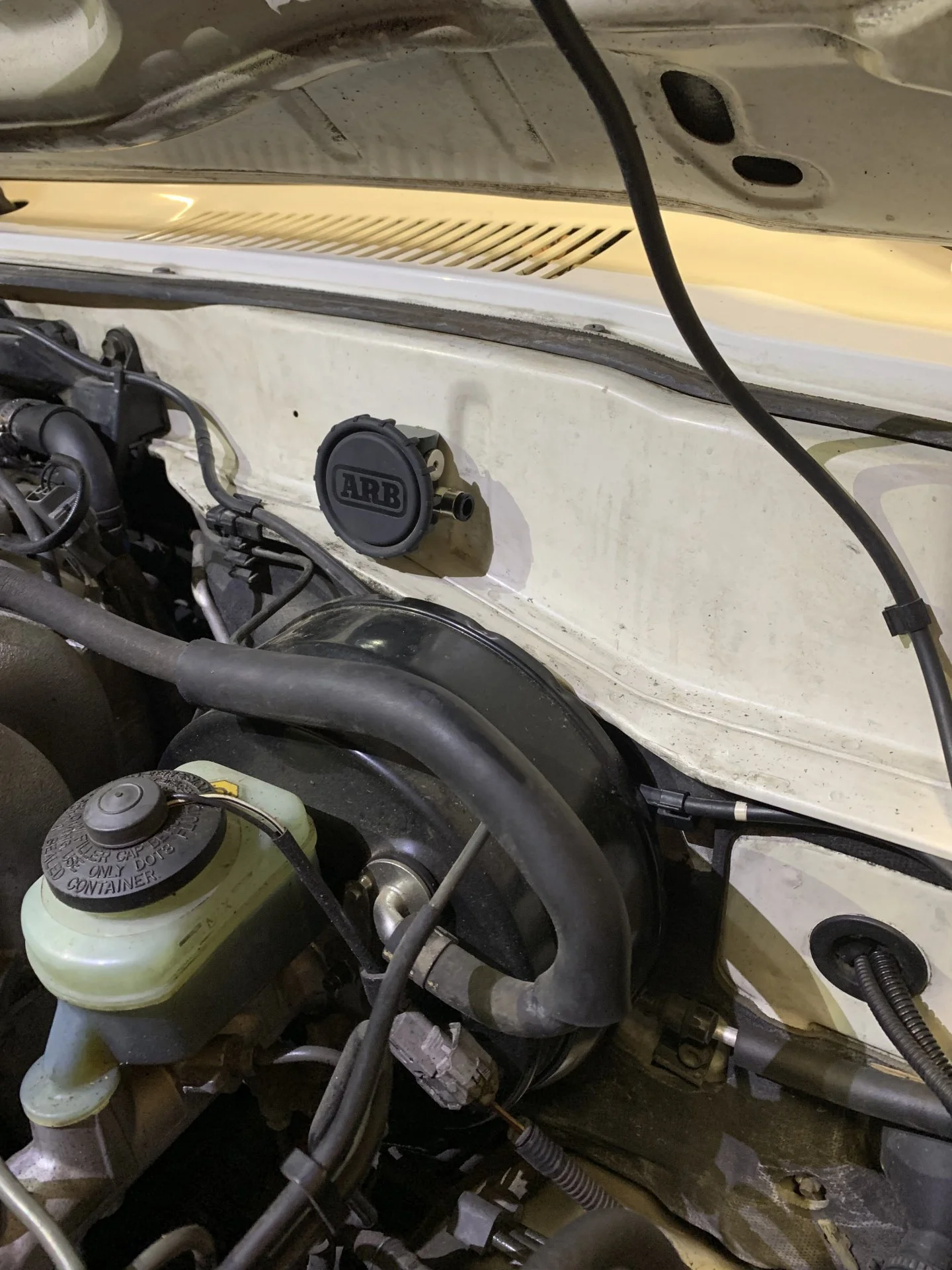

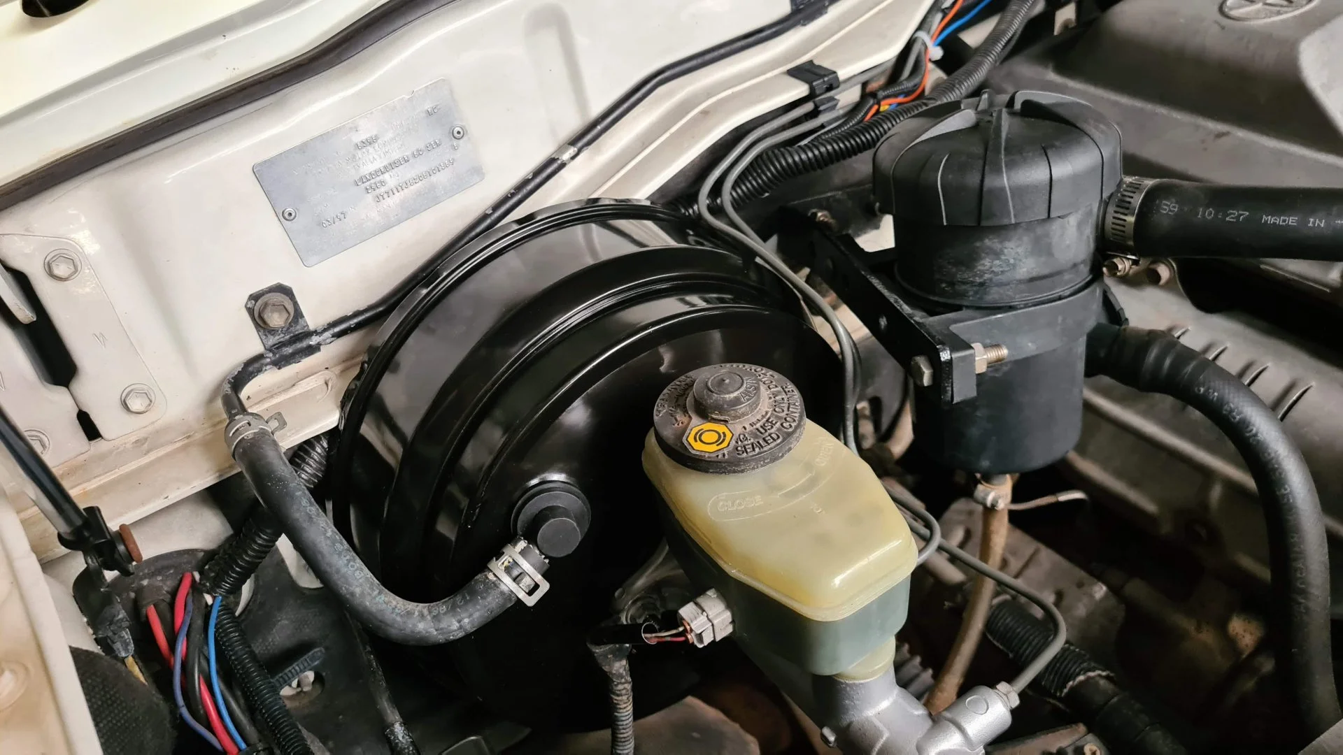

Mounted the diff breather today. Waiting for a little bit warmer weather to run the hoses...

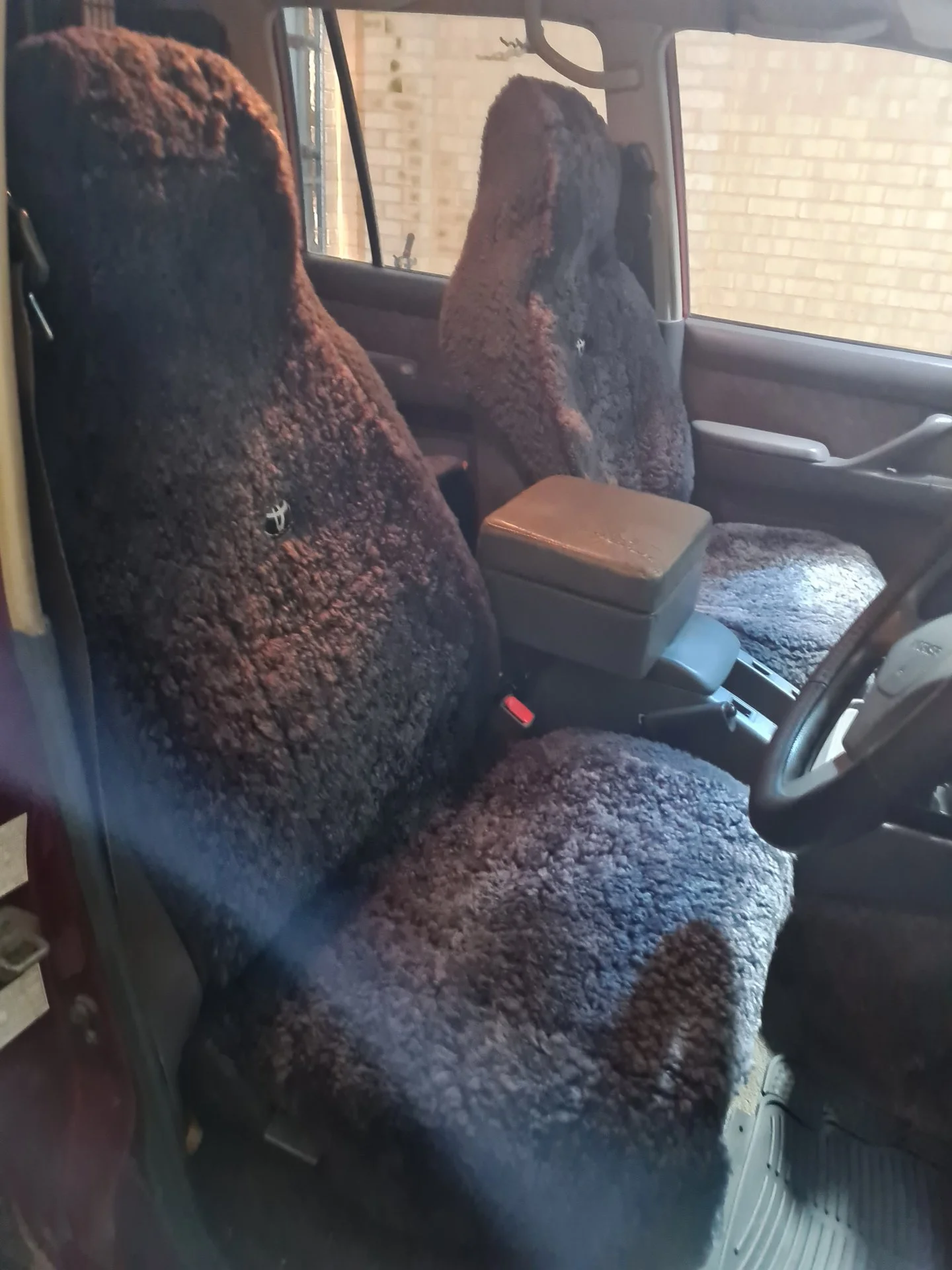

Lastly, found some toyota faux wool seat covers; nice and comfy.

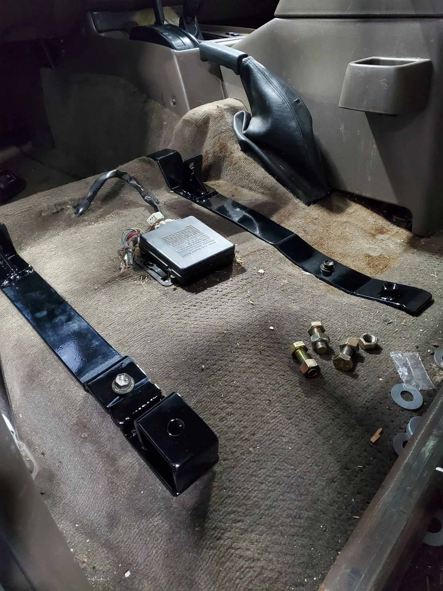

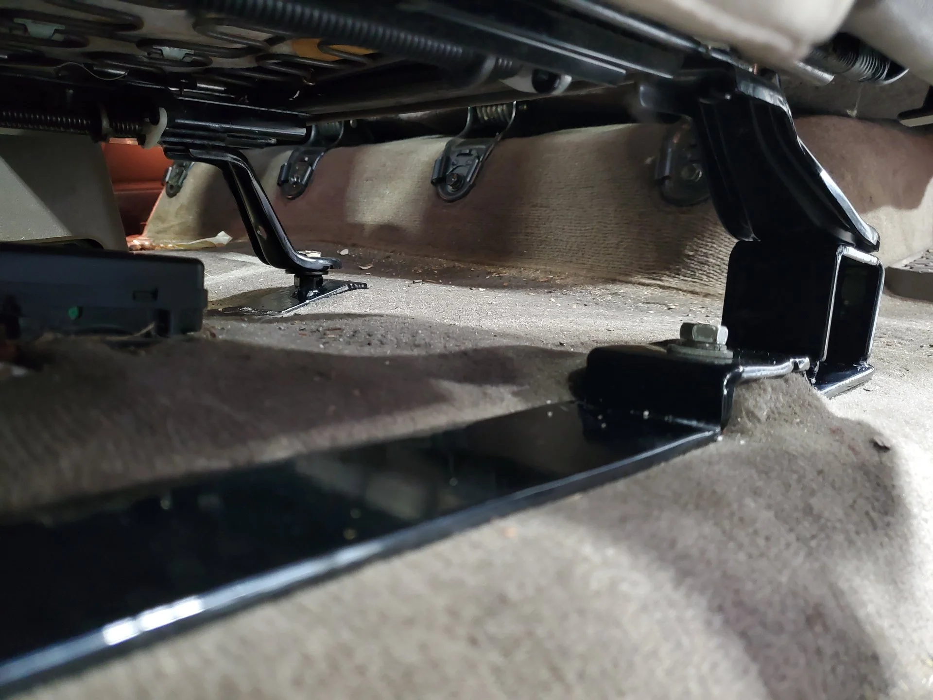

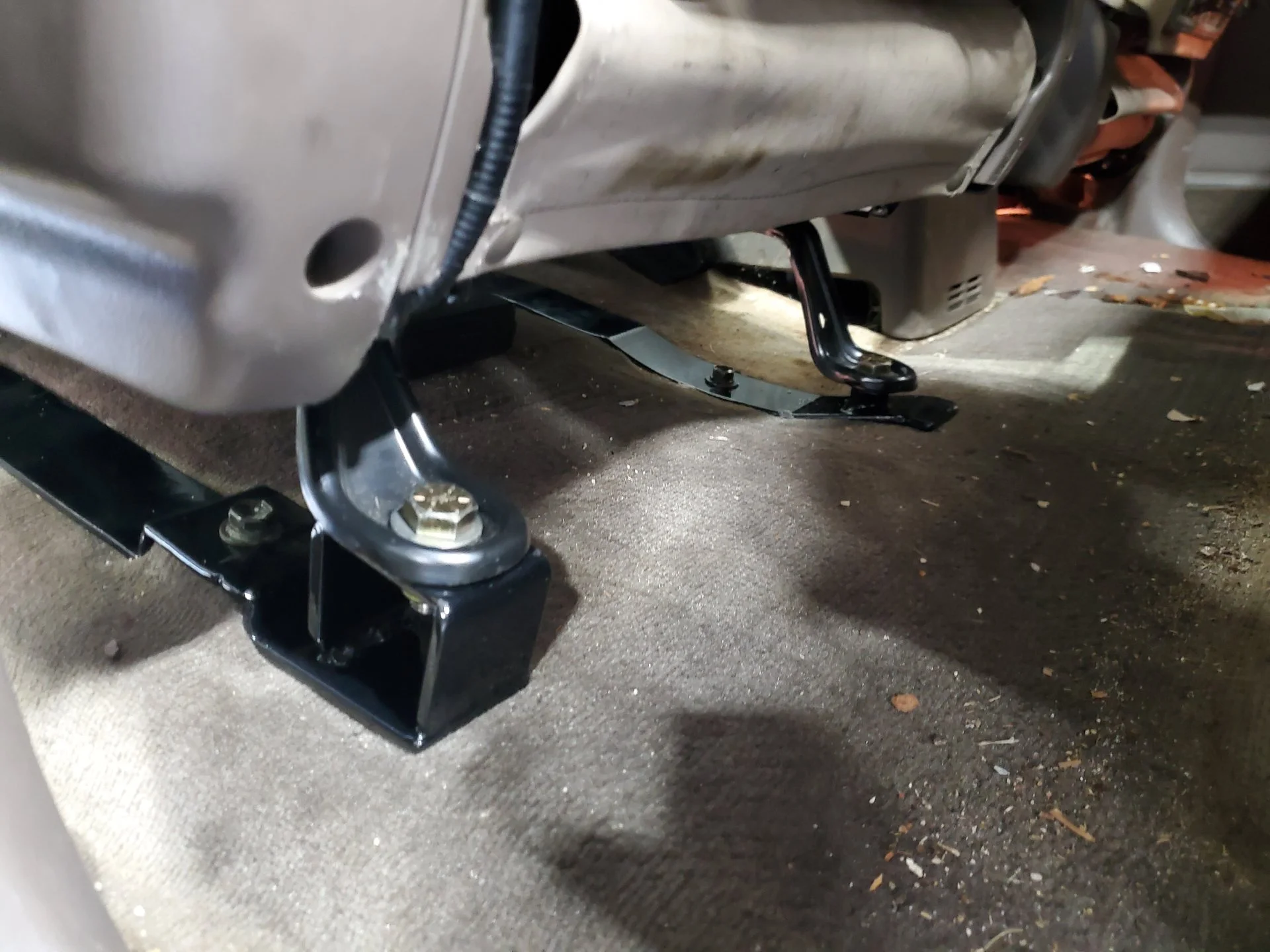

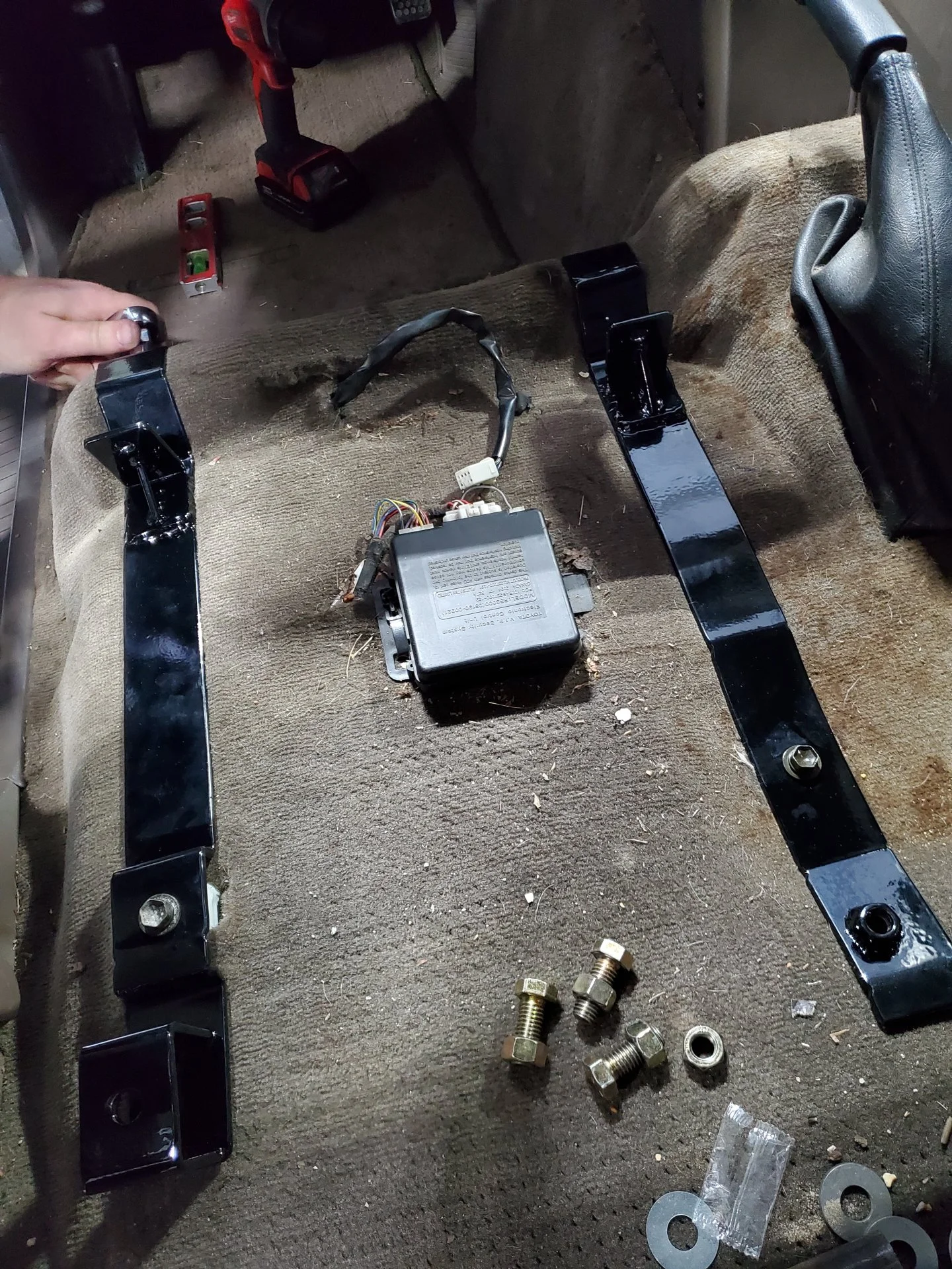

I built some seat relocation brackets and got myself 4 or 5 more inches of leg room. If you're over 6 foot tall, these 80s are super uncomfortable. I am 6'6 and this mod was an absolute must. Also replaced the seat gears with brass gears so now they move back and forth like new. Took it in a road trip this weekend and it was so much more enjoyable to drive.
