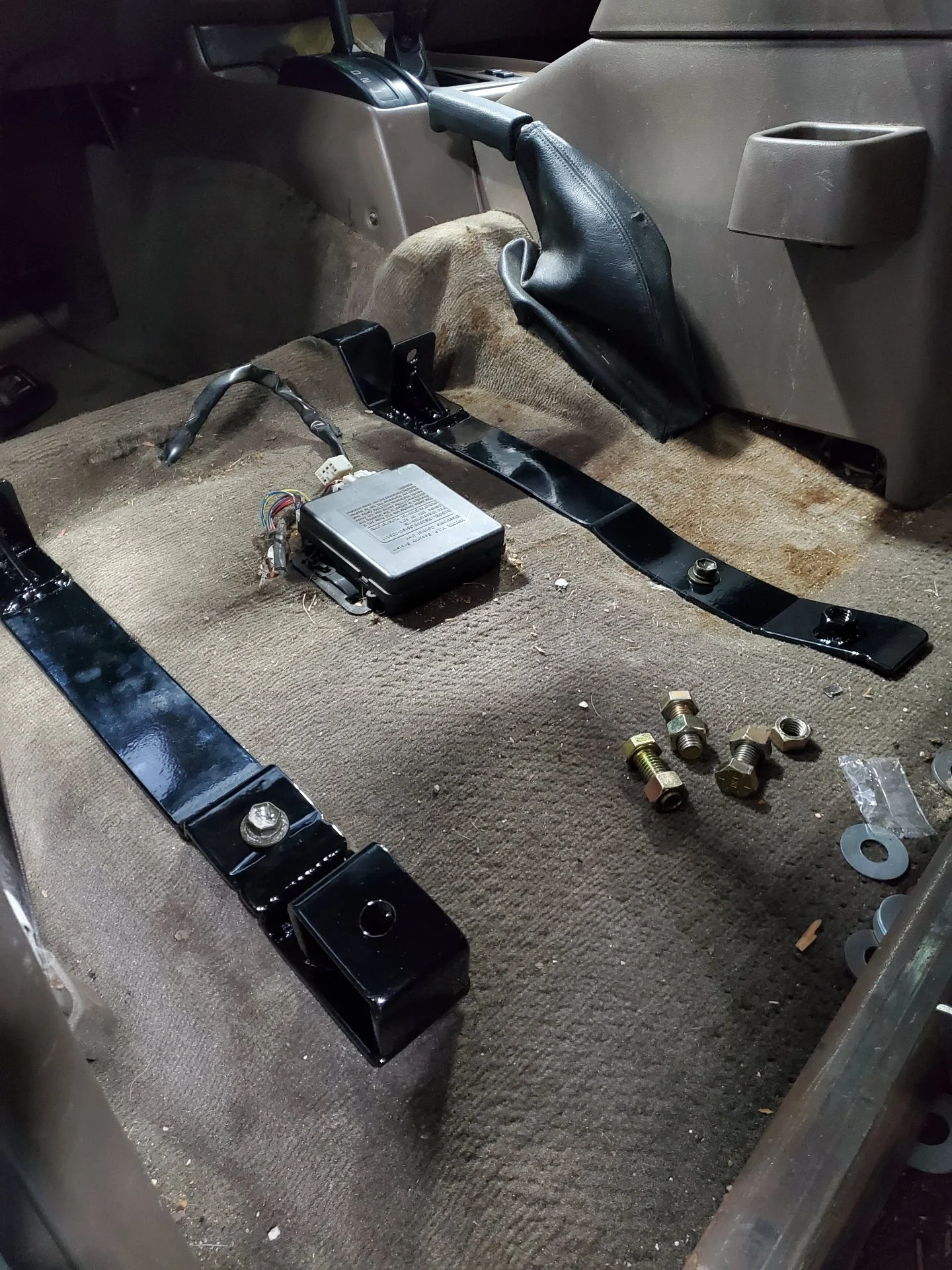

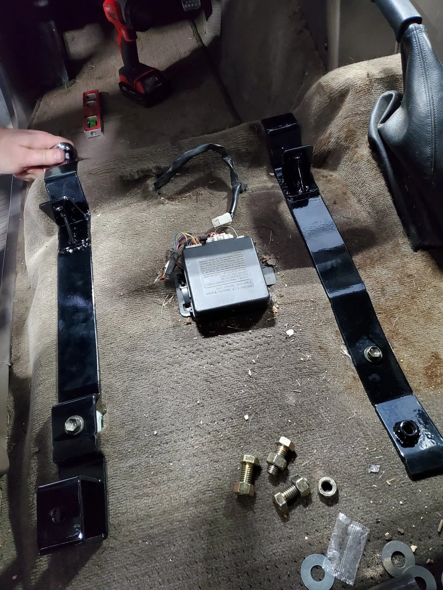

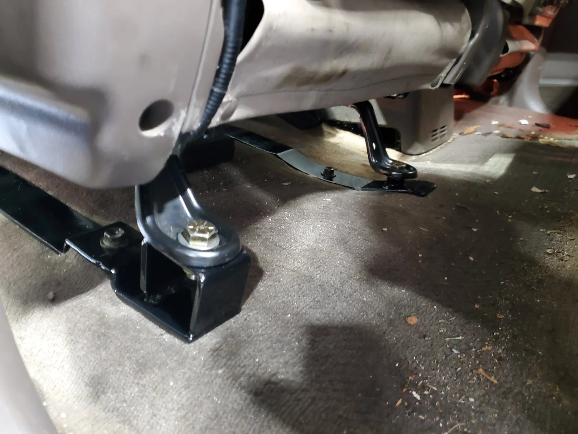

I built some seat relocation brackets and got myself 4 or 5 more inches of leg room. If you're over 6 foot tall, these 80s are super uncomfortable. I am 6'6 and this mod was an absolute must. Also replaced the seat gears with brass gears so now they move back and forth like new. Took it in a road trip this weekend and it was so much more enjoyable to drive.
That looks like it too a lot of geometry and figuring out time. How many prototypes did you go through before you were happy?

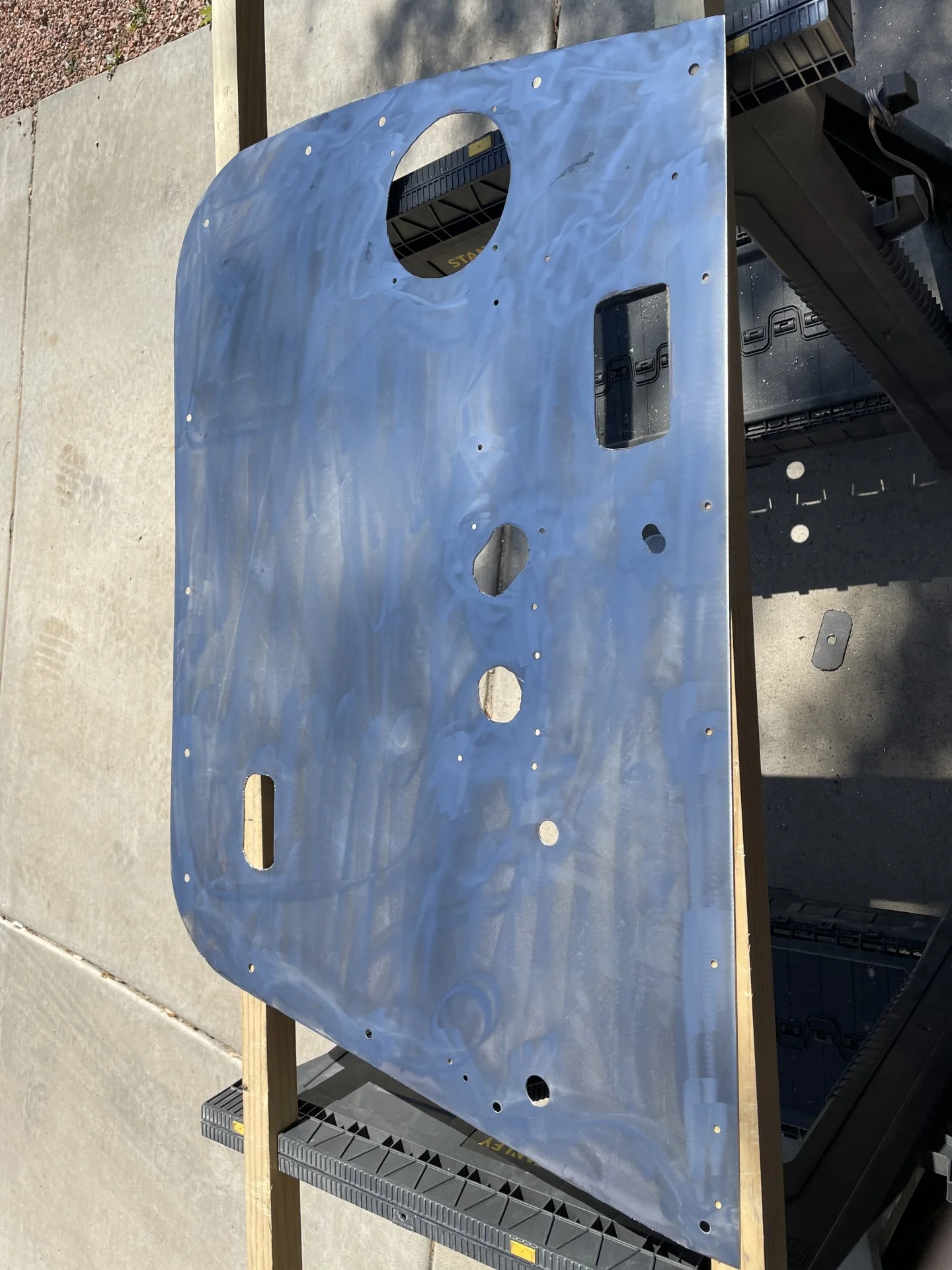

Put in a new window run which fixed my wind noise. Decided to sound deaden the door with Noico and run my ditch light wiring.
Then I got a little too into it and fabbed up a new steel door panel. Just the one for now. Worked pretty well, so plan to do the other 3.
Will probably add a custom door pocket to it at some point.
That looks great, nice work.
Bad ace, hopefully you do a good write up on these door panels.
I’ll try to take better step by step pics for my next one. It’s super easy though. Just pop your card off and disassemble. Decide what you want to remount. (I skipped the pocket only).
Then I just traced my card and necessary holes onto 18ga steel sheet. This was probably overkill and 20ga would be okay.
I cut it all out using a dremel, drill, and angle grinder.
Attached it by using 1/4-20 nutserts into the existing holes for the old card clips.
I also moved the light to a space with an opening in the door as it used to reside in the pocket and needs extra depth to mount flush.
Finish with paint or whatever you want and then re attach your plastics and speaker.
I deadened the backside of the sheet, but be careful of thickness. Mine was a little fat around the door handle and speaker.

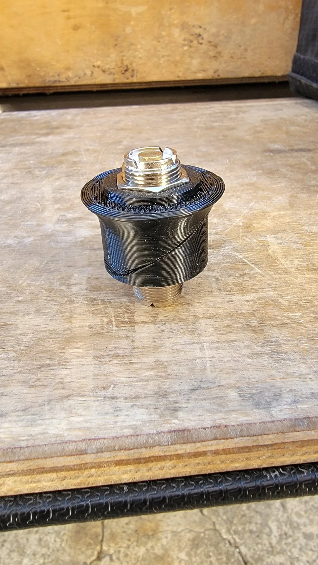

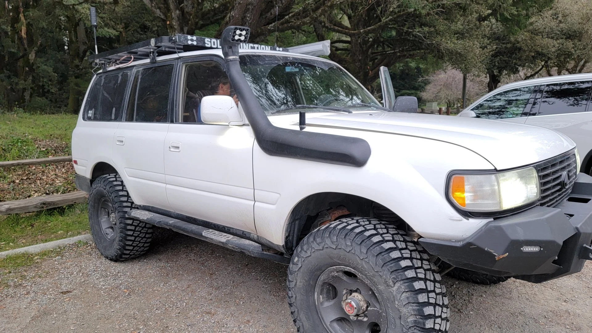

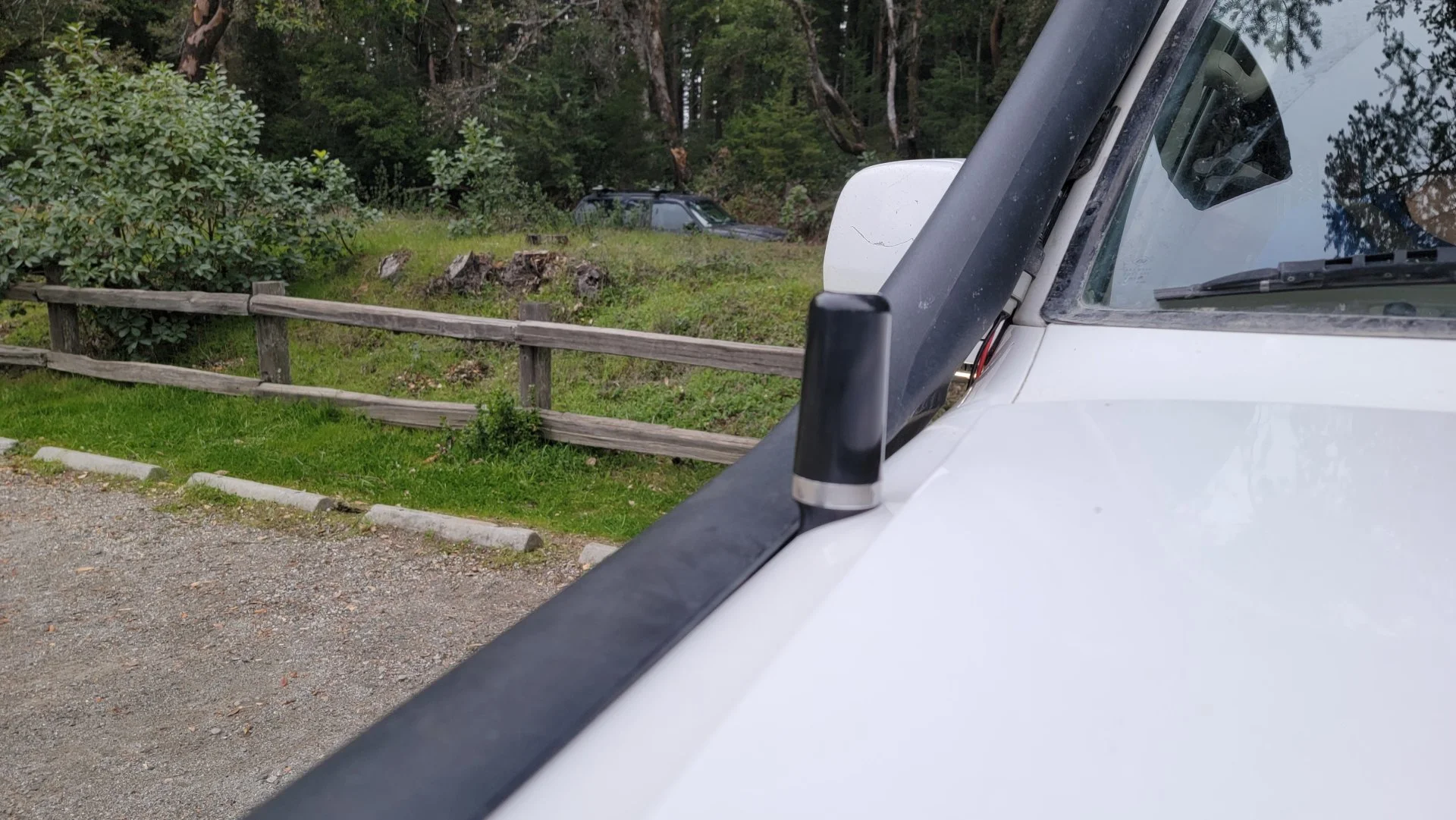

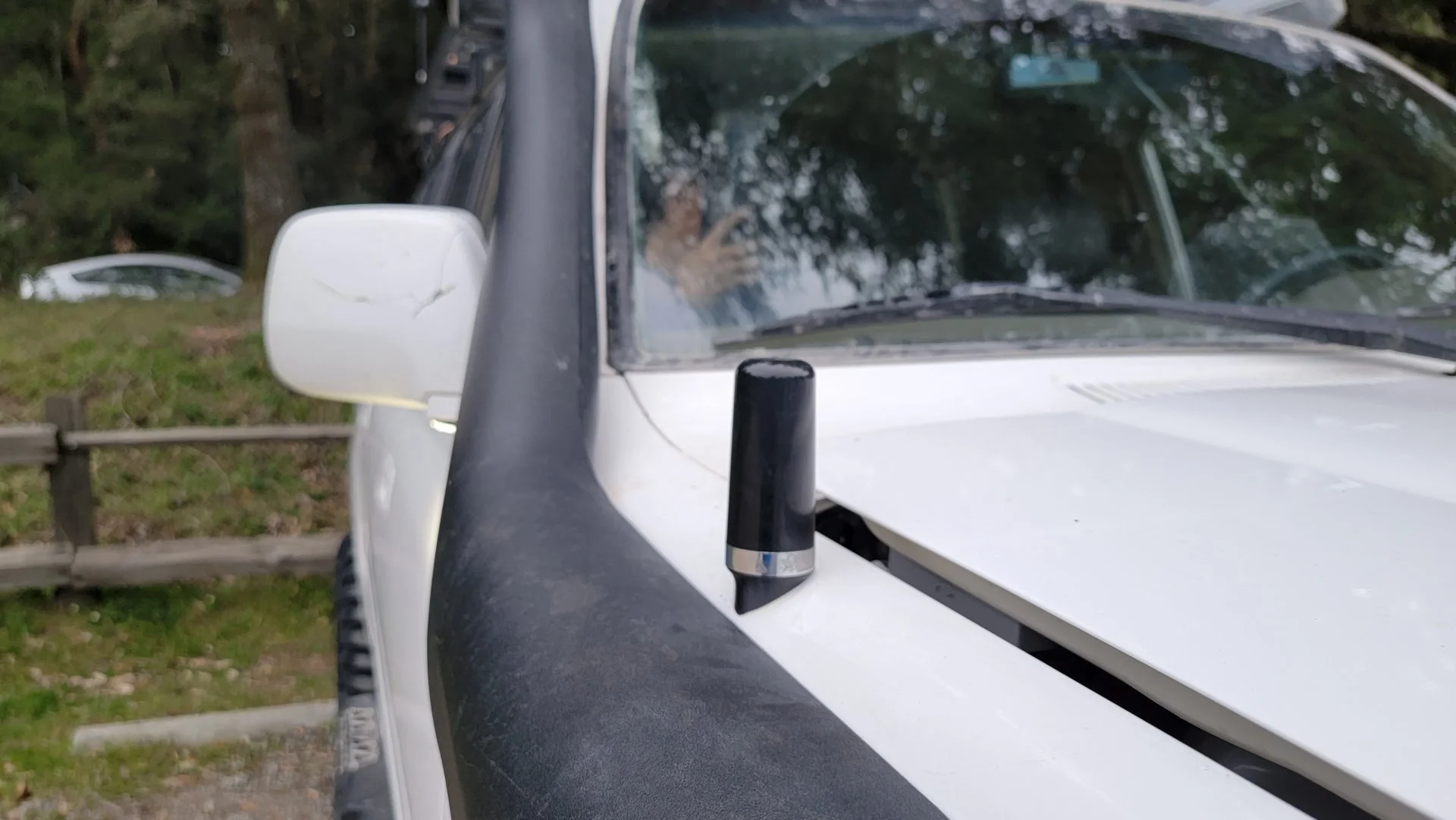

I installed this nmo mount I made that replaces the FM antenna. I never used it.
I'll use this for aprs.

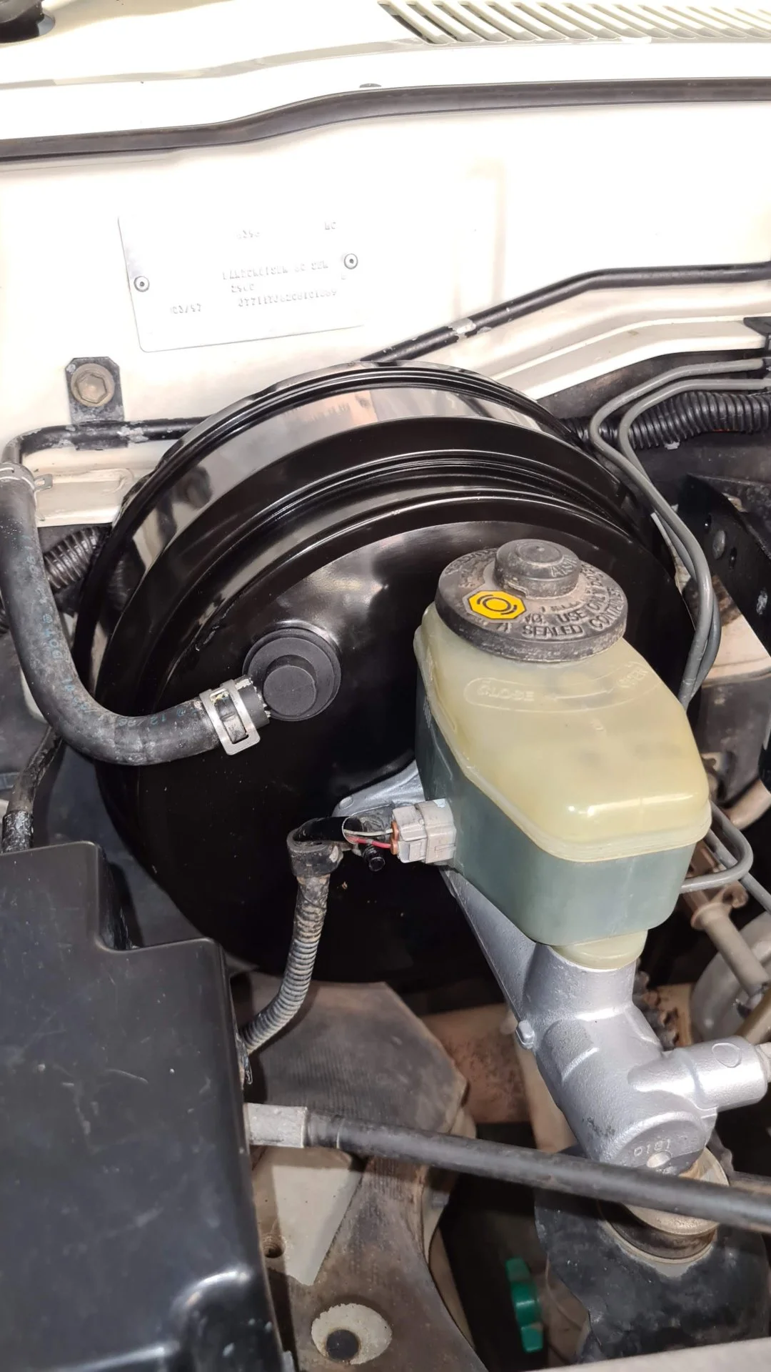

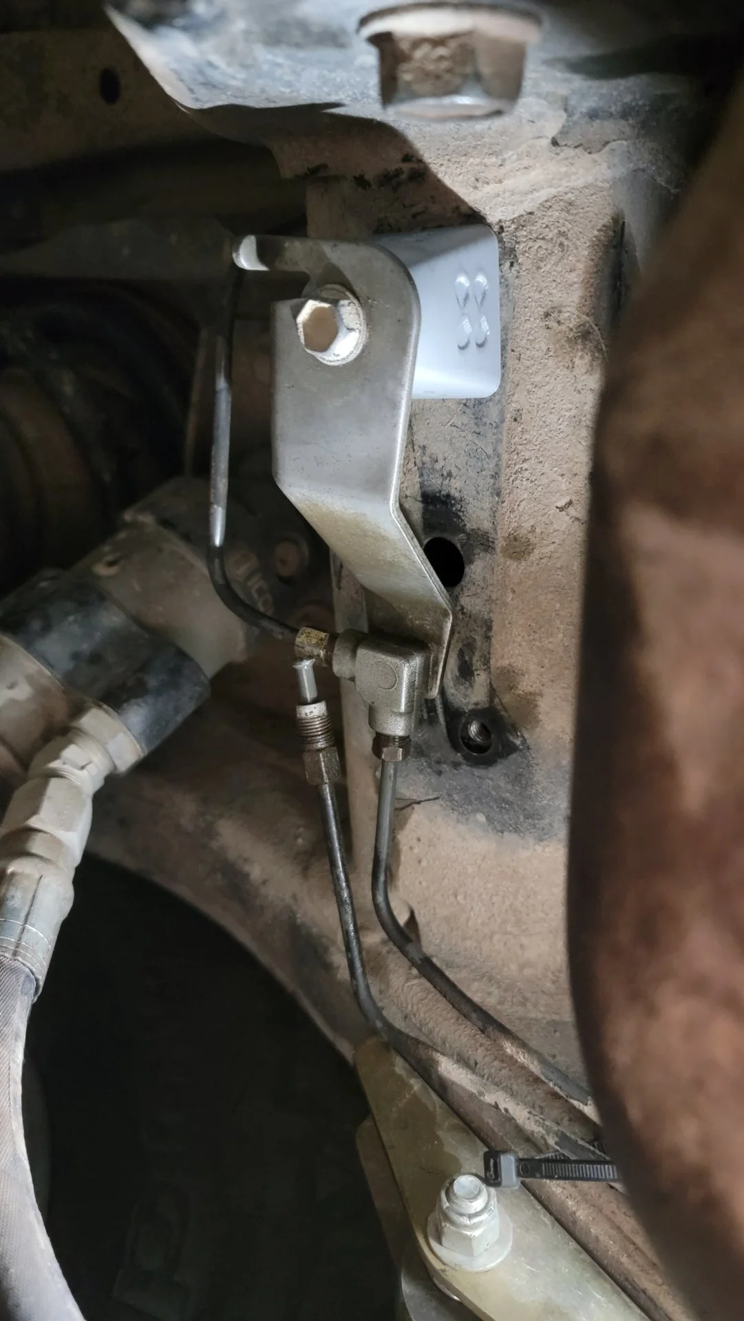

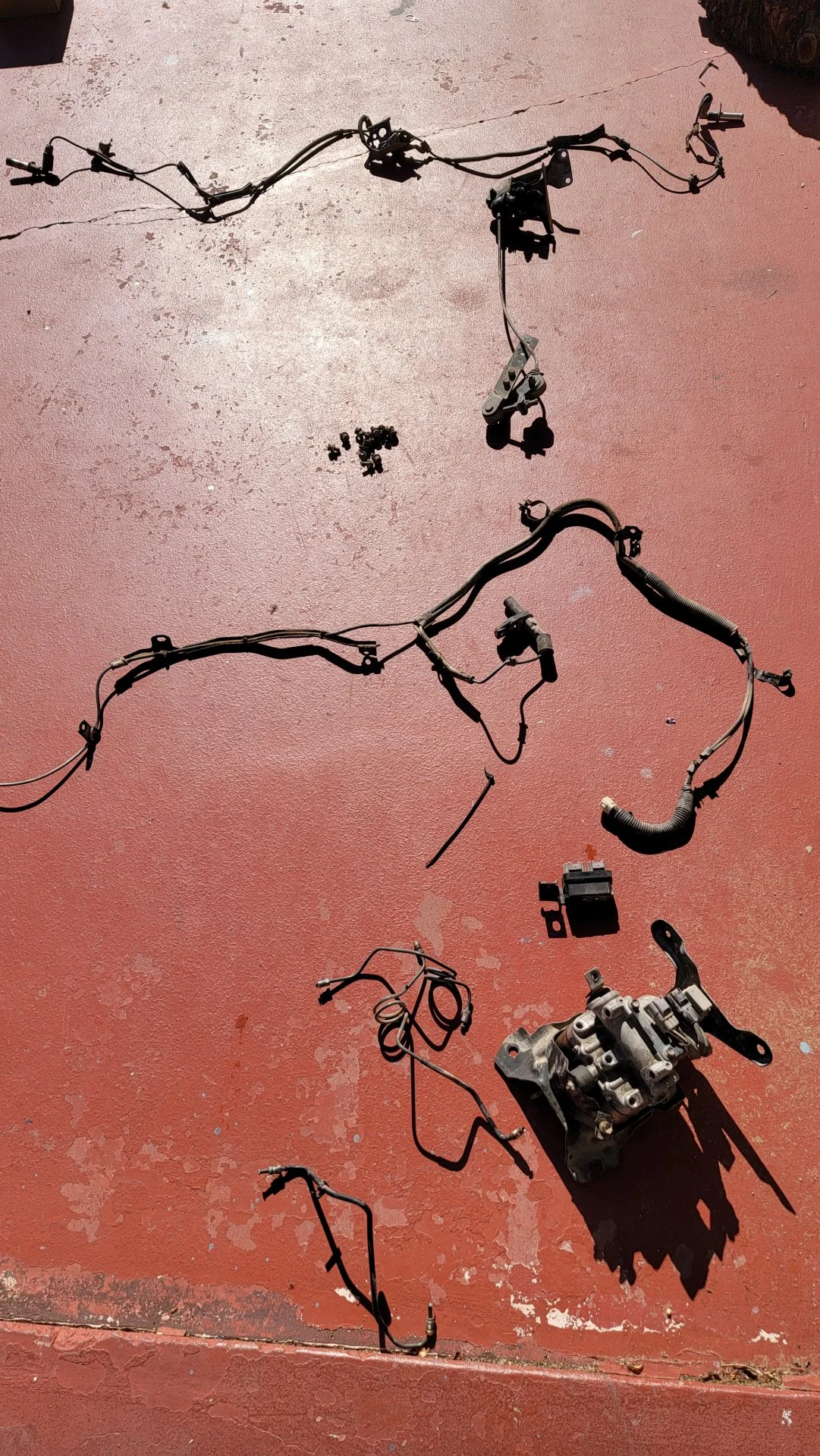

Sunday I took out the abs and lspv.. It kept engaging while going down hill slowly on Turkey claw.

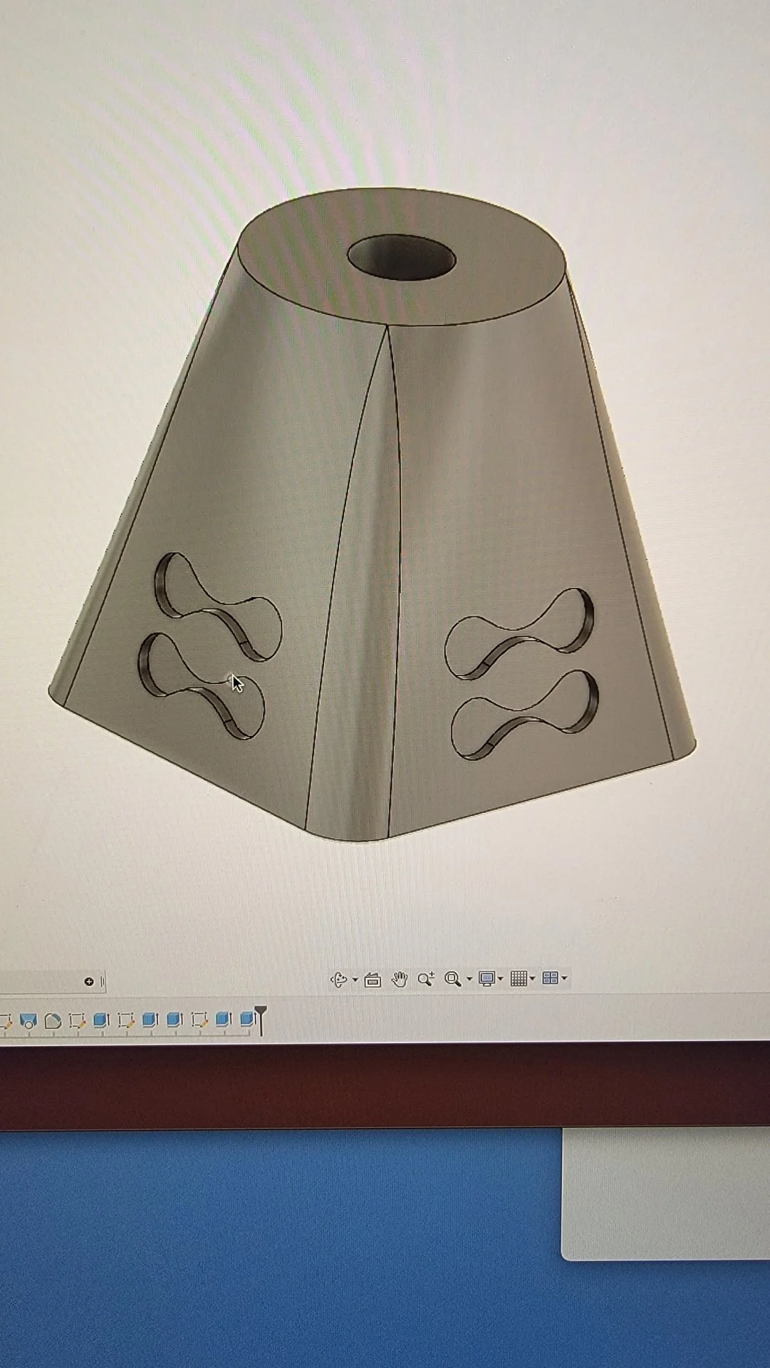

I made this spacer to mount the 90 degree union on the rear of the frame where the lspv used to be. Keeps the tubes from vibration and fatigue. Also I am leaving the old lspv tube there as storage for spare brake line tube if i rip another one.
Solvefunction - Offroad and Landcruiser parts - https://solvefunction.com/shop/ols/search?keywords=Lspv&sortOption=descend_by_match
If you want a spacer/bushing otherwise you can use make one.
I'll use this for aprs.View attachment 2939140View attachment 2939141View attachment 2939142View attachment 2939143
Can you tell us a bit more about this? I assume you have to run a new wire somewhere?
My FM antenna has been flopping around inside my fender for a couple of years now.

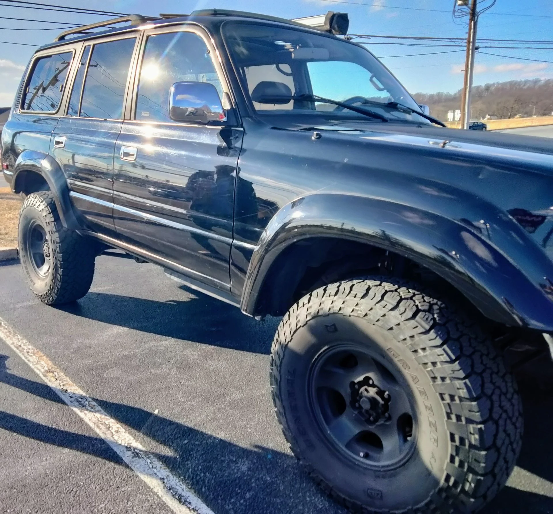

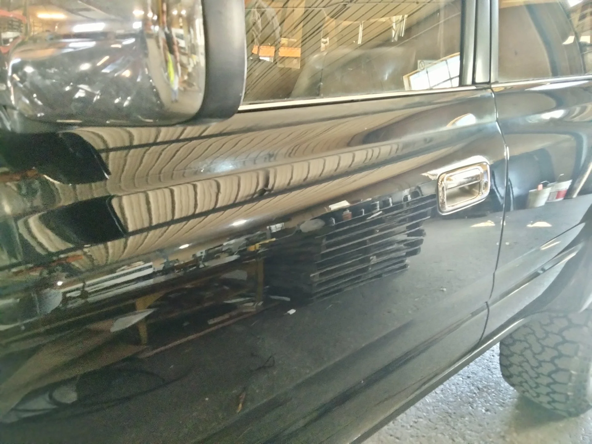

Put a bit of shine to it, quite surprised at how good it turned with minimal effort and a sloppy cut and polish job. My driver door was super oxidized and it looks way better now. Was the first time I've done any detailing to the outside since ownership sadly...
Remove the old antenna and then tape the antenna cable to your old fm antenna from inside the cab really well and pull it through the firewall. Mount the new antenna mount to the fender. Then attach the cable..

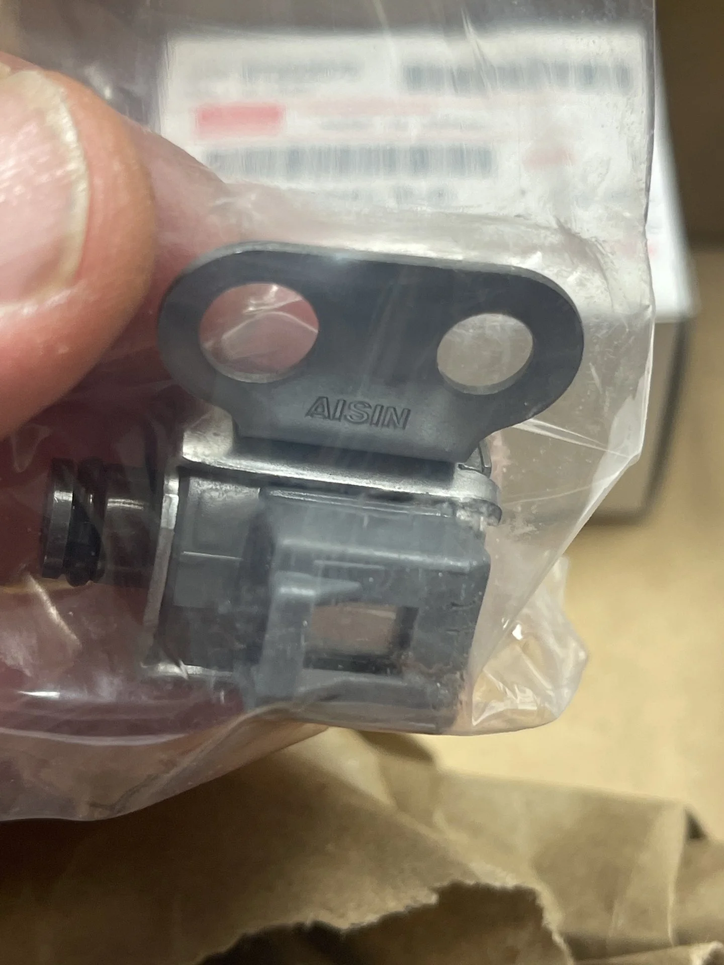

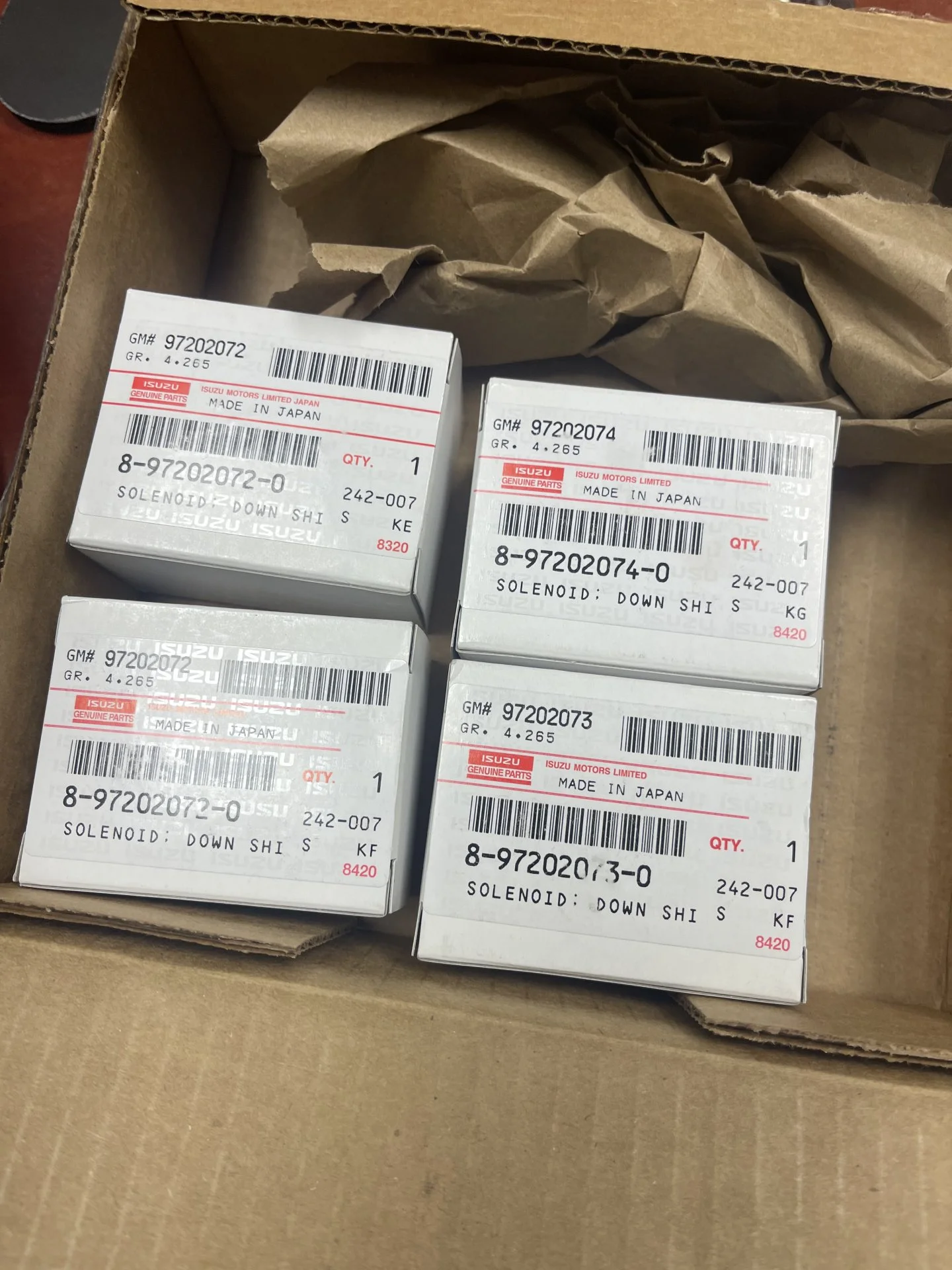

Specifics on the vehicle tranny. 1994 a442f. 4 solenoids from Amazon $25 per piece. Cheaper than from Cobra Transmission and certainly cheaper than from the dealership. Boxed as Isuzu OEM parts, parts marked as genuine Aisin. I know this has been covered in the past but figured it doesn’t hurt to share it again.
Update. It’s been a few weeks since the repair. Trans is working flawlessly. What led to the repair? In a slow acceleration situation, such as after picking up a drive thru order, I noticed zero idle torque induced movement, like I was stuck in a higher gear. When I hit the gas from there, the engine would rev high as if starting from 2nd.
This happened intermittently so I left it alone until it happened at a stoplight and the OD light started blinking. Having an OBD1 truck, I jumped the port terminal wires and it came back with a “62”. “Shift solenoid 1 disconnected” (something like that).
Minus breaks, I could have had the job done in 2 hours. The most tedious part of the job is draining the trans.
Luckily, I had a nice gasket in place, no cracks and still very flexible so I reused it. If FIPG or silicone were used, it would have taken much longer.
