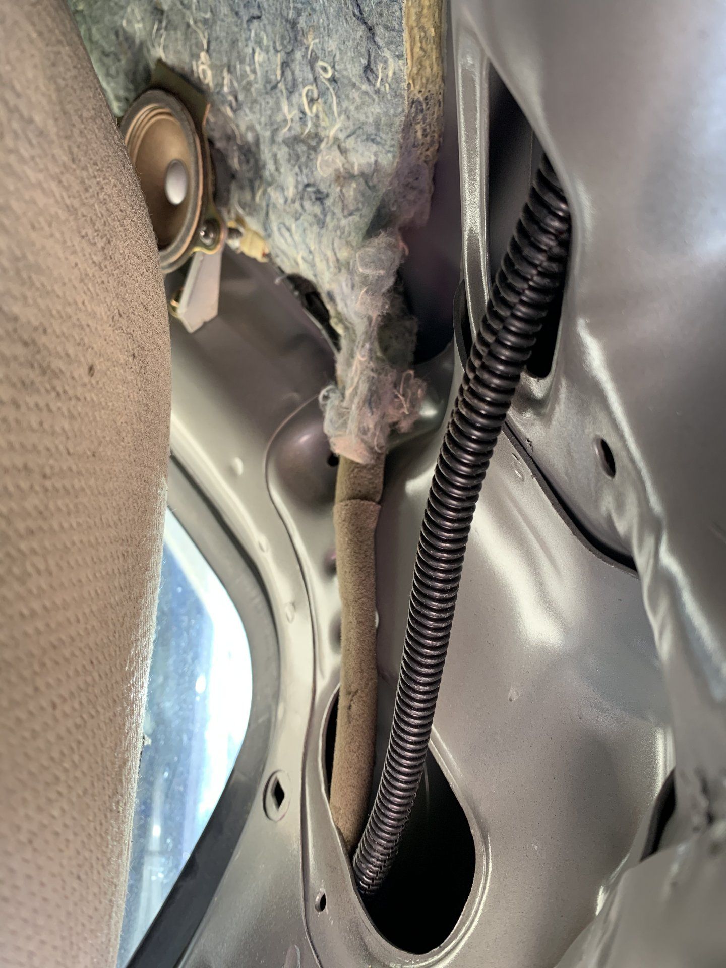

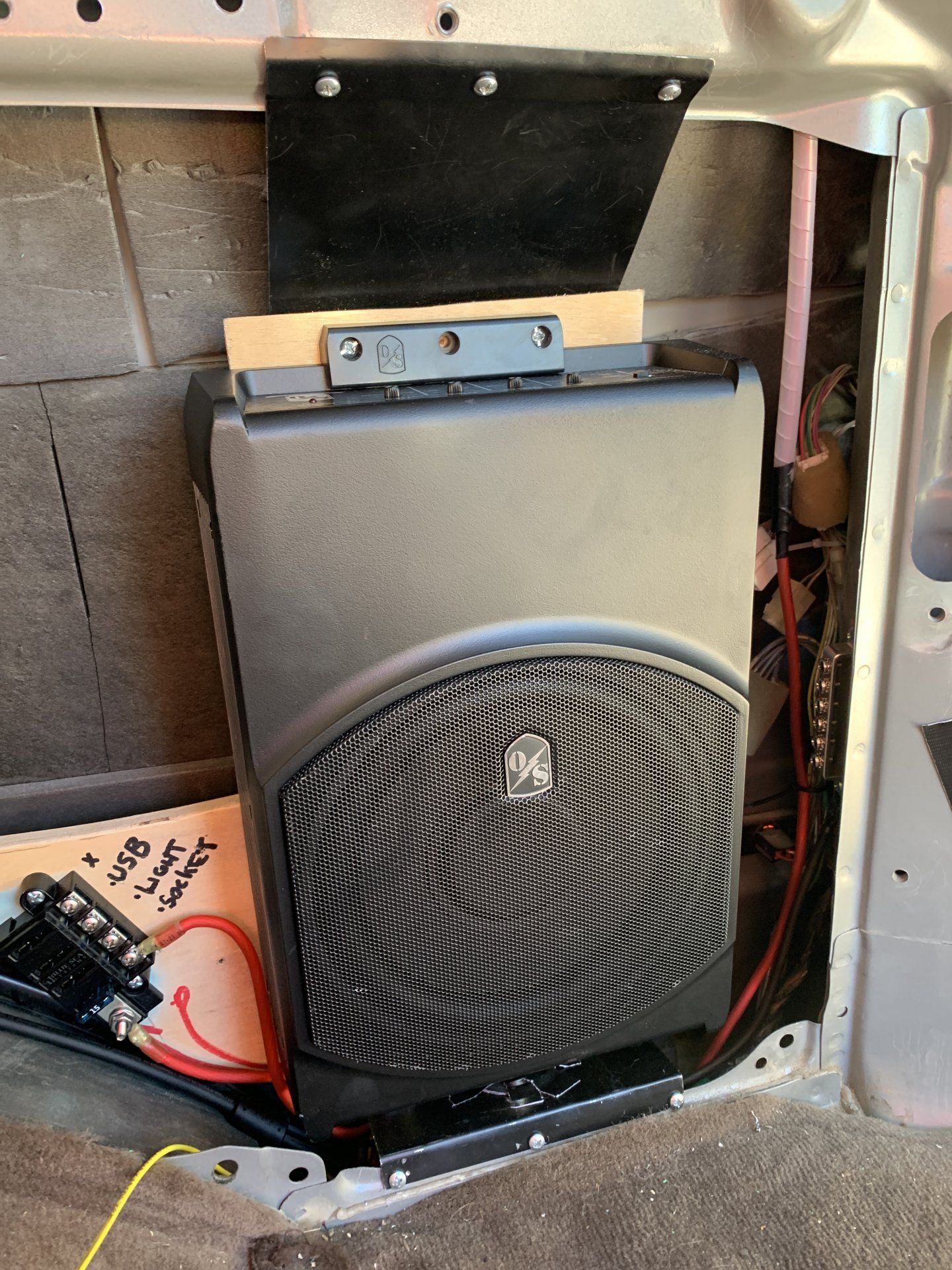

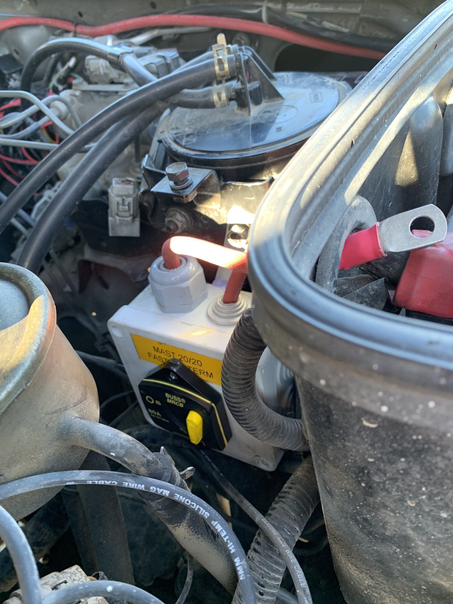

Wiring. Barf. Always takes longer by 3x., I had an old marine waterproof junction box so, made a bracket to mount it to the CC canister bracket. Mounted the blue sea breaker in the box, ran the 4awg to the back. Split the power on right side so I can eventually put a fridge in, ran a line over the hatch headliner down to left quarter. Mounted sub. Now need to run speaker cable down the other side to head unit. Mounted a ground bus in the back too. Blahhhh.
Oh, have to buy more cable jacket for the 4awg before I can button it all up. Still need to wire up the usb / cig lighter panel too.

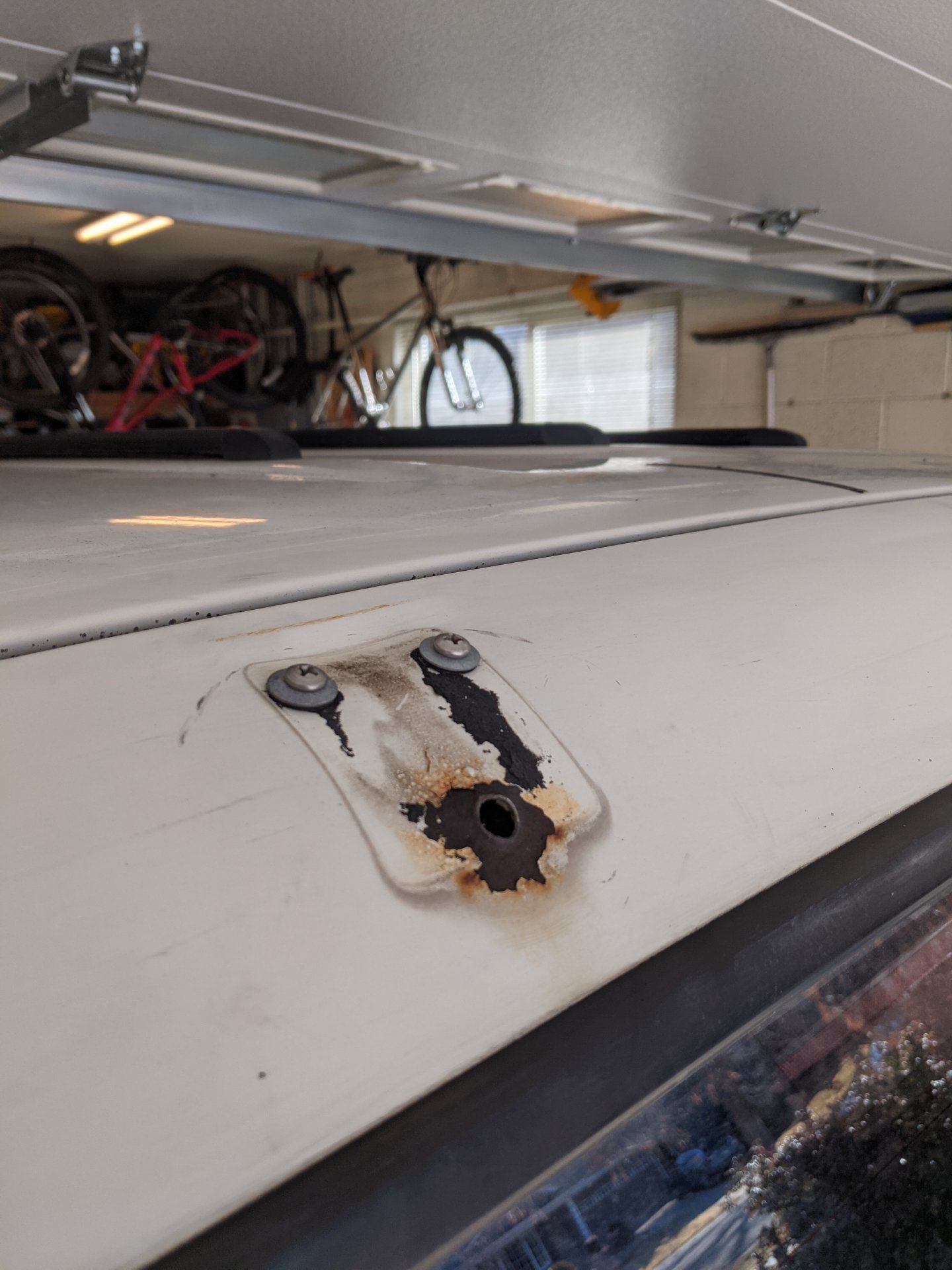

A few days ago I was started down the rabbit hole of chasing leaks, when I was up on the roof checking my drains I noticed this.
So today I went ahead and pulled the roofrack and addressed this issue.

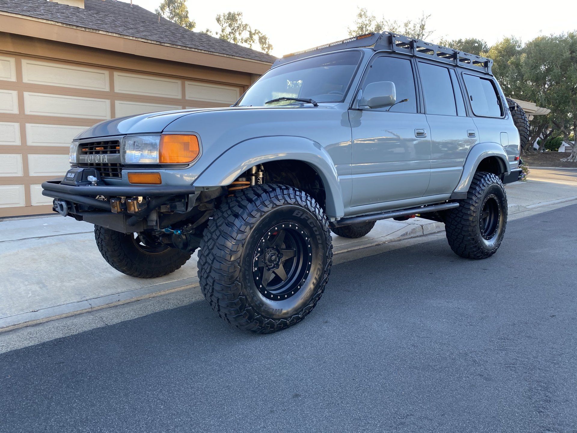

I have been ignoring my 80 since getting my 200, I Had it detailed and gave it some love
Is this the rig that basically got a full restoration about a year ago. I love it it either way. Seeing 80's like this made me decide that I am going to try and do this in another year or so.
That is one good looking rig.:clap::clap::clap:
