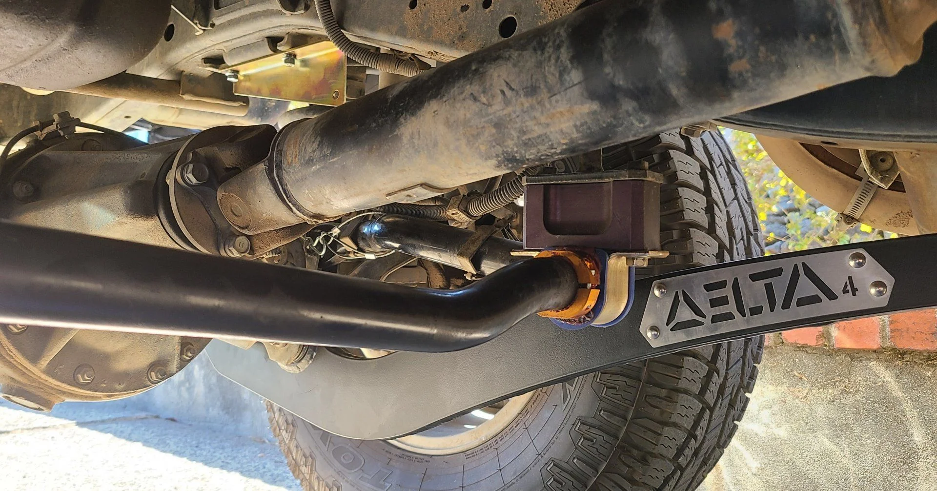

Fixed a front end clunk I've had for a while now. Simple really, the front two bolts were not torqued to spec on the radius arm/axle. I recently discovered that my 1/2" torque wrench is busted and inaccurate, so I'm now a little nervous about what else I might have used it for. I don't think I've used it much, thankfully. I use my 3/8" for most everything under 100 and haven't had much to torque above 100 lately (got the big 300 lb wrench in anticipation of the front main).

I’ve got a clunk too. Could you tell what it was at first on a lift or did you just start torquing bolts?

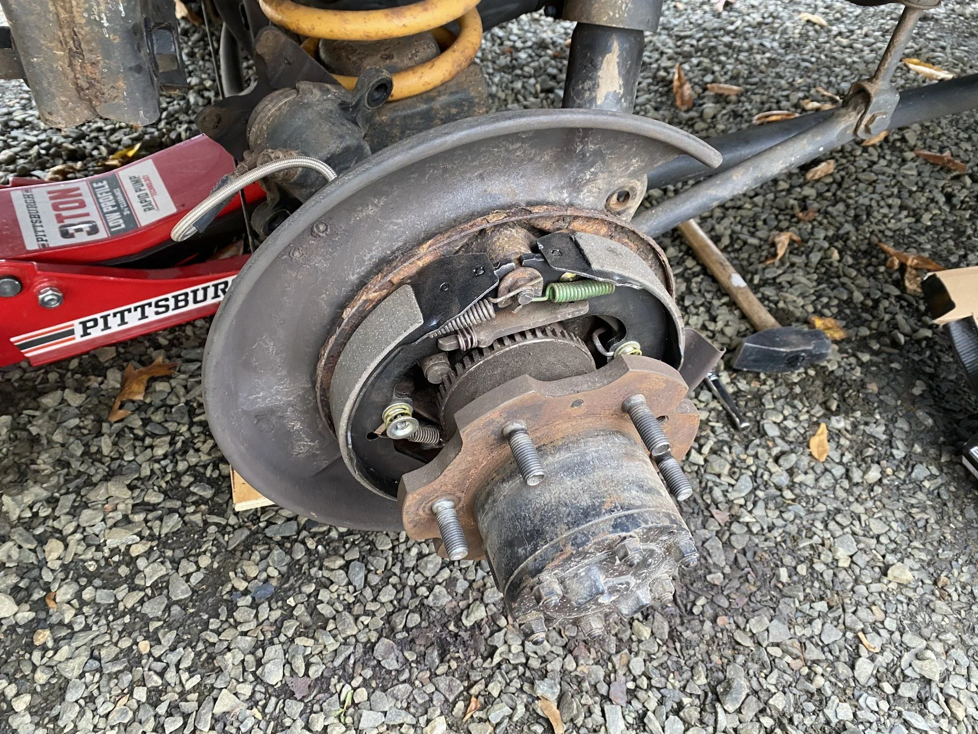

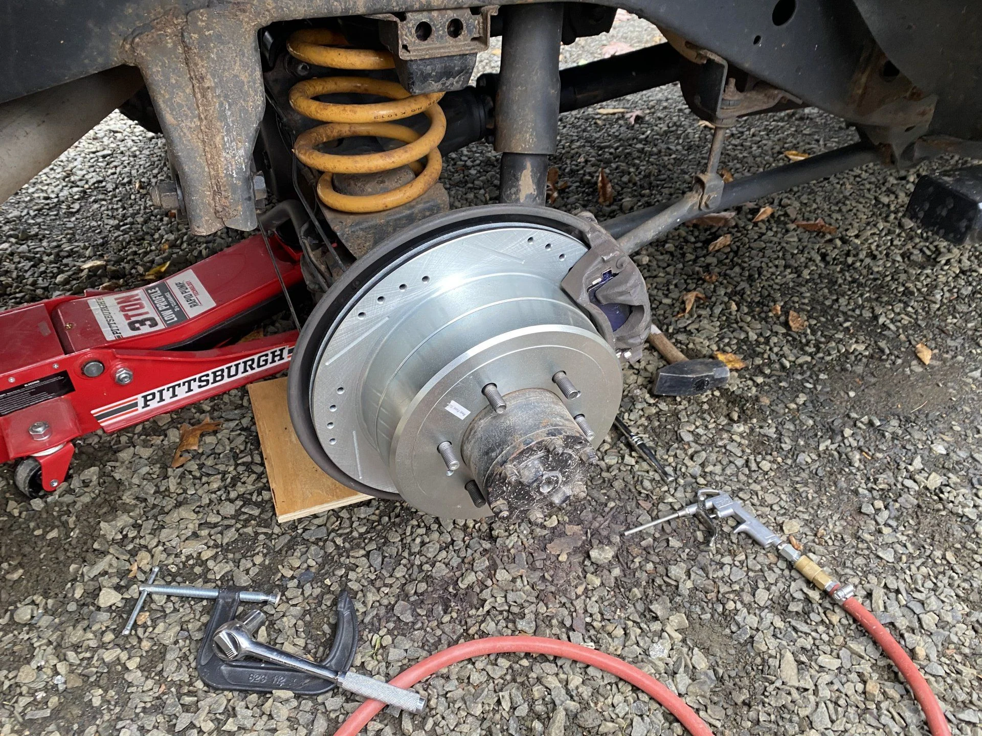

Rebuilding knuckles on my junkyard donor axle.

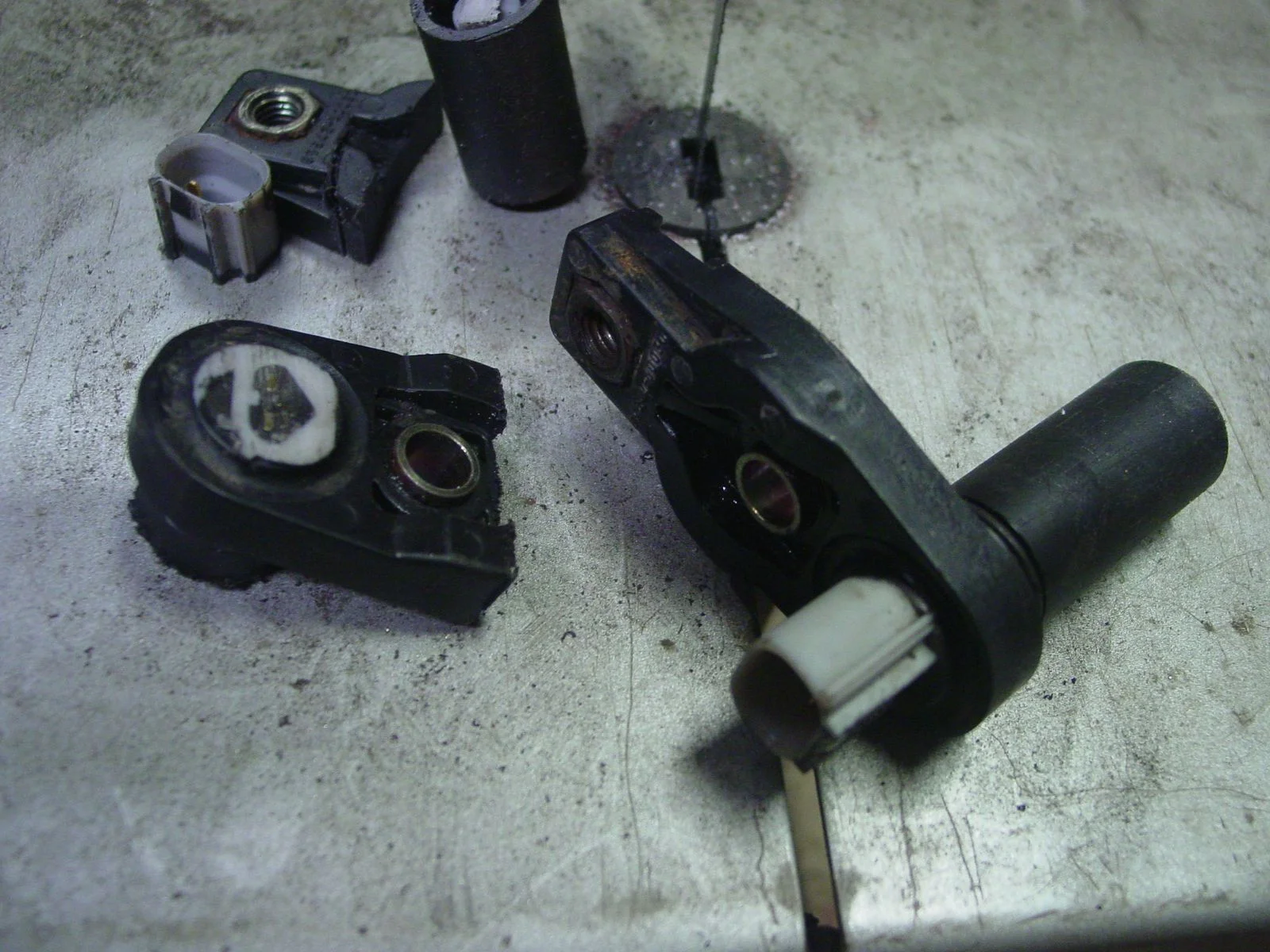

No pics of knuckles, but used the little bandsaw to turn the 300k mile ABS sensors into ABS sensor delete plugs.
Great solution
We offer ABS sender plugs for those without a bandsaw at $10 a pair shipped
I first replaced my swaybar links (the ones that look like little ball joints) because I have beat them up working under the truck and figured they needed replacing anyway, but that didn't help with the clunk. I also pulled the swaybar and the front driveshaft for diagnosis, but nothing there either. I read up on MUD and found loose suspension bolts to be a common theme in front end clunk, so I just started tightening bolts et viola! 130 ft pounds is a lot of torque, so I'm betting my faulty torque wrench only got them part way there, but the clunk didn't appear until after I had done some miles to loosen things up.
I couldn't tell by wiggling/jiggling or looking, but as soon as I put the wrench on them, it was obvious they weren't very tight.

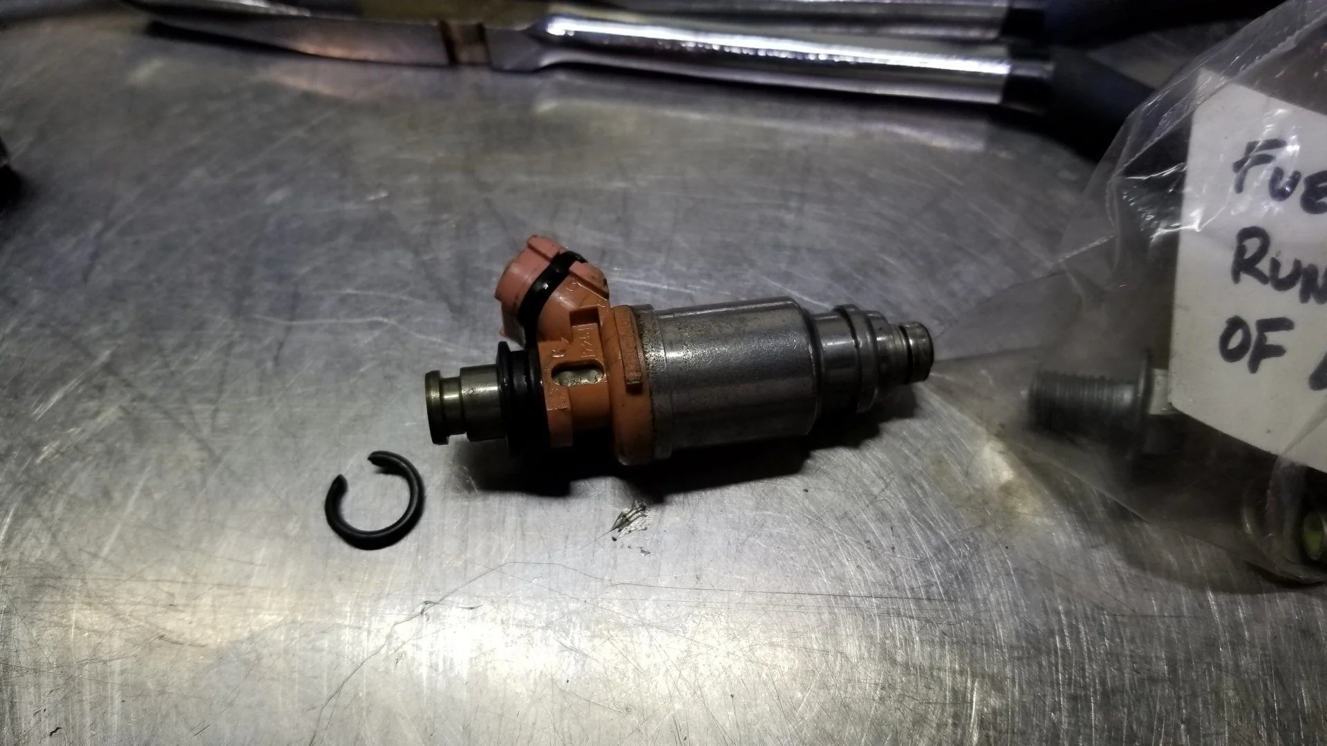

Took the LX for state inspection and the garage told me I had a significant fuel leak from the #1 injector ... :cry: I have no sense of smell (not Covid related) and could not smell the fuel, but could see it streaming out once I knew where to look. Lesson learned, if you do your head gasket and notice the truck taking longer than normal to start while cranking it, start looking for a fuel leak.
An entire head gasket re-build taken down by this ...
Disassembled everything needed to replace the o-ring, luckily I saved the old ones as just in case. Took me 2.5 hours to get the washers and banjo bolt back into the fuel filter, such a tight fit from up top and I don't know whose arms could fit in from the wheel well or what knuckle dragger can reach it from their back underneath either.
Once the upper plenum was back on the hard part is over and goes quickly ... except when you accidentally pull off the 12mm socket from the extension when tightening the lower throttle body bolts and the socket disappears into the abyss and doesn't hit the floor. Took the TB back off and looked for it from all angles ... GONE. It belongs to the truck now. I will let it keep it as a trophy for surviving the repair process.
Just got the call now that it is done and passed inspection now. It's been down almost a year for repairs. Hoping it lasts a good long time again now :cool:
