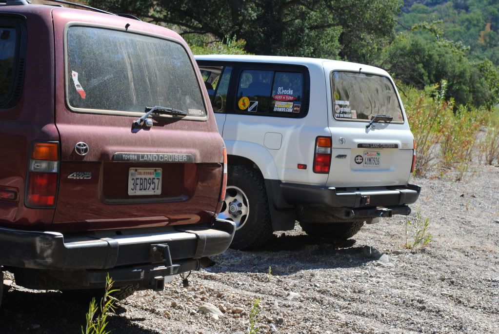

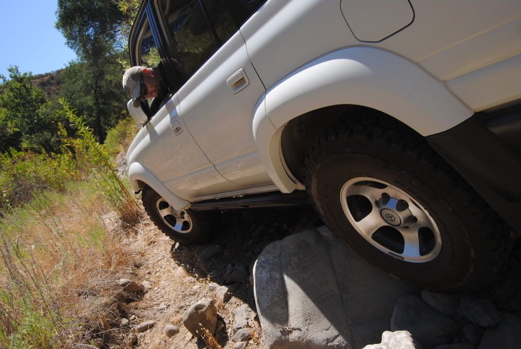

Me and Mazder went out to rock front ranch Sunday, just a good half day drive, nothing crazy except for the large rock in the river bed.
Video on how i did it later haha..
Oh yeah thought that looked familiar, LOL.:D
Would like to see that GoPro footage....

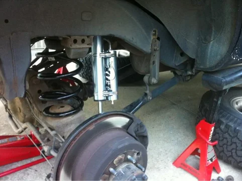

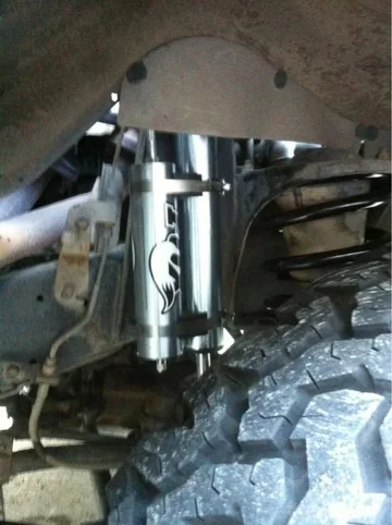

This weekend I finally installed my lift and some fancy shocks.
Now I just need to sort out a wicked lean to the ps front.
You may have switched the spring sides inadvertently. IIRC they are side specific. My ome 850/860 setup had a lean until I switched the fronts around.
I installed 850s/863s. I followed the Slee instructions and I have the A's on the ps and the B's on the ds. I'm going to take it out this afternoon and find a ditch to flex it out to make sure the springs are seated well.
wow nate thats gonna be bad ass when all said and done!
I'm curious too. My recent experience moving from 850's (220lb/in) to 418's (300lb/in) convinced me that the 850's are not strong enough for a Cruiser with bumper/winch/ec... But, I'm sure better shocks will help. ARB is supposedly importing a ton of new suspension stuff this Fall. Maybe that will include a 2.5" heavier spring than the 850?
