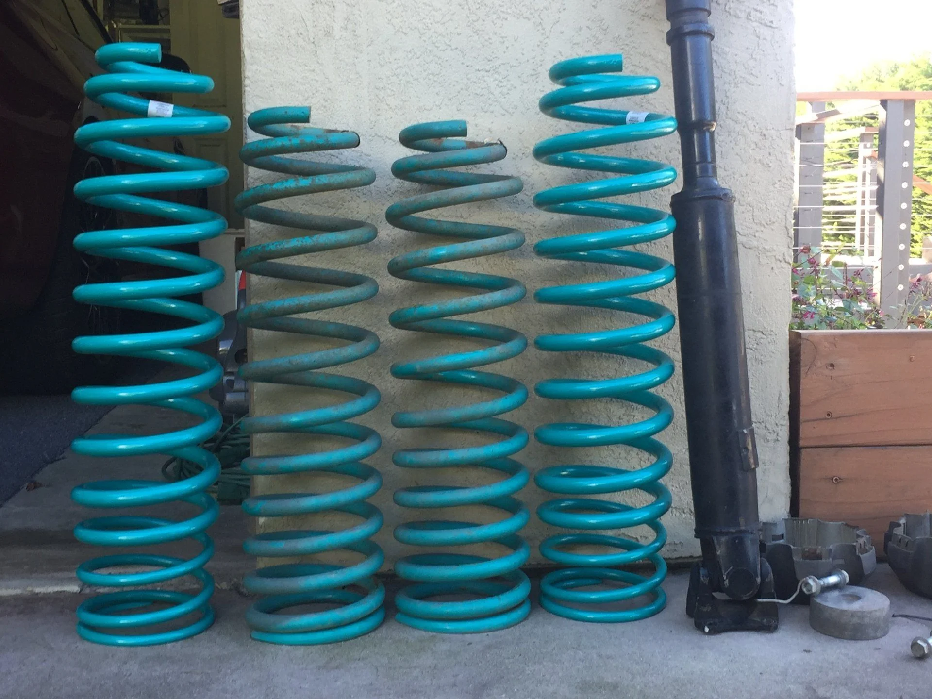

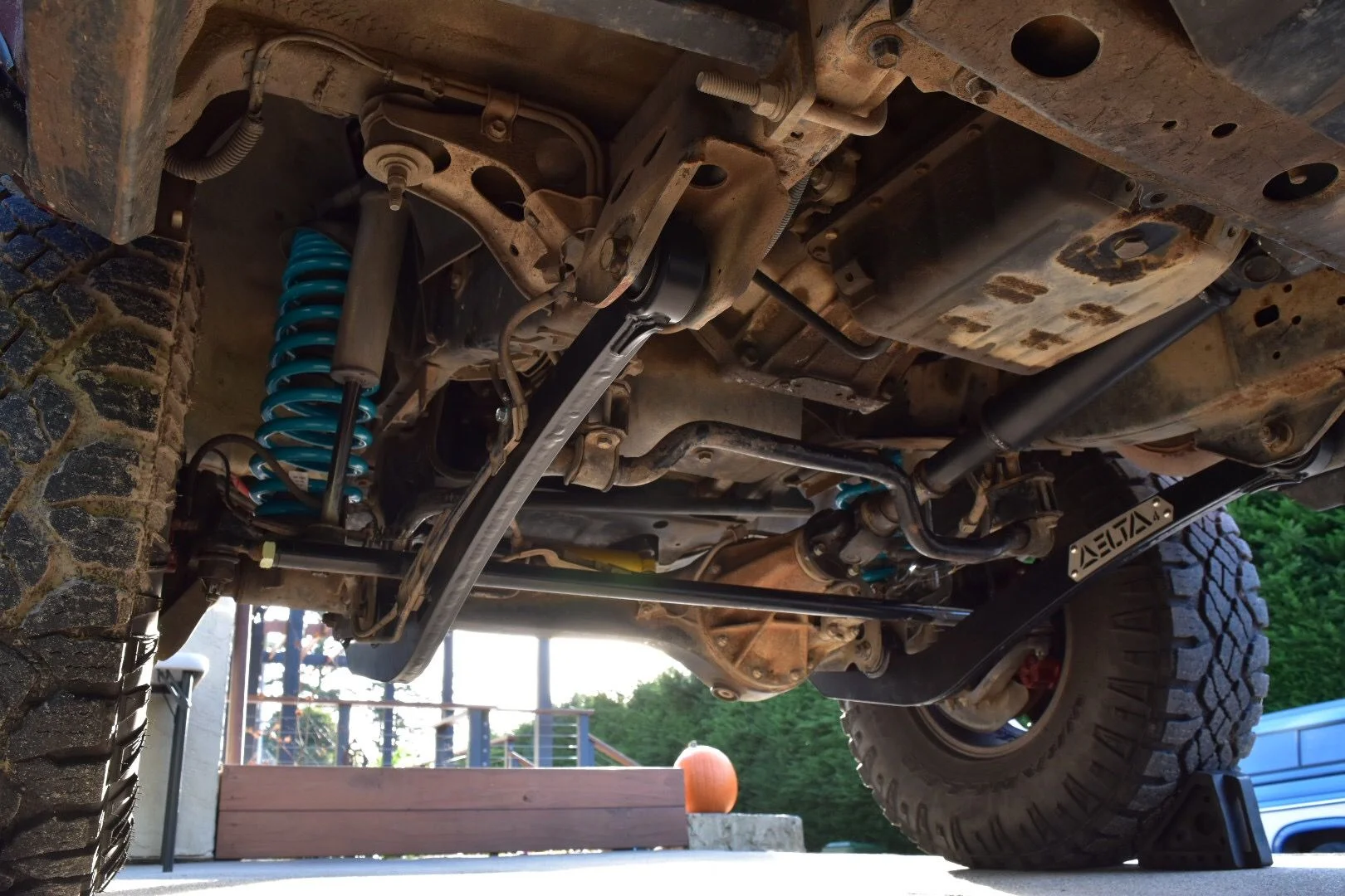

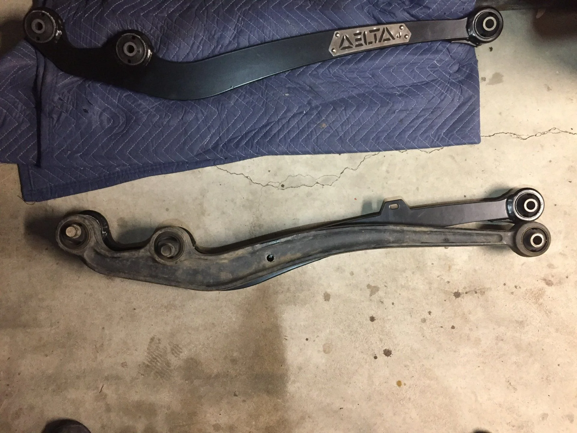

A couple weekends back, addressed some suspension issues once and for all.
-2.5 caster bushings need replacing every couple years and only get me close to 2°. I want a better solution.
-3” flexi front coils (180#/275#) are too soft for a heavy truck like mine. Need a stiffer rate.
-Front driveshaft angle not ideal at 2.75” lift and I was getting some vibes. Shaft had some spline play as well.
Went all in and solved these problems by raising up 1” to a 4” lift. Threw in a Tacoma DC shaft built locally, 3.5” Tapered front coils, and Delta radius arms. Added a 30mm coil spacer in back to correct stance also. Truck drives so smooth now. Easy to handle, firmer in the corners and vibes are gone. I don’t expect to have to touch my suspension for a while now.

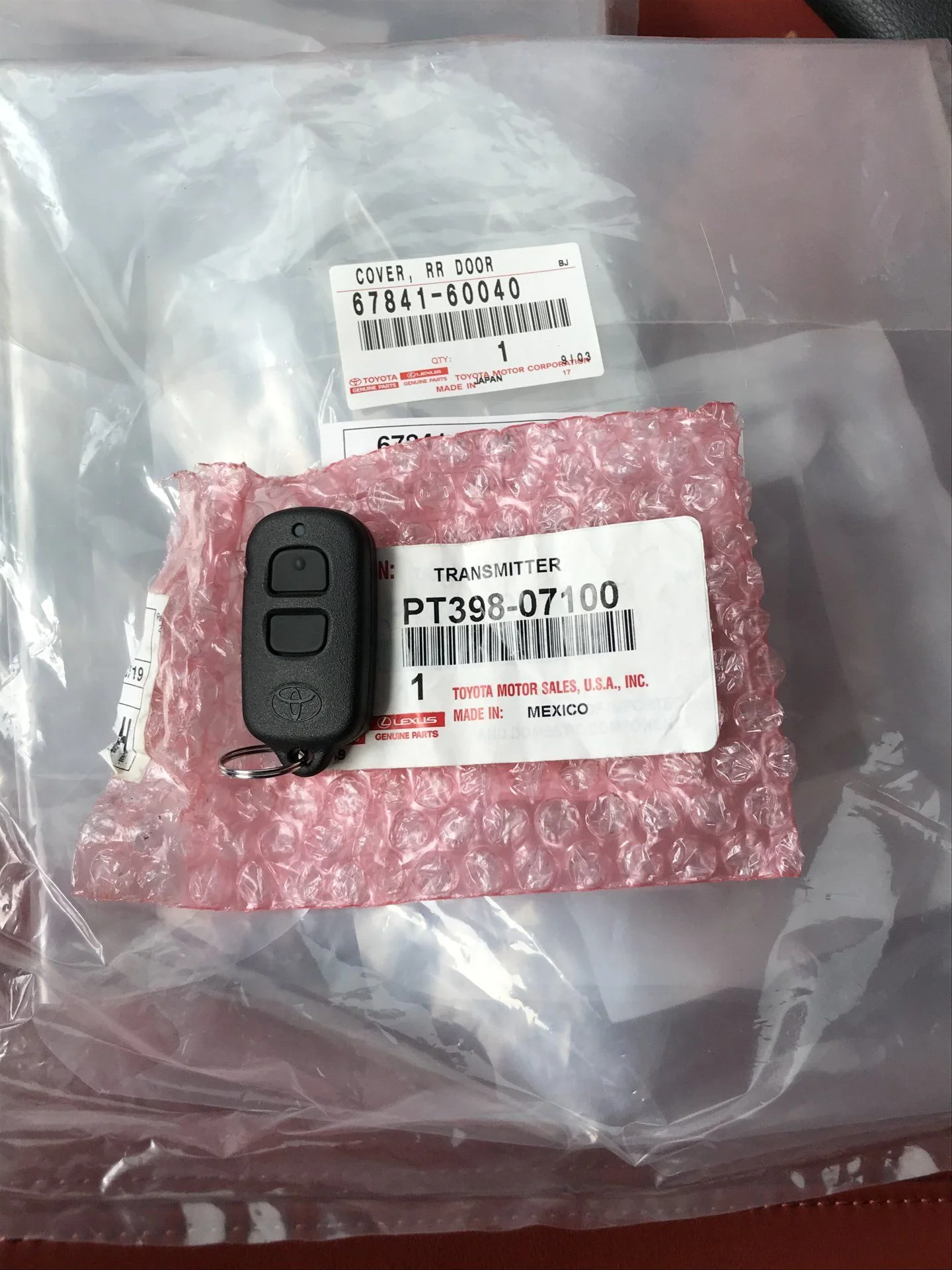

Hecho en Mexico (just like the 23 year old original)
Edit: Verified it works so I now have three working remotes (1 new OEM; 1 original OEM; 1 aftermarket)

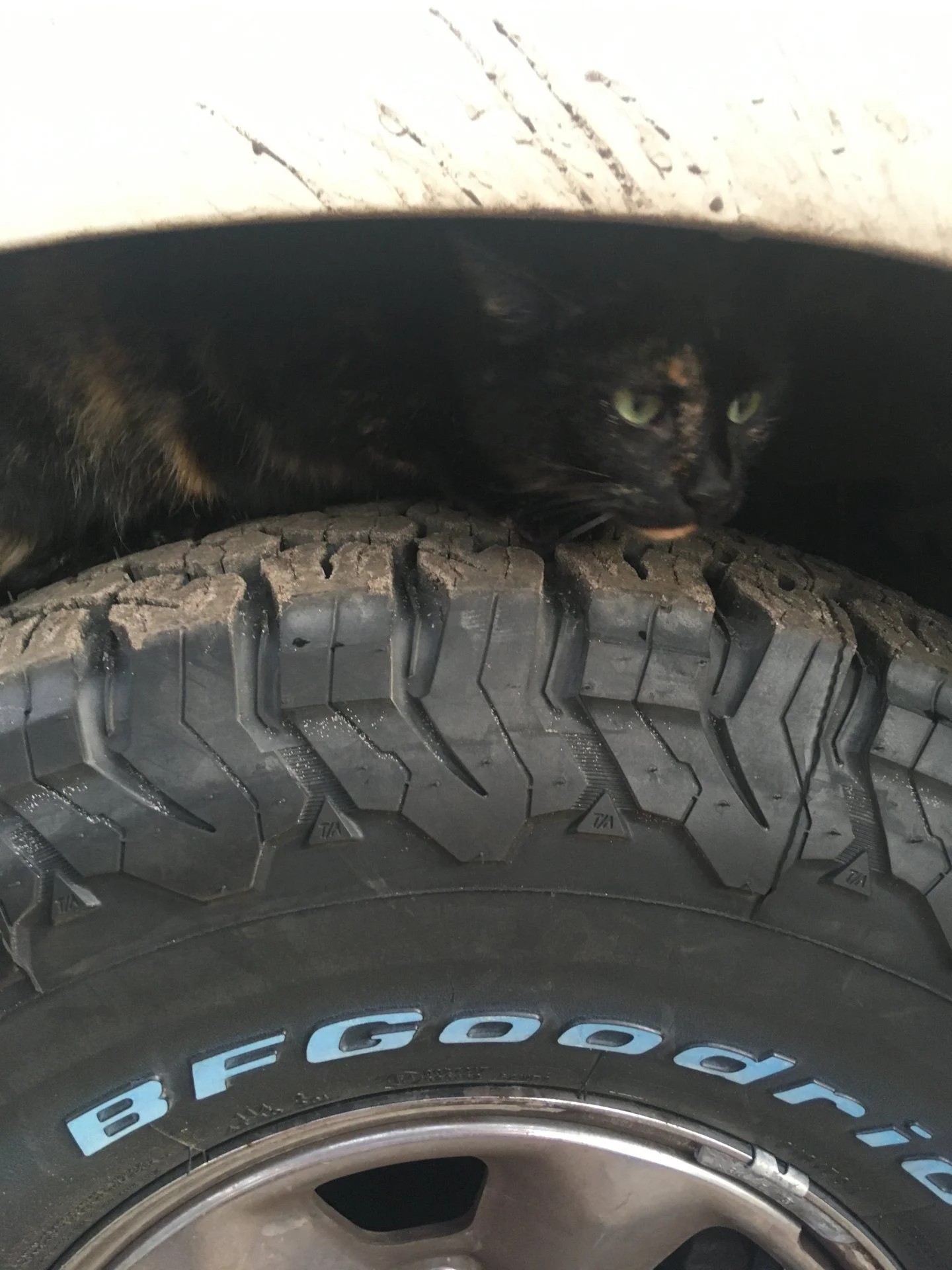

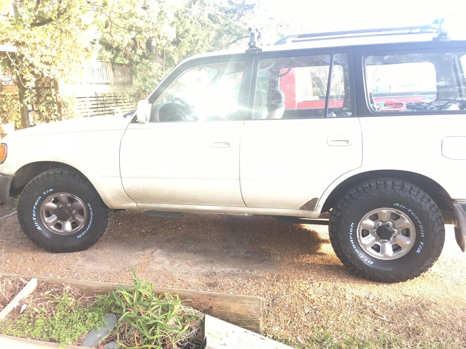

I got my 33x10.50 15 Bfgoodrich all terrains installed while I was at work! they look way better than I thought. I should have installed them when I got the fj80. no lift stock suspension except new ome shocks. I don't really notice any loss of power (what I was most worried about) I think I can tell when I am driving at 75mph but 0-55mph no difference. I think if I replace the springs I will only do ome stock height for sure. The cat likes them.

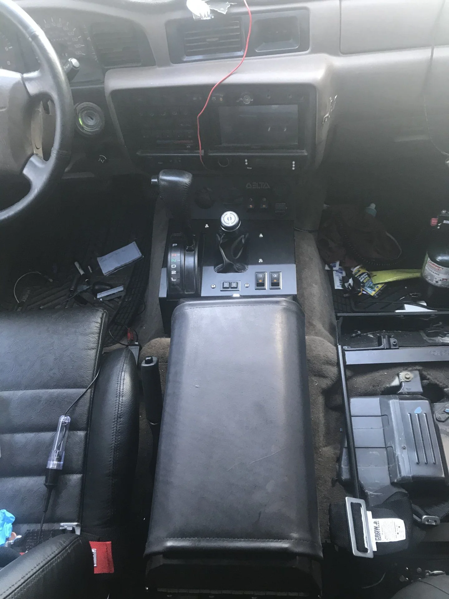

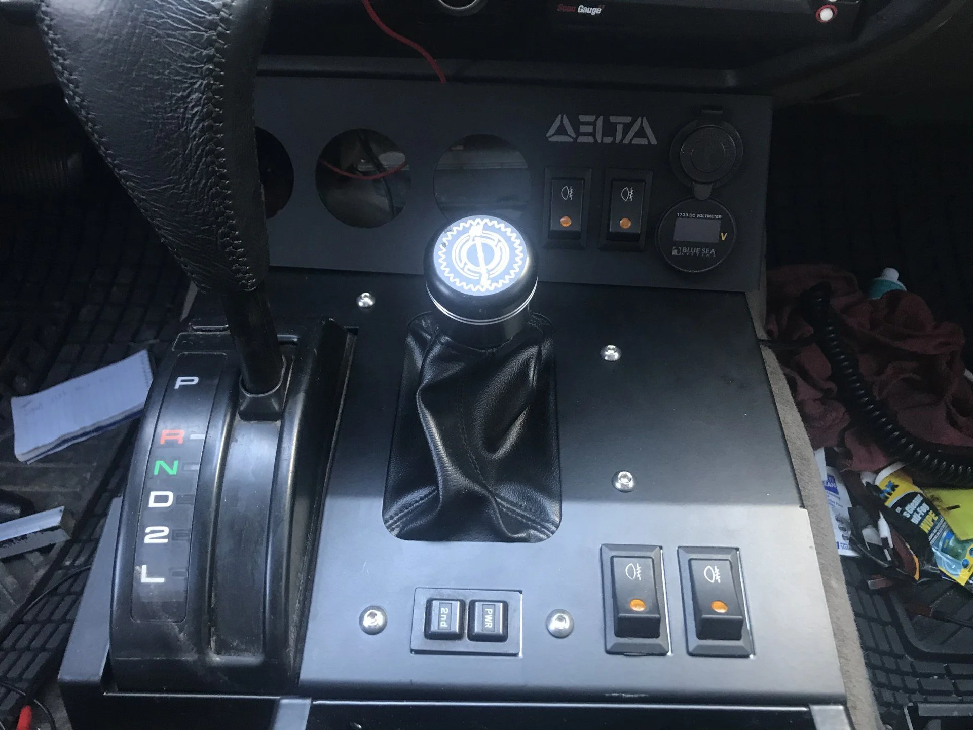

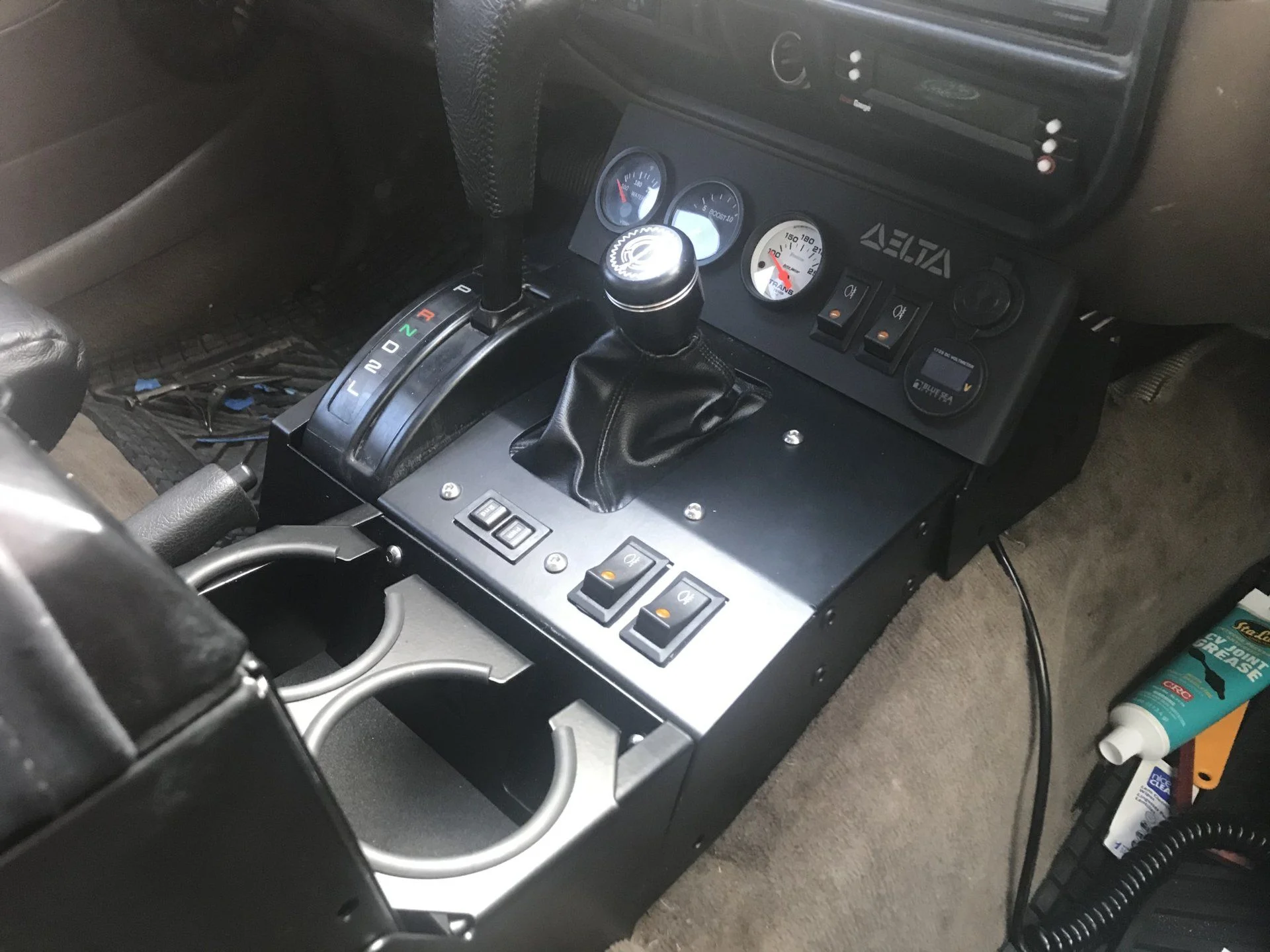

Wired this mostly and installed the delta console crowds the shifter a little more than tuffy. But it is sweet otherwise
tranny temp gauge, water and boost
