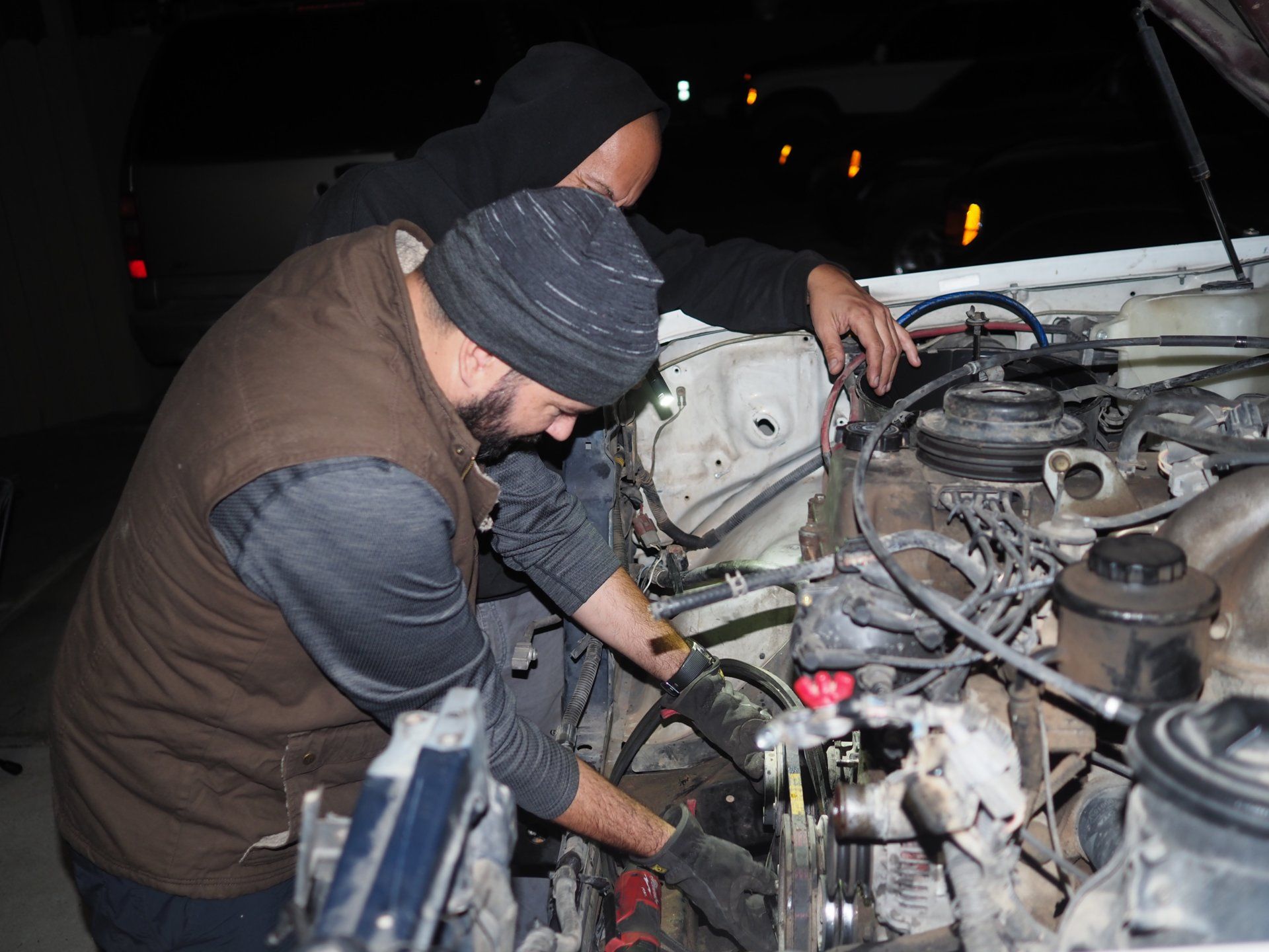

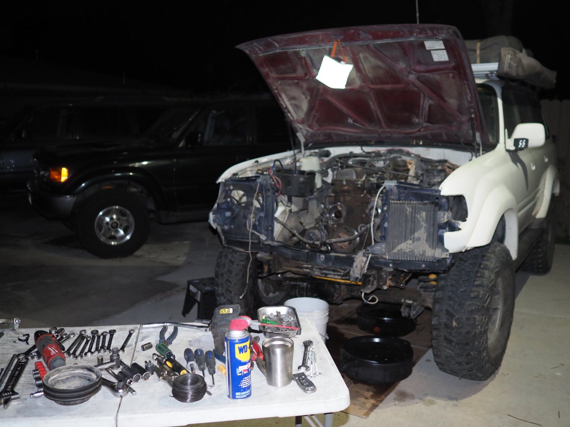

Been working on chasing down oil leaks and general maintenance
