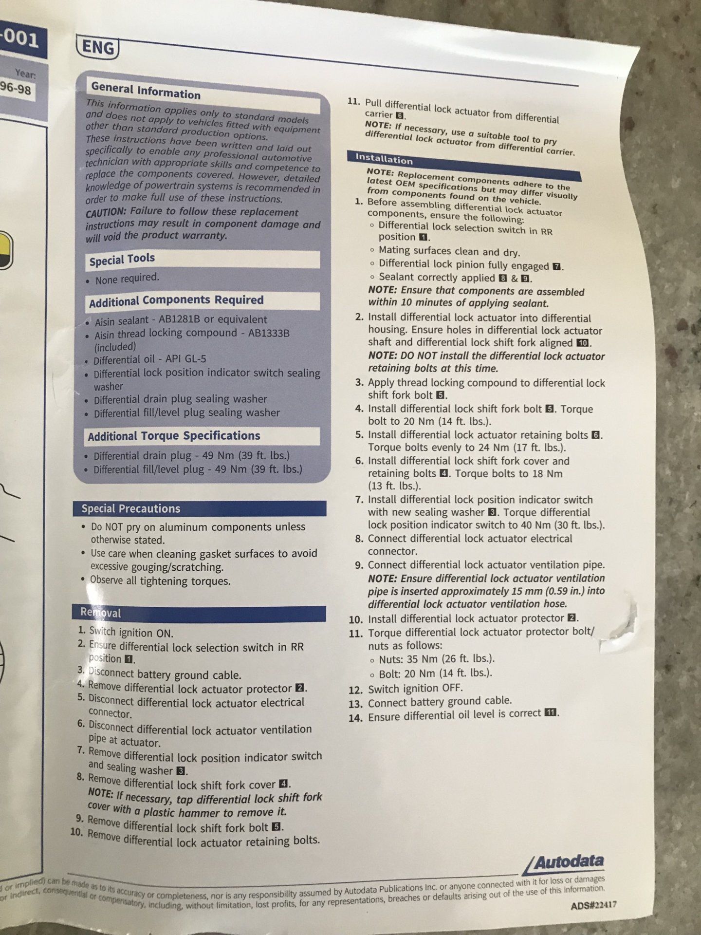

New rear diff actuator, CB radio and 4’ firestik, 7pin mod. Came across a nifty set of instructions and bolt torque settings on the rear diff actuator from AISIN that I thought I would post up for others to benefit. One pic is the whole 2pg document. The other two are pic of each page.

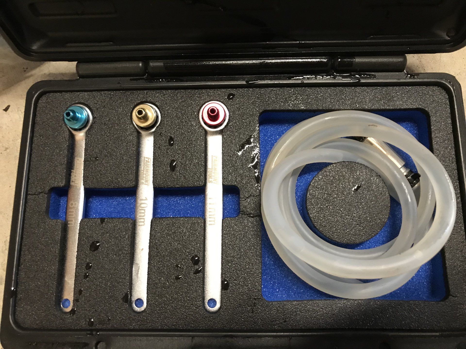

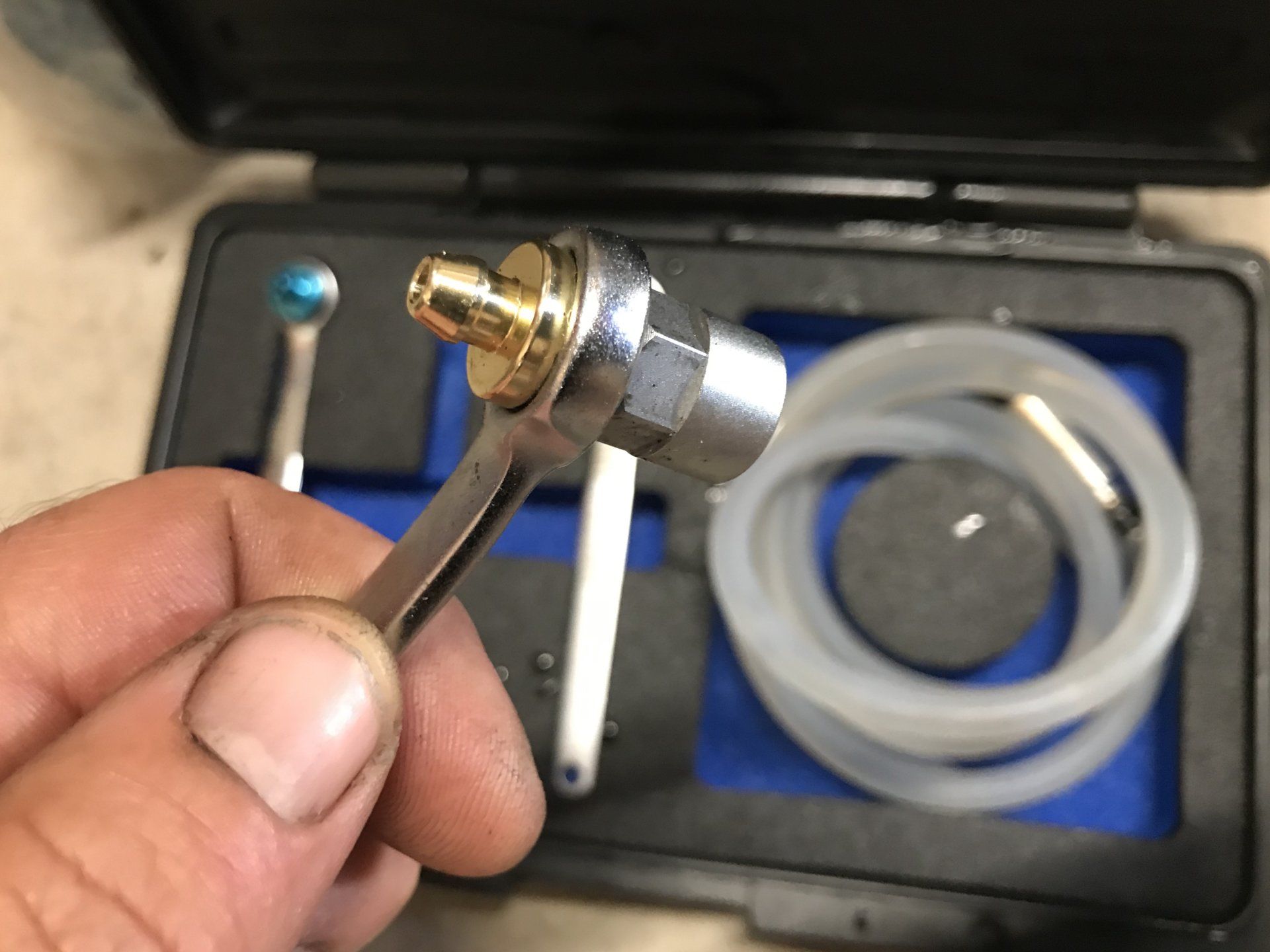

I recommend you get yourself this kit.
Best one man bleeder set up there is in my opinion.
Cheers

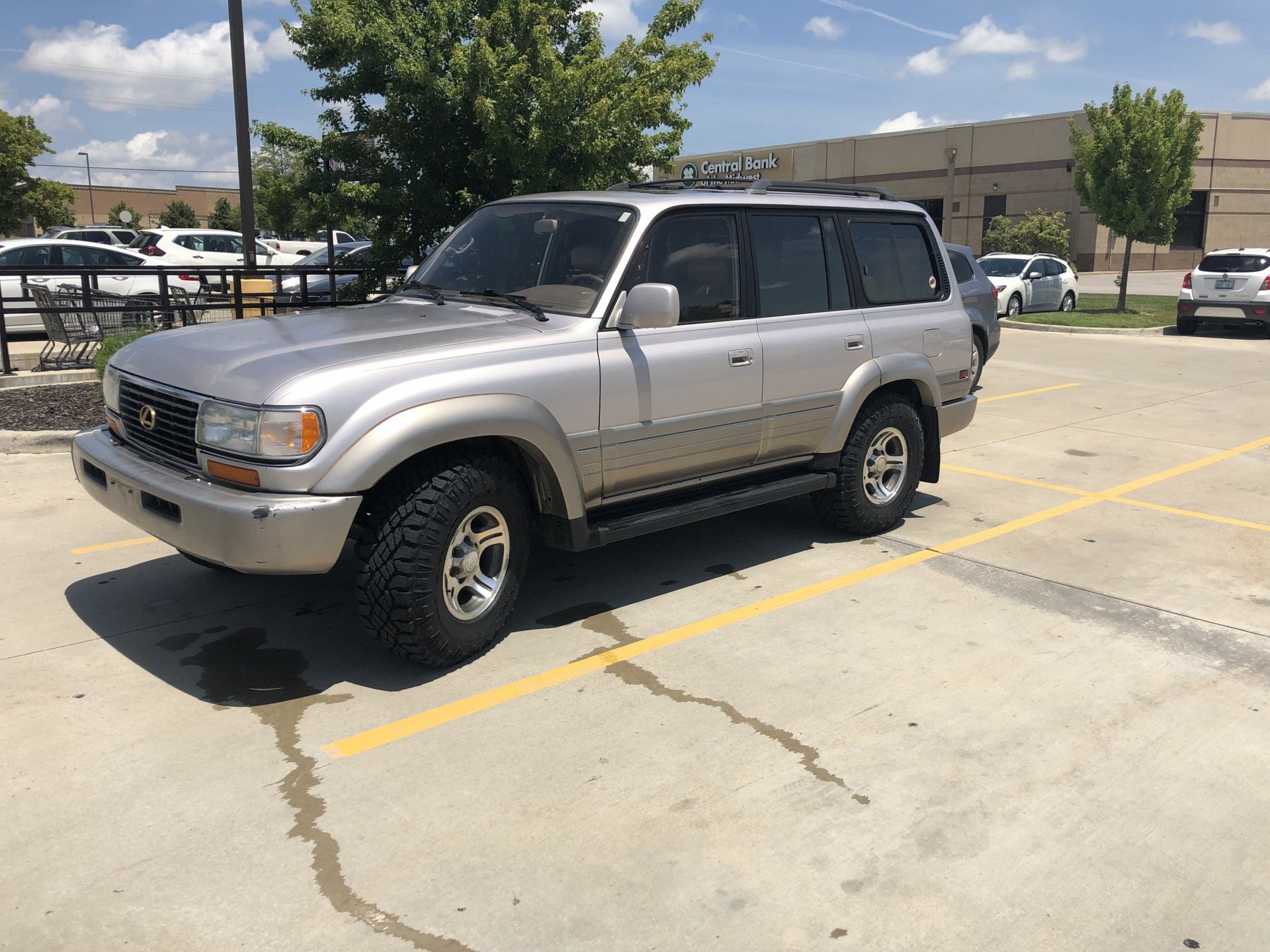

There are days like today when I do a little bit of work on the cruiser and then on my way up to the store I realize that all I really want to do is drive the Land Cruiser. It doesn’t really matter where. I just want to drive one.
So I drove one of them. Then gave Miss Sara a bath.

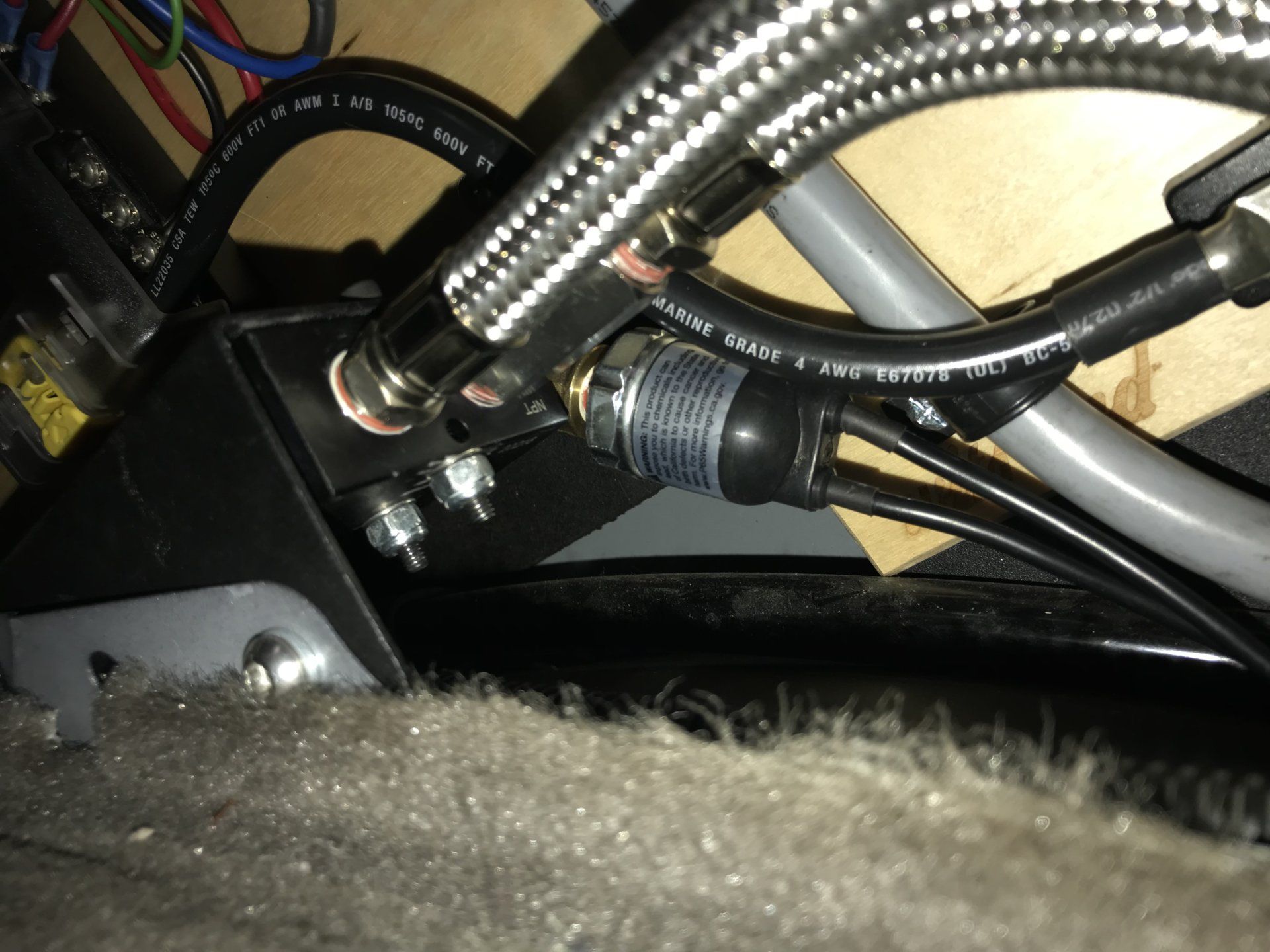

Did a little plumbing and wiring. Finally got my OBA sorted with a remote pressure switch and installed a check valve. Also got my ARB/Anderson power cord installed. And finally, got the Kicker pocket sub mounted because I used the factory sub space for my compressor. Just a bunch of little tasks that I’ve been trying to finish for months.
Nice panel detail ! Info on the pressure reg /plumbing ? Thanks
