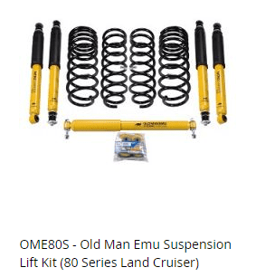

Ordered the 3" OME lift, now just waiting on delivery...
