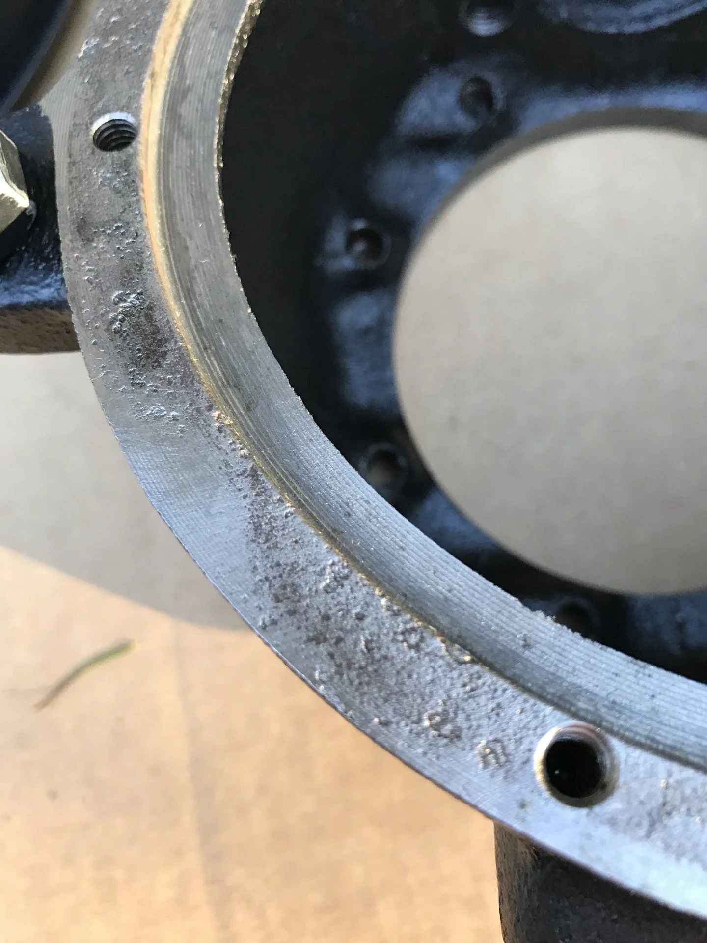

Is this pitting a problem? Wiper side of the knuckle. I may just put a layer of JB weld and sand it down.

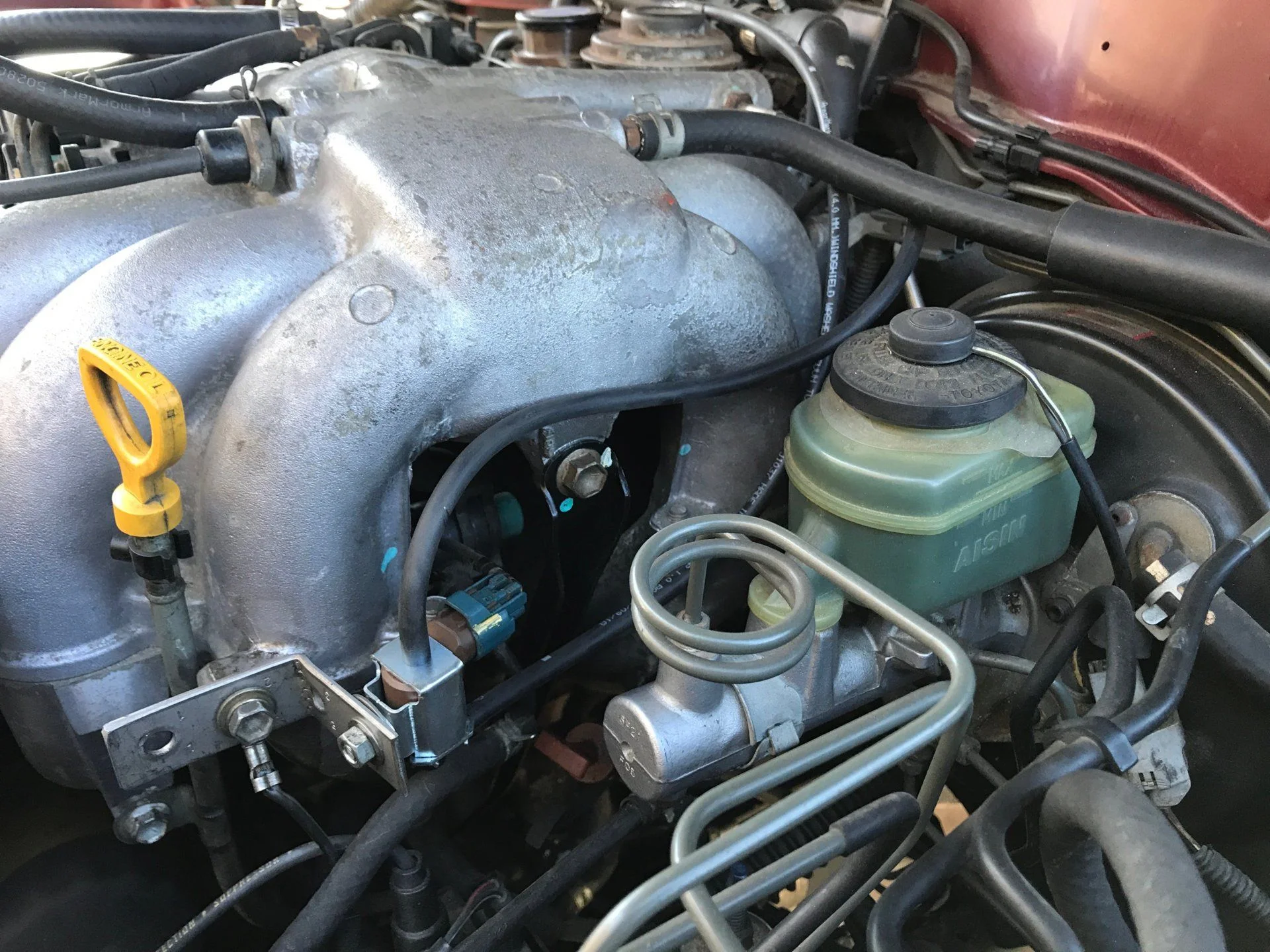

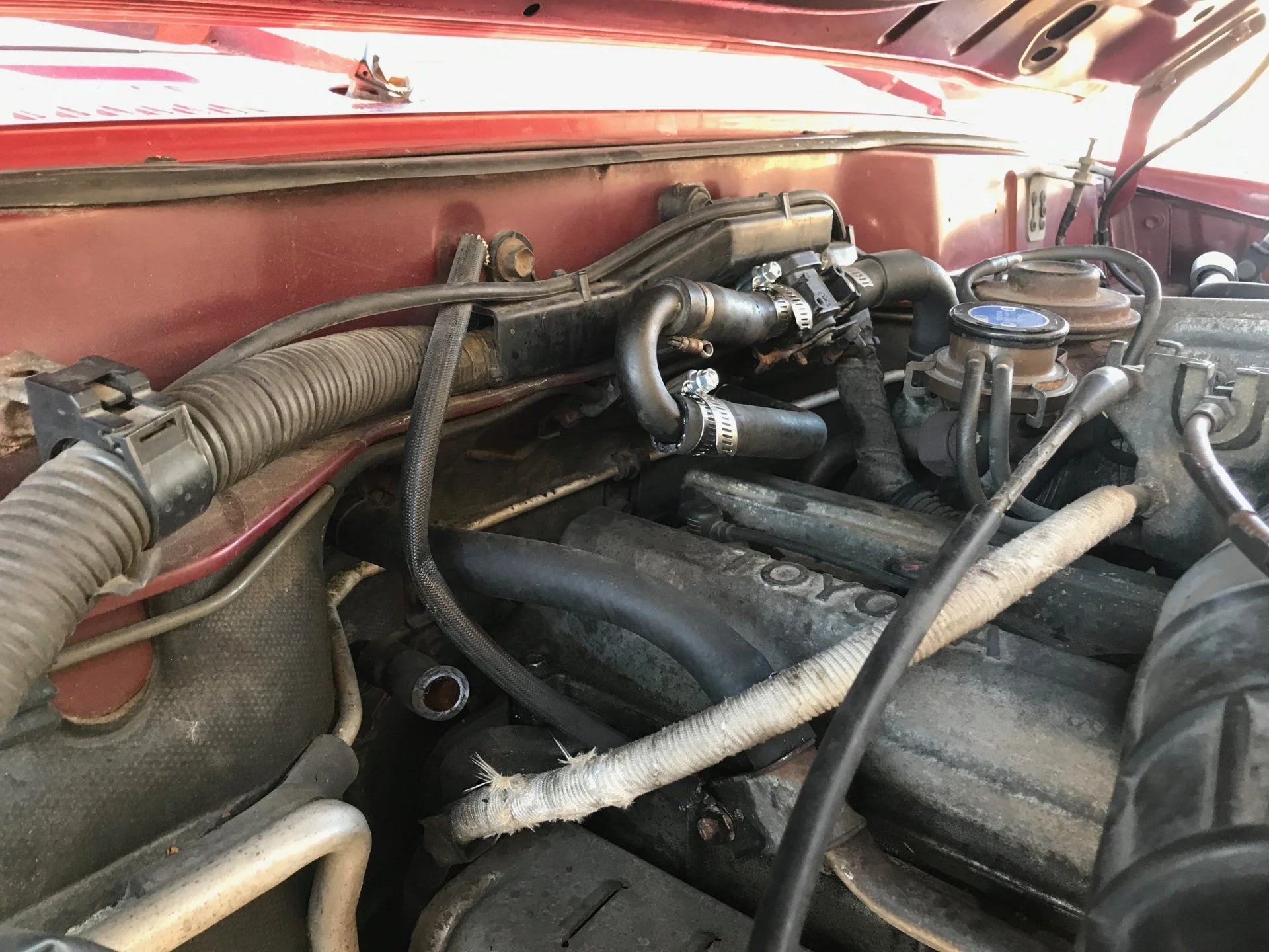

My dad and I did a rear heater bypass (completely) because the old pipes broke on Thursday and all the coolant drained out :(
We also replaced the EGR VSV and re-mounted it outside the intake for easier access.
First time I dig into my 80 so I'm proud/excited on getting this work done.
The EGR VSV code was the only code we have and hope to finally not see that engine light turn on for a long time.

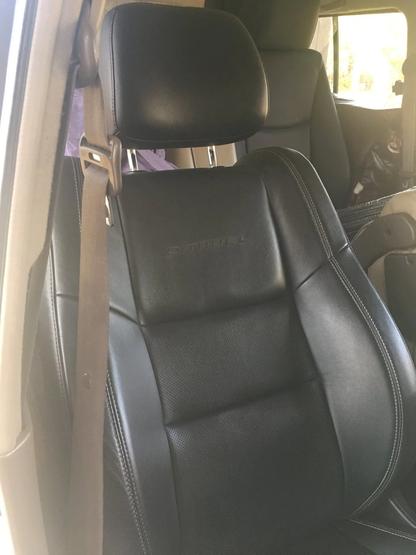

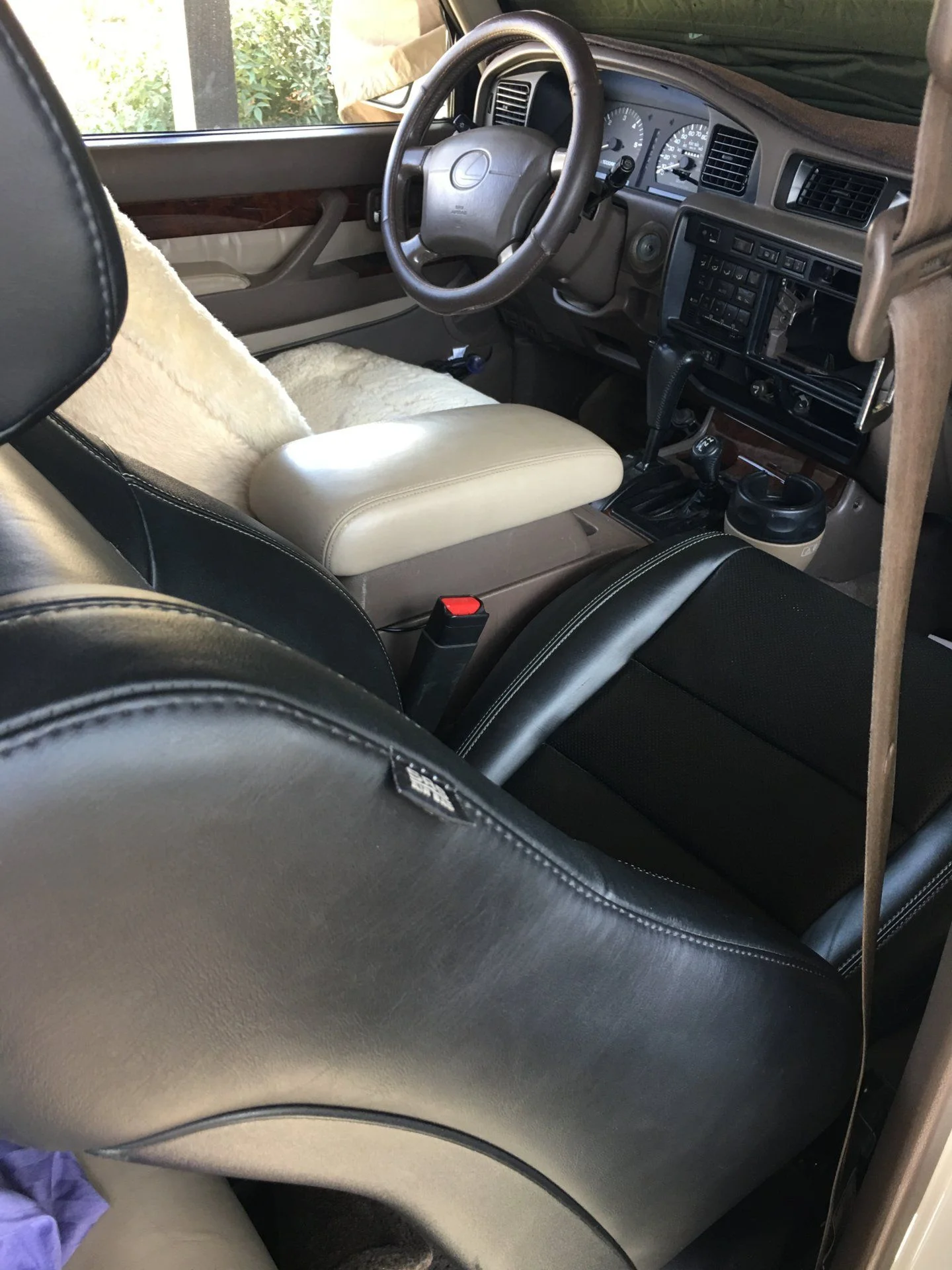

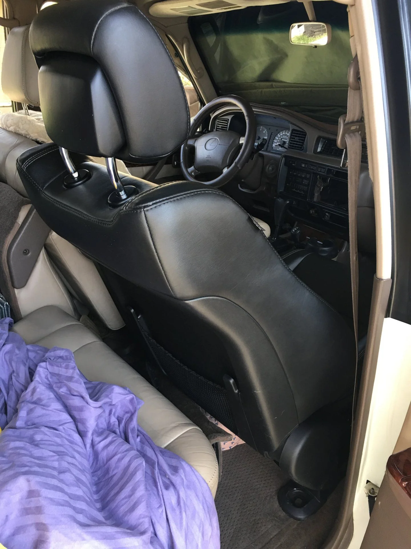

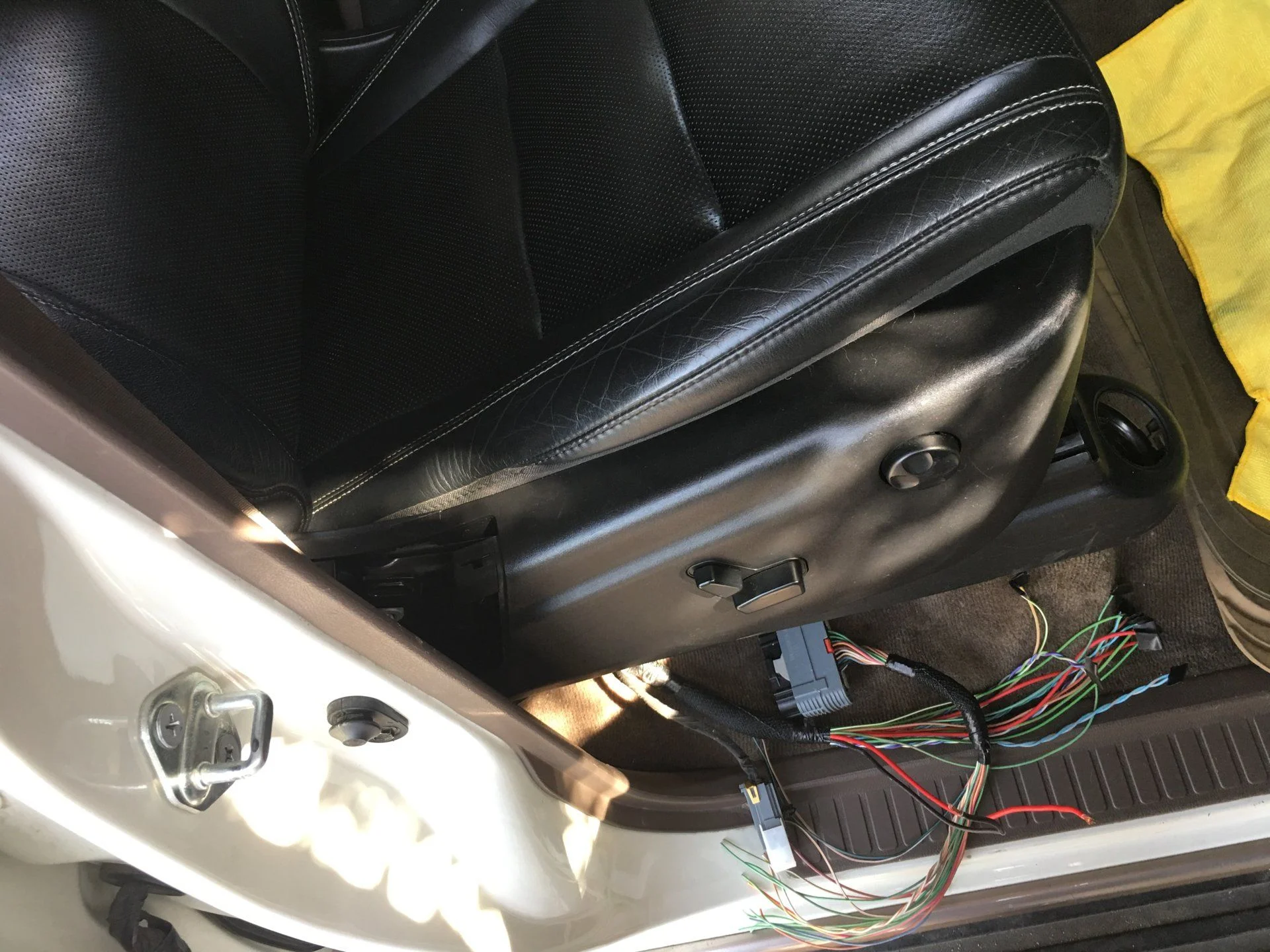

Toyed with this idea. Dodge Citadel power seats. None of the mount points line up - well, right rear hole does but then front two are a bit too far forward (close width-wise). Like the look and they are super comfortable. They come with a bunch of wires but can disconnect one harness and they require just two wires - a hot and a ground to work - up/down, forward/backward, recline.
I actually already have a set of original primo LX450 seats I could pop in but I'm saving those for now😉. Anyway, PS seat froze all the way forward so this was an excuse to check fit.
Also have some BMW and Scheel seats (Scheel, before they became Scheel-Mann) I will try out when I get some mounting brackets.
Leaning towards Planted brackets.
