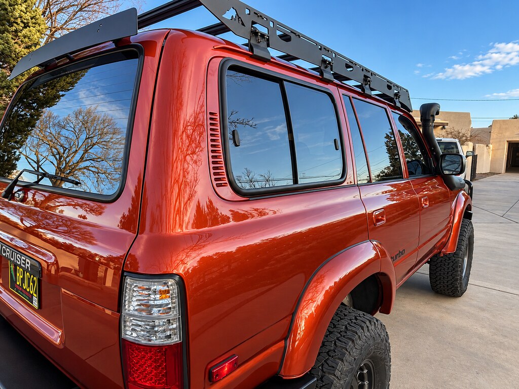

For the paint, i went with a 2-stage custom burnt orange metallic. The materials (primer, paint, clear coat and other materials and supplies) cost just under $4K. The labor including removing the doors, cutting the hood, masking, mitgating some rust issues, sanding and priming, painting, clear coating, reassembly, and some other minor work (including painting the wheel trim rings) added another $8K. So total paint job was ~$12K.
Looks fantastic. I’d love to see more pics. That seems like a fair price for good work.

Thanks. While I wanted a custom looking rig, I also wanted a color that looked "natural" being on a Land Cruiser 80 Series so going with an earthy color was high on my list.
I also didn't want to pay for showroom quality since I will be adding my own pinstriping when off-roading, but wanted to still look good enough for the occasional auto shows that I like going to. So overall, I am very happy with the results and the paint shop has been great to work with too.

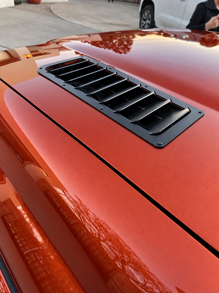

Hood vent detail:

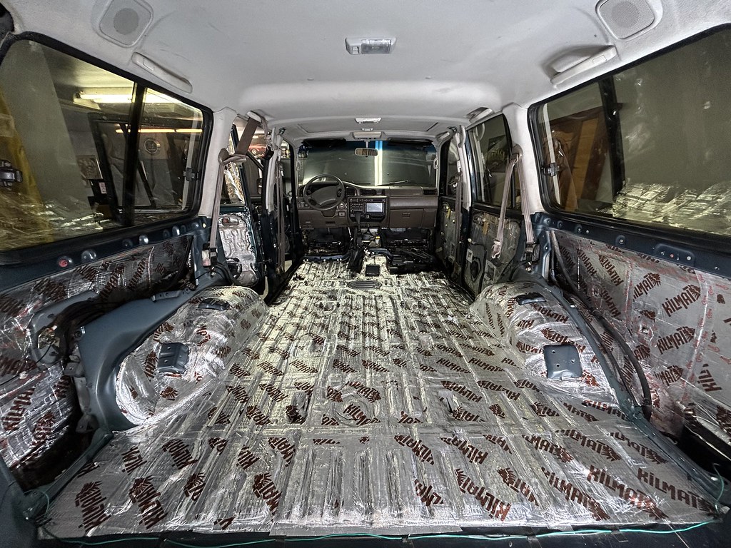

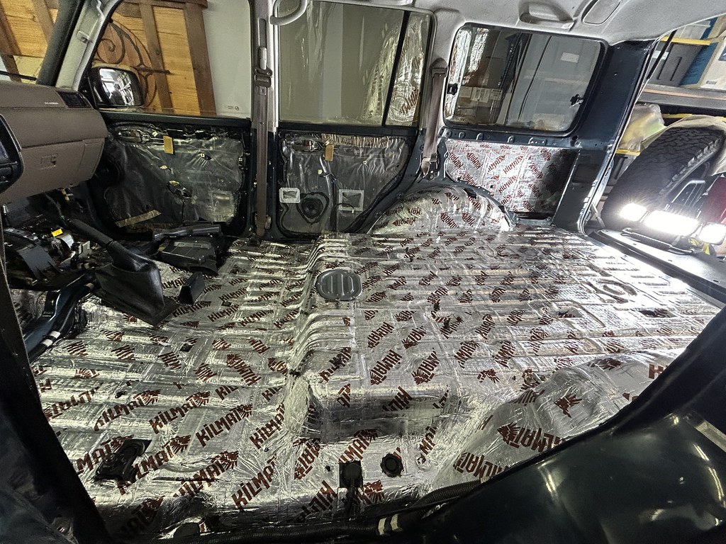

I am more proud of the sound deadening treatment I did underneath as that was a lot of work...lol. But after cleaning the old matting and glue completely off, I applied Kilmat under the dash, seats, and in the doors and rear fenders. It added a lot of weight but the 1 decibel in noise reduction was worth it! :rolleyes:
