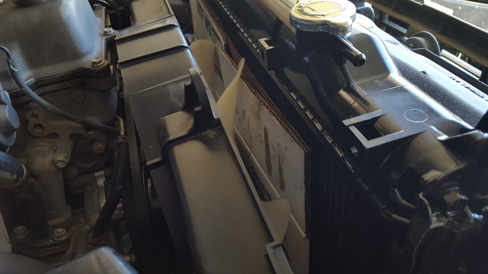

Going to start with the blue fan clutch from wits. Also, @NLXTACY, I noticed the gap between the shroud and radiator and I'm thinking if this also contributes to the high temps I experienced climbing those hills over the weekend. I'd be keen to see how it would look in a normal oem set up, so if anyone can share some pics of theirs, that would be appreciated. PO went with an after market radiator and not sure if it was the best thing. I'll see the difference and if I need to, I may go back to a stock set up.
OEM rad has foam as Joey said. Here are a couple pics of my OEM install...linked thread has PNs courtesy of Onur. Cooling System Overhaul Pieces and Parts?
That is a plastic tank.
16400-66040 is a 3 row brass core, used 93-94
16400-66081 is a 2 row aluminum core, used 95-97
