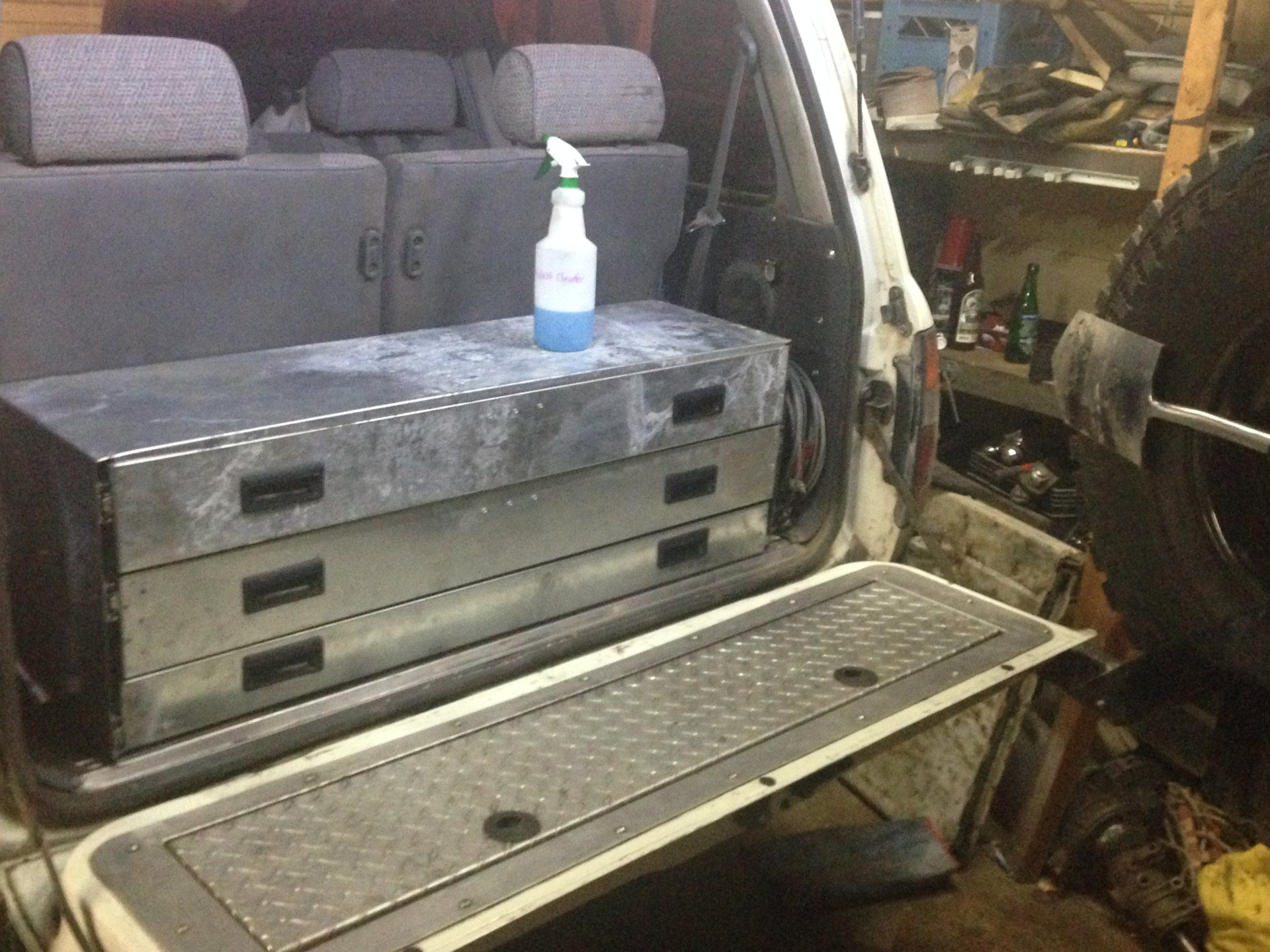

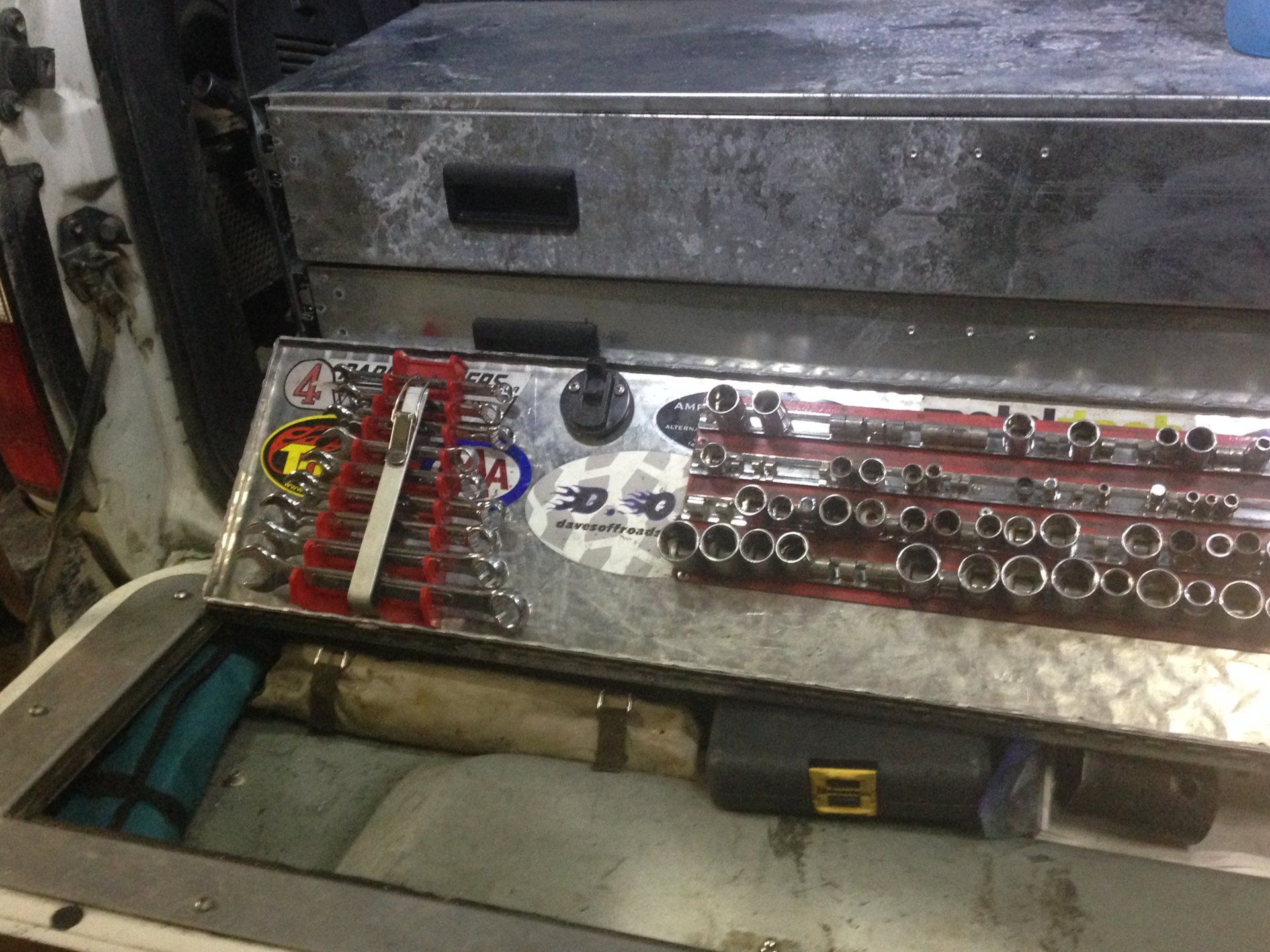

dude thats a great wrench/socket mounting idea. oh man Im stealing that I think
Have at er'
I ordered the holders and buckles off of aliexpress, the aluminum strap that holds the wrenches in, I cut a notch through the lid and bent a loop on the end and tucked it through, put a bit of foam with an adhesive along the inside of the strap but I can't see anything rattling. Should be so much quicker than unfolding tool wraps.
The socket holder was from "princess auto" but you can probably find the same thing cheaper at harbour freight.

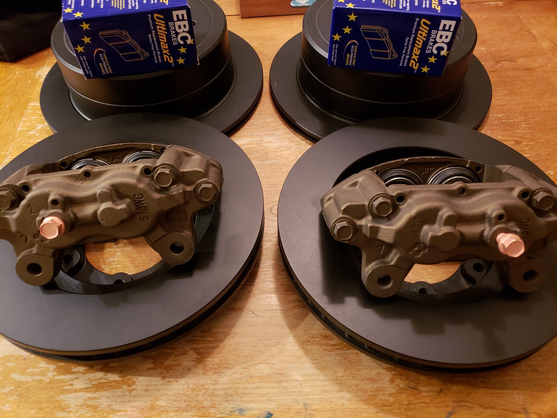

New EBC front and rear rotors. New EBC pads. 12 new front wheel studs and new OEM brake lines arriving tomorrow. Freshly rebuilt and cerekoted OEM calipers...I have some dirty work in my future...
New EBC front and rear rotors. New EBC pads. 12 new front wheel studs and new OEM brake lines arriving tomorrow. Freshly rebuilt and cerekoted OEM calipers...I have some dirty work in my future...View attachment 1863983
Dirty work.. Throwing in the knuckle rebuild while at it??

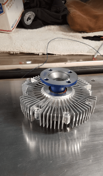

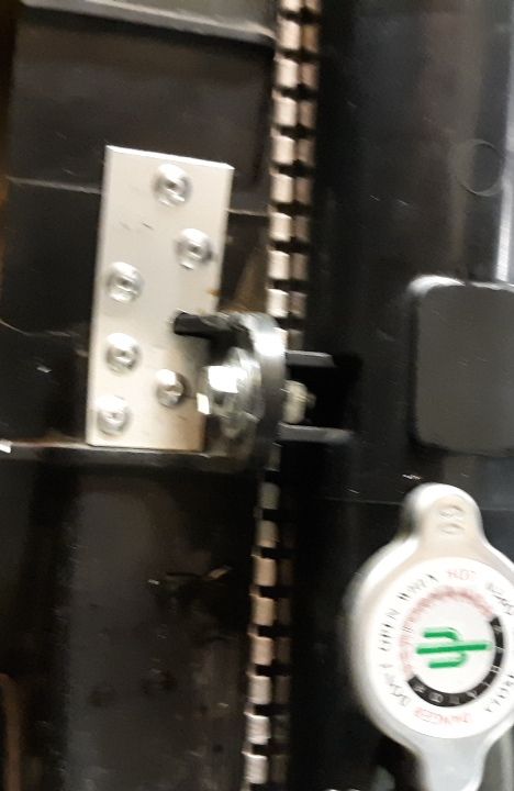

Going to start with the blue fan clutch from wits. Also, @NLXTACY, I noticed the gap between the shroud and radiator and I'm thinking if this also contributes to the high temps I experienced climbing those hills over the weekend. I'd be keen to see how it would look in a normal oem set up, so if anyone can share some pics of theirs, that would be appreciated. PO went with an after market radiator and not sure if it was the best thing. I'll see the difference and if I need to, I may go back to a stock set up.
That gap absolutely contributes. Should be foam in there.
