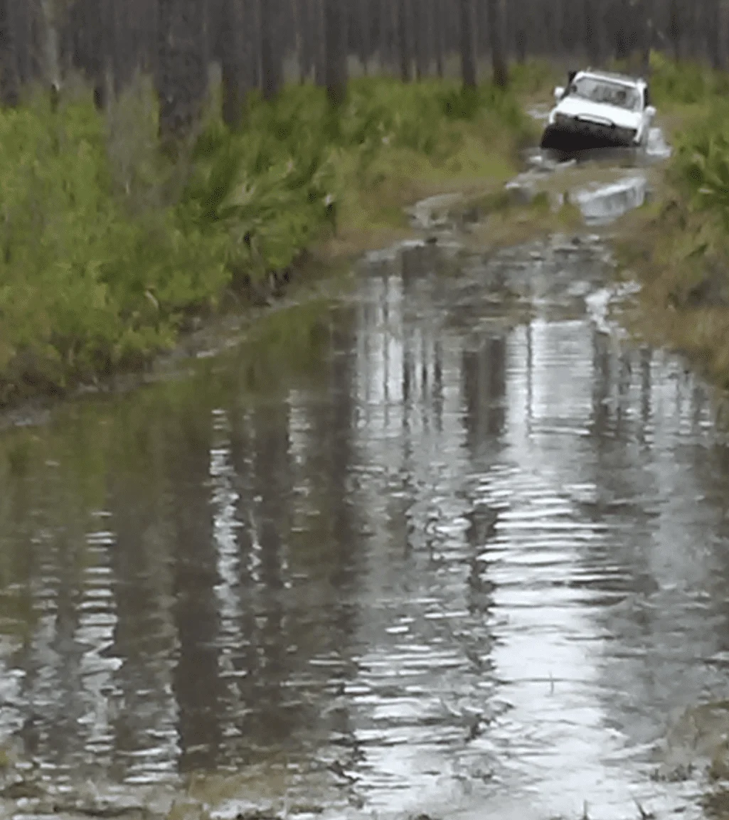

After punching myself in the face fixing a spun caliper bolt I thought it would be fun to swamp myself in the Appalachicola NF. Spent 2 hours drying out everything I could pull. Sketch factor 4. Good times though.

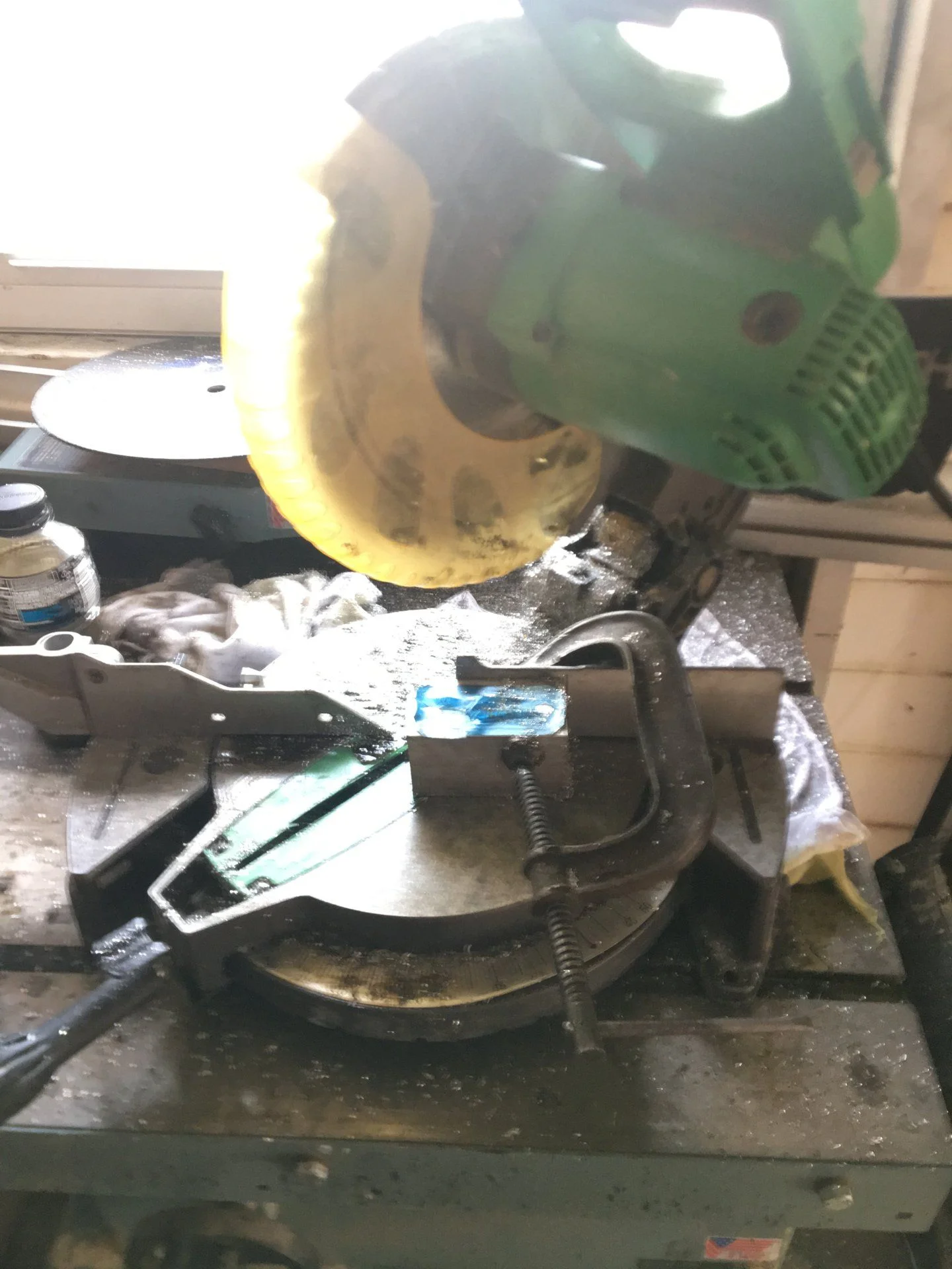

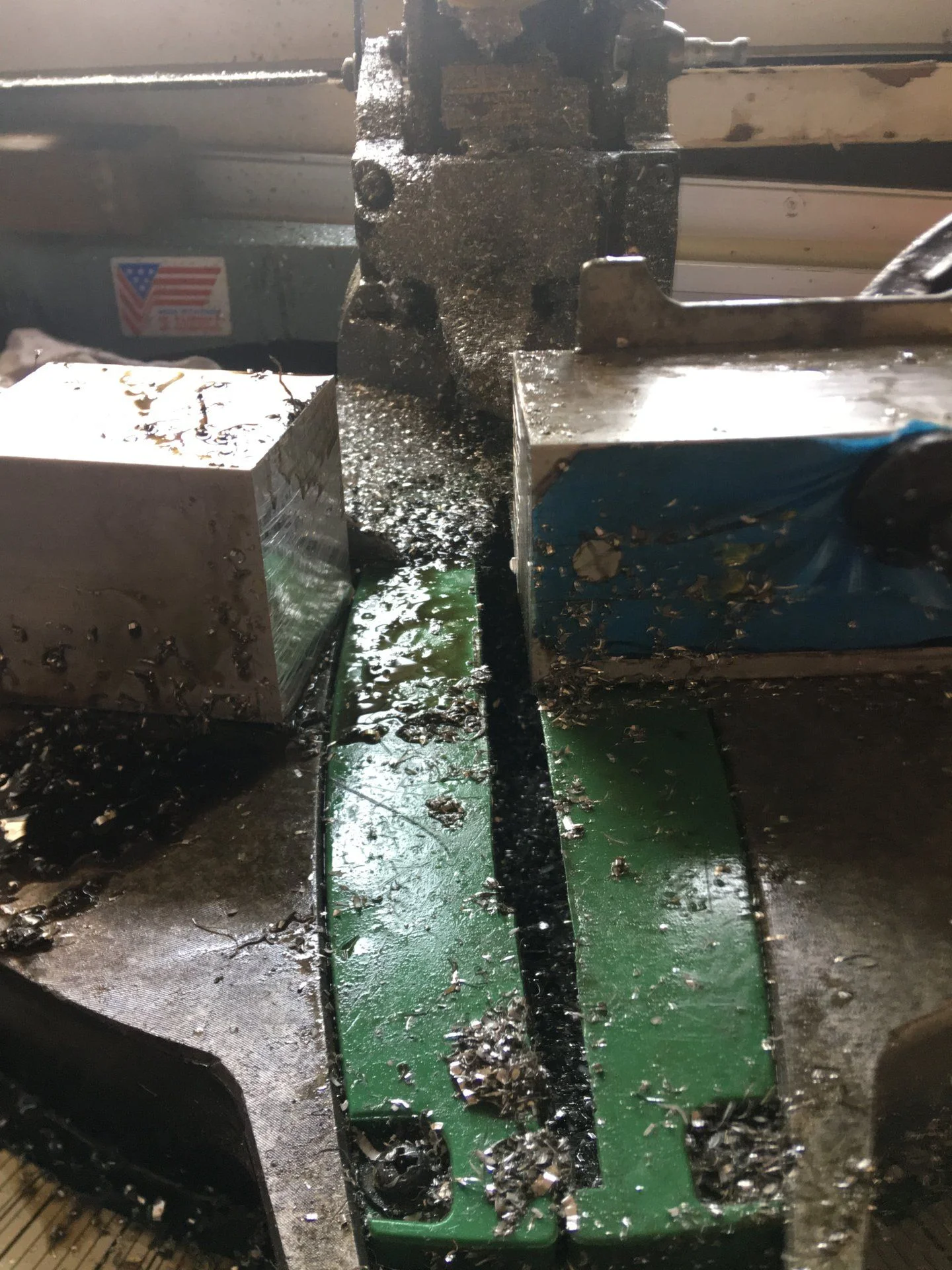

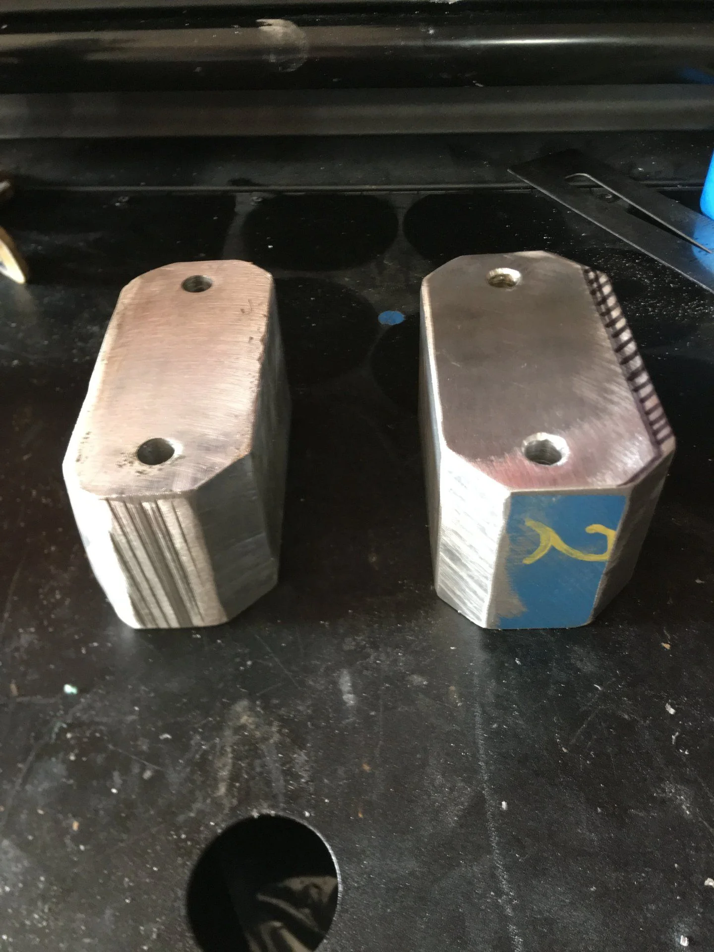

Chopped my second sway bar drop bracket. This one went much more smoothly than the first and in truth had it done in ~10min.
The first, on the left, is a pretty sorry looking attempt. That said it’s fully functional and will be placed on full duty. The right one is marked to show how much wider it is than it needs to be. Anyone know if a ~.25” difference will adversely affect anything?

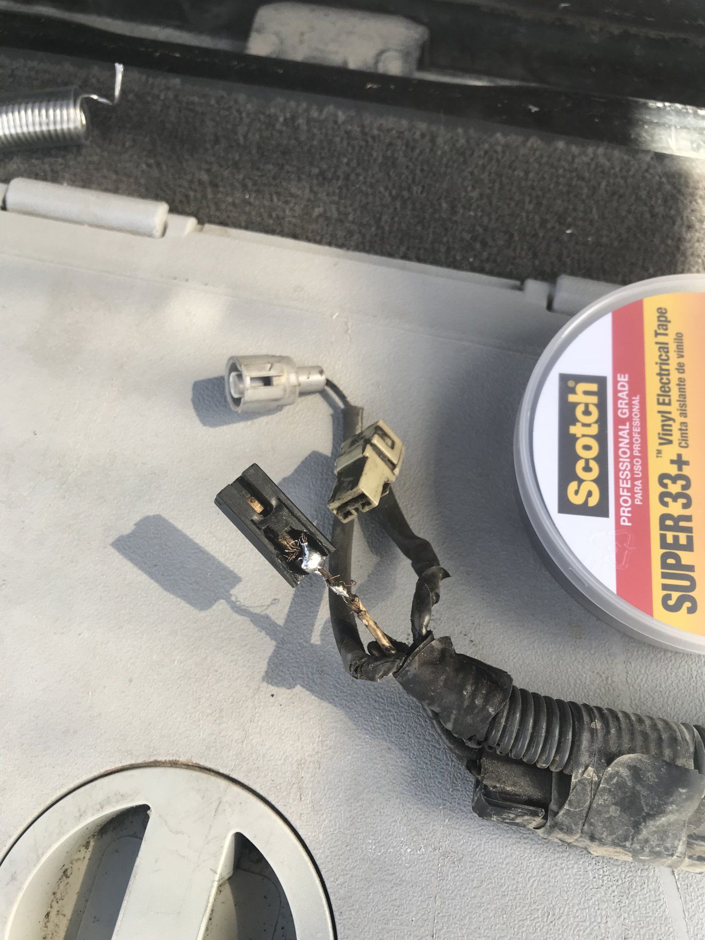

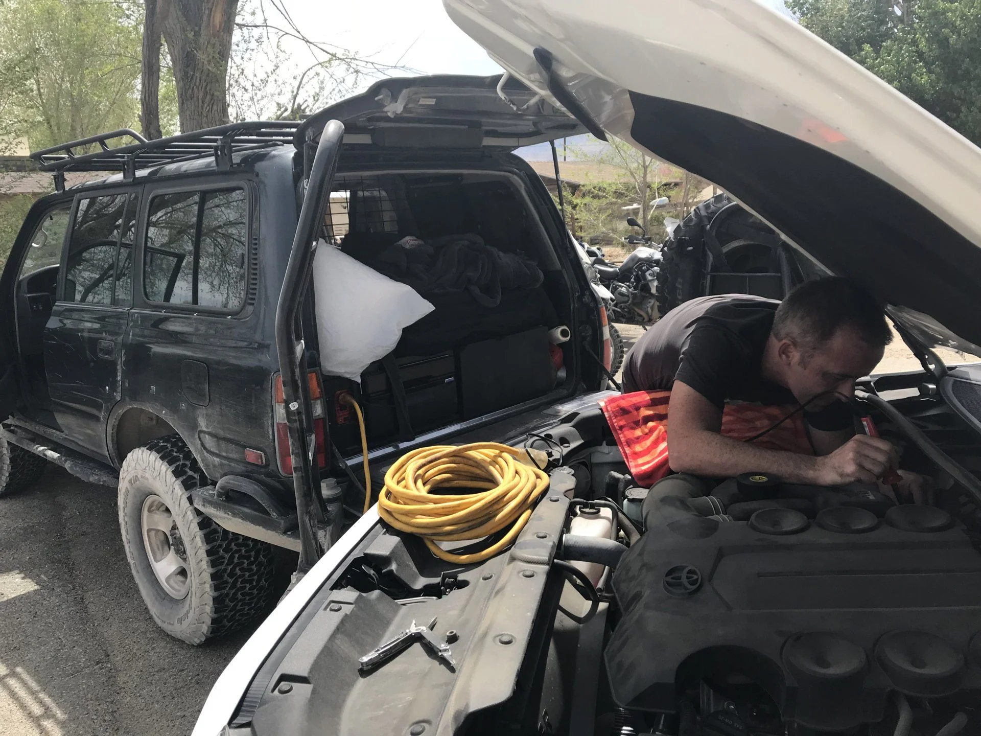

6 days trucking around Death Valley - had a loss of oil pressure while ‘out there’ and traced it back to a sheared oil pressure sending unit harness - bought a soldering iron and some electrical tape in Bishop, CA and performed a parking lot soldering job!
Oil pressure back!
Not the tidiest of jobs but it got me home!
Then a buddy of mine was having all kinds of problems with his new 2016 trail edition 4runer - running rough - high idle - tracked it down to a sheared spark plug connector terminal wire - out comes the soldering iron for another parking lot rescue job.
The offending connector!
Everyone needs a buddy with a landcruiser!
