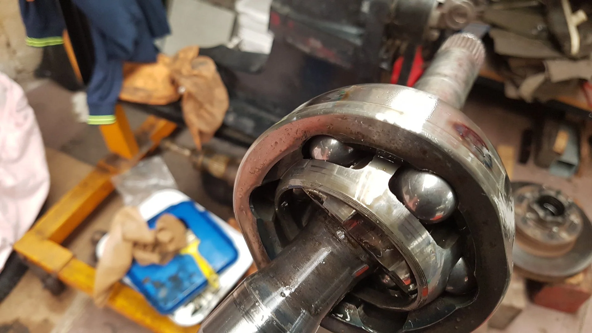

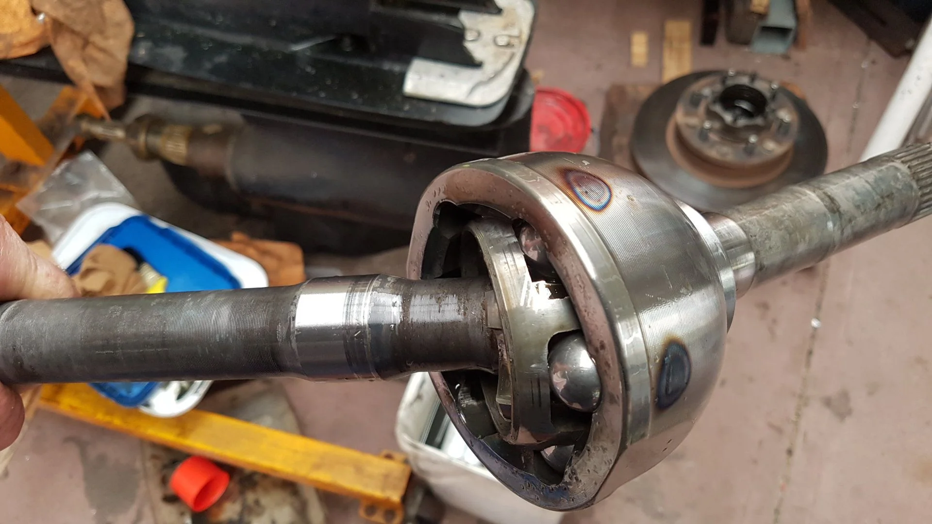

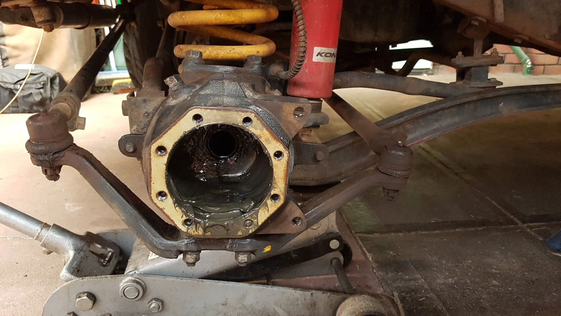

Last time I was turning off the beach in 4x4 I could hear what I thought was the L/H birfield clicking, so today I removed it and it seems fine? I have been using the H/D AVM locking hubs that came with the Marks Adapters free wheeling kit that I installed a few years ago, could it have been these clicking? or perhaps it was the other side and the sound transferred. I have ordered a set of Aisin hubs to go back on.

Take out the cage and confirm. I had one this year that looked perfect too, until we took it further apart. Crack was on other side of cage. How is motion on it?
Cracks in the birfield cage can cause clicking, but it can also come from the grooves that get worn in the cup. The balls catch as they try to move past that low point. This is why additional grease can quiet the noise, and switching the joints from side to side allows them to ride in a new area on the cup.

You only get this clicking when turning on 4x4, correct ?
Could it be the upper & lower steering knuckle arm bearings ?
When your birfs start to go, you'll get constant clicking any time your vehicle is in motion and you turn your wheel all the way.

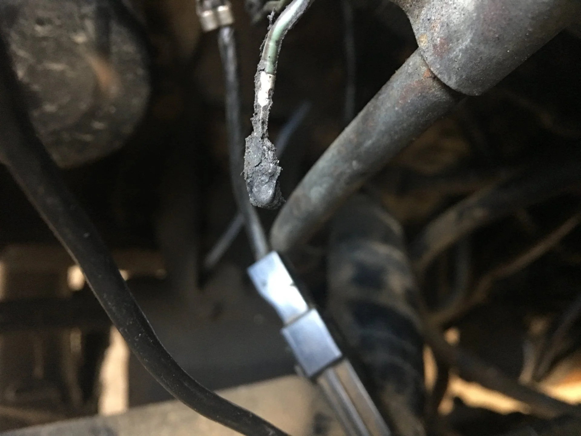

Things are going more smoothly now that I’m looking at the correct knock sensor. It looks like someone confused RTV for solder...
Scraped the sensor clean with an x-acto knife, sniped off the female connector, and added a pigtail with my best impression of a lineman splice:
I didn’t have time to test drive but I’ll get her out on the road before week’s end for quick jaunt to see if the code 52 is gone.
I picked up new inner and outer circlips, aisin hubs, wheel bearings and 5 tubs of molly grease today, thanks for the tip on switching sides, ill do that
