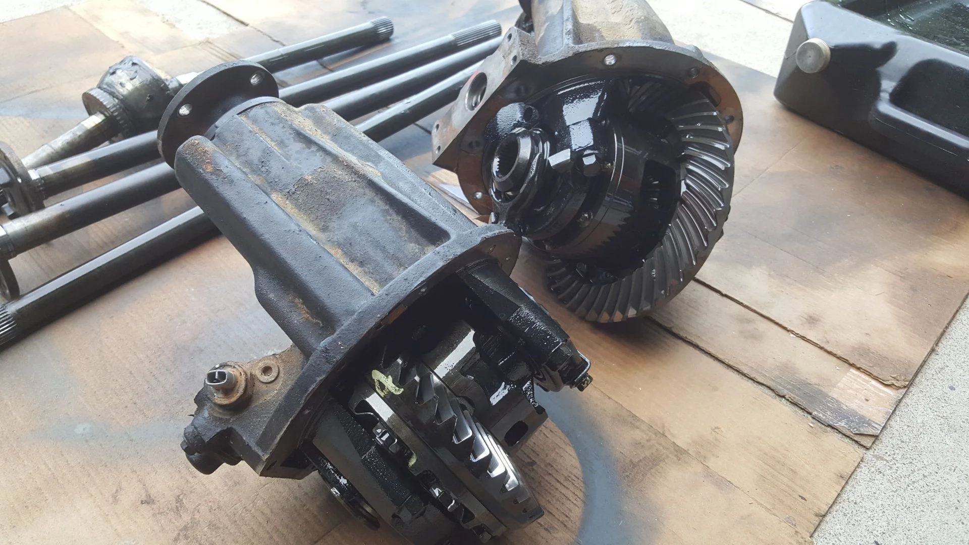

5hrs and got the diffs out... Not too bad. Just now wrapping them up to send to @gearinstalls.com (Zuk) for some 4.88s

Nice! I did the same thing two months ago. Just finished breaking them in. Well worth all the effort, but my garage still smells like gear oil...
How'd you re-seal the 3rd's to axle? I'm thinking about taking the belt and suspenders type approach and use the paper gasket with FIPG. Zuk mentioned just using the paper gasket. My truck only had that on there, but I really don't want to be tearing back into this anytime again soon. Want to ensure it will not leak. Any other advice welcomed.
Permatex Ultra Gray...
I'd use one or the other, but not both. In my experience, using FIPG with a gasket just allows the gasket to squish out when tightening bolts. No bueno.
I prefer to use just FIPG. Permatex "The Right Stuff" works great.
