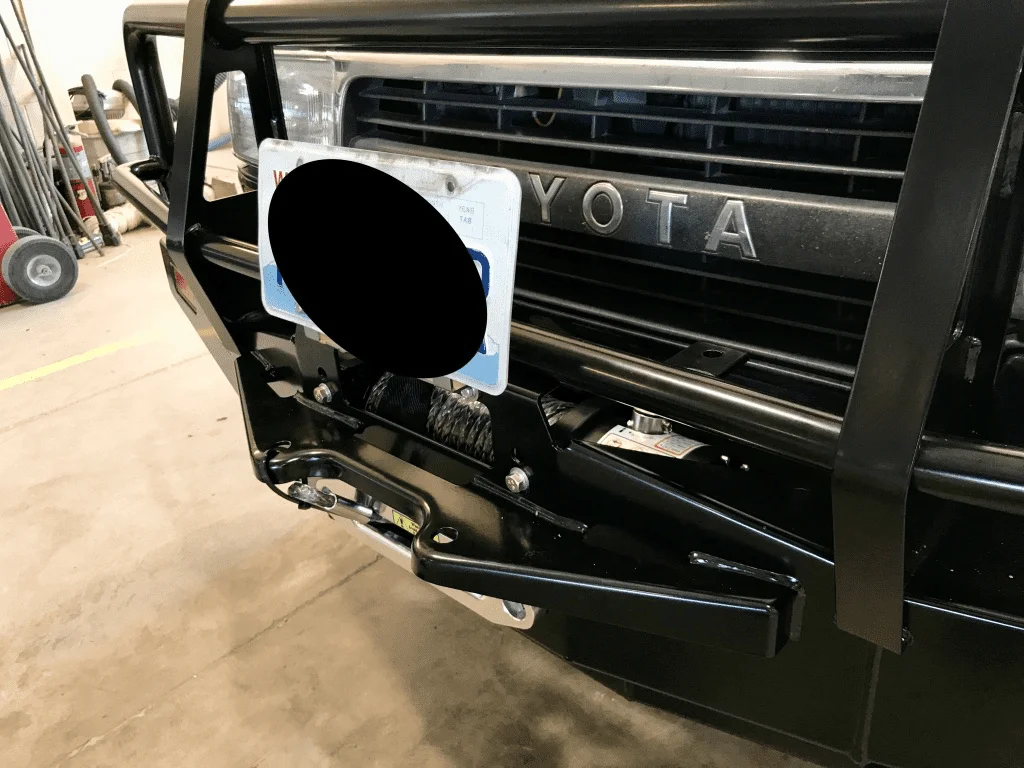

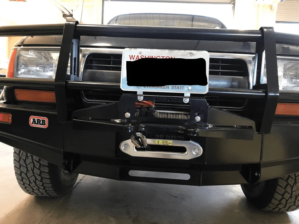

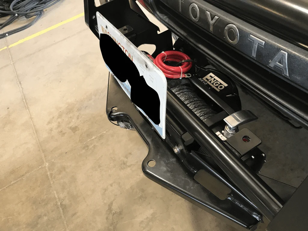

Installed ARB bumper and ENGO SR12 on Elsie.
