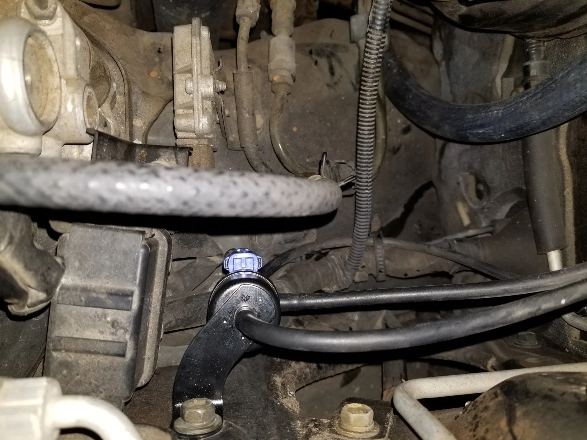

Installed the Lowes catch can mod. The old hose was so brittle it felt like PVC and cracked in several pieces when I attempted to remove it. Parts store run ... I think NOT. Pop the hood on the LX and steal the hose off of that. Cut the section out for the catch can only to find the clearance is super tight. Will now have to order 2 new hoses from Onur and do this twice ... like everything else on the truck.

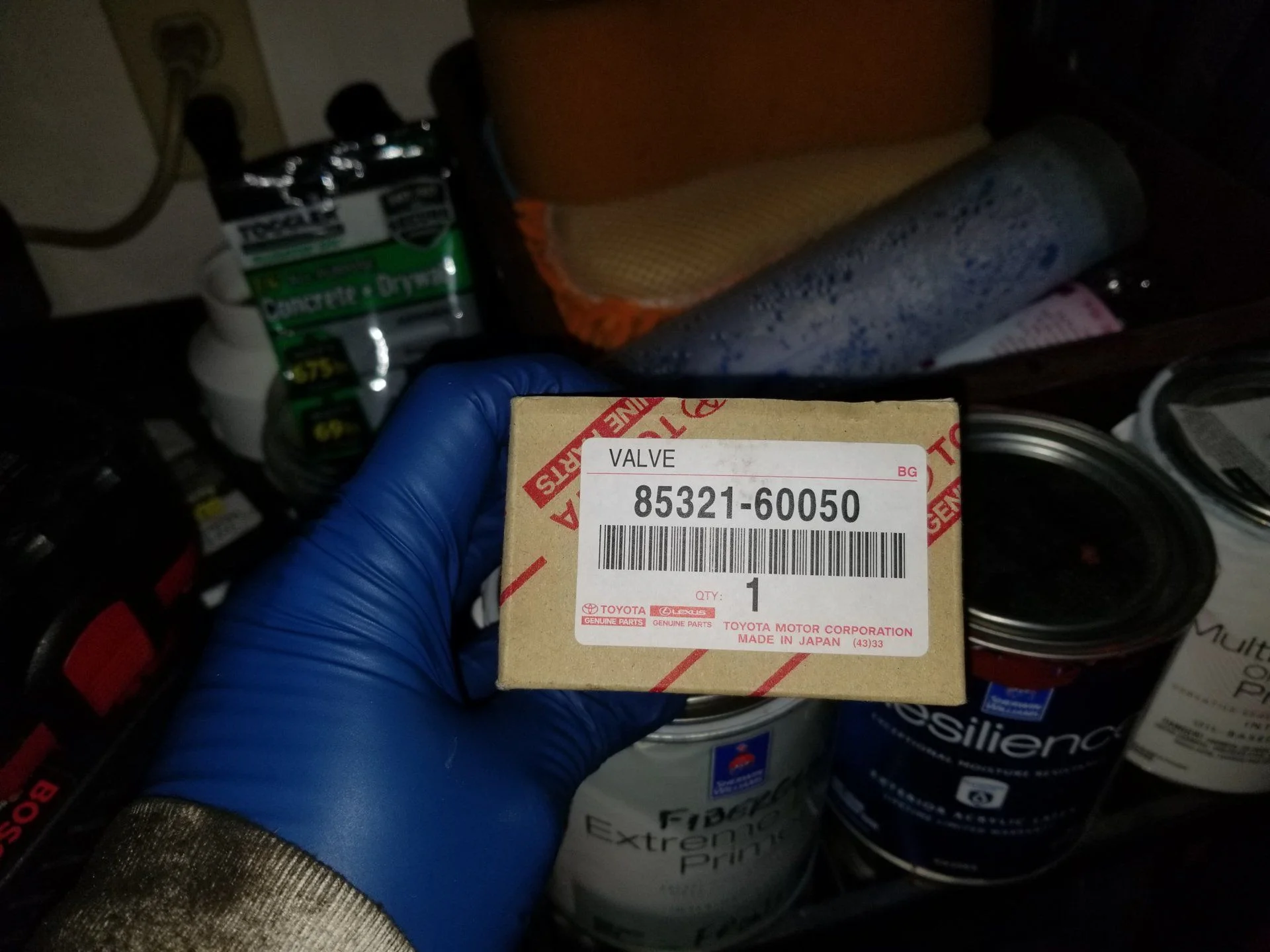

Hooked the rear washer back up with the new diverter unit from that parts guy.

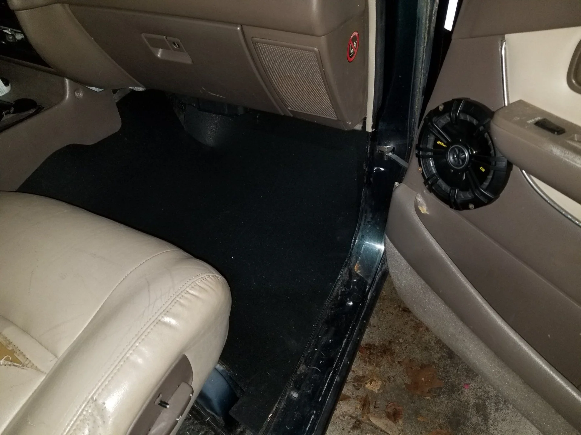

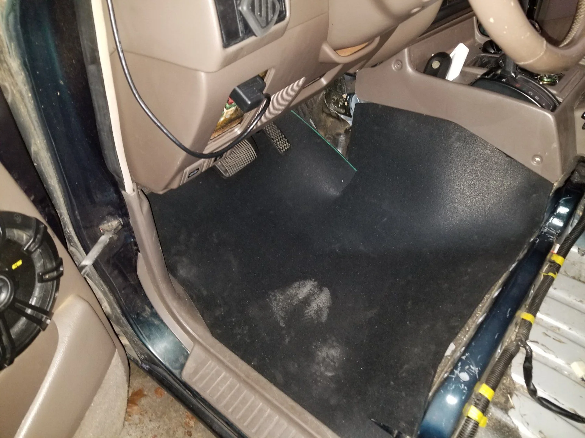

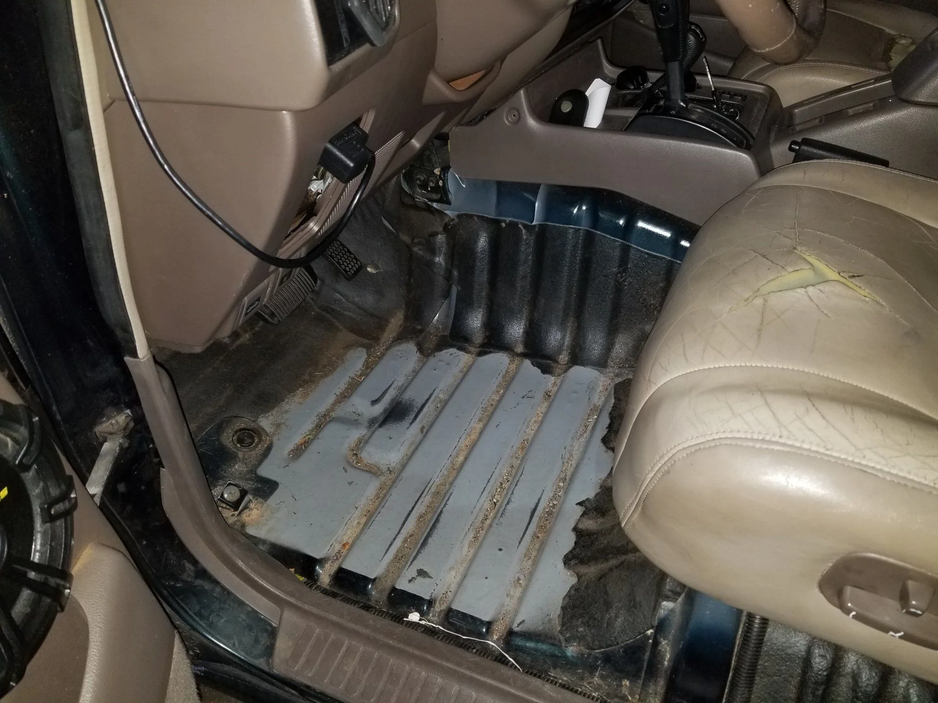

Since the PO had so nicely decided to remove and throw away all the carpet I finally got around to cutting pieces of the 1/4" gym mat to roughly fit the foot wells and rear seat area. Def seems to cut down on the road noise a bit, so some win there. I will see how it holds up over the winter. The goal is to have something that can be removed and hosed out. If it works, I will Monstaline the interior in the spring.
Before:
After:

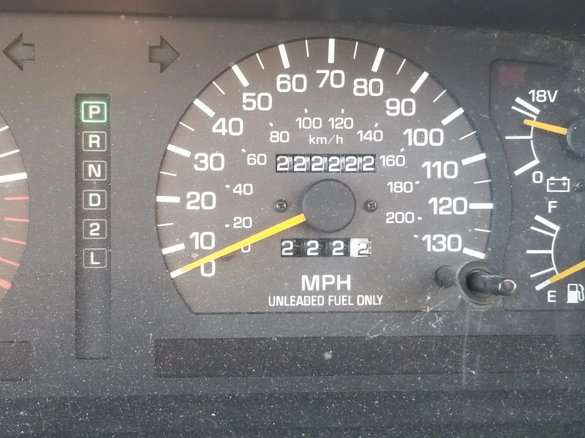

Finally ... completed the 2nd break in cycle. I was way too happy with myself for setting the trip meter right and not forgetting to get this pic. You can see my constant co-pilots, the SRS and ABS lights as well as my Cruiser in it's natural state of hovering near empty. Points off for not keeping it in gear and showing the D light works.

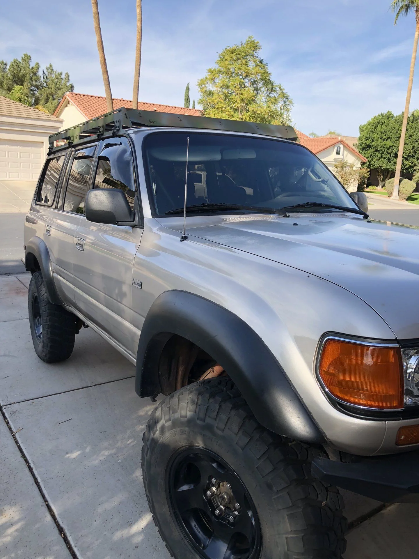

Almost forgot the most important part ... added some HP
Great mounting method. How did you do that? More pics of mount?
I used drop "L" brackets mounted to the extruded aluminum rails with standard 80/20 hardware. The panel did need to be spaced upward about 1/4" to then clear the roof ribs.
Which solar panel did you use? Can you take pics of your setup
The panel is an old Siemens SM50 50 Watt panel that was left over from a job I did about 15 yrs ago. It is no longer in production. The closest similar thing available is something like in the link below. It is so expensive because the solar panel industry has moved to much larger (physically and electrical capacity) modules as the norm. Small dimension, 12V panels are an odball in today's market.
https://www.amazon.com/Shell-Siemens-Solar-SM50H-Replacement/dp/B003DI6FU0?tag=ihco-20
Depending on how much it is worth to you though, the 51" length fits PERFECTLY between the frame rails of the rack. Didn't plan it that way, it just worked out.
