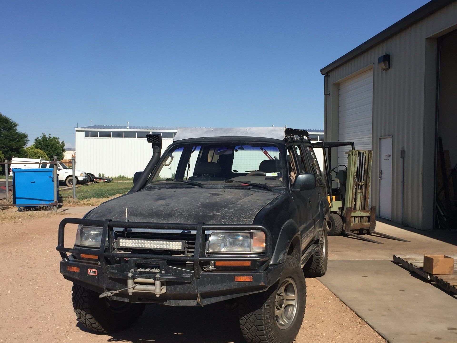

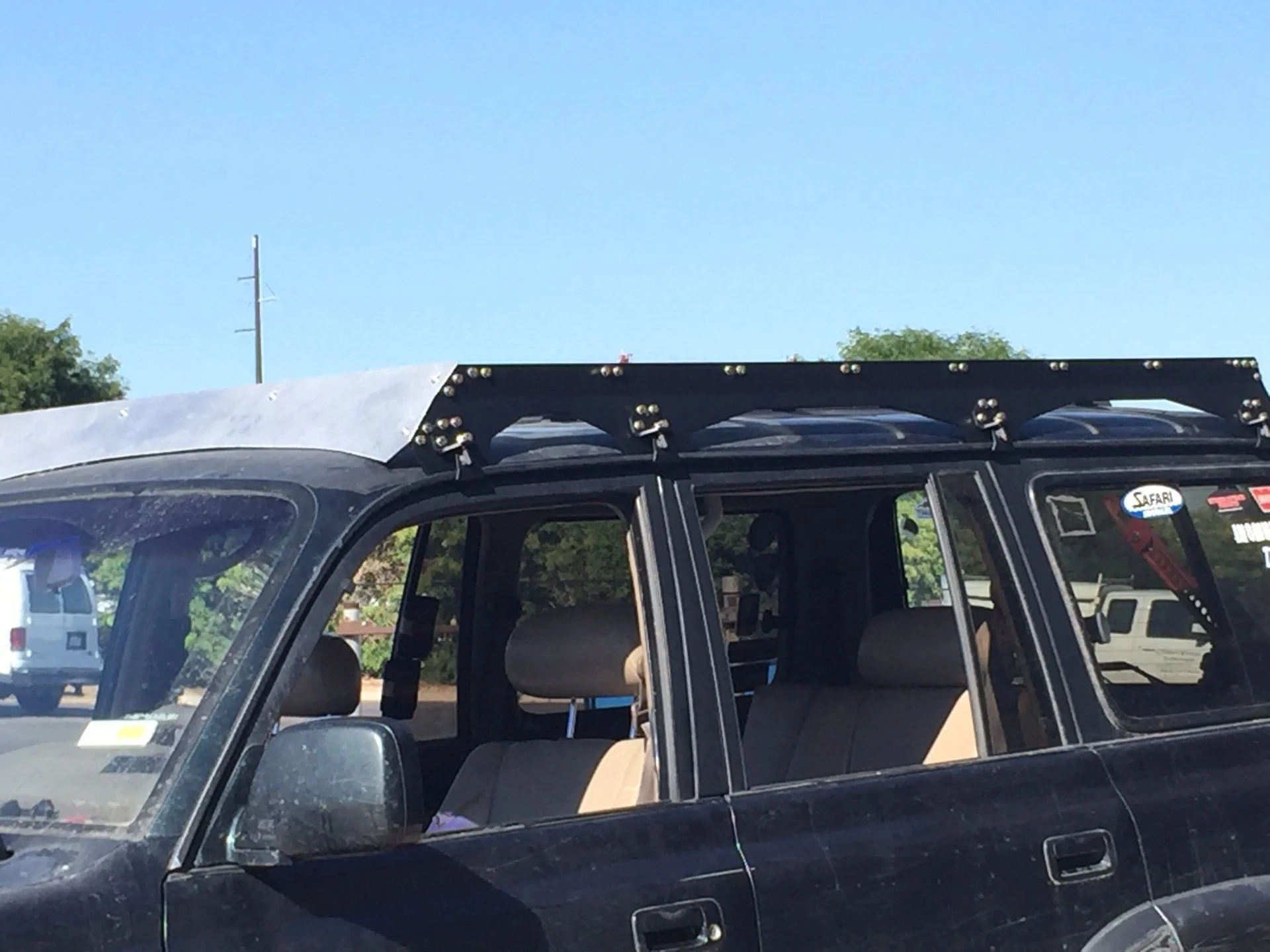

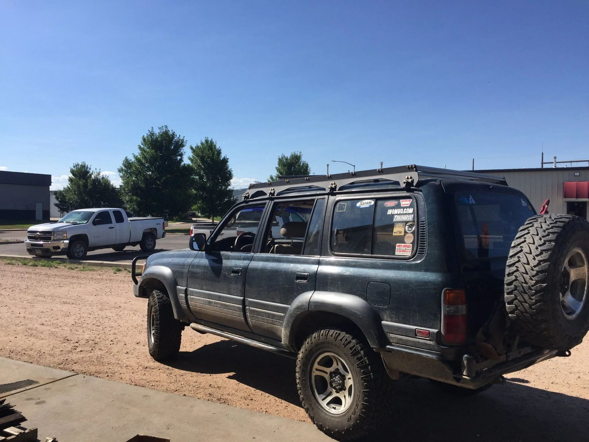

I needed a roof rack for Rubithon and am a broke college student so I talked to my friend Scott at Apex Engineering and Design and my boss, Mike Smith, owner of Bump It Offroad, and conviced them to help me with a roof rack. I told Scott the general idea of what I wanted and he designed the whole thing. Mike cut it out and helped me with the rest. Finished and bolted it on today. It turned out great!

It looks like a redesigned Prinsu. The design works, low noise,strong.

I built a roof rack as well and have been thinking about how I can transfer the contour of the roof to a pice of metal so I can cut out an nice a deflector like yours. How did you accomplish this?

Once we had the rack on the roof without the deflector we took a square that can extend and has inches in it and took the distance from the bar to the roof at the angle the bar was sitting. We basically plotted a curve with the center of the bar being 0,0 and measuring points in inch increments in the x and measured down the y. The middle was 5 3/16" to begin I think and the outside is like 7 3/8" if I remember correctly.
Come check it out at rubithon and I can explain that way better if that didn't make sense

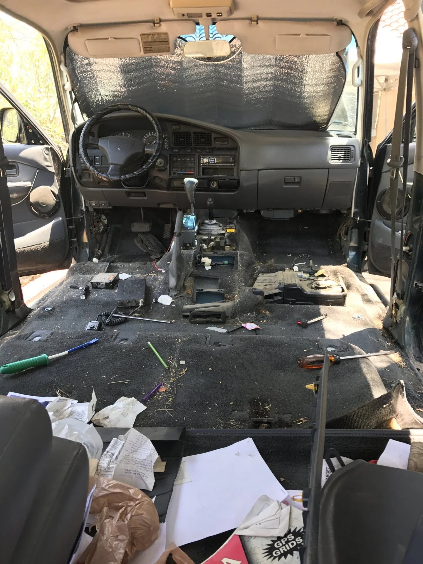

Jaysus. That looks like a lot of work.

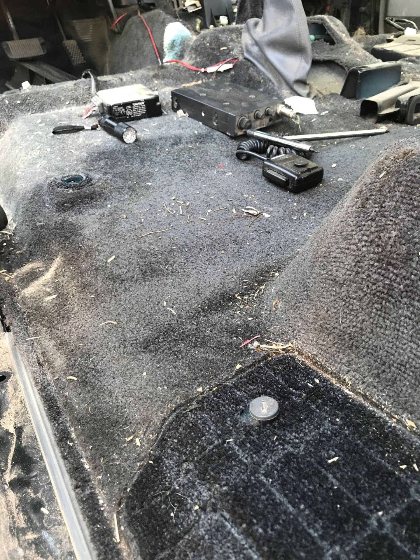

Not really too bad. The biggest pain is moving the wet carpet around. I'm hoping the low humidity holds out while it dries. I have a few stains that don't want to come out that I need to deal with. Simple Green didn't work.
Now to decide on some cost effective thermal barrier and another thin layer of jute.

Thermozite.
