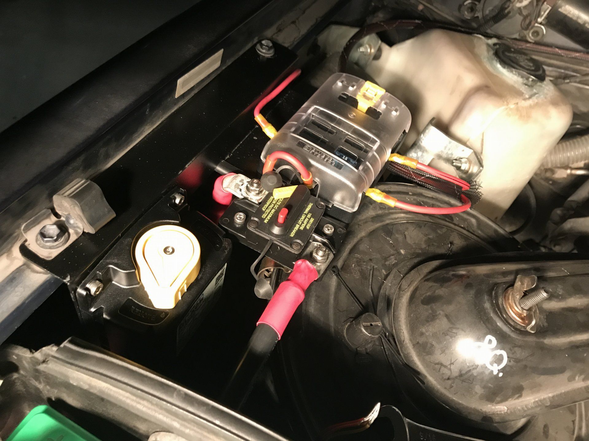

My buddy @DrGil wanted dual batteries and fuse panel for his 96 80 Series so that his fridge could run off the aux and leave his main alone. My setup was way too convoluted to consider so why go the opposite and try something that is basic and easier? Enter the BlueSea ML-ACR.
The ACR, fuse panel and circuit breakers, along with some 1/0, lugs, misc wire, connectors, oh and a sweet one-off custom bracket to hold it all and it seemed like it could be doable in a day. Well, night. We started at 7pm and just finished at 2am. Seven solid hours for dual batteries isn't bad. If I were to make a few adjustments to the bracket, pre-cut and pre-terminate the wires, then you could have plug n play dual batteries in about 2-2.5 hrs.
