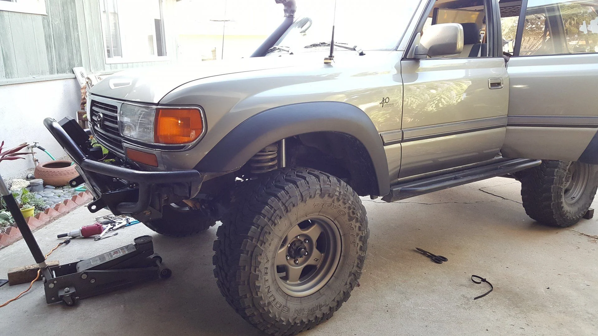

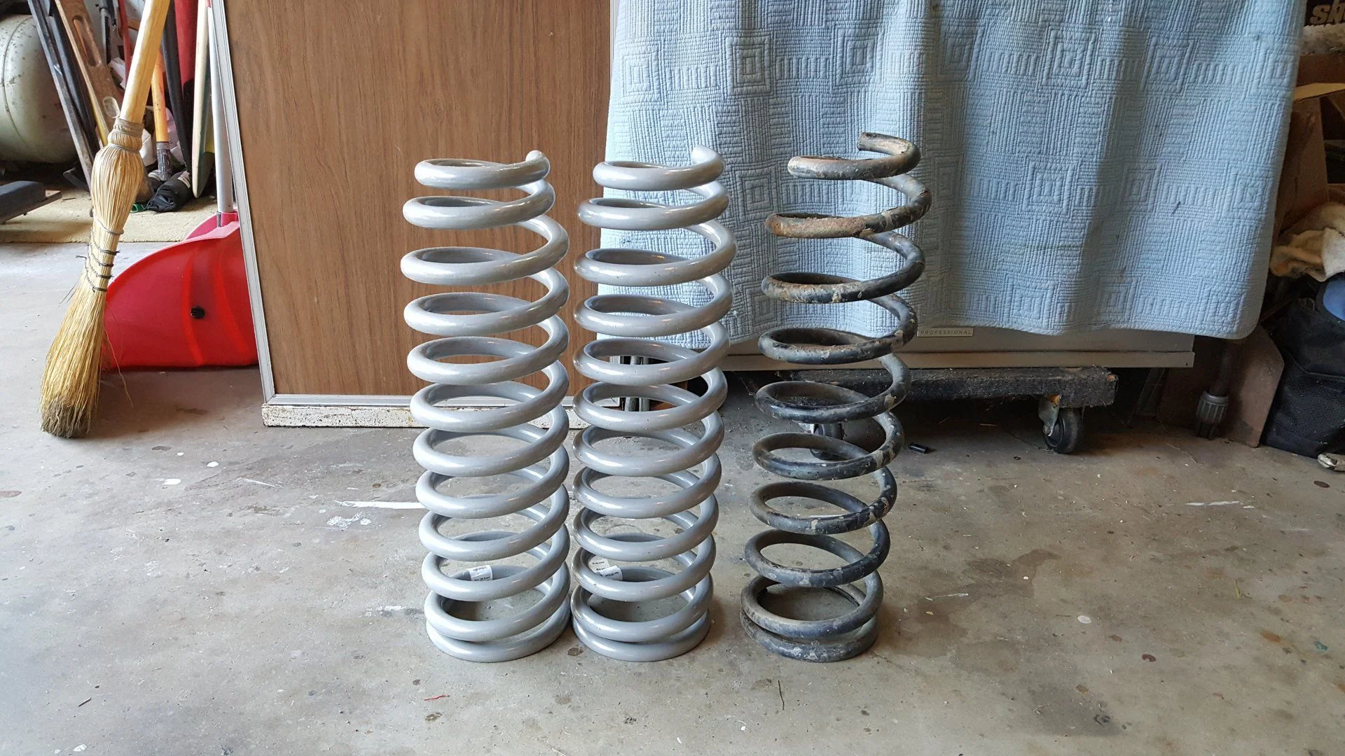

Installed front Slee springs. I had OME 850J coils for about 5 years and just thought I'd switch it up and to match the Slee rears. So far they feel comparable to the J coils...maybe a tad firmer. I guess I'll have to wait til next weekend to try them offroad.
Which springs did you install?
They are the 4" Slee springs. They only have one kind of front 4" springs. The rears I installed were the mediums.

Nice looking rig! I could have sold you my Slee fronts, they have been collecting dust under my work bench.
How about a profile shot on level ground?
