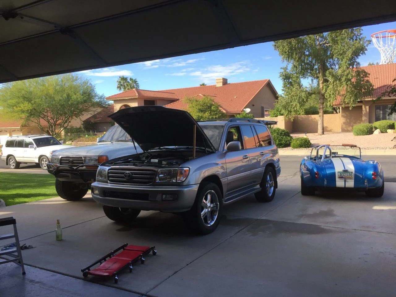

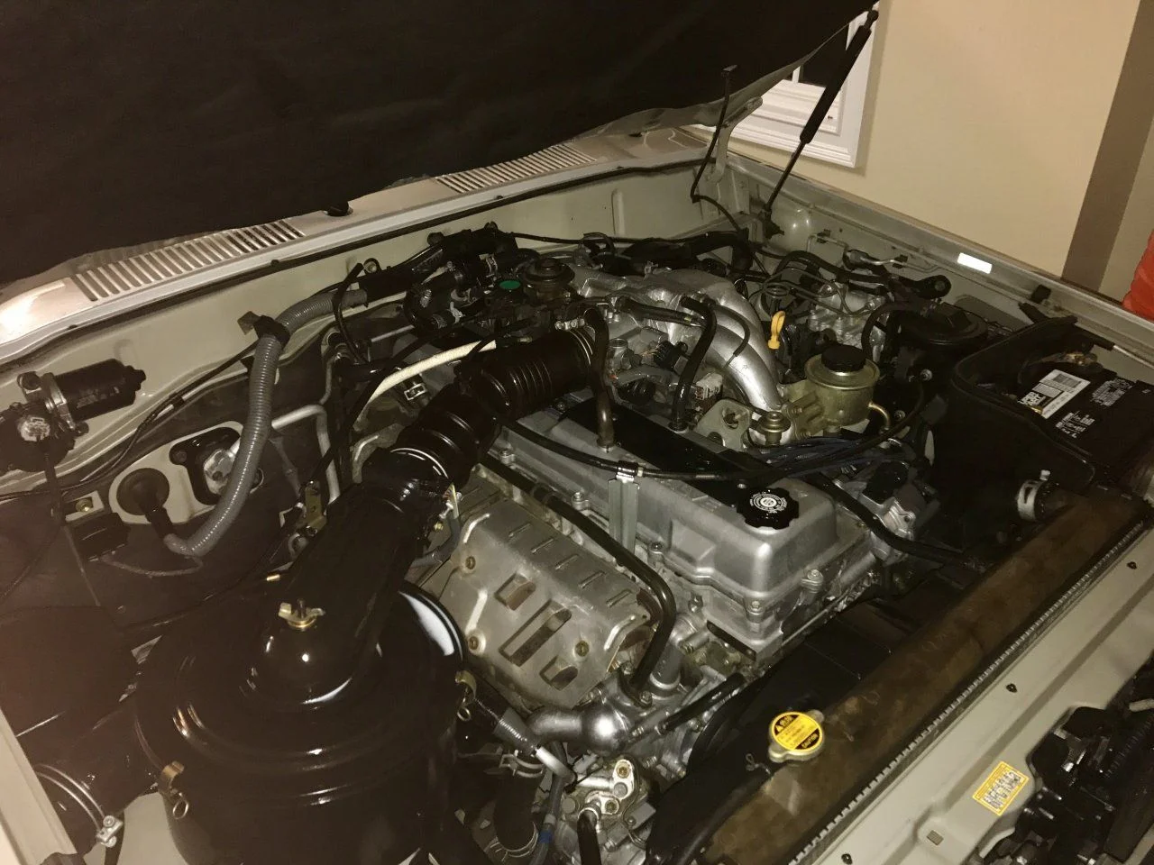

It has taken me a month of puttering but the Land Cruiser lives after its year long hibernation!
It is running a little rough and I'm hoping it is a combination of year old gas with the tank on empty and the ECU doing its baby steps. I'll check the timing tomorrow. So far no apparent leaks or gas smell. I may have a vacuum leak. Boo!
I replaced the faulty EGR VSV and all the hoses under the manifold.
Replaced all heater hoses and my wonky heater mixer.
New valve cover gasket so I could reseal my leaky half moons.
Since the injector rail mocked me, I had the injectors cleaned locally.
Replaced the leaky crankshaft seal and oli pump cover gasket.
Replaced my leaking distributor o-ring. A little oil film in the distributor. I cleaned it and will monitor.
New belts
New spark plugs, wires, cap and rotor.
New PVC, grommet and PCV hoses.
Replaced the leaking low pressure power steering hoses. I may still have a leaking power steering pump, but will clean and monitor.
Rehabbed my blue fan clutch with ~17.5K oil. Tools R Us helped me do ten years ago or so. The oil is light yellow.
Changed the oil and a half dozen other small things.
I'll check the timing tomorrow, drive around and hope that it passes smog test tomorrow. Cruiser gods willing it will take us on a snow run to N AZ on Monday.

And I'm pretty sure I have a misfire as the timing is spot on. :frown: :bang:
I'll check the injector harness connections if I can and the spark wires. Booooo!

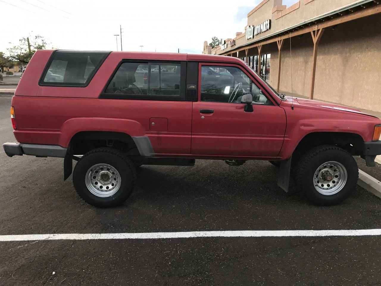

Well, I was able to temporarily solve my misfire. Snow tires on the 4Runner!:bounce:
The family of 5 will be cramped, but a snow vacation waits on nothing.
