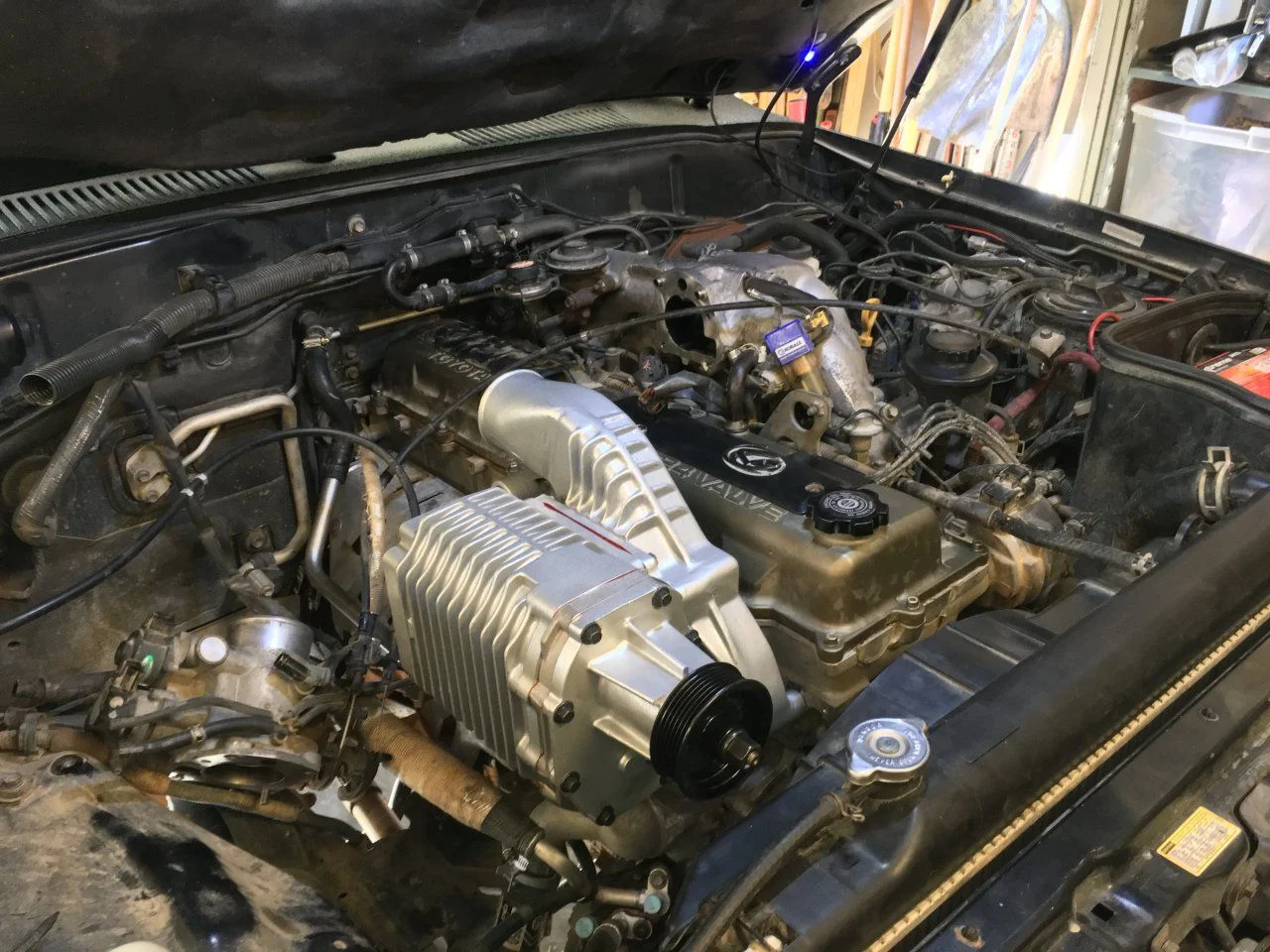

Well yesterday was a huge day for the lx. Thanks to @2fpower @Robkc @kc_chevota helping me out. Here is my quick review of the supercharger. Around town yes there is a difference on the highway there is substantial difference in be able to pass people go up hills etc. the engine ran around 186 to 194 all the way. It almost feels like you have unlimited amount of power compare to what I had before. I did not push it at all I think I did see 3psi once. I do have to adjust the kick down cable to make it down shift. But the power. I can't say enought about the it. It is absolutely worth the investment. Here are a few pics

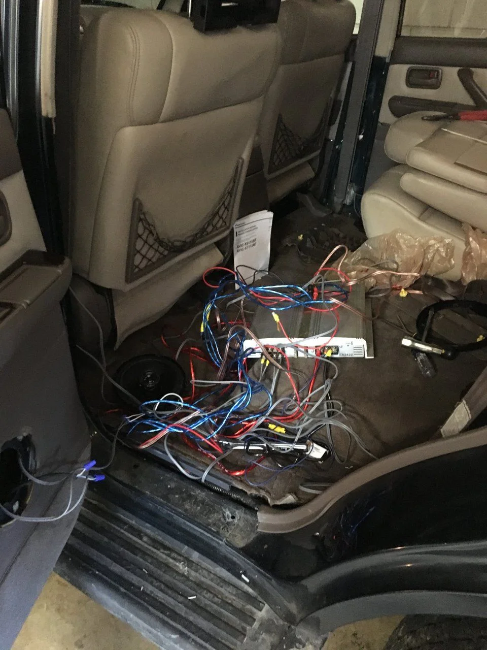

Ran amp wires from battery, etc and from my in dash DVD to the rear seats for my 4 channel amp. Will run my sub amp later when I actually get a small sub and box. Hooked up the rear speakers (6.5s) and instead of running wire to the fronts I am going to use this method:
I also ran extra wire for when I hook up a rear camera and a headrest monitor. Wires wires everywhere!

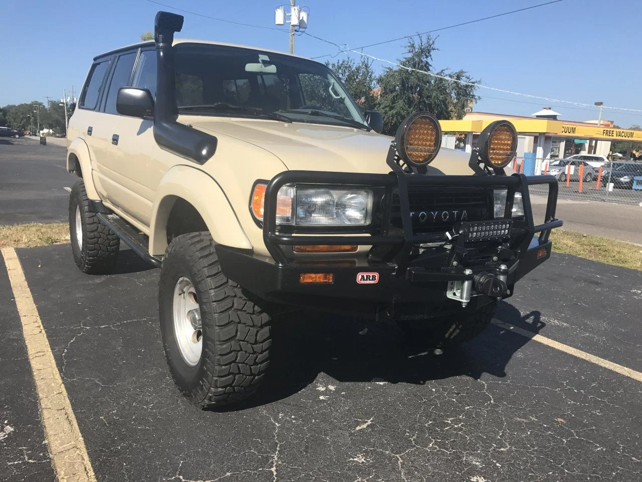

I installed the ARB winch bumper.
Tips:
1. An engine hoist and a ratchet strap through the light tabs makes for the perfect vertical positioning jig and is far more reliable than the help of a teen son.
2. Wax the frame horns with beeswax to help the bumper sockets slide over
3. The Toyota M10 bolts from the original bumper are better than the ARB hardware. I used the ARB 12mm bolts elsewhere.
4. A deadblow, a few light taps from a sledgehammer, a block of wood, and some cardboard are needed to get the holes lined up "just so"
5. Instructions, like most ARB instruction sheets, could really benefit from illustrations.
Winch will happen down the road....

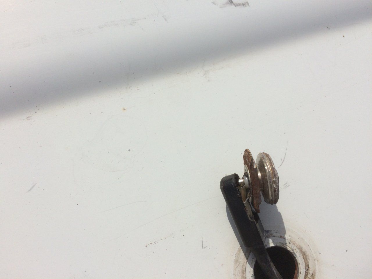

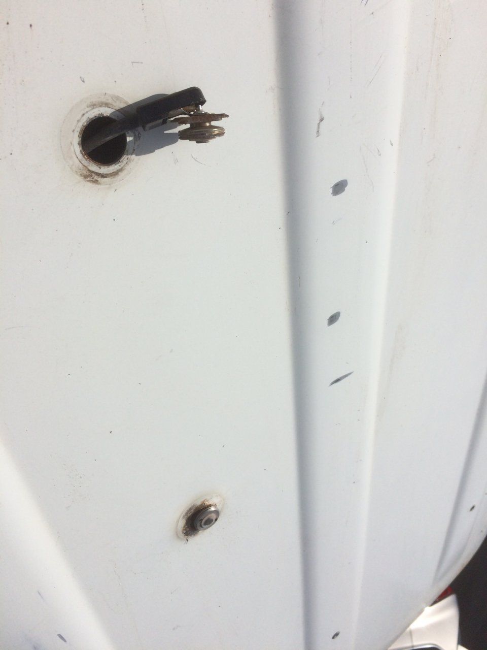

I'm finally getting to the Monstaliner. Unfortunately my 93 had all the crap on the roof. I used a sharpened putty knife and a hammer to peel the four rack strips off the roof and finished it with acetone and scotch brite.
The bigger problem is these roof mounted antena's. Not sure what kind they are but now I have two 3/4" holes to patch.
Can you identify the type of antenna? I'm curious.

View attachment 1347338 View attachment 1347339 View attachment 1347340 I'm finally getting to the Monstaliner. Unfortunately my 93 had all the crap on the roof. I used a sharpened putty knife and a hammer to peel the four rack strips off the roof and finished it with acetone and scotch brite.
The bigger problem is these roof mounted anta's. Not sure what kind they are but now I have two 3/4" holes to patch.
That's an NMO antenna and mount. Used for HF/VHF/UHF radios. (Most likely a 2m/70cm ham radio).
If it's that short it's going to be for the higher frequency range. Looks like 800 MHZ range, likely for some kind of trunked system. You are correct on the mount though. If in decent shape they could be reused for a ham antenna. Also other than figuring out how to patch the holes they make caps to seal them off pretty well and leave a smaller bump without having to weld or some other kind of patch that might leak.
Looks like an 800 mhz or possibly a 460 mhz business two way radio. . If I were you, I would have someone look at the coax cable, and the base ... if its in good shape, re-use, otherwise put in a new antenna base and get your ham license and a 2 meter ham radio. A 1/4 wave antenna will screw right on that base. re seal the antenna base in the hole... that is the best functional place you could put that antenna and you dont have to figure out what to do with an un-used hole.
