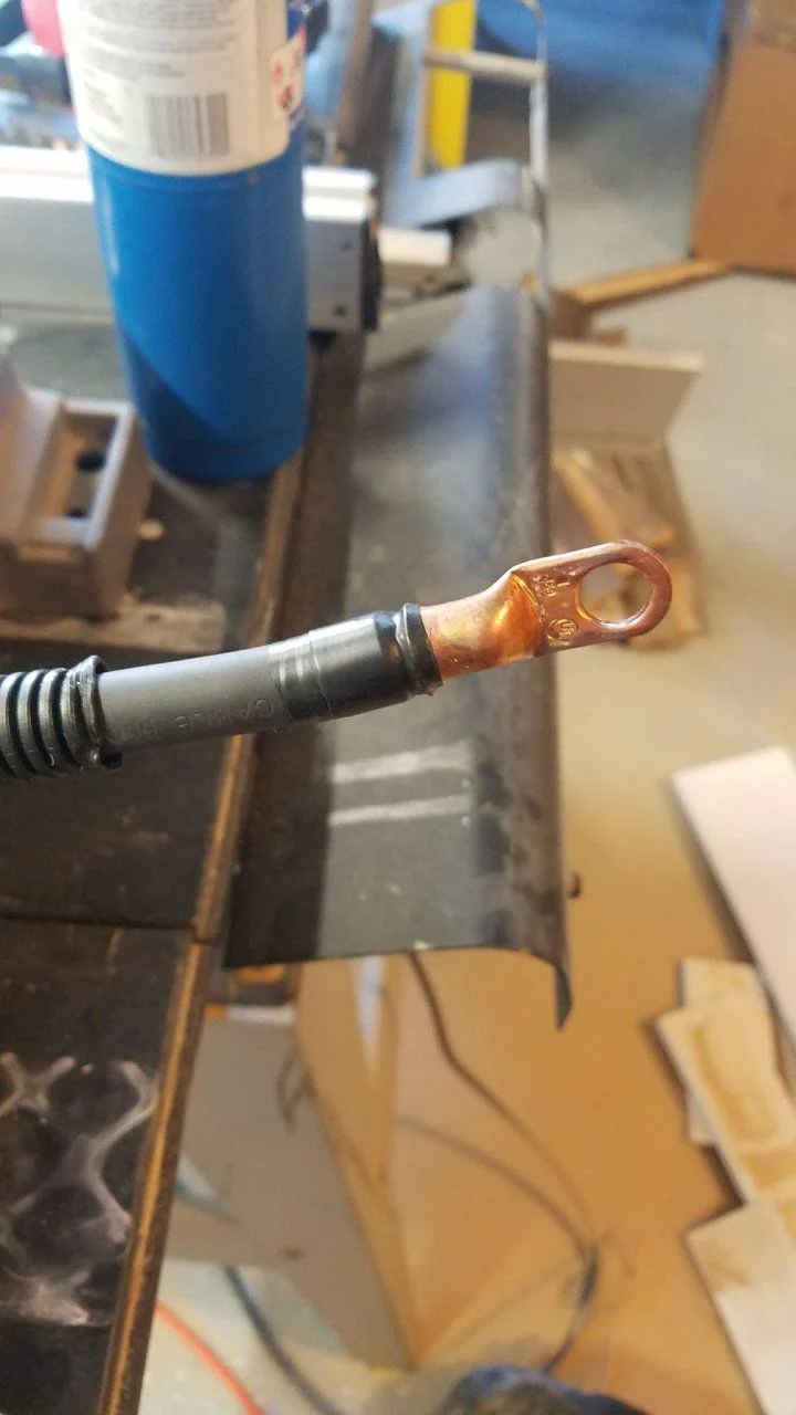

Over the last few weeks I started to have intermittent no starts. I would turn the key and get a click but nothing else. After 3-7 tries it would finally turn over and start. Replacing my power and ground cables was already on my radar so I went ahead and replaced the cables from the battery to the starter and the battery to engine ground with #1 welding cable. So far it starts every time without hesitation.
No crimping, just solder. There are various opinions about this but a lot of racing forums said just soldering is fine. Time will tell. I still need to do the alternator cable but wasn't 100% sure where it ran after going into the loom. I think it connects to the fusible link???

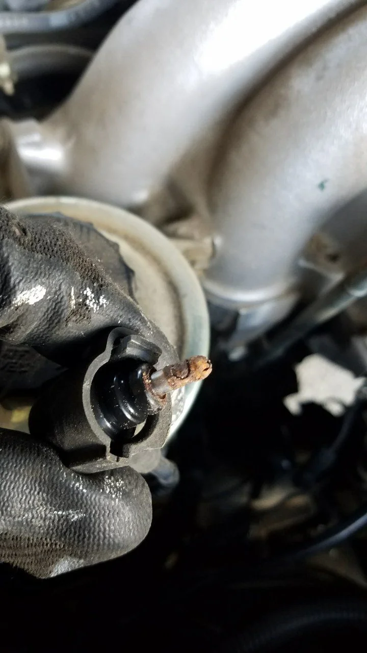

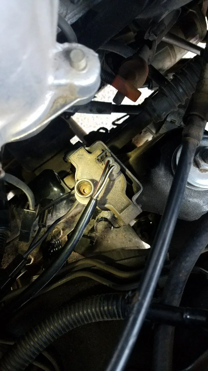

While moving things out of my way I noticed this.
I wire brushed it the best I could and scraped out what I could from the ignition coil. Added some dielectric grease and plugged it back in. Can I buy a replacement cable or do I need to buy the whole set? Also figured out my FR wheel is loose from 12-6. Time to check the bearings... Also ordered some Philips HIR bulbs.
View attachment 1345739 View attachment 1345738
Whole set. Its in your best interest to do all anyway.
