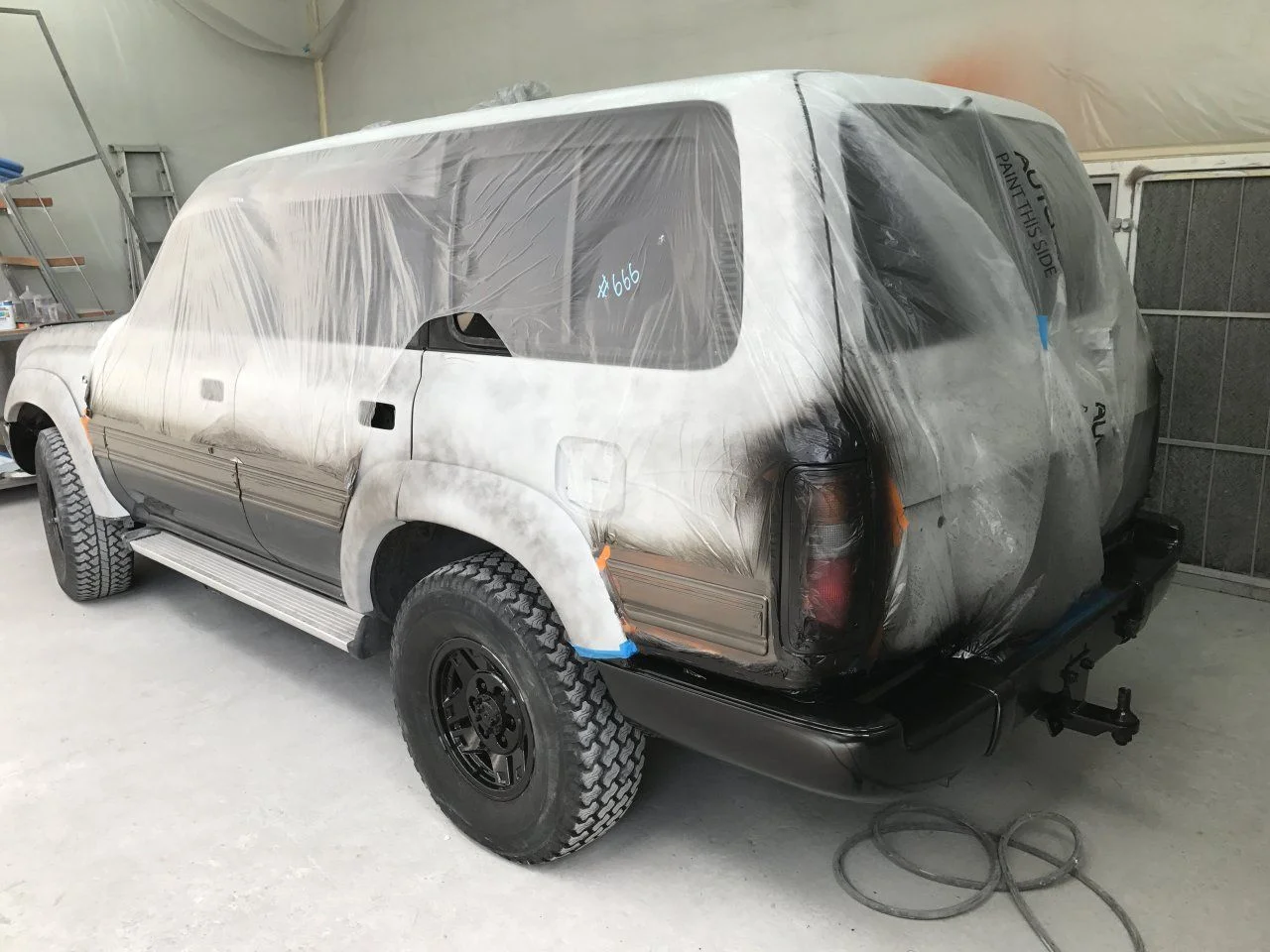

This is over the last few weekends, finished the 4x4labs rear kit and added 1.25" wheel spacers.
I think some 5.29's are on the horizon as the next mod.

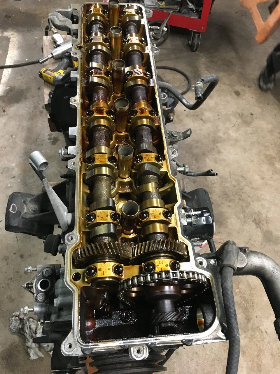

Just ordered this from the land of down under... Gonna be mated to an H151F. Cant wait for this to arrive.. Coming with correct ECU for the 105 series with a manual transmission and complete wire harness.
Can I ask how much that is, to get it state side? Also, is it still a 4.5 with the newer head? What's HP? Very cool!
This 3rd gen 1FZ-FE engine comes stock with 240HP and 300lb-ft torque vs a US Spec 1FZ-FE 212hp and 275ft-lb torque.
This one came from a 03/2000 FZJ105.

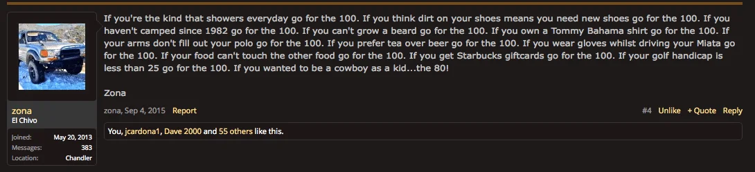

Was looking on my laptop for a picture for my daughter's show choir and came across this. Definitely a top 5 GOAT post on Mud. Shout out to @zona. Classic!

Ugh this generation head is so much nicer than our 1FZ head! I wish I would have just bit the bullet and ordered one before I wasted hours and hours porting a new US market head.
Scott, I know what you mean. Still debating on this build whether to leave as is with the new engine and 5 speed or do Forced Injection.
