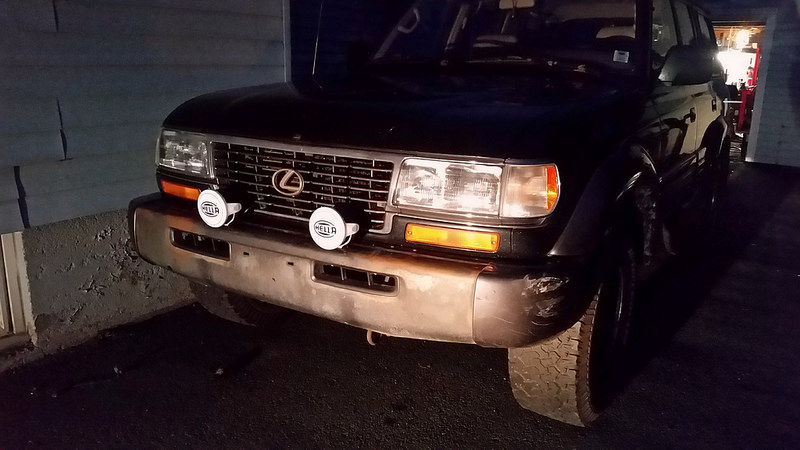

Removed the damage multiplyer and added my Hella driving lights off the old truck. Going to repaint the front bumper with hammertone paint over the weekend to pretty it up, but I will be fabricating a bumper for the vehicle in the next year.
2016-08-30_10-44-14 by Andrew Turner, on Flickr
