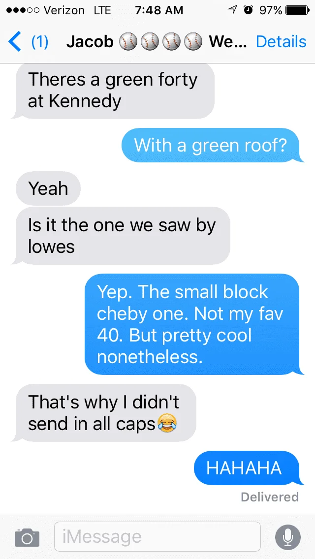

My son texted me when he got to school this morning. Gotta love this kid.

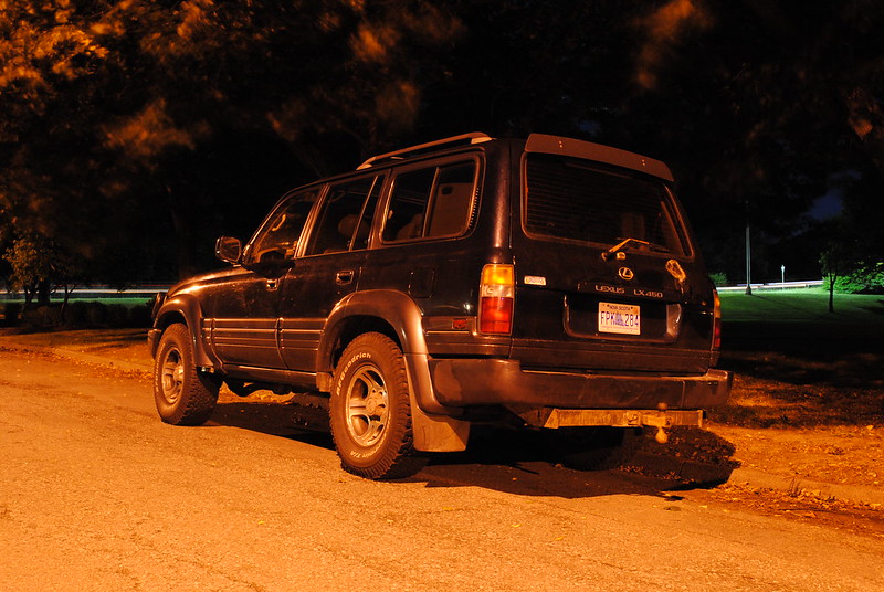

Even though I've had my 92 for 24+ years I still get excited when I see it!
