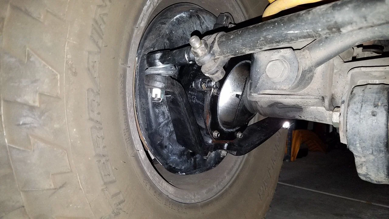

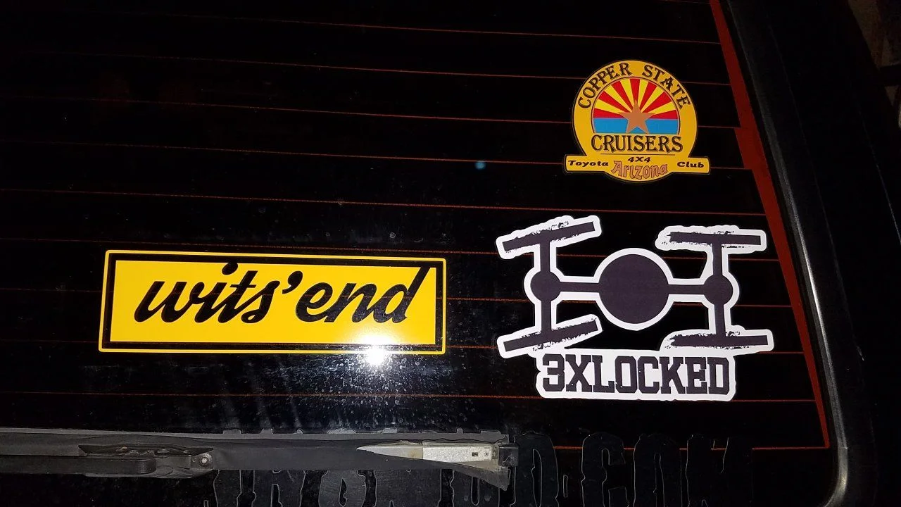

Bragging up CBT @murf for front end tightening up. TRE's, all LCA bushings, bearings. Also got my CSC and Wits End stickers up and running. May have to invest in a rear wiper! Might be able to do that work myself.

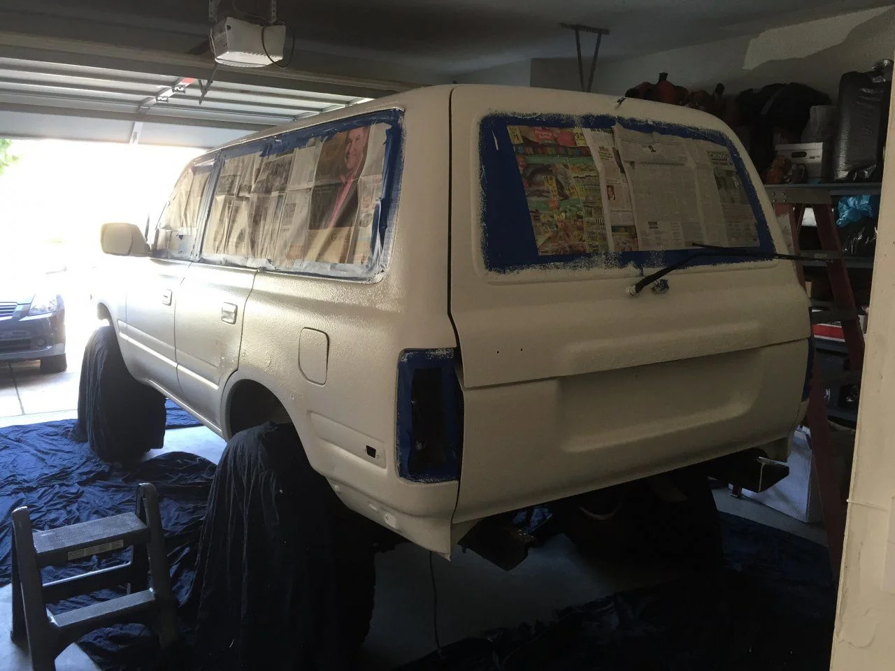

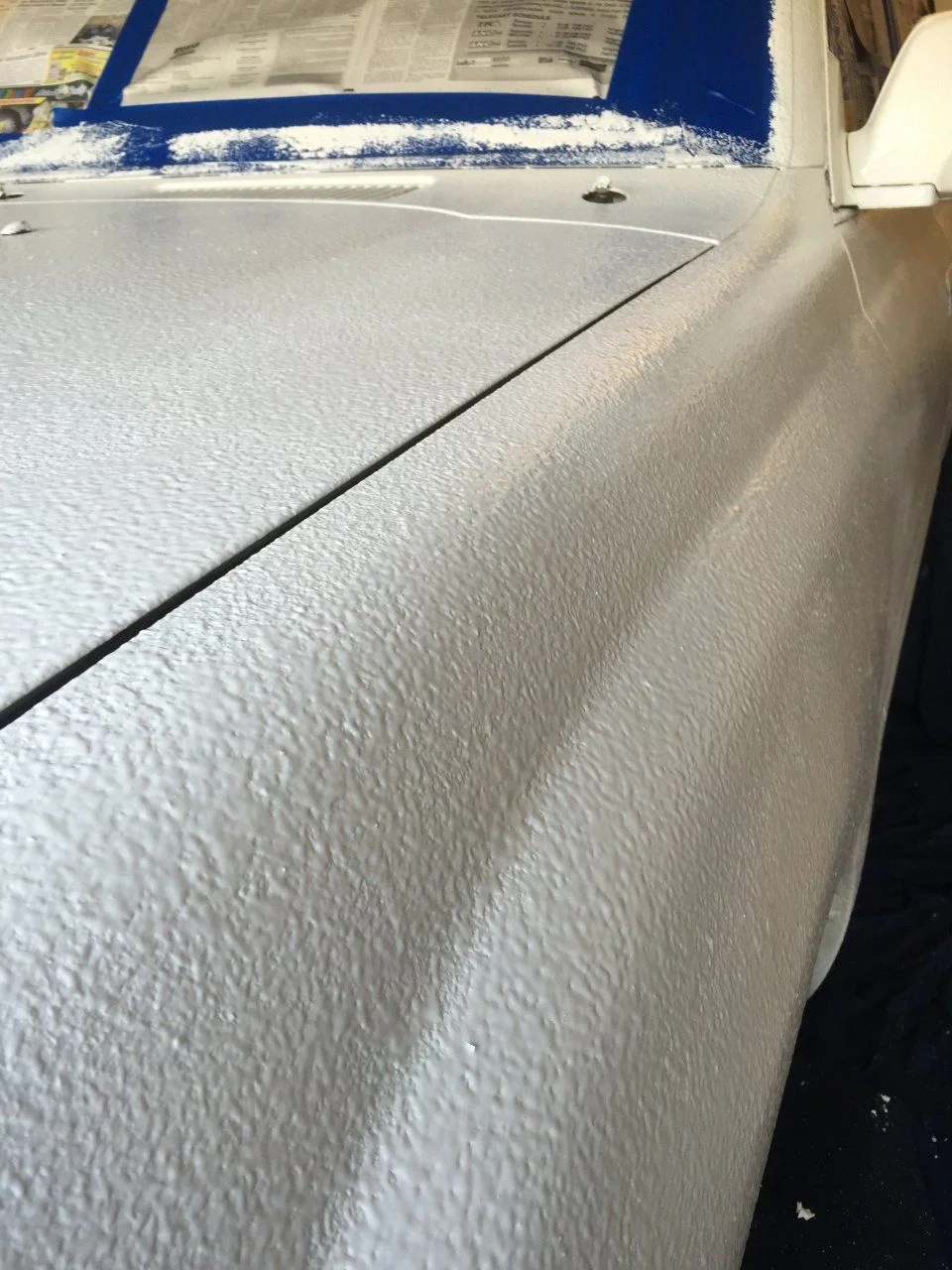

I finally finished my monstaliner project over the weekend.
I stayed with white but I wanted it a bit dull/flat, the tintable white is so glossy for my taste so I mixed three quarts white with a quarter of killer beej. I could've mixed in more of the beej but, oh well.
I purchased a three gallon kit just to make sure I have enough.
With the rack and all armour out, deflated tires, I managed to get her in my garage...
I was too conservative on the first coat, could've made it thicker.
This is to depict the original white vs the liner...
Still have to work on the door handles as I've removed them. Not sure if I do black on them... They were too tedious to remove...
I like the texture of the liner, great product. All I can say is prepping is the key, which I failed ( Ithink) A few of the holes from the flares that I had JB weld on needed more sanding... So they are popping out right now. I may have to sand them again and re do that area.
It was a fun project, but if I was to do it again, I'd spray it!
Oh well, it's going to get dinged and scathed anyways...
