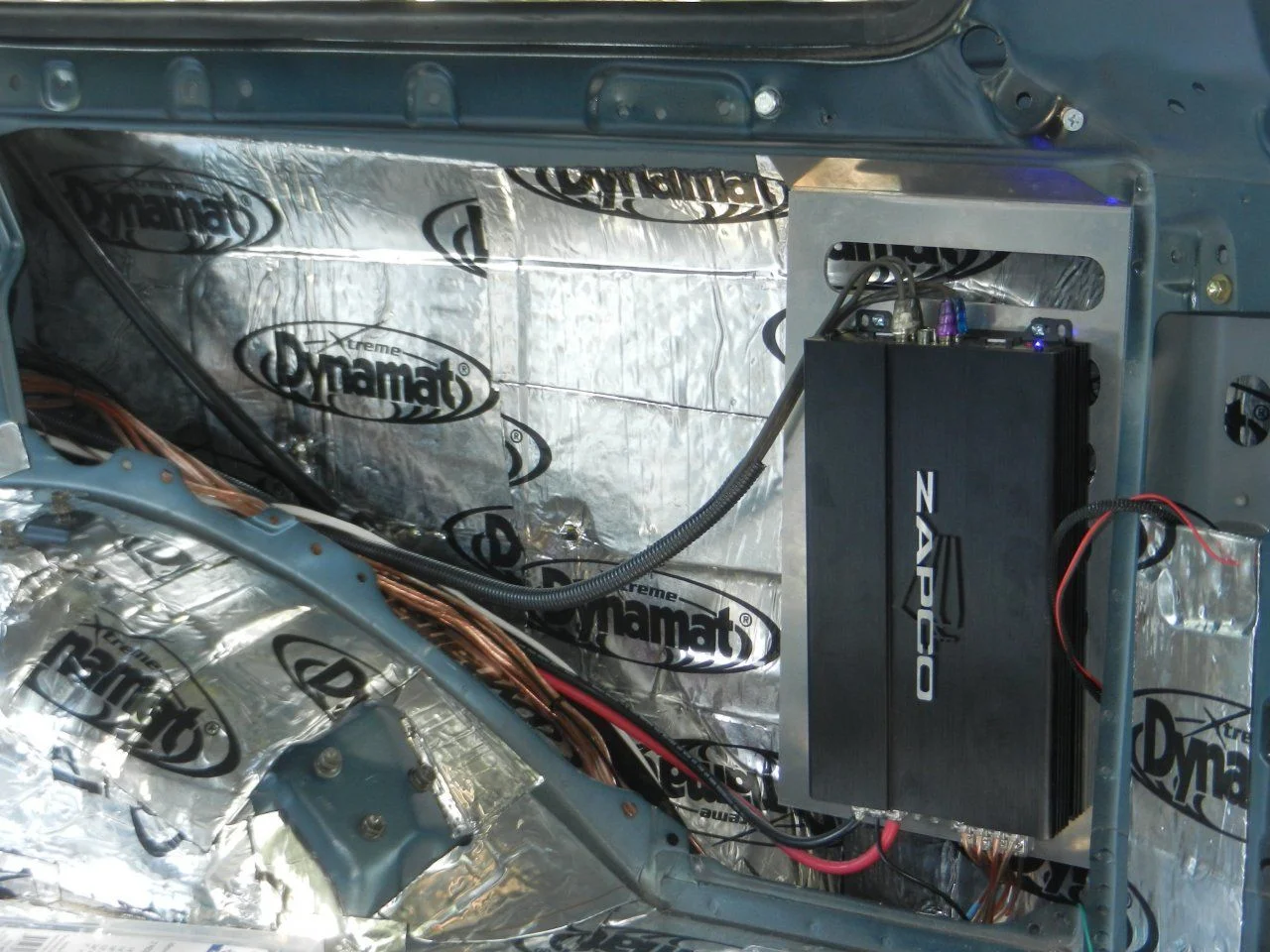

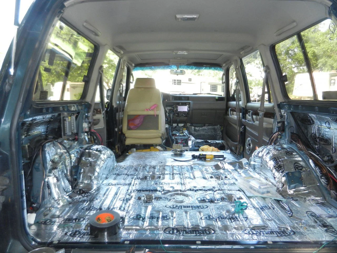

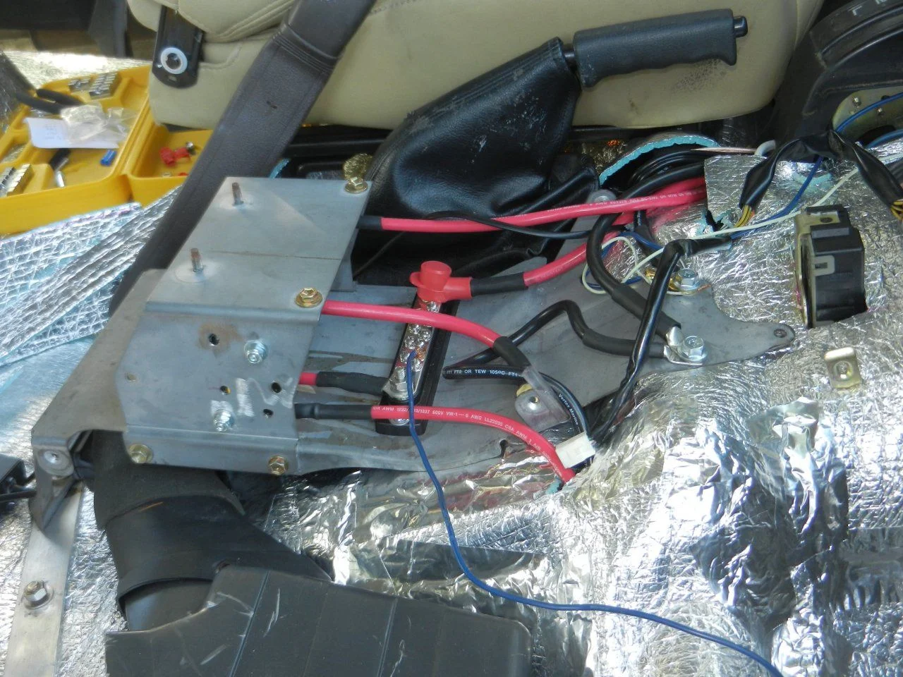

Well this has taken more than the weekend but has cleared many projects all at once even if it took a month. First thing, gut interior, apply sound deadener (no 20% rule here, rule was cover it if I could reach it). I then added a layer (in some cases two) of heat insulator called EZ Cool, this has reduced interior heat around the transmission tunnel and front passenger side dramatically. This was where two layters of EZ Cool were applied. I used aluminized duct tape to hold down the EZ Cool. I also ran new wires, distribution blocks, new fuse box in the drivers back quarter, new amp in the passenger quarter, new speakers, HU and powered sub. Along with the new stereo I of course had to add a backup camera and ran new wiring for my rear LED's. I have a buddy with access to a waterjet so I had him cut my brackets out of 1/8" aluminum. Cannot forget about my new tailgate storage from socallove, of course it is lined on the inside as well.
This is very nice. I have vinyl flooring to replace my carpet and was going to pull the carpet this weekend but decided to wait a few weeks until I have a better game plan for what all I want to run to the back. And of course sound deadener and heat shield. This helps tremendously.
I may end up pulling the second and third row areas of carpet and start cleaning. Did you power wash it to get it nice and clean or just blow it out?

@LS1FJ40 I took a simple wood handled s/s brush and attacked all the spots that the jute backing was stuck to the factory deadener. This cleaned it up really nice, then just vacuumed real well and started laying down the deadener. I highly recommend the EZ Cool closed cell insulation, it is thin enough to replace the OEM jute backing and it forms fairly easily. Two layers in the most high heat areas and you will be good to go. I also cut out and replaced the vinyl/plastic barrier behind the door cards with a layer of EZ Cool and taped it down with the aluminum tape. It is far away much quieter than before.

I will check the EZ Cool insulation out. @reevesci also recommended something similar. Can't remember the name of it now but have it bookmarked on my computer.

J, Thermozite is the name of it.
Thermozite Heat Shield Carpet Padding
Available in single or dual sided foil.

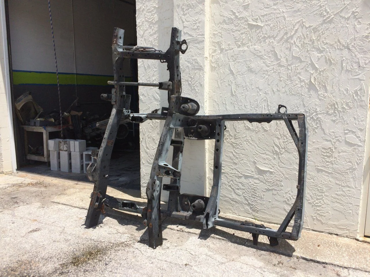

Happened over the weekend but not 80 related. These 2 beauties arrived at my doorstep!!!!
Ummmm......why?
Not enough shop space :)
Unfortunately 80's aren't old enough yet to where rust-free frames are in high demand. I still have the axles and steering box though that will definitely see use.

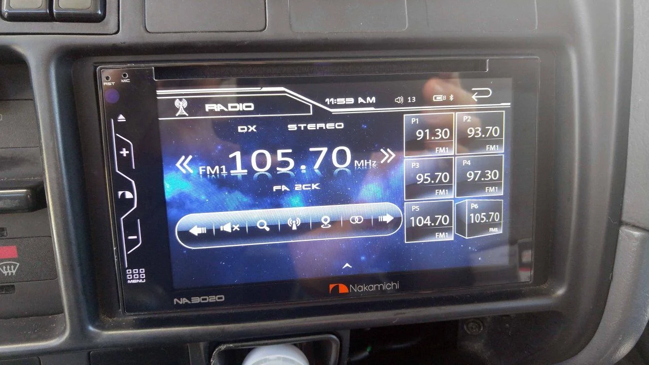

Did a radio upgrade...
