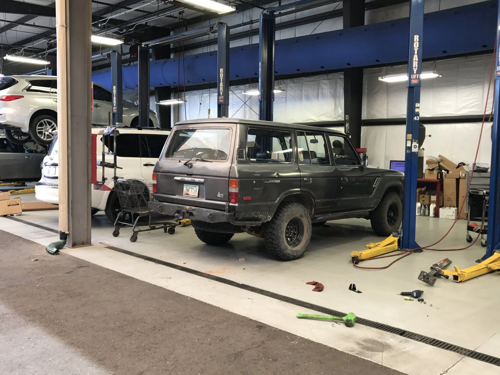

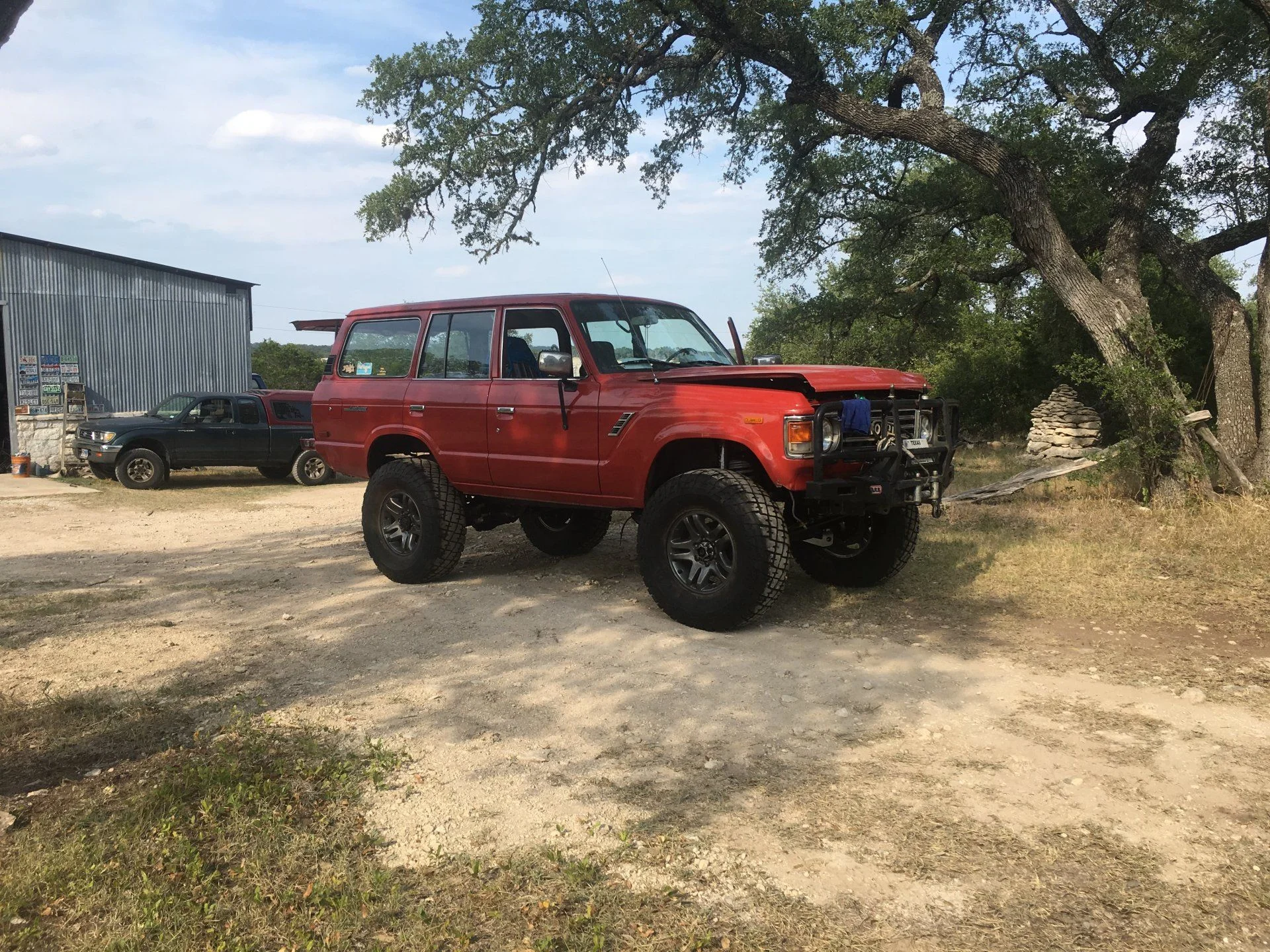

Moved it under its own power for the first time since January

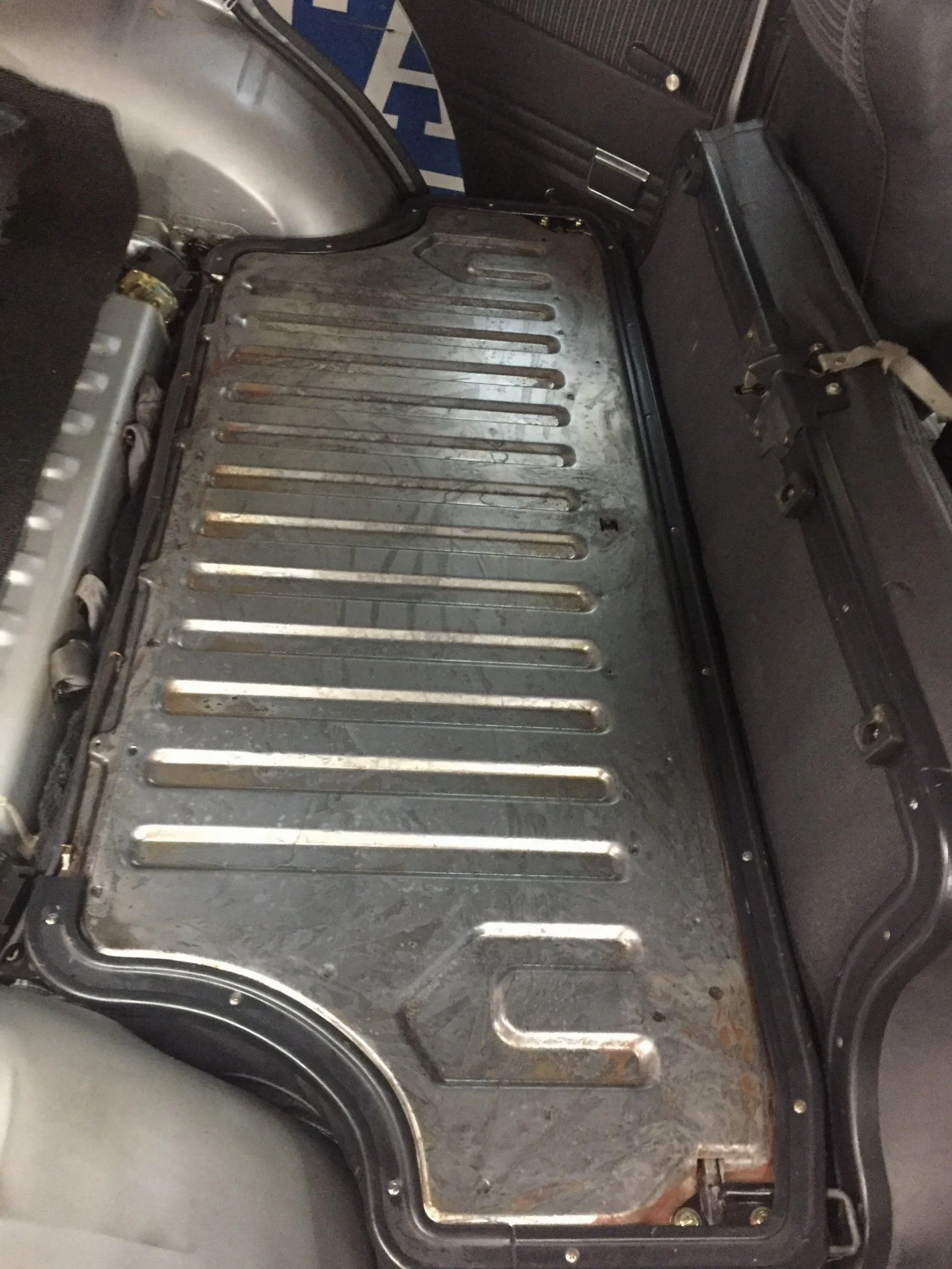

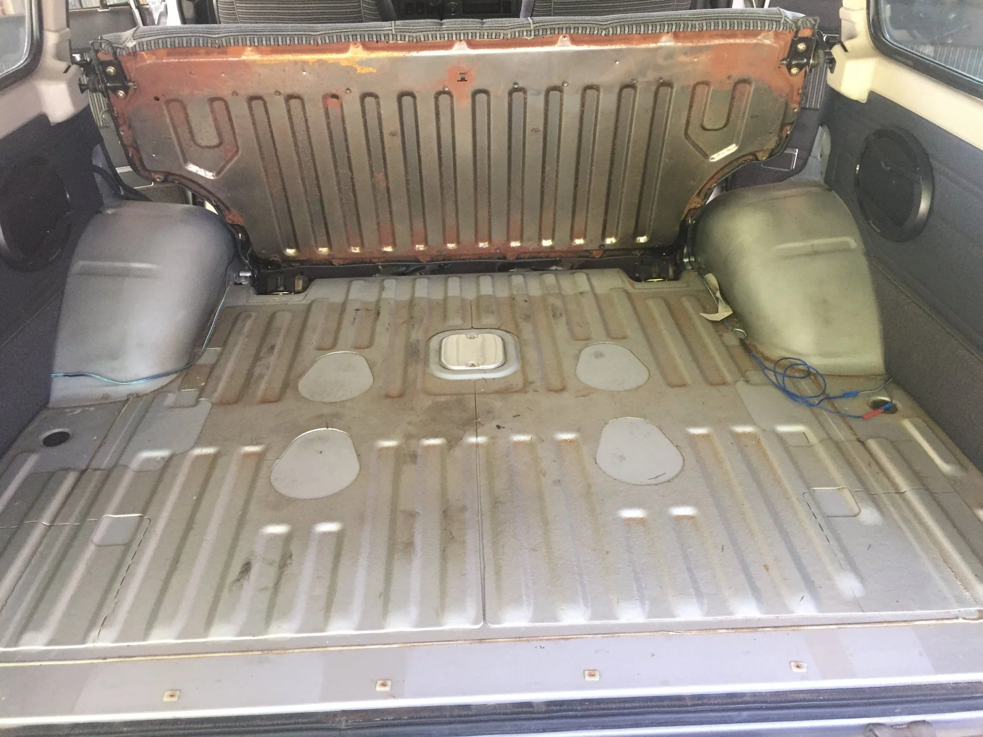

Converted some rust. I just received @dnp carpet set and proceeded to tear out the old and found the back of my bench had quite a bit of flash rust on it. Picked up some of the new eco=converter stuff that is water based and doesn't smell like a chemistry set. Worked rather well. More pictures as I get the carpet in.
before...
after.
Going to hit it again and get a little more of the creases.

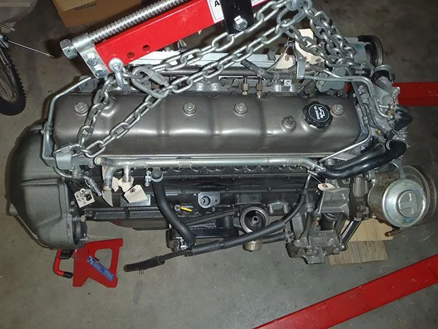

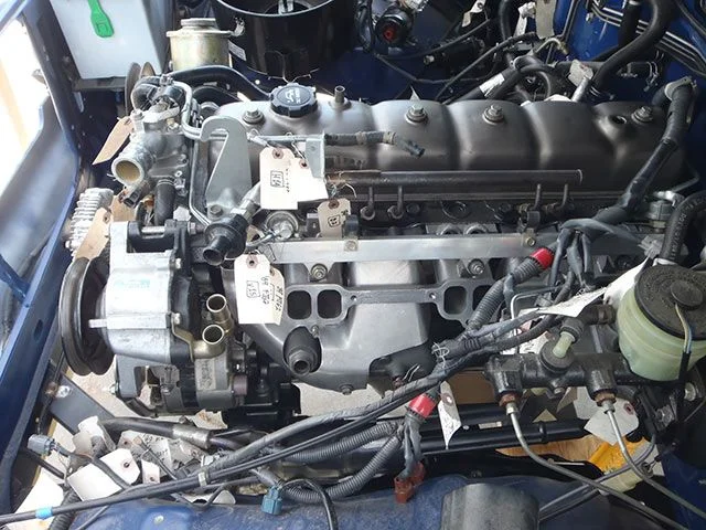

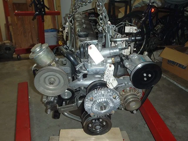

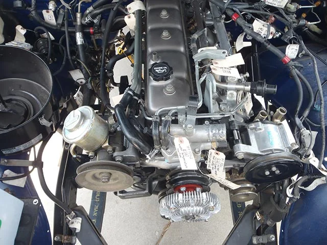

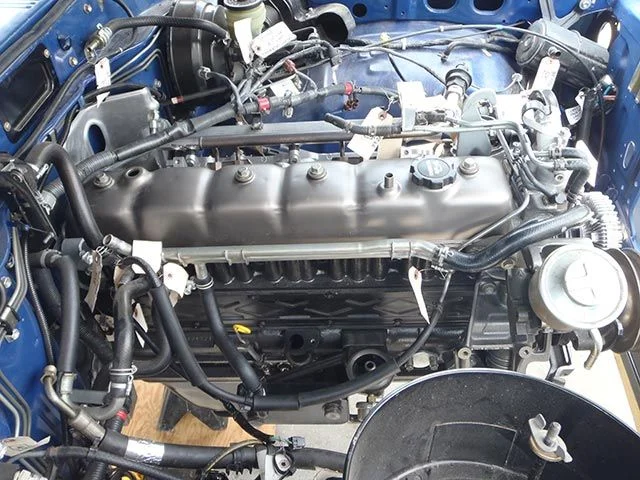

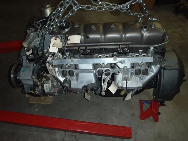

With the help of my youngest son removed the 3FE from the engine stand for the first time since its rebuild (February 2016). It's now on the engine hoist and ready for installation into the '86 FJ60 project vehicle tomorrow morning at first light. Here are some photos:

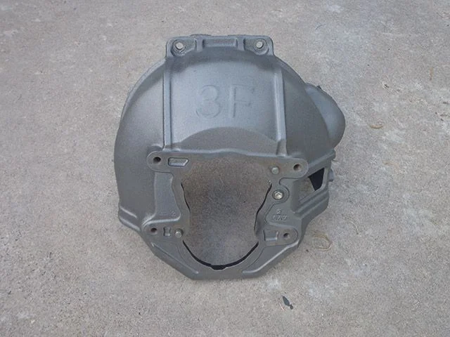

The freshly cleaned and painted 3F bell housing (VHT high temperature engine enamel, satin black inside and cast iron outside, baked under two brooder lamps for 8 or 9 hours.
The 3FE safely tucked away for the night.

Dang that looks clean!!! You even used those evil cotter pin hose clamps! Props to you for keeping it all factory.

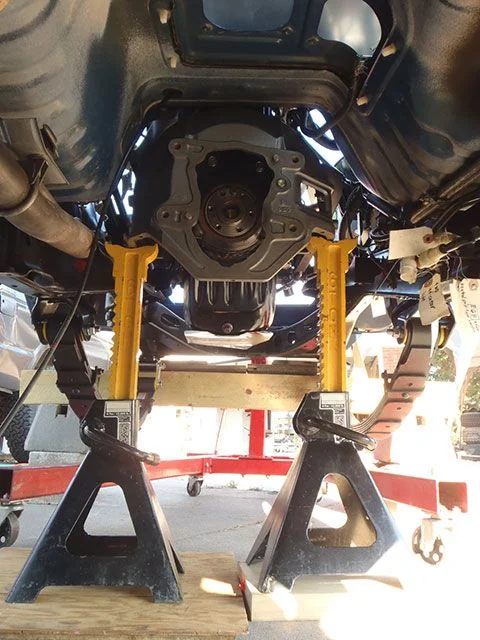

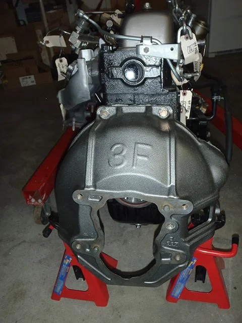

Here's how the bellhousing is supported until I wrap up rebuilding the '89 FJ62's split transfer case (will be converted to manual front drive engagement) onto the back of the new H55f:
Why would you not install the flywheel and clutch in the garage? You're missing the pilot bearing as well.
Mostly schedule coordination with my son. Besides, now I'm ready for an early Festivus celebration and the requisite demonstration of "Feats of Strength". And with the lift I've got plenty of working room under there.
