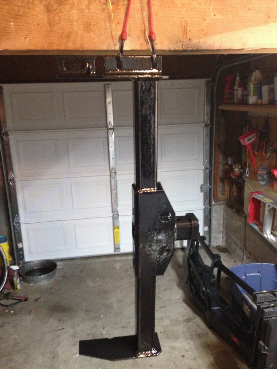

Picked up a new to me hitch. (Thanks @88FJ62PARTS) Wire wheeled it and coated with chassis saver. I'll pick up some mounting hardware for it tomorrow.

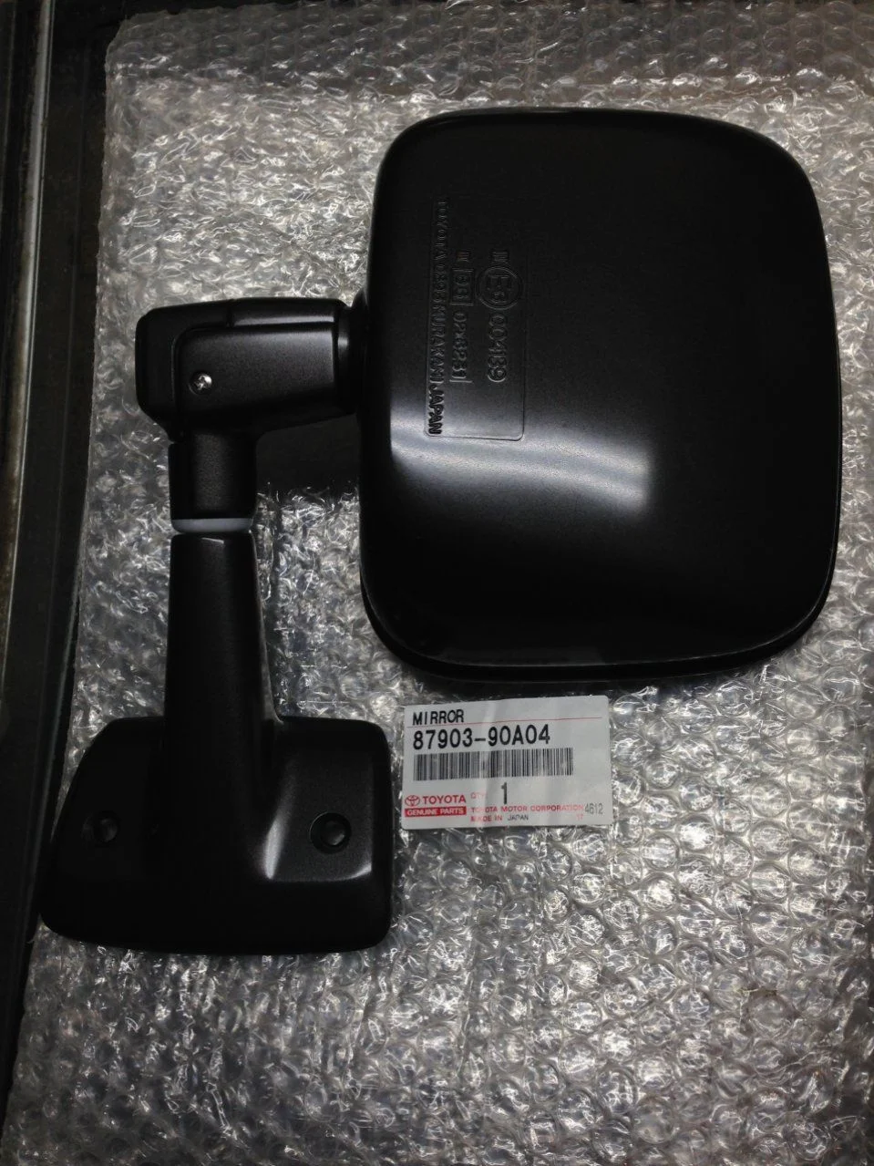

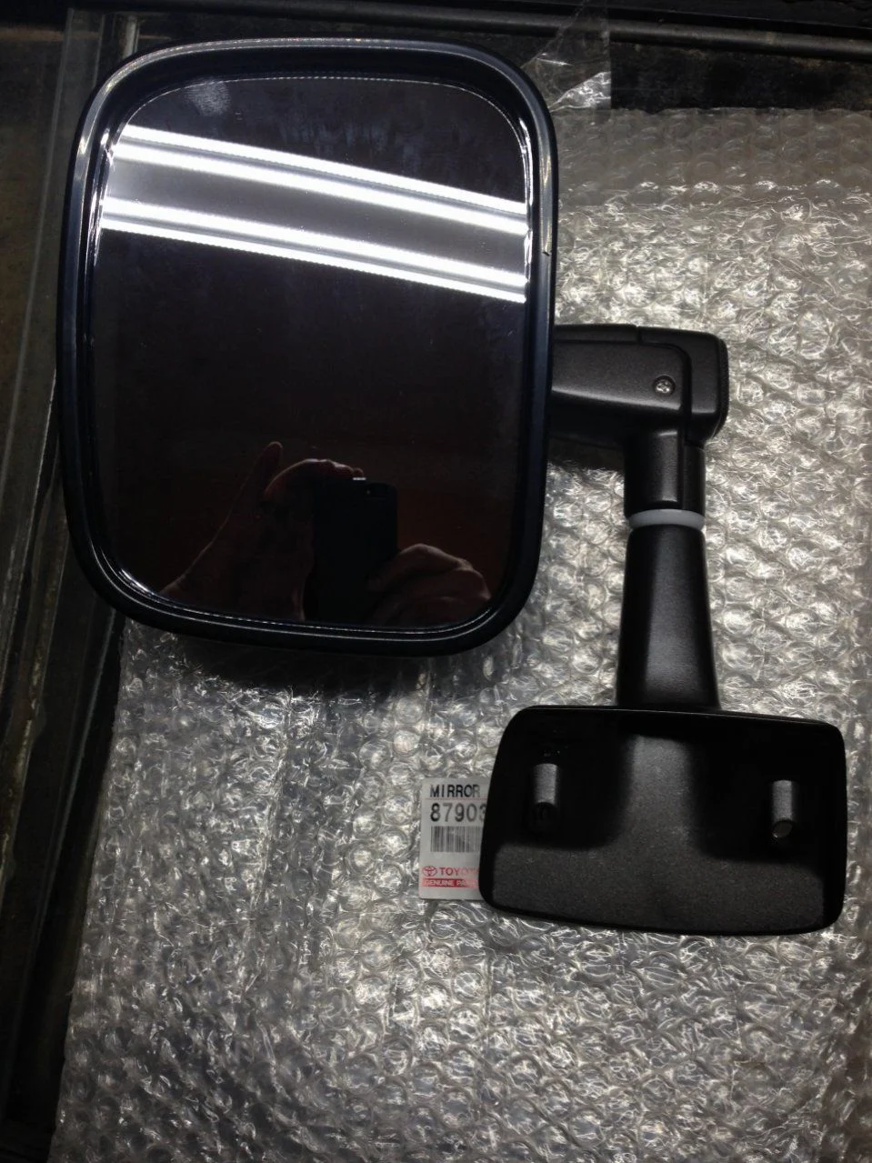

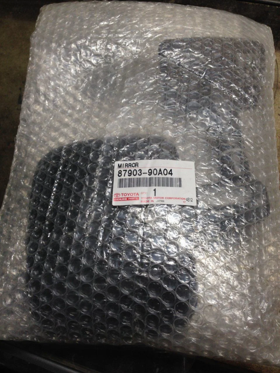

Also had a surprise waiting for me when I got home. (Thanks @Racer65) Faster shipping than expected.
