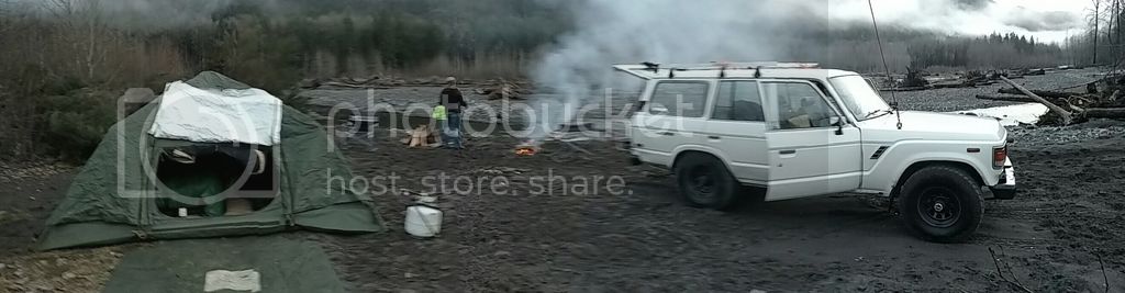

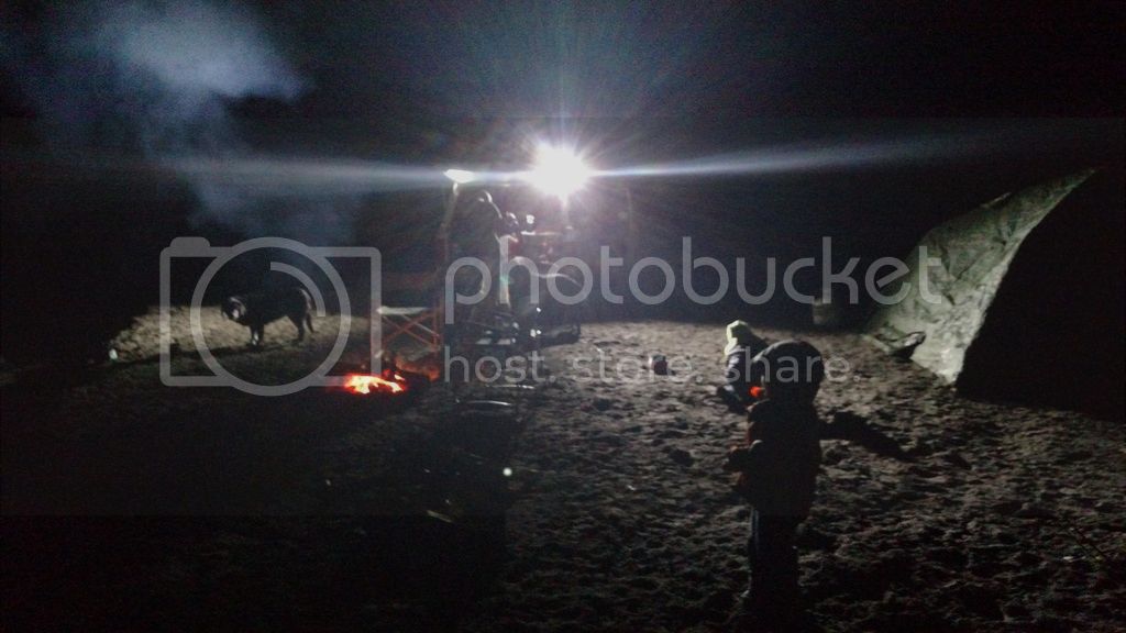

Tested out the new ATV roof rack and LED lights for the first time at our favorite river spot. Takes a bit of 4x4 to get into it, a little mud on the tires. Kids loved the new light to play in the sand. Had the best baked potatoes cooked right in the coals of the fire. LED's ran the battery down but I got one of those tiny jump boxes Amazon.com: Nekteck Multifunction Car Jump Starter Portable Power Bank External Battery Charger 600A Peak with 16800mAh - Emergency Auto Jump Starter for Truck Van SUV Laptop Smartphone USB Device and More: Automotive . Thing actually jumped my dead battery and started my cruiser! Here are some pics..
@WAEPLORERJR, THAT is what having a Cruiser is all about. Love it.

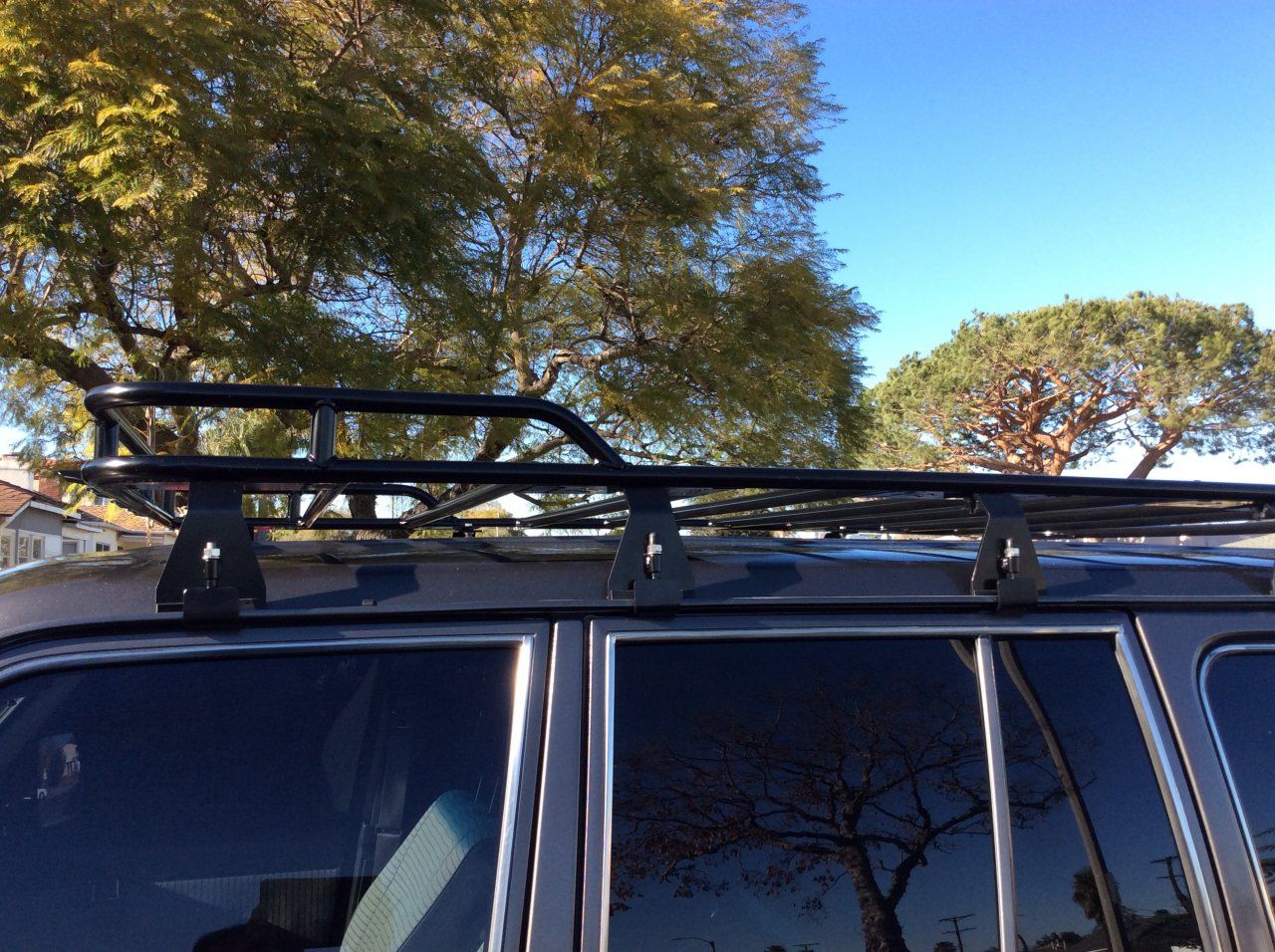

Installed my new Trail Taylor roof rack.
Thanks Jason
Wow-very nice.
Got a weight?
The reason I ask, is that I have a full length Tradesman rack that weighs about 80 pounds. If you are under 50, I might have a trip to Wyoming in my future.
Wow-very nice.
Got a weight?
Andy, how many mounts are you wanting? Each mount and plate is about 2#s... I can get you really close to 50# if you shave 2 mounts and 2 crossbars.
