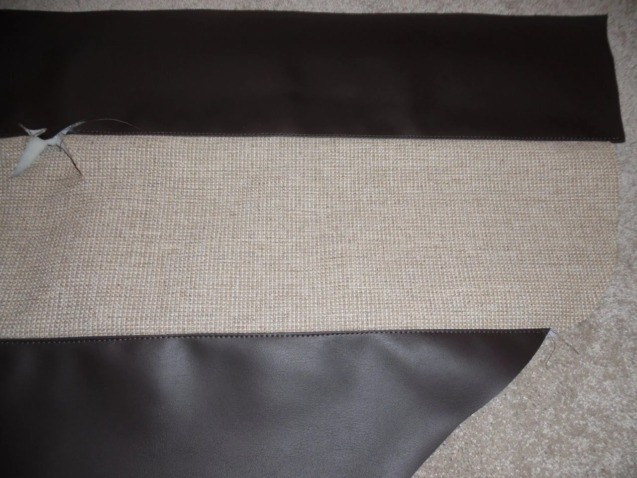

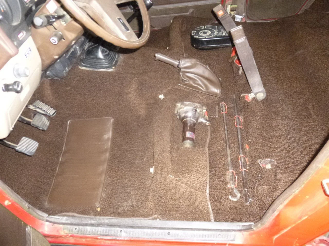

Looks good Jason. Does he still have the patterns for the door fabric? Lord knows I could certainly use 4 new ones. Any idea on the price for those? I didn't know you were getting those done, too.
T,
I told him to make a copy of them and the cargo as well. I'm going to try and catch him tomorrow if time allows for piece pricing on the carpet. I'll ask.
J

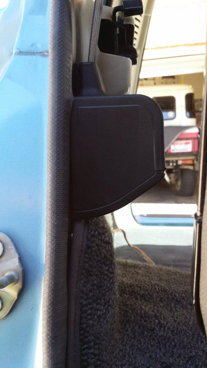

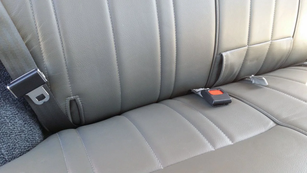

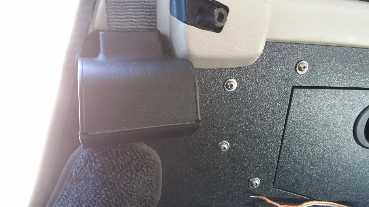

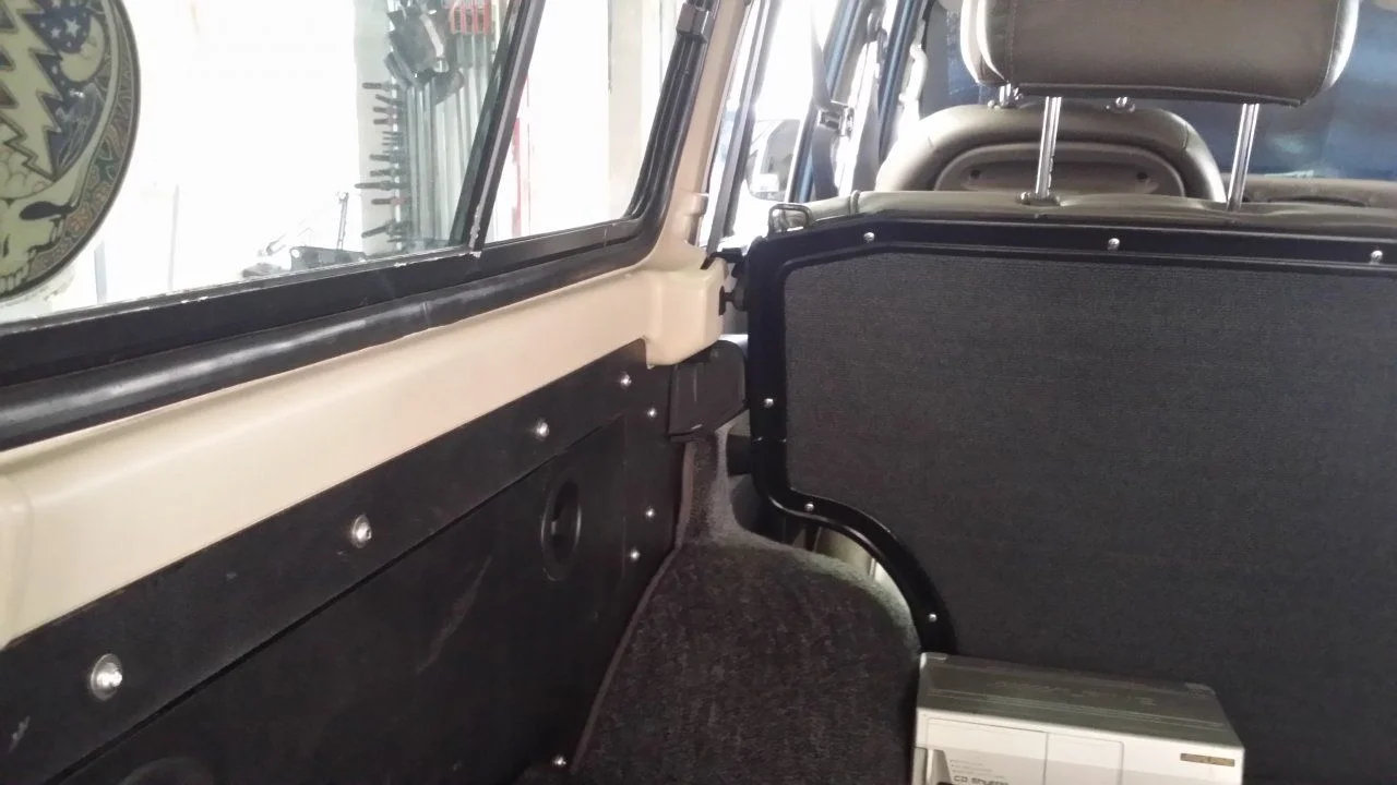

OK, I finally finished my install of rear shoulder belts as per @roadstr6 and his rushing turdle
with some slightly different mounting as I have wagon gear panels. Upgrades the seatback to have headrests. So now the rear seat is as safe as can be for an old 84 vehicle. Also ran solid power to the right rear quarter to power my ARB fridge.

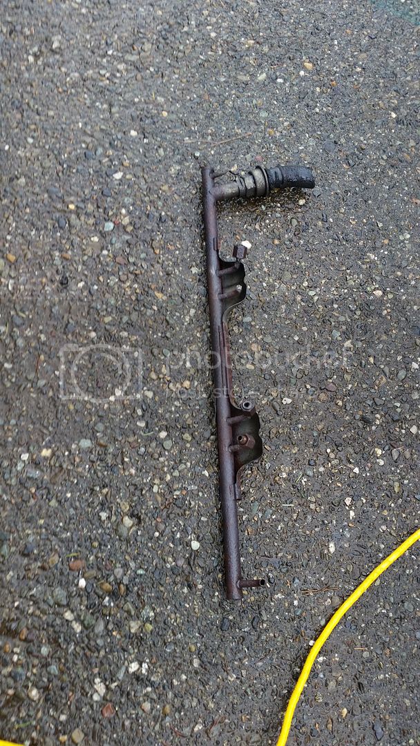

removed the air rail(rustiest thing on my 60) and installed the OEM(3fe) plugs in the head. I was really surprised how easy it all came off.......it was so rusted(soaked in Kroil for a week) I was able to just twist each rail with a 17mm wrench and the metal pipes broke, which then made it easy to get the rest of the plug out. the rear one looked like it would be a PITA to get to, but after the other 5 were off, I had the sawzal going to cut the hose off the check valve.....the vibration was enough to brake the back one off at the pipe :) Plugs went in and bottomed out nicely. No more leaking air rail and its looking much cleaner under the hood, working my way to a full desmog.
I did however manage to bust off 1 of the 4 bolts for the T stat upper housing. just the top 3/4" with head broke, so there should be plenty of meat left to get the rest of it out of the lower 1/2......but will leave it to my buddy who has much more patience than me

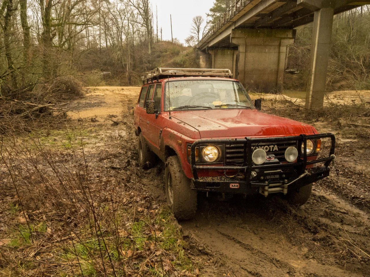

Yesterday became stuck under a bridge along the Locust Fork in north Alabama. Winched off the bridge supports to reach a less slick spot.
