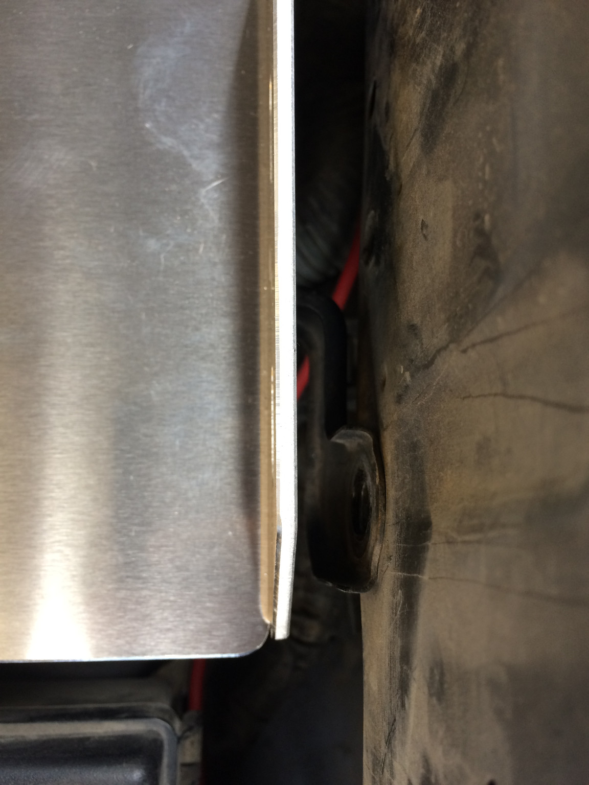

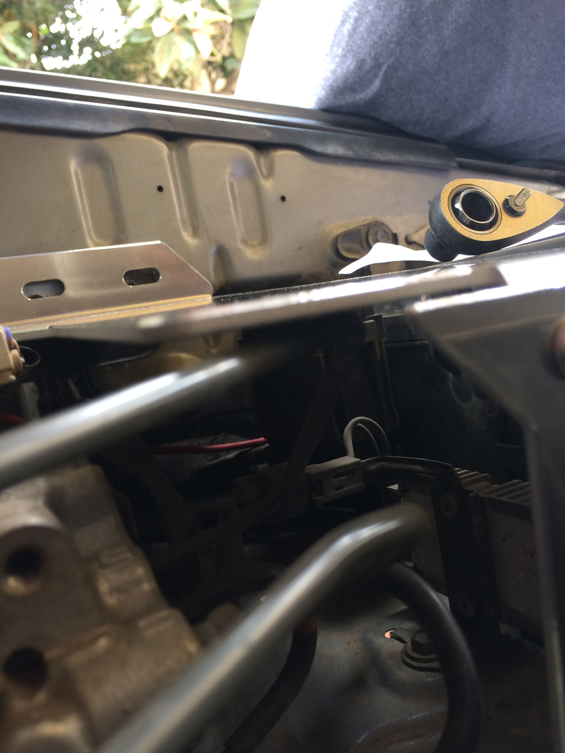

@bravoleader So here is the issues I ran into with my tray install.
It hits the top of that bracket I pictured before.
And that prevents the holes from lining up.

I think I see the problem, Power Trays made me a blank one since I am planning to install a BlueSeas fuse black that I already have and there trays fitted with holes would not work for the BlueSeas fuse block. And for some reason the tab against the fender is turned up instead of down like yours is.

Quick and easy... Open the hole with a die grinder or step bit?

Not to sound rude, but are you sure you are not installing it upside down? From my understanding the trays should all mount the same, they just have different cutouts. If the fender side is indeed upside down I would request a replacement as that will not bolt up properly.
I thought about that at the time I tried to install it because there is a major lack of directions with these trays! I had to go to the website and search for a pic to see which side attaches to the leg. The left side of the tray is down to reach the leg support and the right should be down as well according to your photo but mine is bent up.

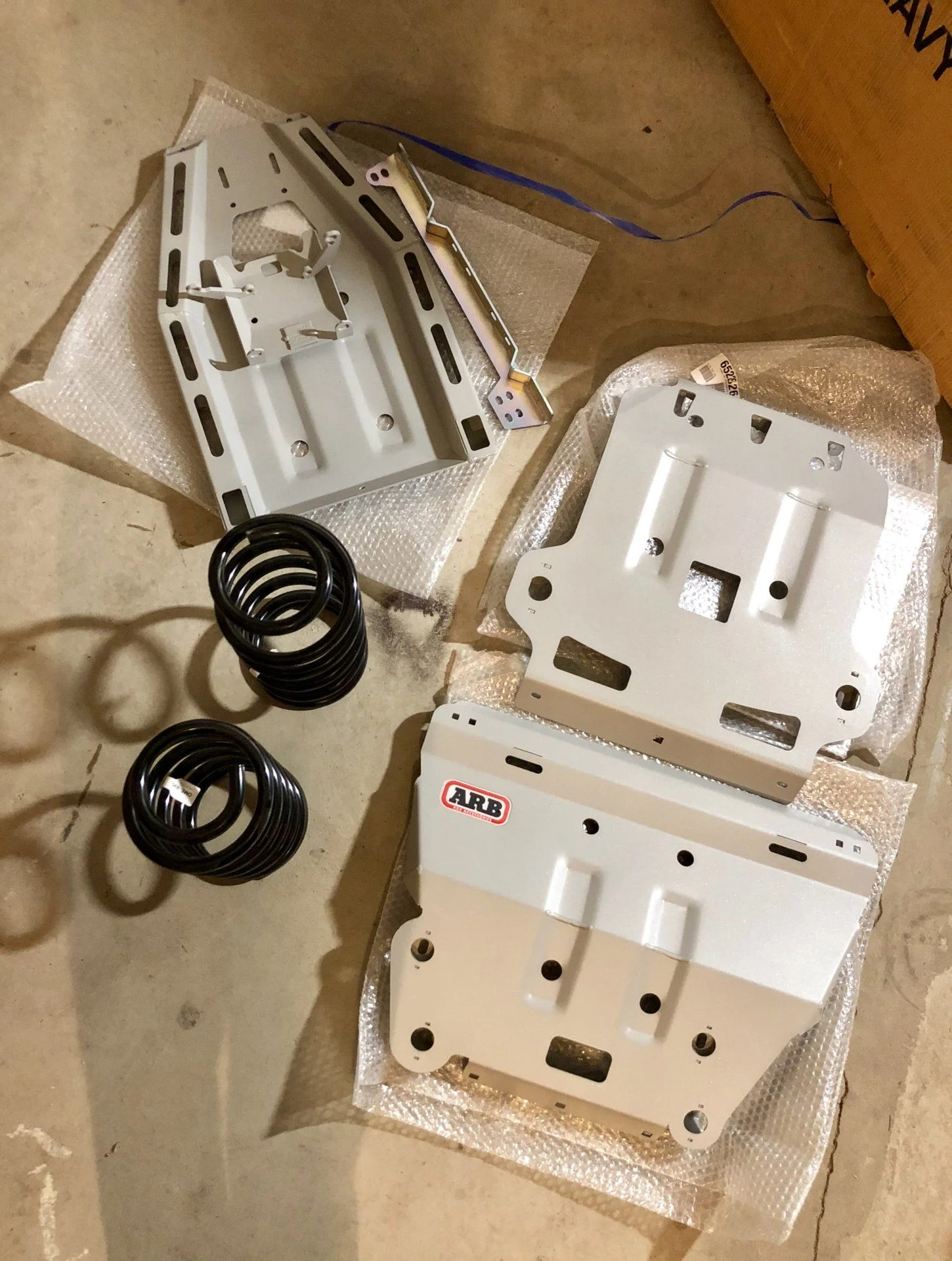

On Topic: Received brake replacement parts and some underbelly protection. Prepping for installation this morning.

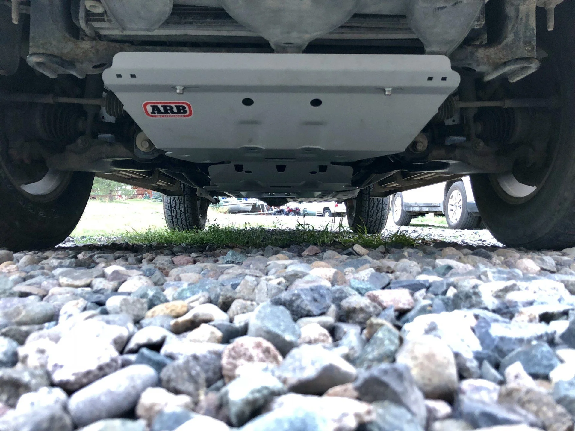

Not that the picture shows it well, but I have the ARB UVP installed. I did find out that the Prado120 has some slight bolt pattern differences compared to my GX470. The one issue I found was the rear tranny UVP plate says to use the rearmost holes for the 150 series, but to use a slightly front pair of holes to bolt up to on the Prado 120. The 150 series pair of holes were what I had to use as the other pair didn't match up to anything. No big issue, just an observation.
