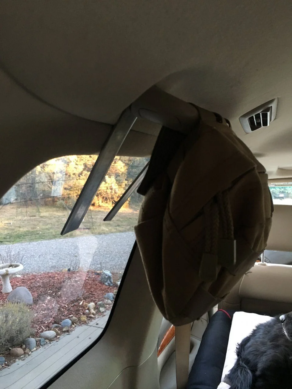

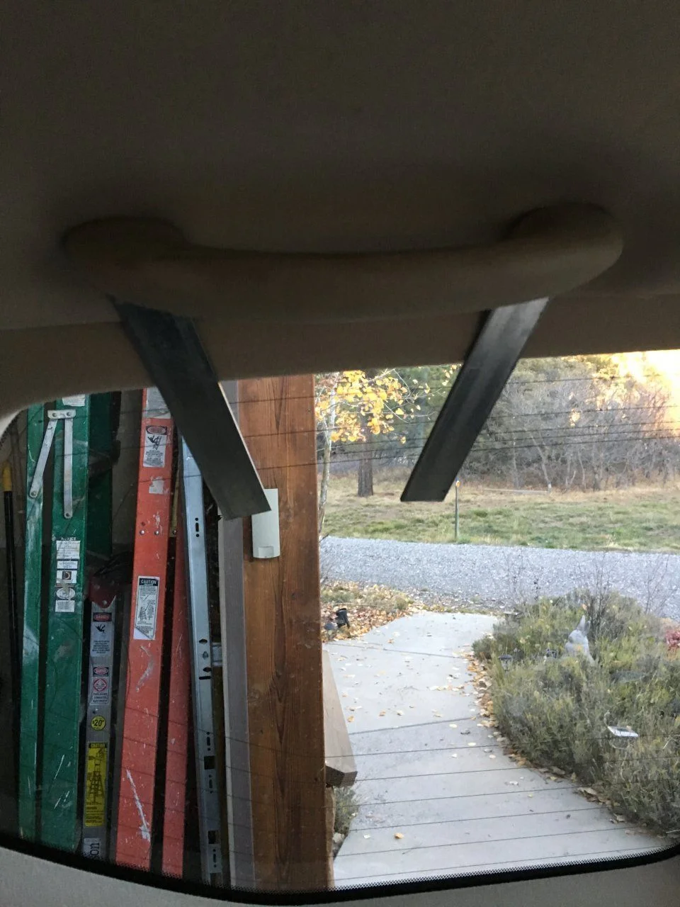

Just FYI on those kits on the grab handles. The day will come when they swing a bit too hard and you will lose your rear quarter glass. Don't ask me how I know this :P
Just FYI on those kits on the grab handles. The day will come when they swing a bit too hard and you will lose your rear quarter glass. Don't ask me how I know this :p
Ok, I won't ask, but Even with nothing hard inside of them? The tire kit does have the reamer and plug tool, but that's it.
A cold day and a good enough slap will break glass. I would just see if there is a way to anchor them a bit. Should be able to.
Thanks for the heads up
thanks Dan, went out and looked this morning,
the Tire kit has some hard stuff in it, but the closes it gets to the window is 4 fingers
the first aid kit is very soft and gets to abut 1 finger from the window.
Need to think this one out, will need to keep an eye on the snaps and velcro holding them on.

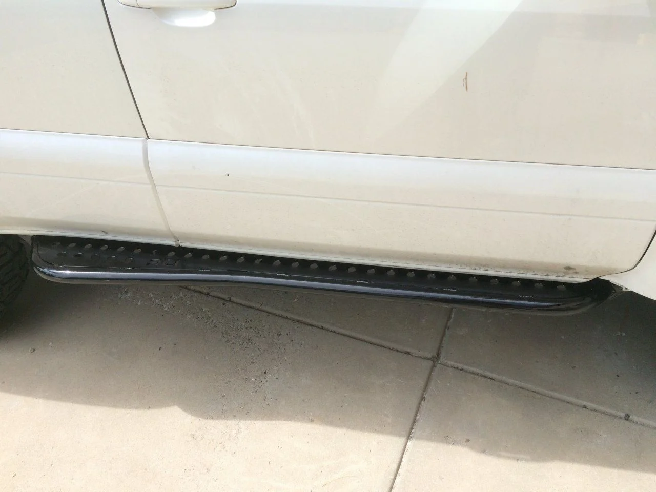

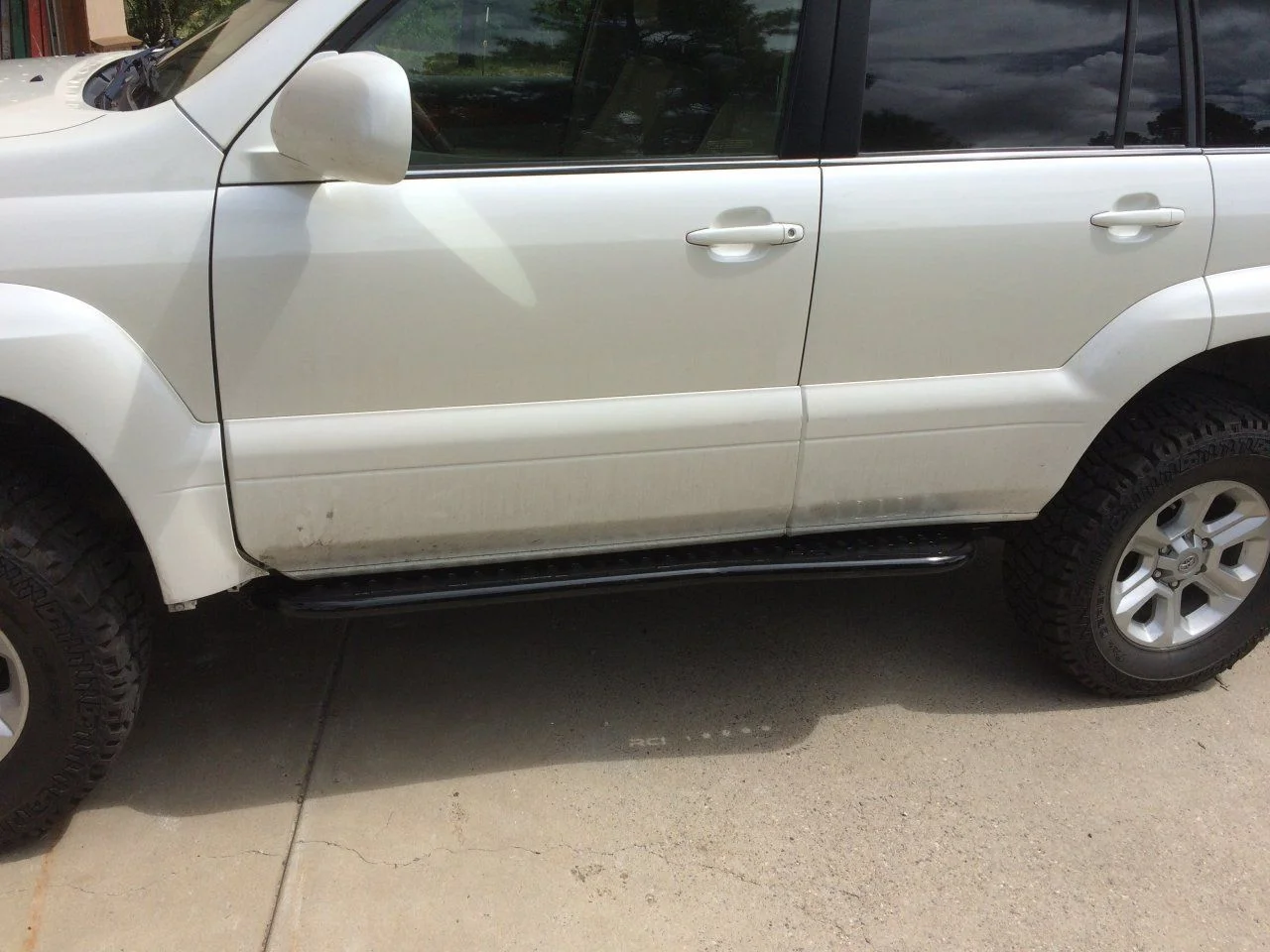

RCI Sliders installed
took your advice and added some braces to protect the window, they sit about 1 1/4" from the windows

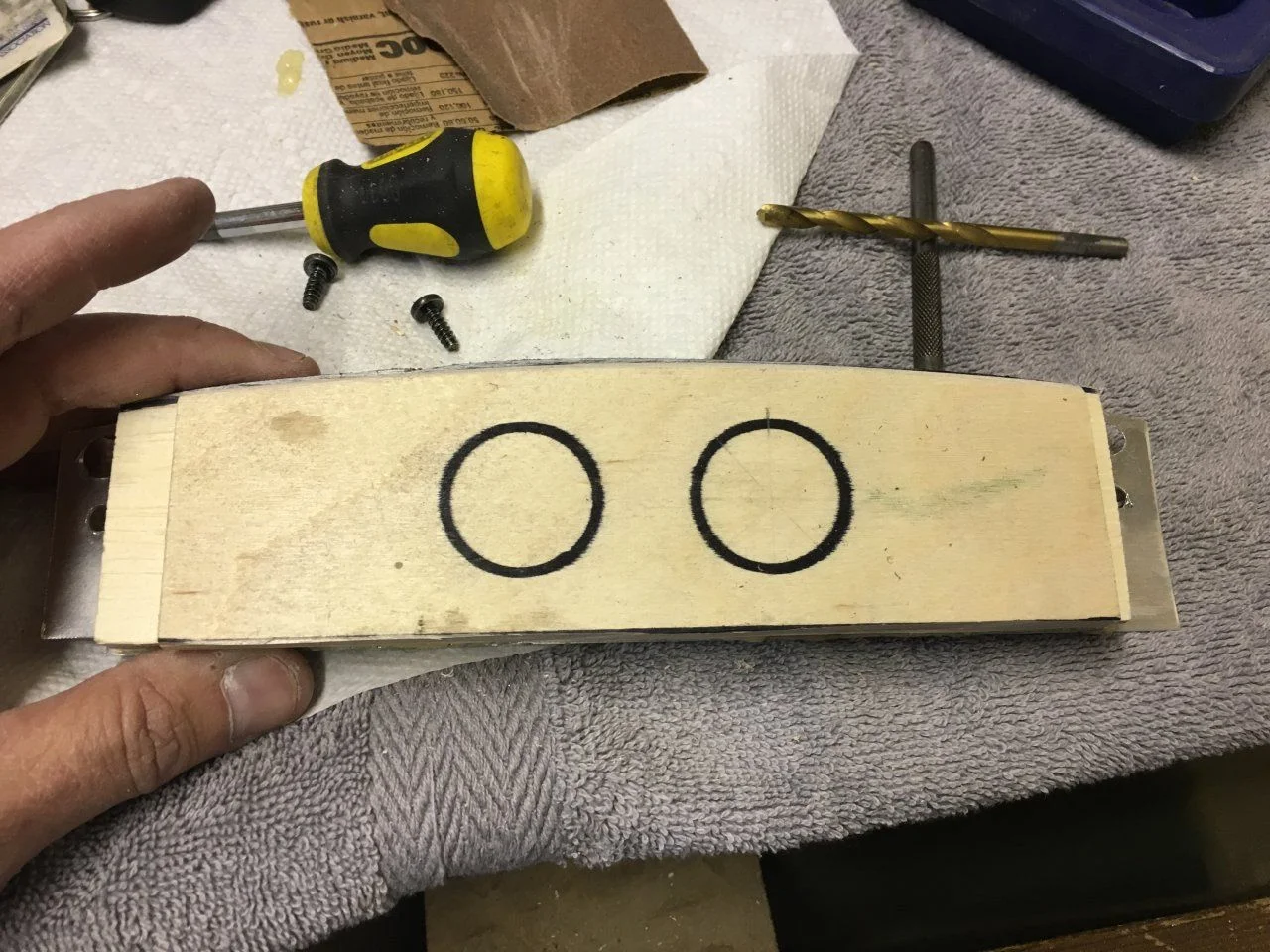

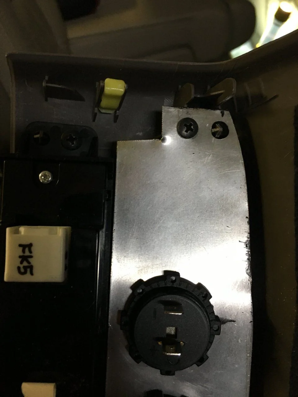

This past week I worked on another project, power outlets to the rear. I used the center console where the entertainment controls are, they are getting used, so I used the area for a 12v outlet and 2 USB ports. When I installed my NAV/Stereo unit, I ran a hot wire back to this area, since I had planned to do this. For the ground, I drill a hole into the floor at a point where there is a gap between 2 floor layers.
this is the area where the entertainment controls where
metal backing plate, used metal and not wood to make it easier to mount
took 4 thin pieces of wood, shaping the last one for the best fit, marks for drilling out
How it mounts from the back side, if you do this, make sure you leave room to clear the yellow mounting points on each side, about 1/2" is needed
finished

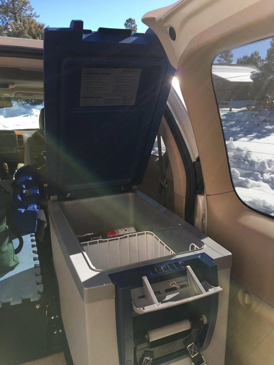

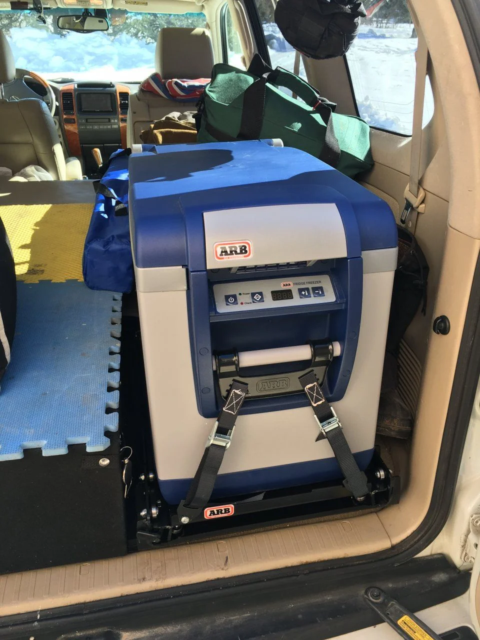

Picked up a new ARB 50qt fridge from 4WP today for $599
ARB fridge purchased during 4Wheelparts Christmas deals
Mounted but one small problem, when fully open the lid hits the upper part of the rear door. It opens enough to get anything out and I could stop the slide at 3/4 open and open all the way.
